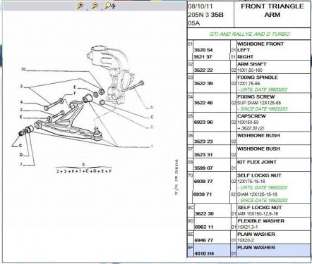

The parts you need from Peugeot to replace these are:
3523 31 Front Bush - 11.08 GBP
3523 23 Rear Bush - 13.86 GBP
There is a kit with both these in as well as all the bolts for about the same price as the two bushes
3599 07 Kit Flex Joint - 26.89 GBP
This contained enough bushes for both sides so was considerably better value.
