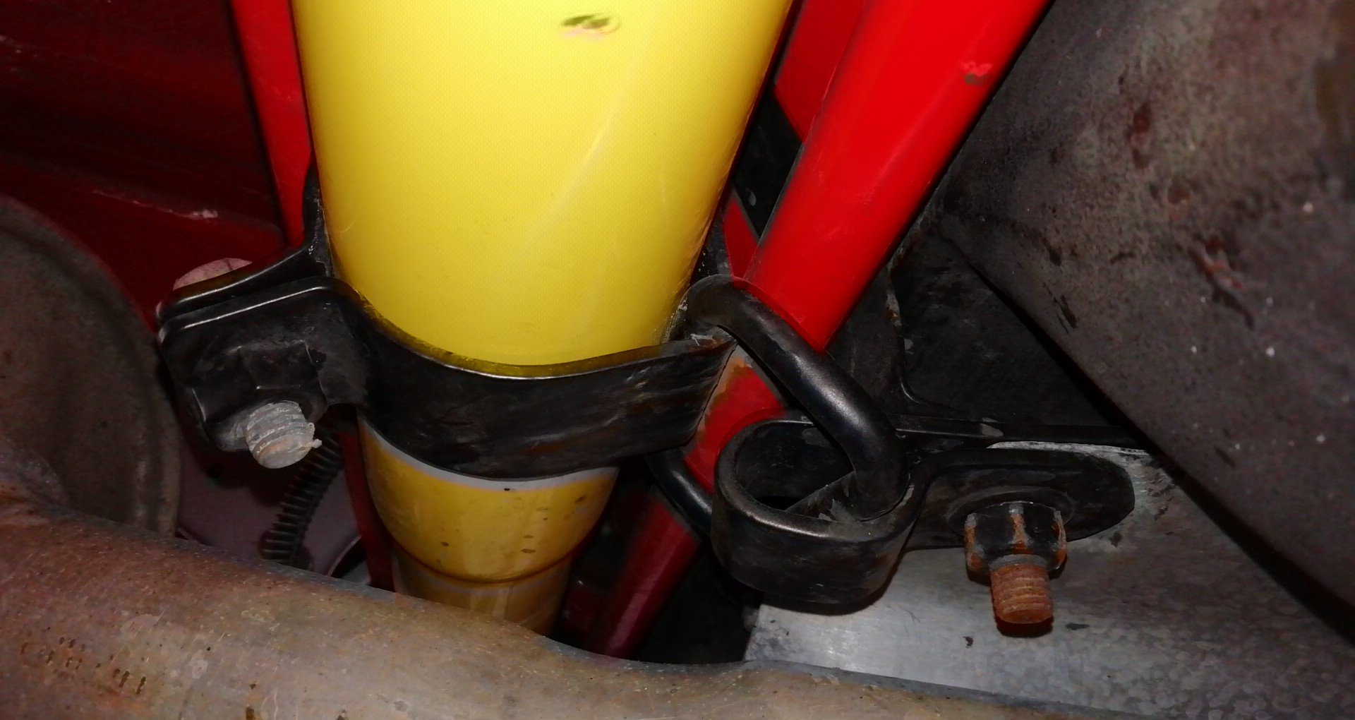

Could this be the issue? Not sure this is correct?
I'm wondering if I've fitted it the wrong way round? I'm also wondering if it really needs to be there at all!
yes that looks wrong, as the suspension compresses that torsion bar will move down, its been quite a while since looking at that area of a 205 but I would say that needs to be above the torsion bar.
or at least possibly further down?
There's no marks on the paint but I'm wondering if that's the noise I'm hearing ! Trying to find a pic online but no success so far

Yeah its upside down I've just checked the bar I removed from my car
Have you got a pic please?
I've managed to manipulate a gap but the bloody nut that connects it to the heat shield has seized so can't remove it at the mo!
series111
Sorry I'm giving you misguided information I've just looked at mrfirepro's restoration and found this pic
SootySport
Mine is the same as the photo above.  I can’t help thinking the metal loop knocks on the tank strap fold. Also wonder why there is no rubber bush to prevent a collision of the metal parts, I thought mine was missing a bush when I dismantled the beam.

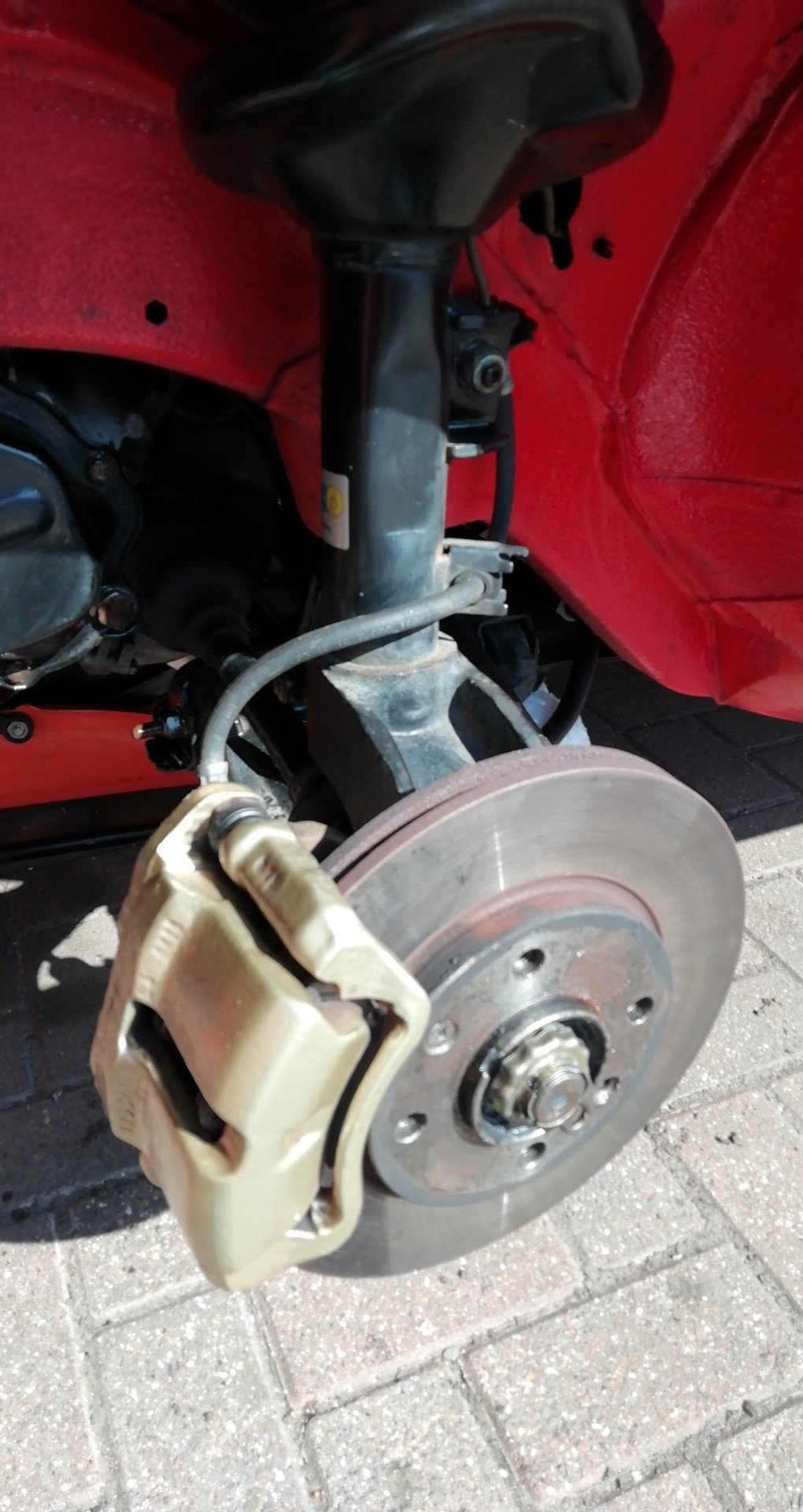

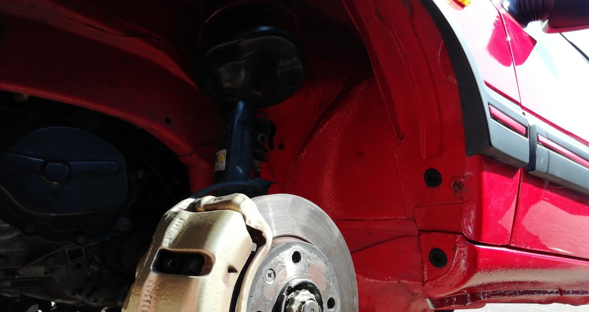

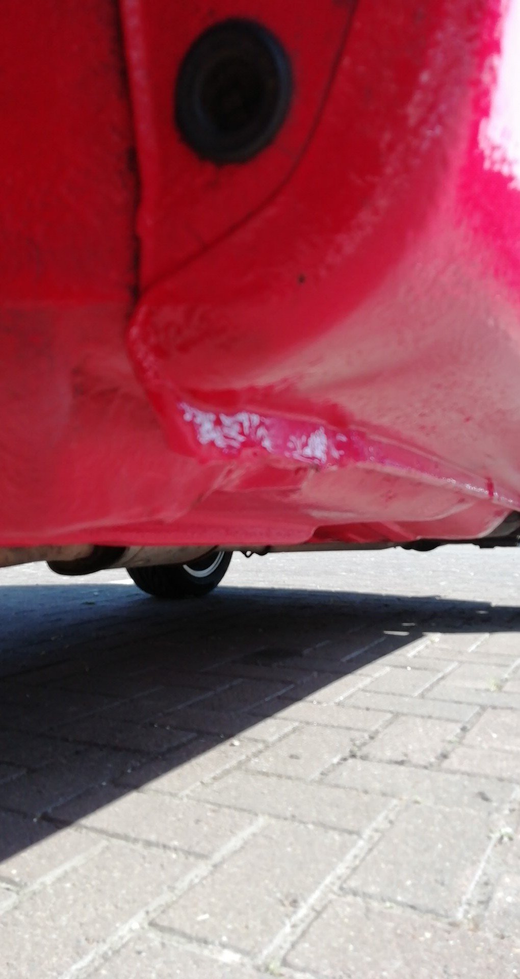

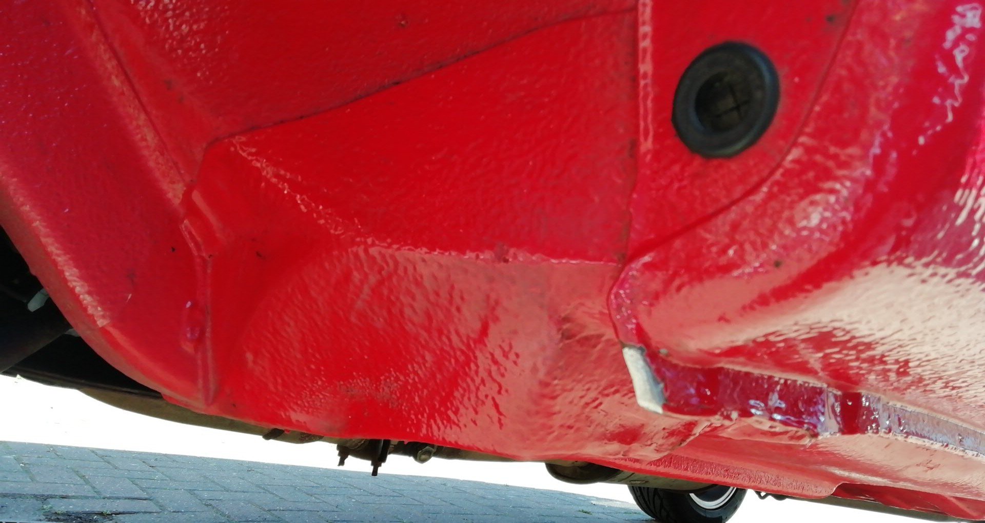

Latest job: front mud flaps removed as I struck an object dislodging the nearside anchor point and taking some paint with it so a small paint repair today. Whilst I was at it I cleaned the arch, cleaned the suspension and running gear in that side and applied a fresh coat of anti rust film spray to all the nuts bolts and threads I could get to.
It is surprising how used it all looks after 4000 or so miles
i decided that id put the car up on stands after this repair. Removed the wheels and did a through inspection of the underside. Spotted a couple of other bits that needed attention. I also gave every nut and bolt a good dousing in Oil Film which is an oil/lanolin mix, should stop any excessive build up of corrosion.
Wheels all cleaned up and a few bits adjusted.Of note the 90 degree hose that goes into the bottom of the radiator which had started rubbing on the chassis.
