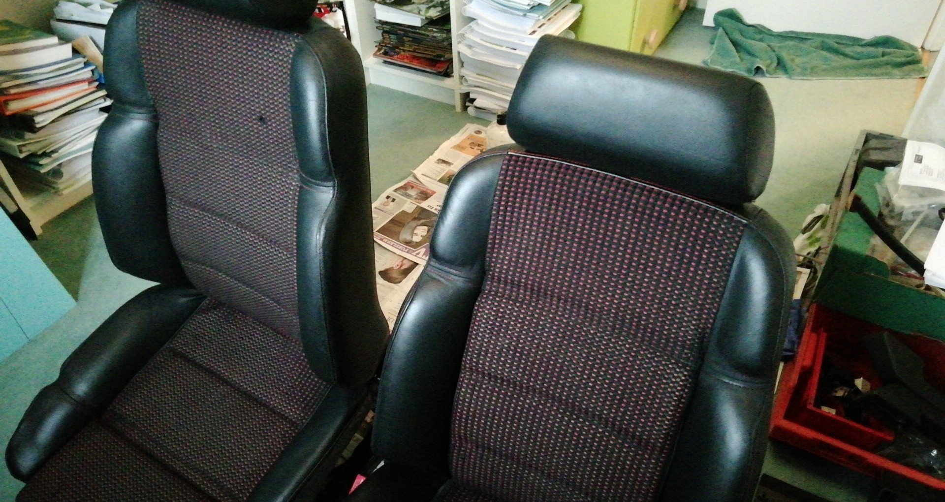

Spent an hour adding leather feed which hadnt been done. Look not too bad. Not sure I'm might just sell them!
Telf
Here what they looked like before , now that's patina!

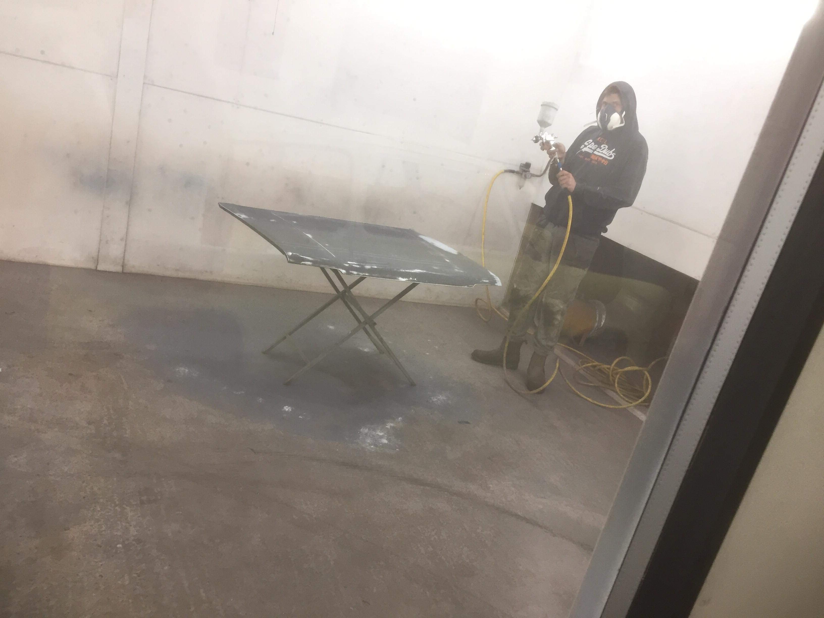

And so here we go again. Bonnet No.3 goes into epoxy..

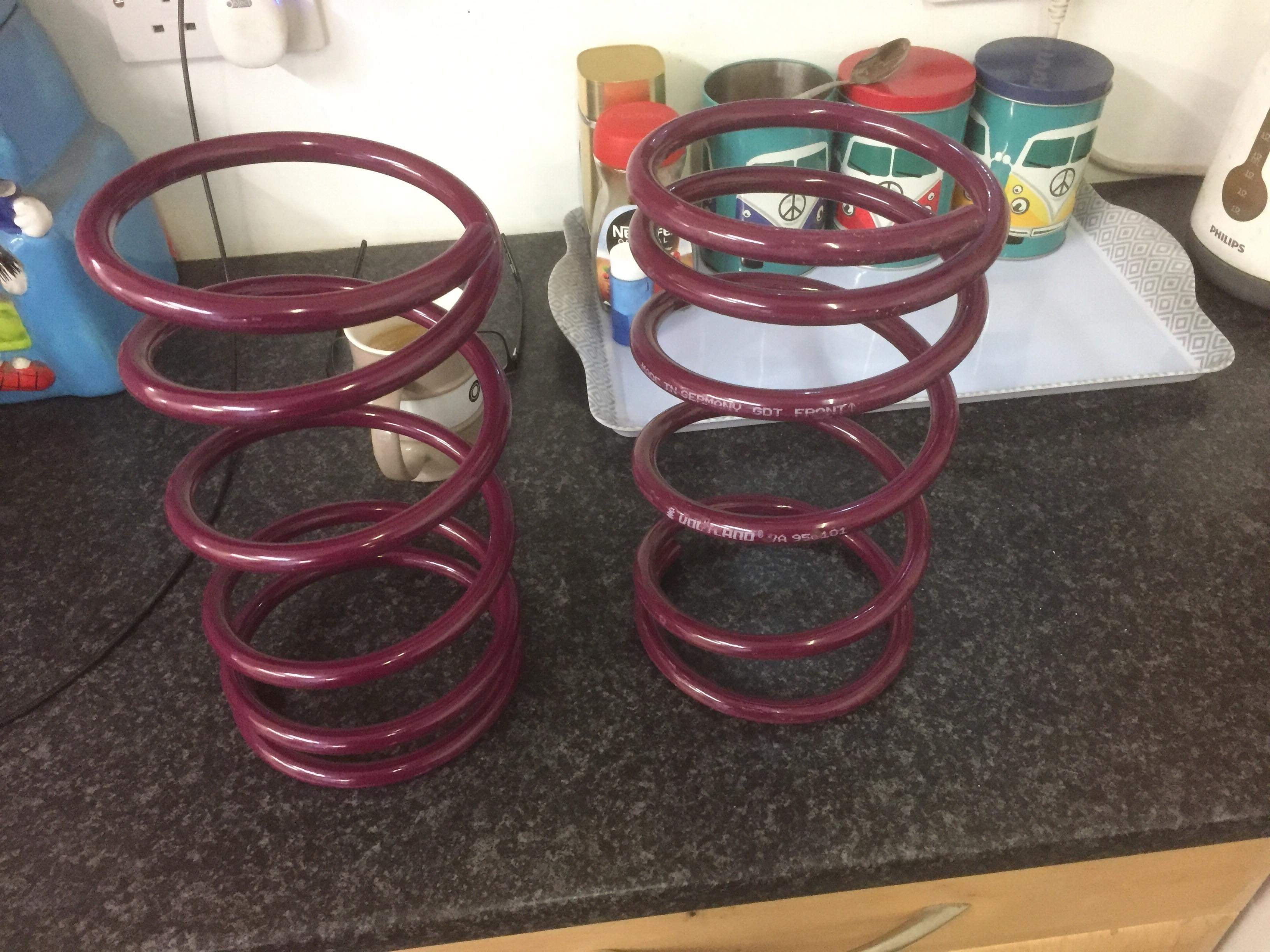

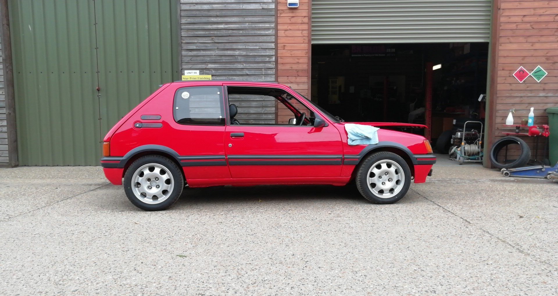

Fitted new springs today. Seems to have brought the ride height to a better level.
They are Vogtland springs.

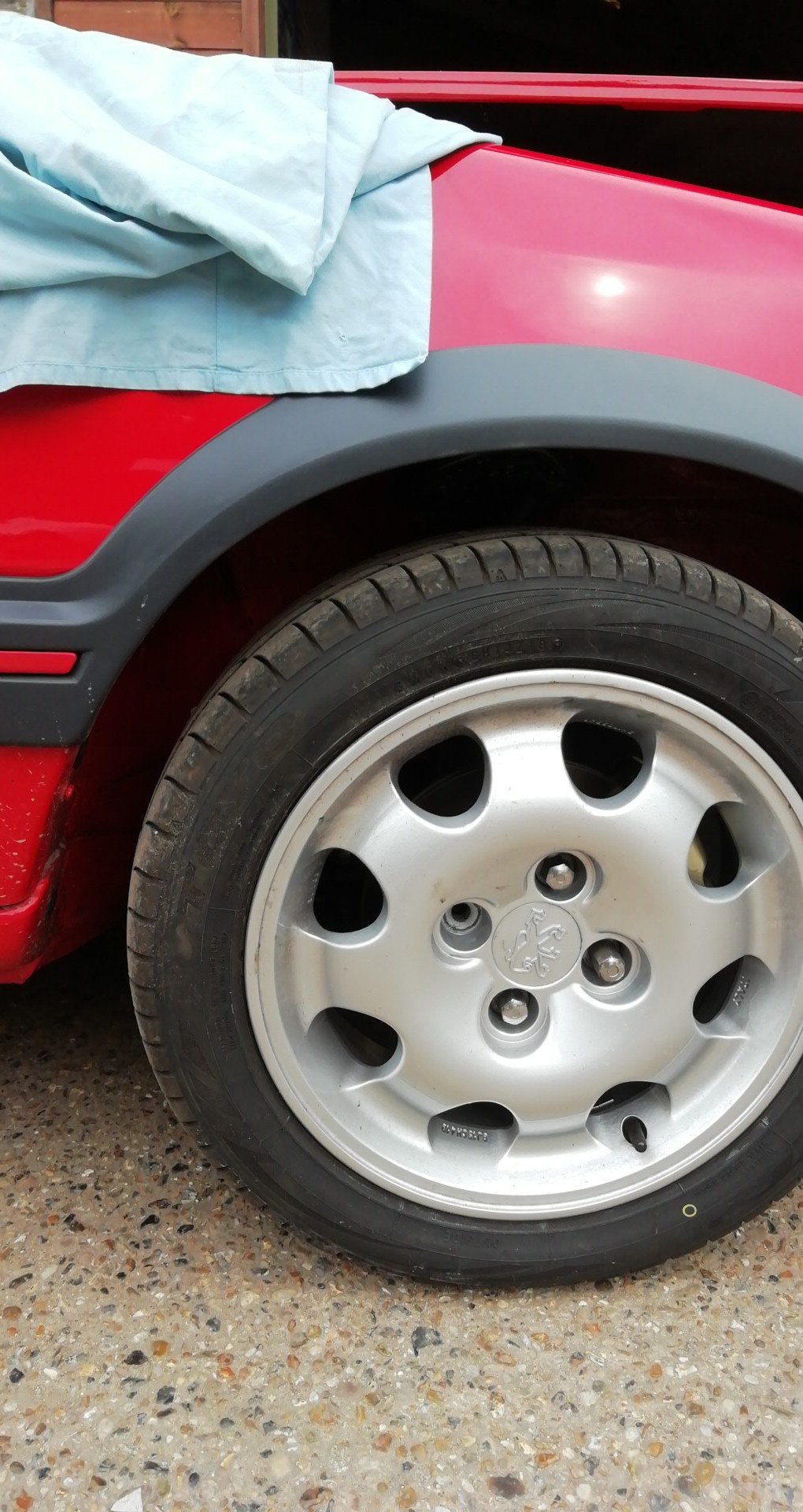

Buy new wheel bolts . Mine are stretched and have seen better days
