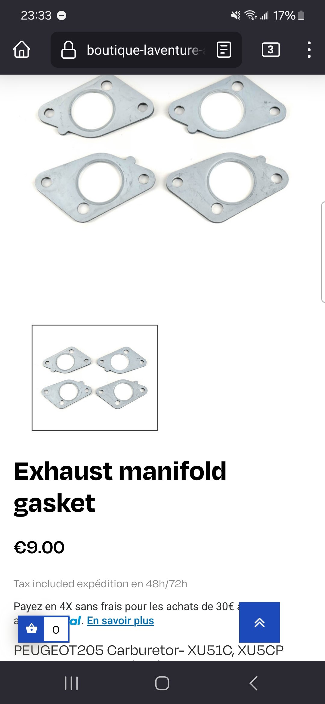

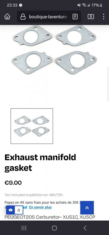

12 for a set of decent aftermarket ones, or this for oem each from peugeot.

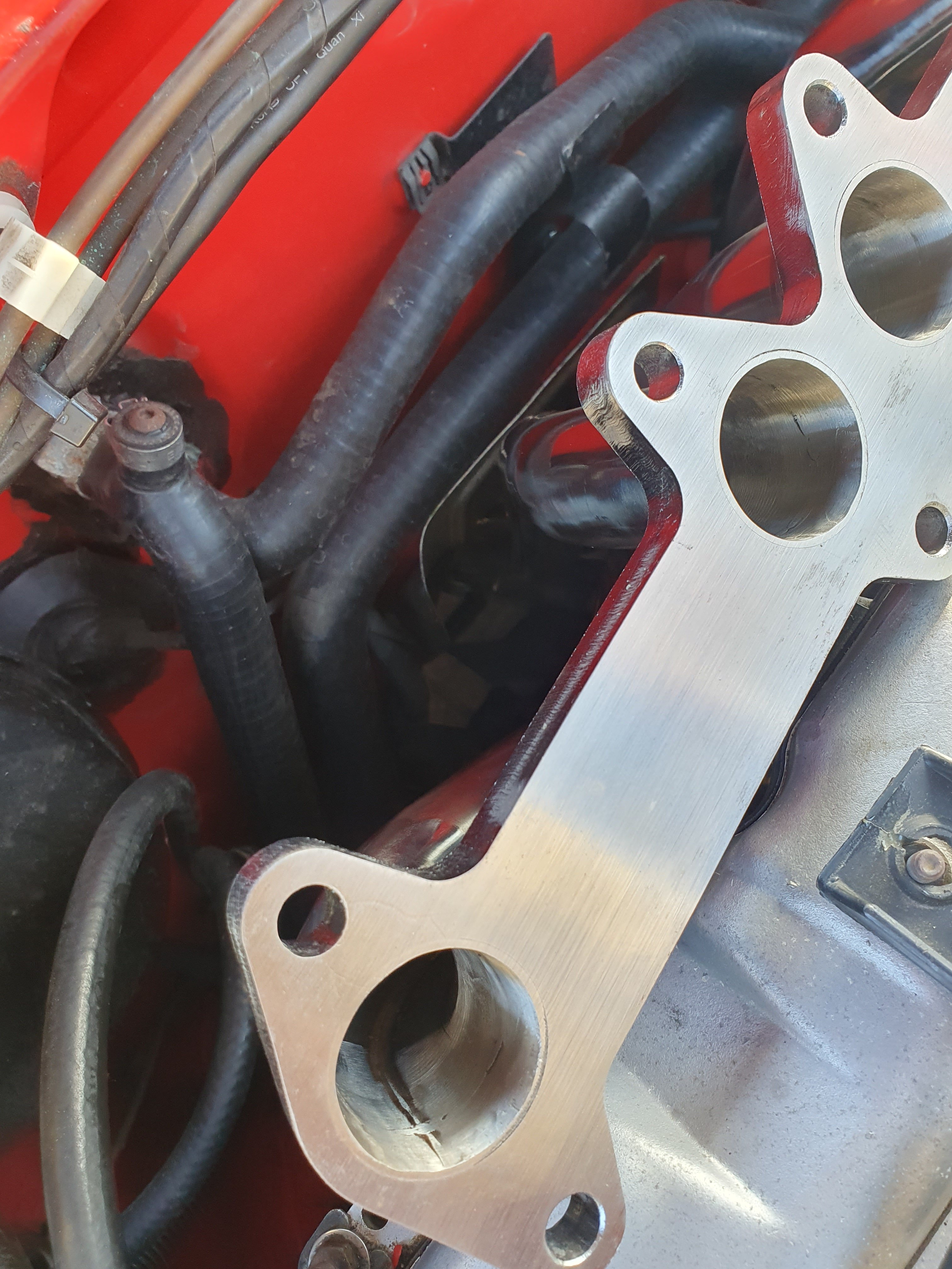

Ok, spent a couple of hours today stripping the manifold off the car. As suspected it has a crack in it. Not sure if they can be welded, i seem to think they are cast so probably not. Dunno.
Anyway I'm fitting a 4 branch stainless instead so it doesnt matter.
regarding the manifold studs, most have stayed in the head but a couple have come out with the nuts, what's everyones thoughts - should I replace them all ( i can see removing the ones still in the head being a pain in the ass tbh or just remove the stuck nuts , refit the studs and reassemble with fresh nuts?
Cheers!
Gohn
yeah if they'll come out without breaking it would be best to remove them all
replace all the studs, cover the new ones with anti-sieze, and get a set of copper nuts
but it depends how difficult they are to remove
the last thing you want is a broken stud
serie04 has the studs and copper nuts but you can probably get them way cheaper at autodoc (they wont sell to us over here)

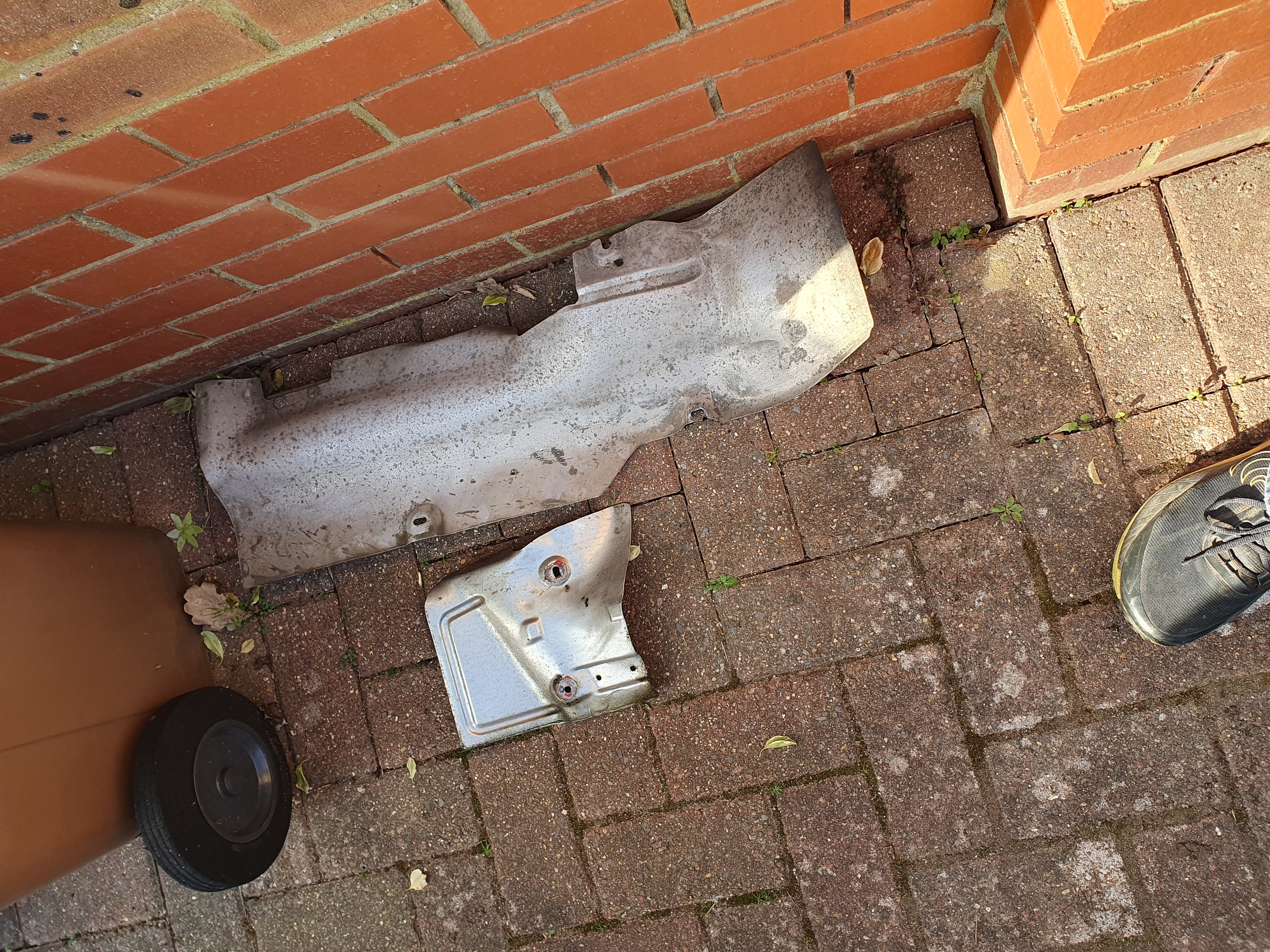

Disconnect the lower engine mount ant try to tilt the engine a bit.
Support the engine and remove the top arm, swinging the bottom around wont achieve much.
Personally I would just drop the subframe to fit that. Doesn't take all that much doing to drop it, bottom arms, track rod ends, drop links, gear linkage, steering column lower coupling, the clip on the clutch cable.
  • Thanks 1
Telf
In the end I took the heat shields off, top engine mount and just made enough room.

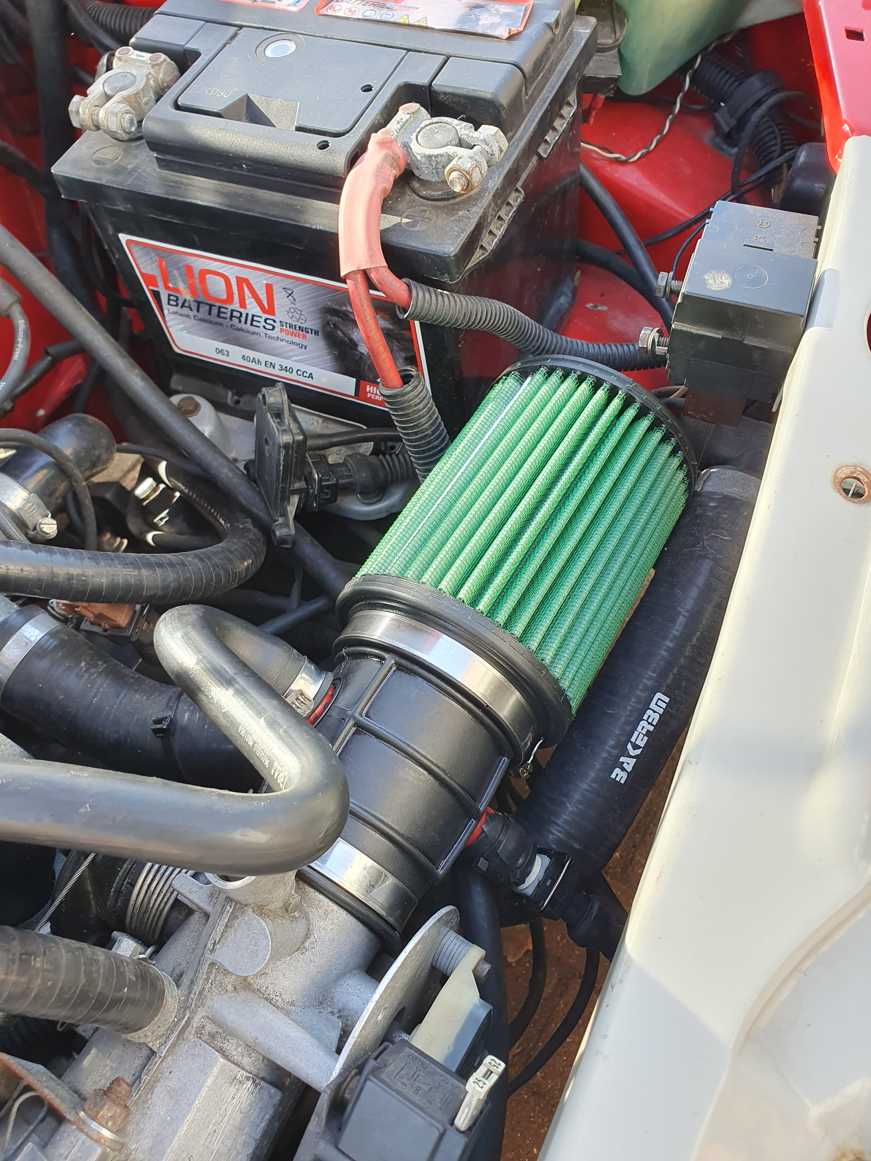

Whilst Im busy in the engine bay I've carried out a good clean and general inspection of everything.
Once again I've found the Baker BM induction hose failing. Rubber cracking around the breather connections.
I'm pretty annoyed with this, but also fed up with the faff of having an AFM, induction hoses and standard air filter fitted. I've decided to remove it all and fit a Green cotton air filter direct to the throttle body via a short adaptor hose.
The rest of the exhaust is being collected from Jackherer, I've gone for stainless , once its all back together I will take the car for a check/fine tune at Emerald.
Its actually quite nice to be doing a bit for work on it, will be nice to have it ready in a few weeks now the weather is improving.

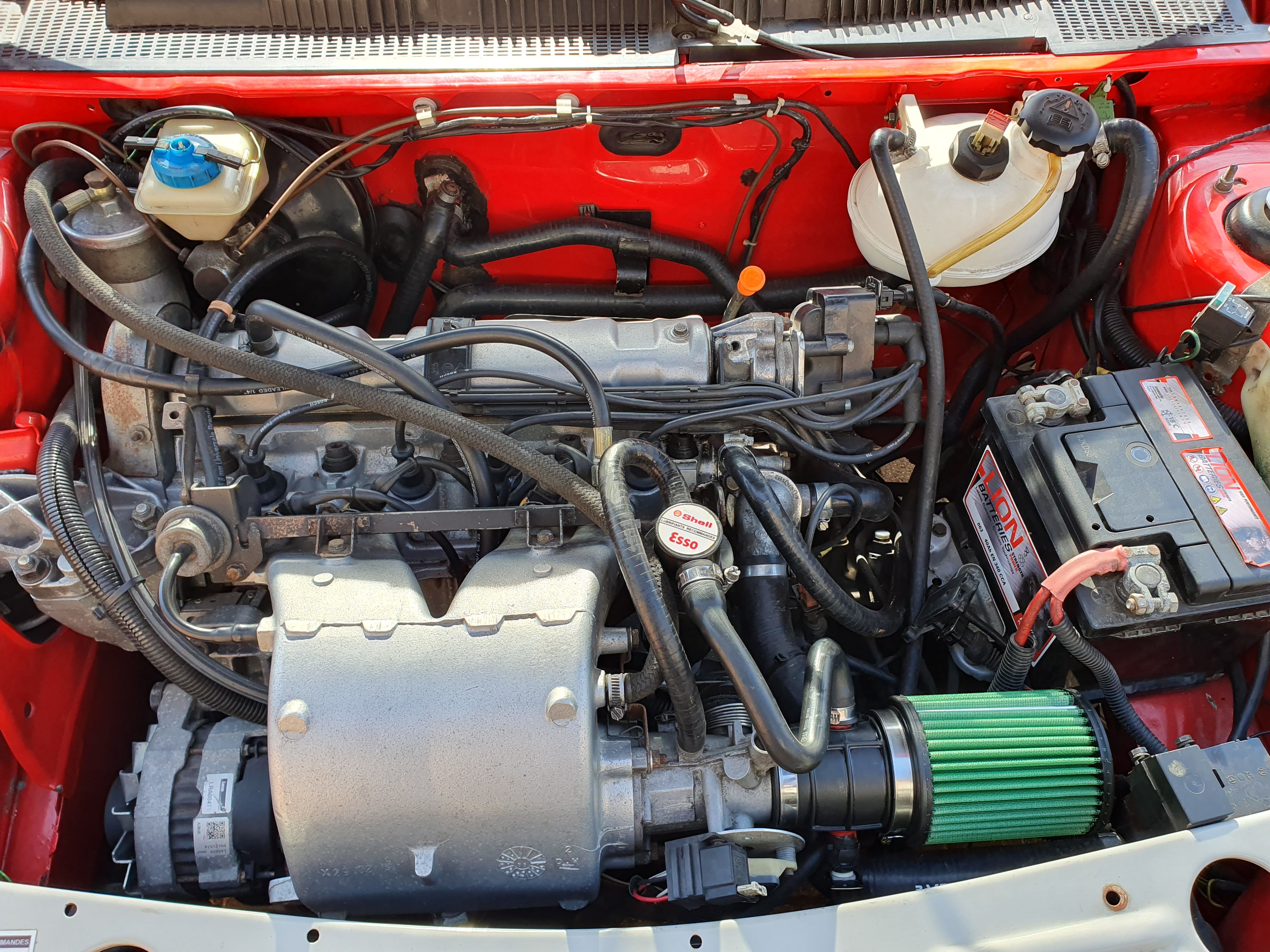

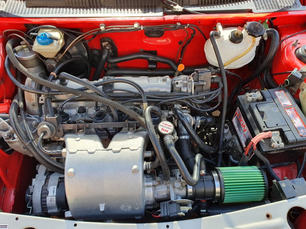

Now have all the cold air induction system replaced with this cotton green filter from France. Installed the air temp sensor in the side to keep it all tidy.
Alot less clutter in the engine bay now, much happier with it and a few kg saved I suppose.
Monday it goes off to have it exhaust sorted, then at some point I'll put it on Emeralds rolling road as it's not been on since it was built.
  • Like 2
Leslie green
It does look a lot less crampled now , I did notice when out today it sounds like mine is blowing at the manifold to downpipe join and sounds louder than id expect for a standard system , it may just need tightened up when it all beds in a bit .
