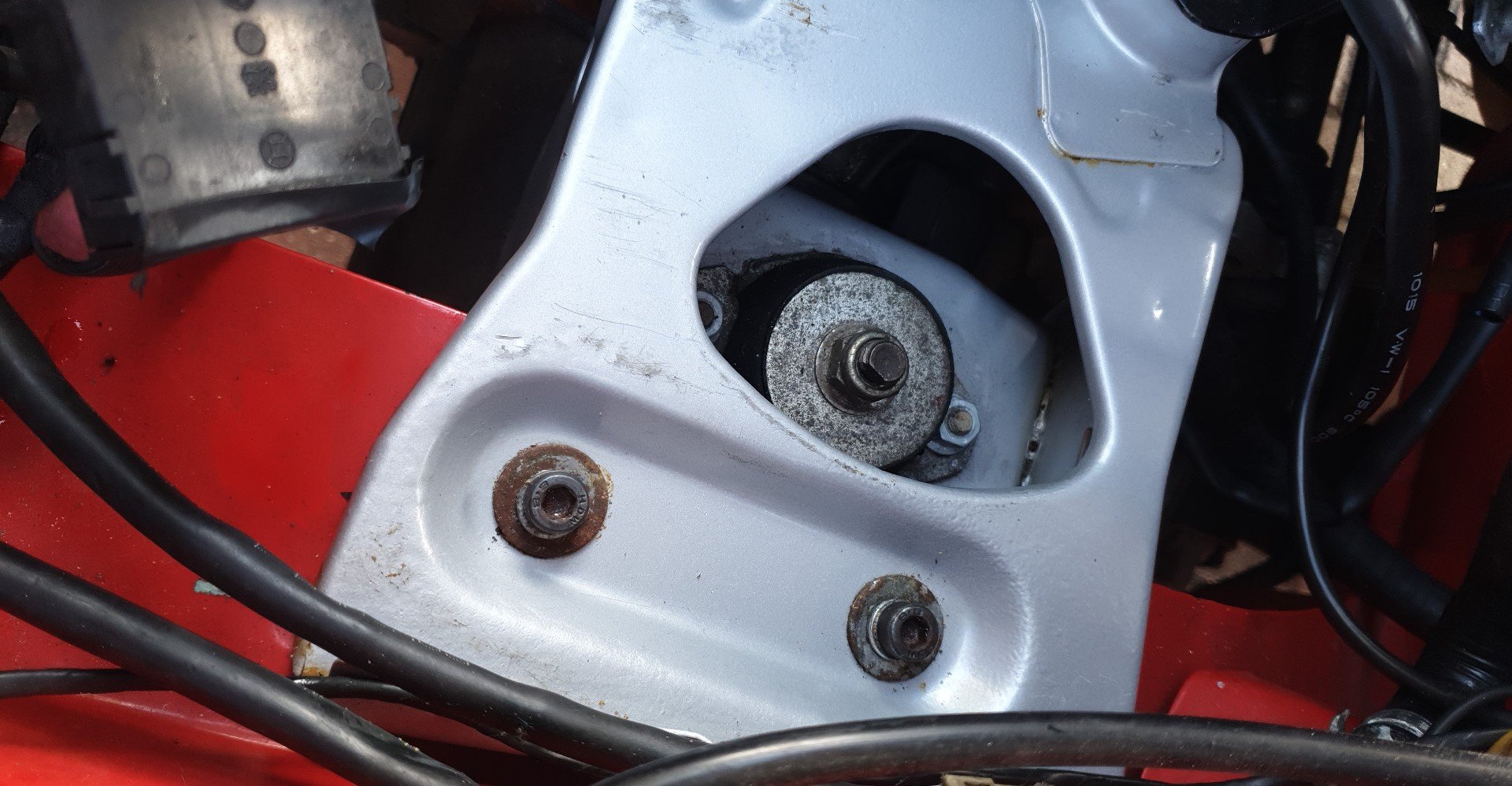

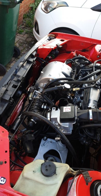

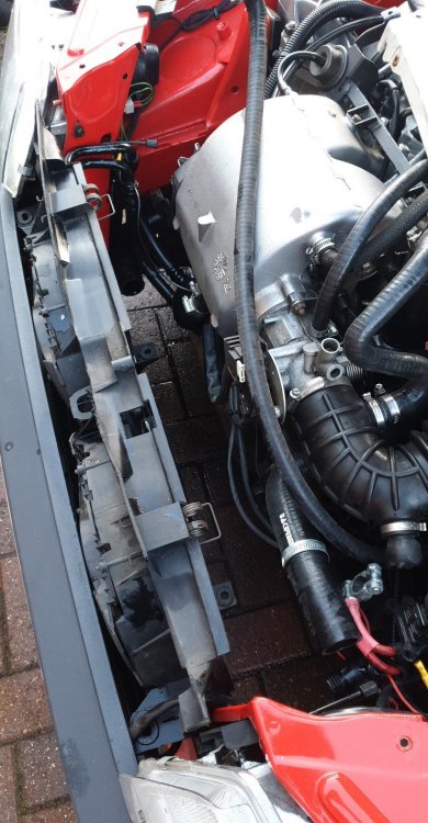

Broken radiator drain. Nissens  design won't allow the drain pipe from Baker BM to fit very easily. I snapped it when I built the car and its been needing sorting for a while, anyway its finally failed so time for a new Rad.
Be aware if using a Baker hose!
So out with the radiator and I'm taking the time to clean all the grime and road crud thats already building up.
SweetBadger
Looks like you're missing the two rubber blocks that sit on top of the radiator in-between the radiator retaining springs and the rad in those pics, unless you'd already removed them?

i am missing one!
I'm sure that I'll have one in the garage somewhere.  Drop me a PM with your address and I'll dig out and pop you one in the post FOC if you need one.
