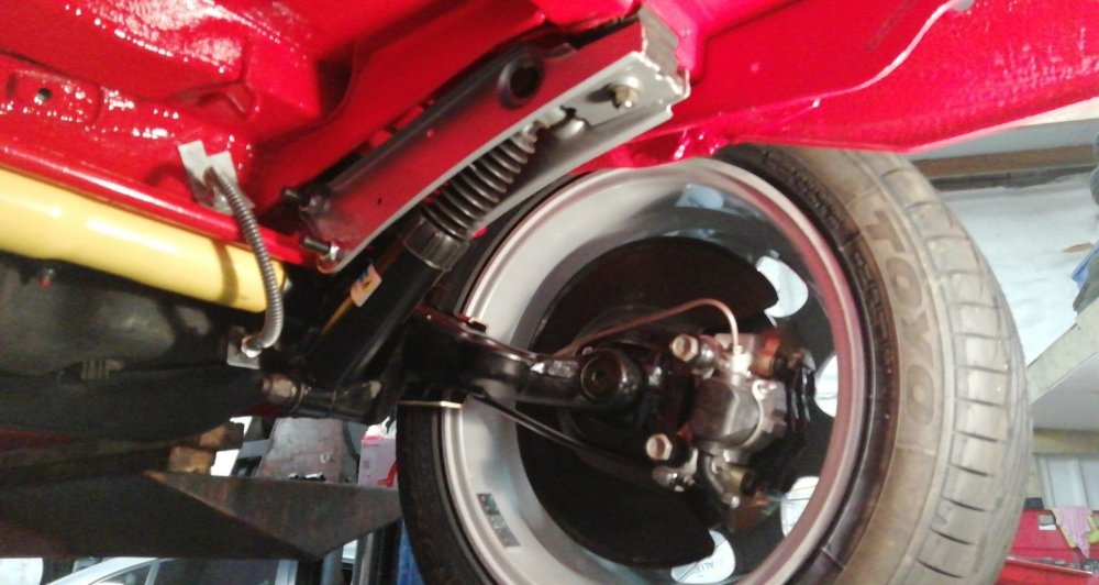

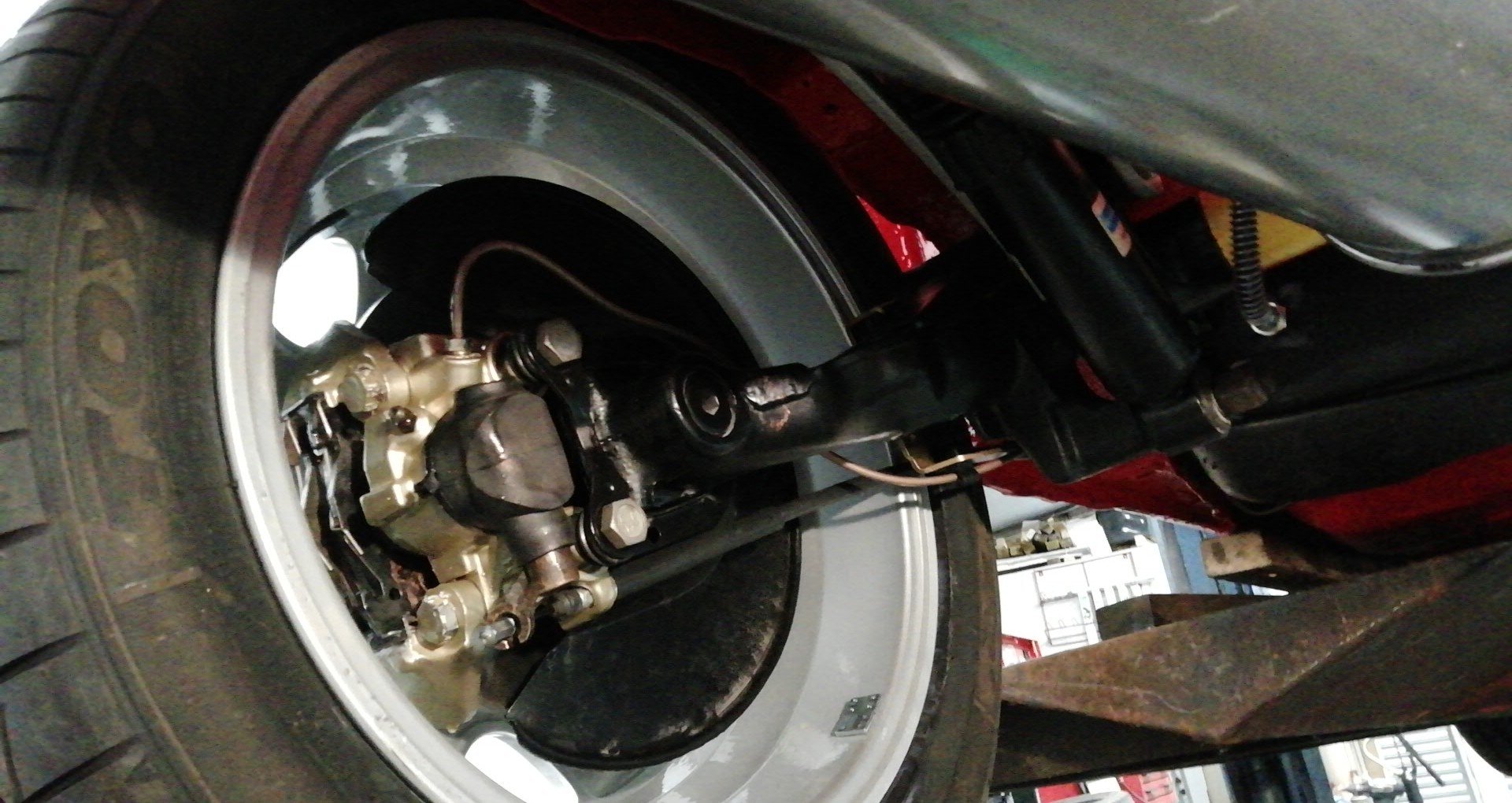

Yeah the Flexi is still fitted
Richie-Van-GTi
I've read it as one side has a flexo and the other side doesn't. The side that doesn't will fatigue with use and break. Never seen a factory car without a flexi.
No Peugeots or Citroens with that style of rear calipers made after 1994 had that flexi from what I understand.
It's only the last one we are talking about that goes into the caliper itself, Paul has the flexi that goes round the beam fitted on both sides.
As Kieran says I've got Flexi hoses round the beam but solids from then on. I haven't fitted the flexi at the caliper

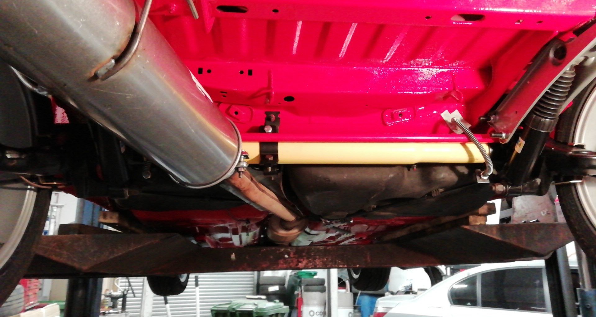

Fairly busy day today.

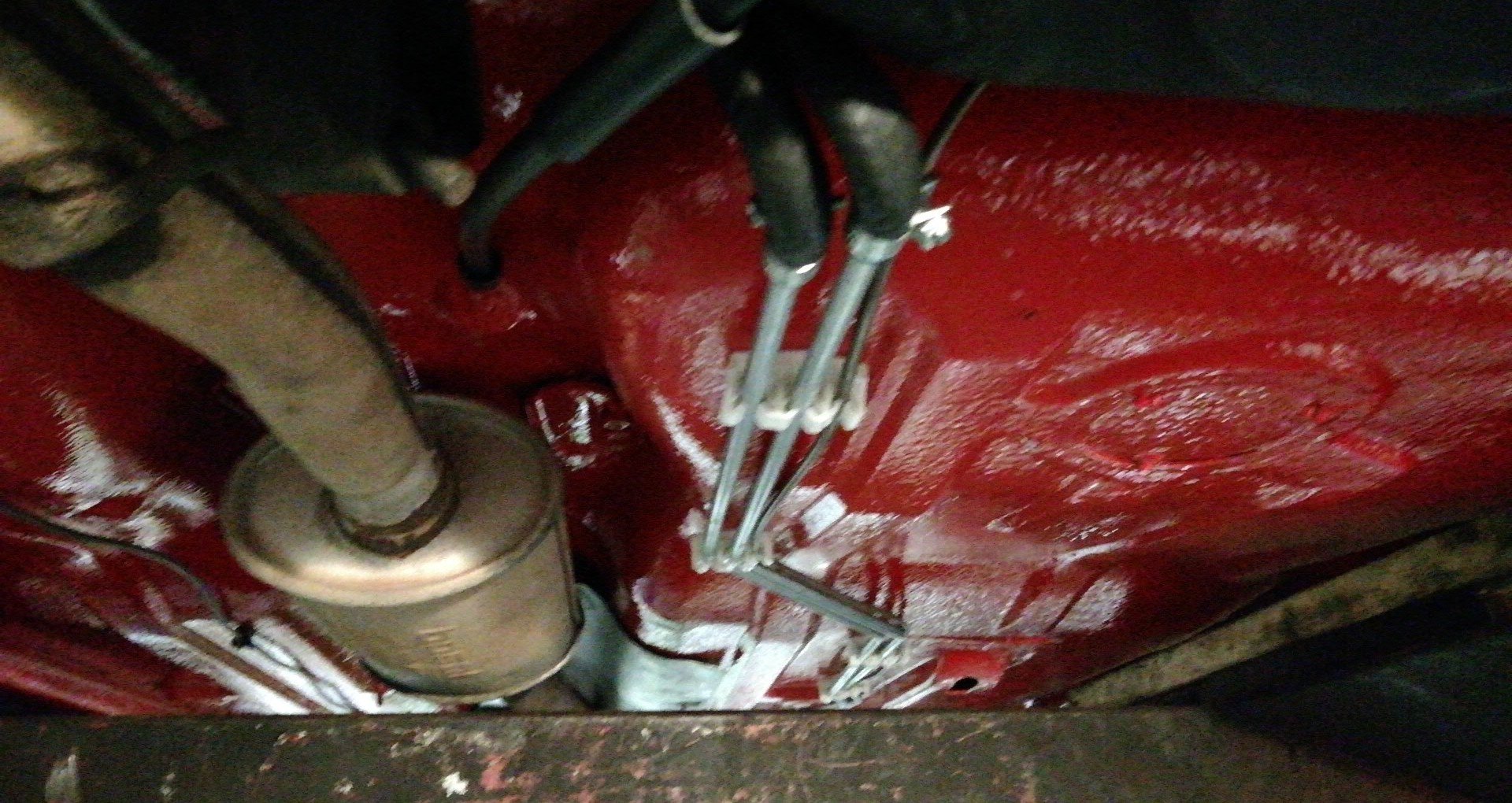

Brakes completed and bled. Underside now fully complete after fitment of the tank strap.

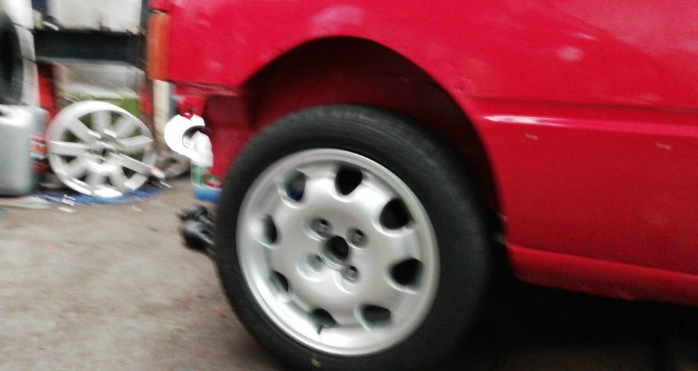

Wheels arrived and fitted and the exhaust also fitted.
Mechanically just the driveshafts to fit but I ran out of time.

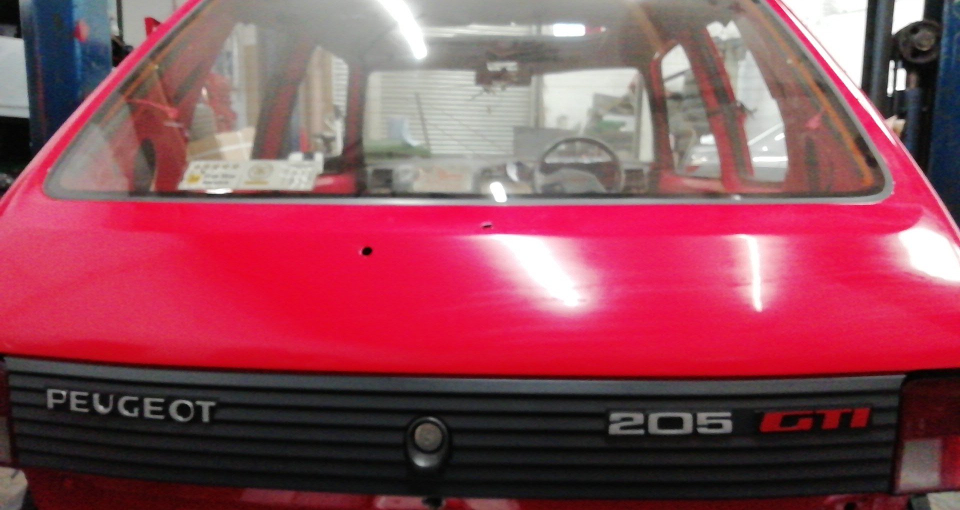

With the car back on its proper wheels for the first time I'm wondering about the ride height at the rear-opinions please- I am after a standard look not lowered. I think it's about right?

I still think it's too high, the line where the top of the bumper meets the rear quarter and tail light should be roughly in line with the top of the tyre.
Kieran I got level and took another pic, I reckon it's about right by your description

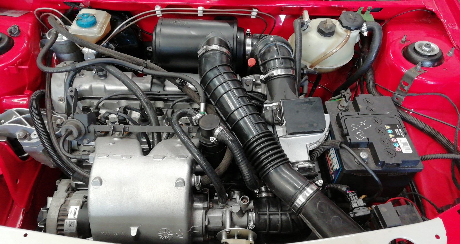

Engine bay pretty much complete. Much messing around trying to make sure nothing rubs,chaffs gets burnt on the block or exhaust or leaks.Think it's about right. 100% certain it's not as per the factory but it's good enough
Edited by Telf
Looks good mate, I'm sure it'll be fine on the rollers. Just take loads of cable ties...

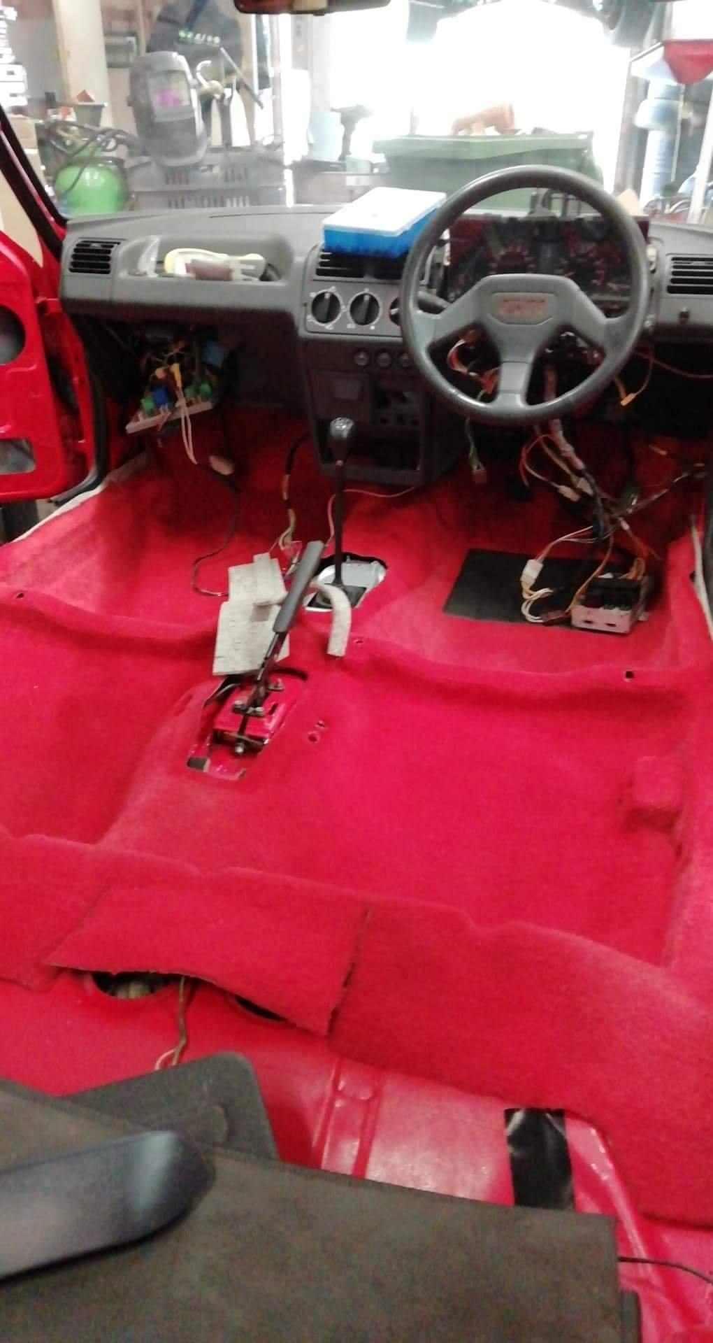

Underlay from Newton commercialin Lieston. Pretty decent for £60

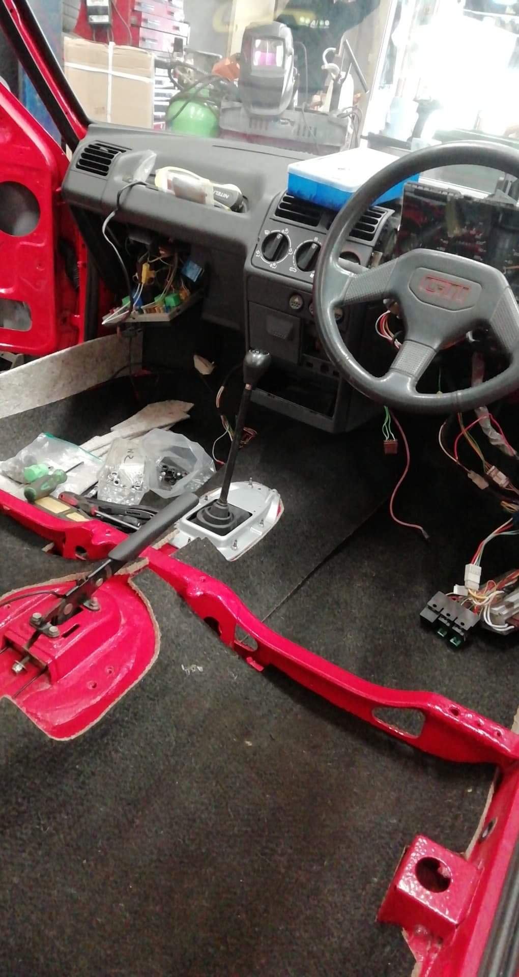

And carpet back in along with most of the dash built

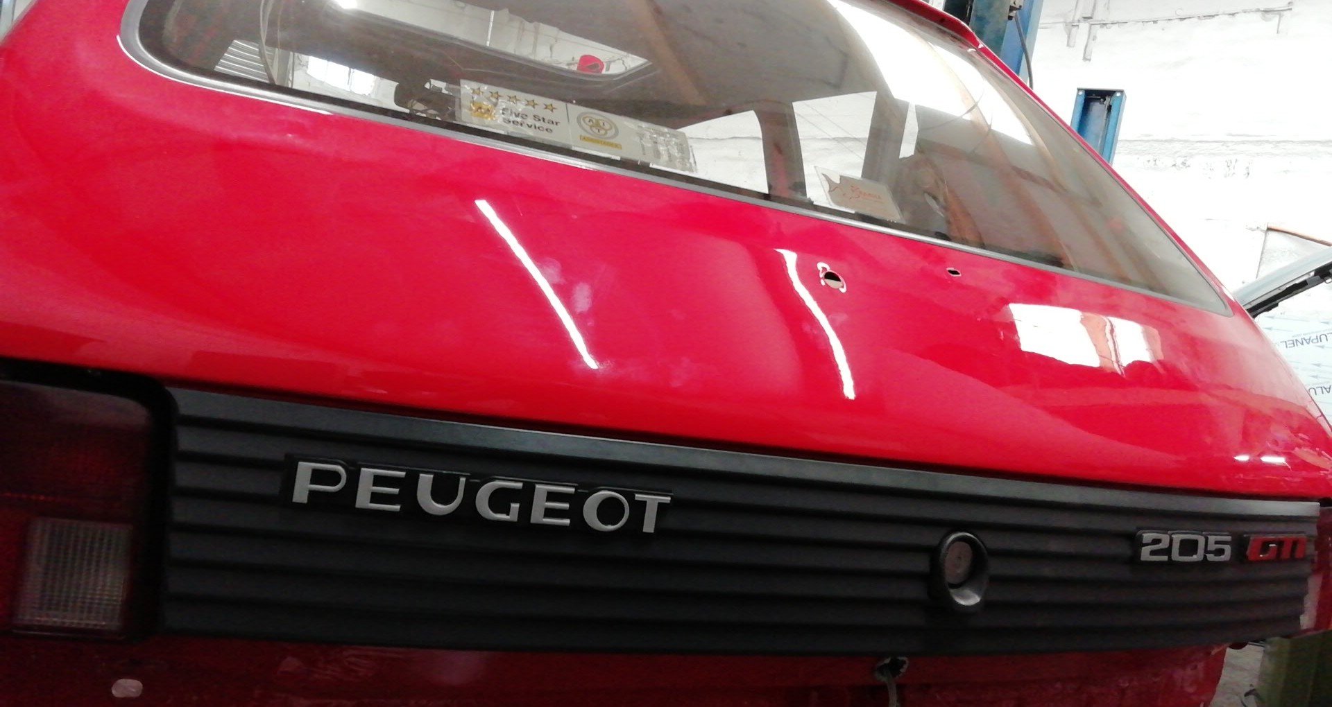

It looks very good with the trim and bumpers etc. fitted. What is the ride height like now?
the rear I think is ok but the front is too high- I dunno if it will settle once its has some cornering action or not?
I think the grey plastic paint has worked pretty well- and the red trim from pug museum helps a lot !!
Front settling is minimal in my experience, a few mm max.
