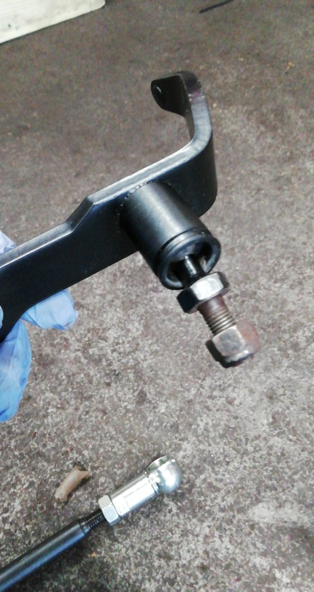

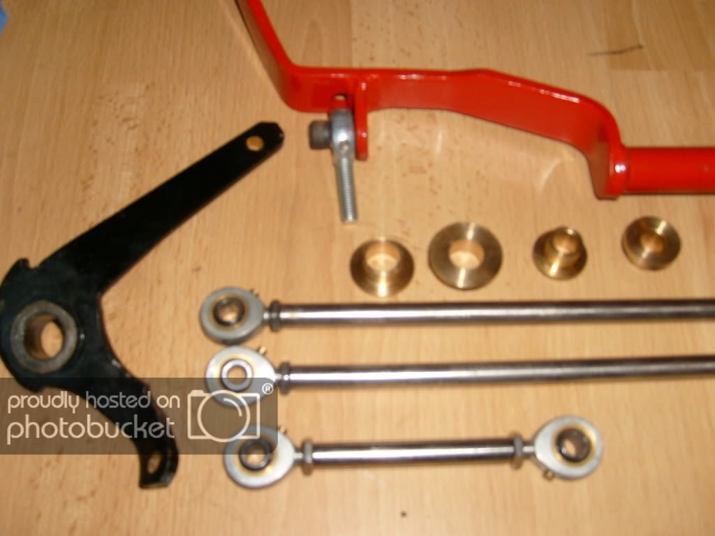

That's one way and does work well, I've done it myself, but seems a shame to start welding and grinding your nice powdercoated rod. I'm sure when this cropped up recently Farmer said he had some replacement nylon cups? Worth asking him anyway.
  • Thanks 1
farmer
Ones in the post box now for him
  • Thanks 1
Gear rod fixed with nylon insert
And the build continues.. most of the electrics installed, doors 70% built and lights fitted . Probably some fettling to get them nicely aligned but still fitted.
In that case you now need the pin to hold it in place.
Won't any thin pin do the trick?
Possibly but they are very prone to coming loose at the best of times so I'd use the correct part. I may have one but it's going to be hard to find...
You really need a new nyloc nut on it too.
its an R clip not a pin.
definitely use a fresh Nyloc as well as some decent washers top and bottom.

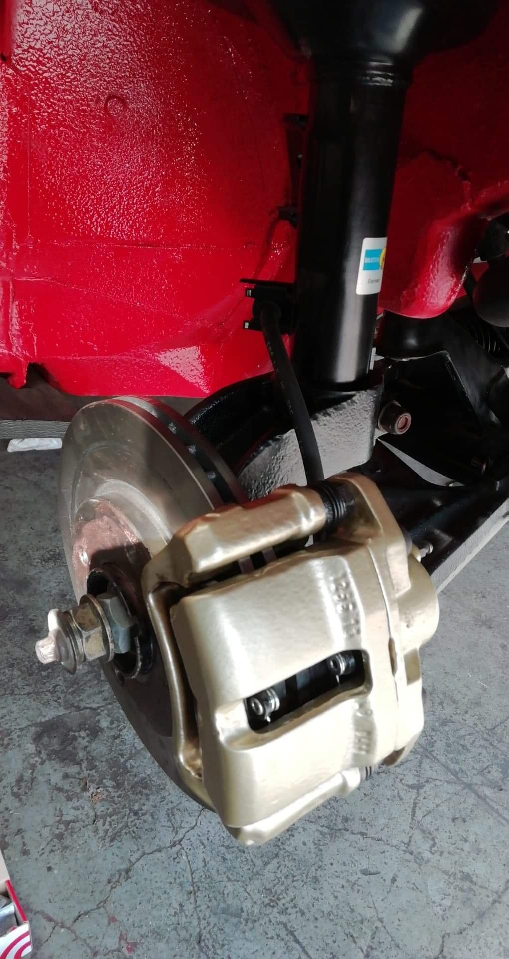

Apart from starting the car the other news from the build is

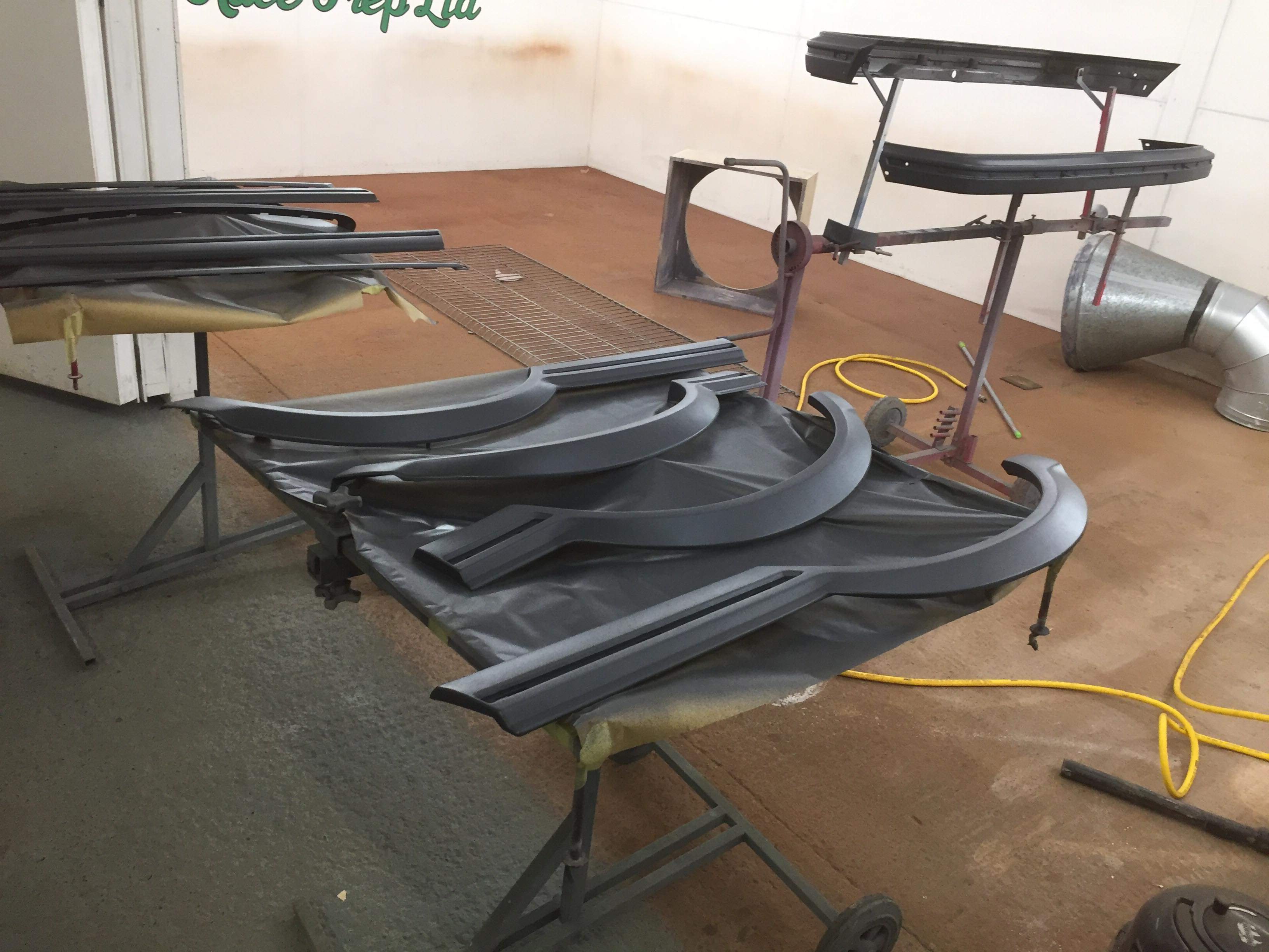

Front brakes finished and plastics painted.
I noticed the plastics are available from the Peugeot museum but at £808 for a set it's asking alot at this stage. So I'll see if this plastic paint works ..
Also bought a new set of red strips for the trim.

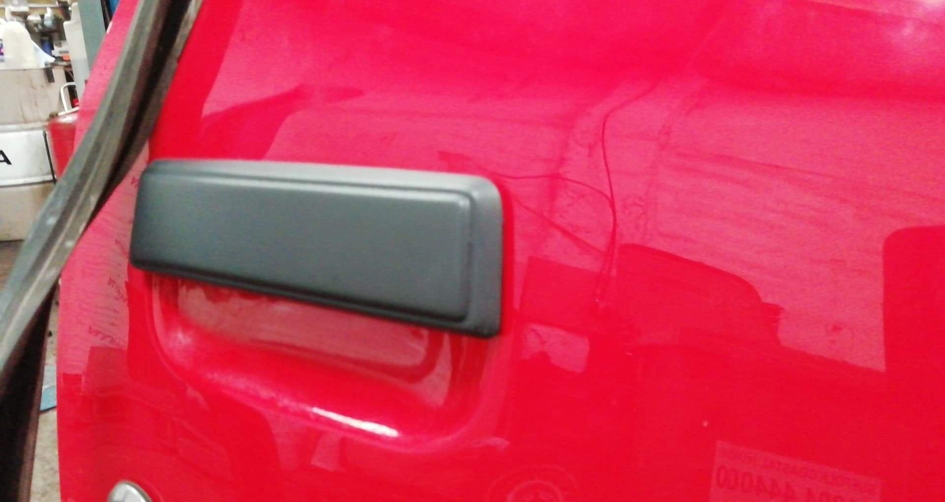

Painted the handles with plastic paint. Came up quite nice. I had a hell of a time fitting these. Tried to insert them from the back ... It turns out they fit from the outside.. who knew!
Callum
What colour have you done yours? I painted mine black because it thought it looked better but having second thoughts now, I used upol plastx
It's anthracite. I had it colour matched to a new rear boot panel that I bought from the Peugeot museum

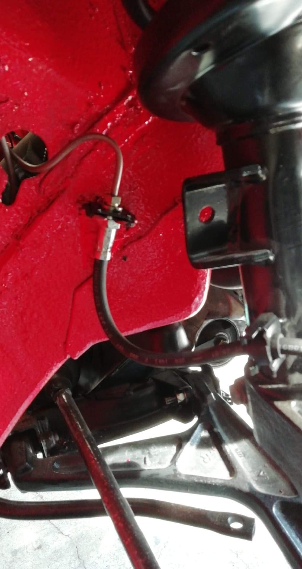

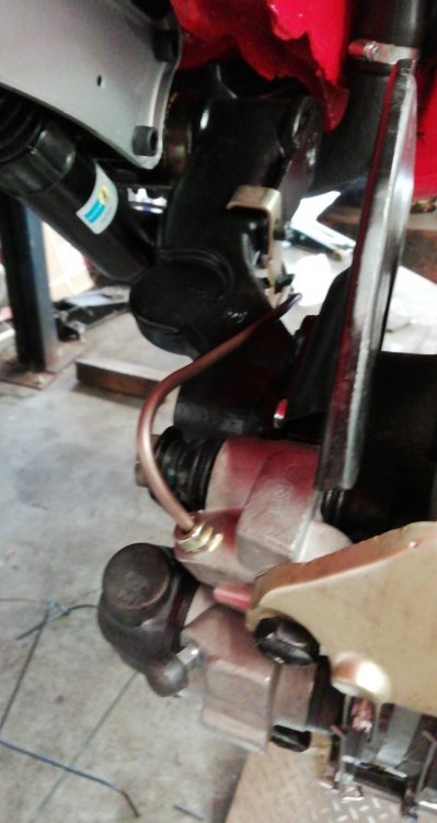

It definitely won't be a show queen.  Set about the rear brakes today. Ideally I would have put all the pipes in before the rear beam but I was missing some of the brackets. I couldn't face dropping the beam and cracked on.
Anyway fitting the home made bracket between the top of the Flexi and the hose from the compensator probed to be a total pig. I've now completed one side and elected to use a rigid line right up to the caliper as can be seen in the photo.  I'm a little concerned if this is ok as the caliper does move left to right on the sliders .
As far as I can tell other folk have done this and had no problems
Edited by Telf

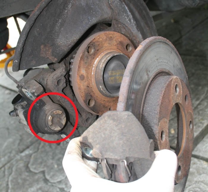

It's how Peugeot did it on later models.
This is a 306 GTI6, you can just about see the original factory pipe:
  • Thanks 1
