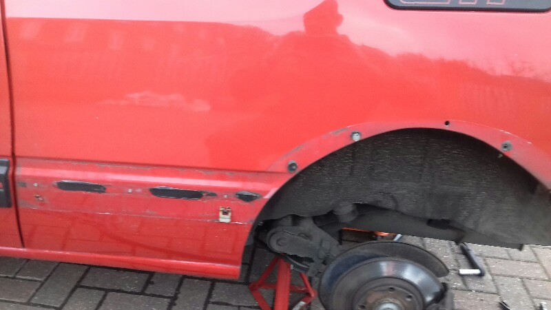

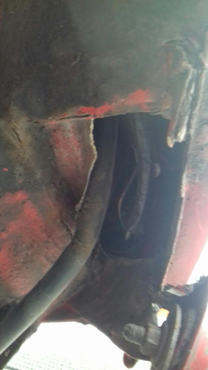

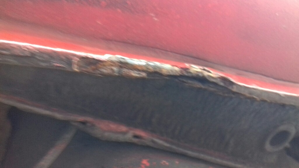

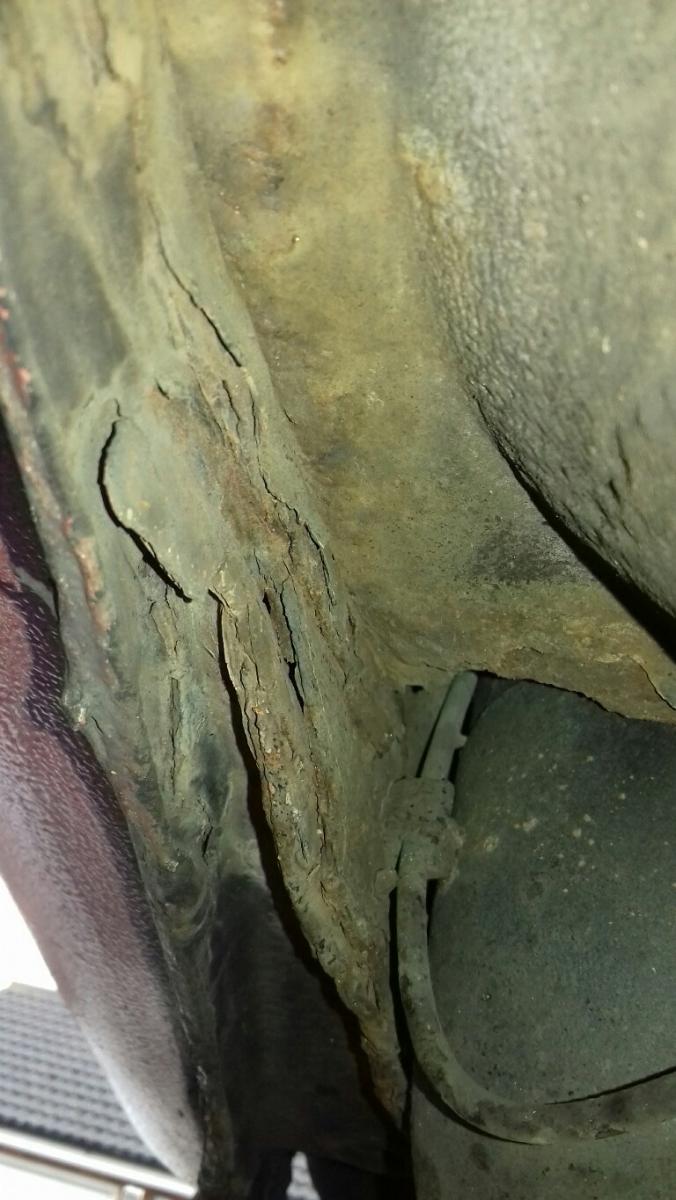

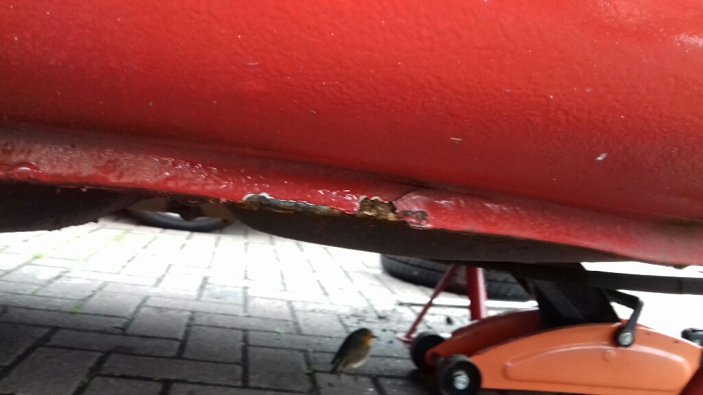

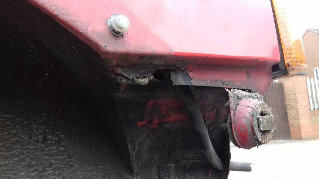

A selection of the issues.Mainly concentrated around the rear end.

As you can see its along the bottom of the sills, the bumper racket panel and in the area of the corner of the fuel tank area... I'm thinking if I can get the tank out and clean everything up then my local body shop can do the rest.
They seem to think it might be time to remove the sills, do the inners and fit new outers. He charges £30 per hour but I'm not really sure how much its likely to cost.

That doesn't look too bad - I was expecting far worse if I'm honest from your earlier posts!
The rear bumper mounts are a common rust point these days and Skyquake on here does a nice repair piece quite cheaply.
Edit: Just seen the later picture - the bumper mount area looks to have spread beyond where the repair panel covers, although still hardly a show stopper.

Skyquake has supplied a pair of panels. I honestly don't know what to do about the sills etc. The rust on the tank corners bothers me- its beyond my ability to repair but on the other hand I'm not sure how bad it really is as far as a proper body shop repairing it is concerned. They have initially quoted in the region of £1000.( to replace the outer sills and repair any inner damage, sort the bumper panels and investigate the leaky footwells)
