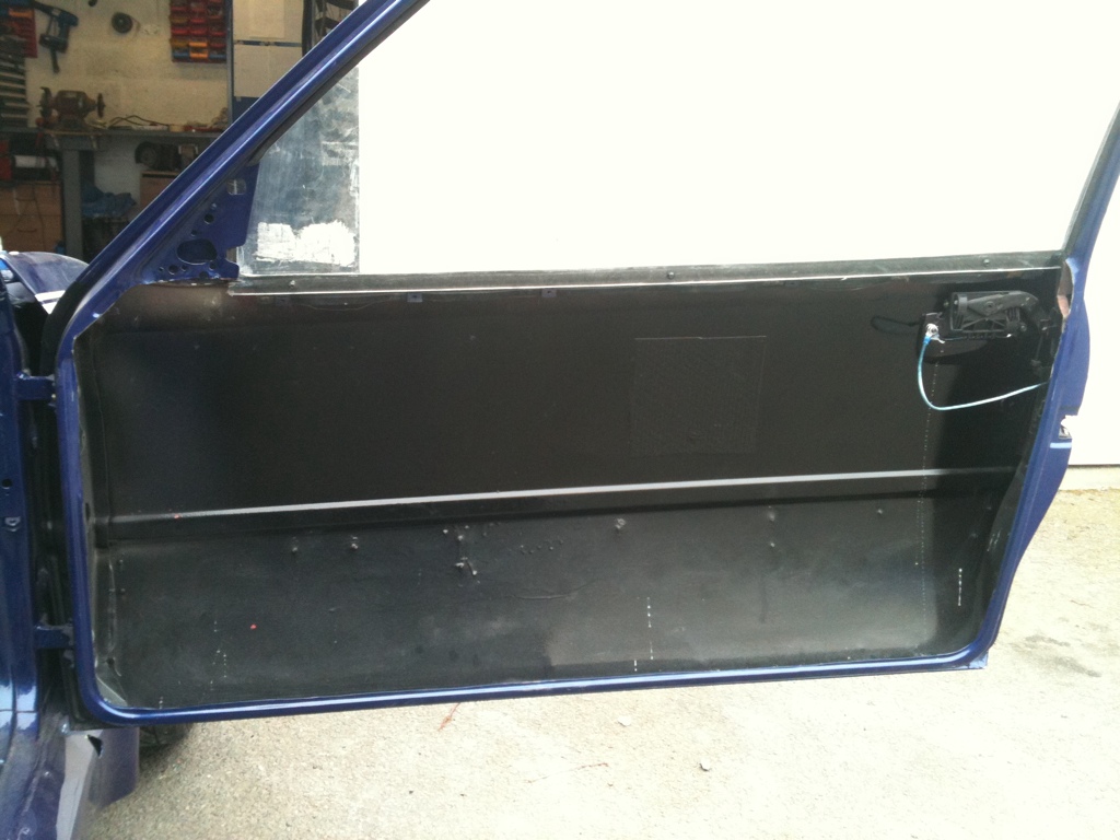

I have just got the grinder to the doors and really suprisingly to me i managed to hack off another 2kg per door and still retain its strength, a little more flimsy but as long as you dont start swinging on the door then happy days. Here's a pic, i had gutted out the centre panel already but left the top panel in which sandwich'd then window in, this has now gone as you can see, weighed the parts that came off and they weighed in at 2kg, reckon i i can another 1/2kg with a few lighetning holes in chosen places.
I have also look at taking more from my boot lid inside, all in all i reckon i shaved of 10kg which is great!!
DO YOU LIKE MY INTERIOR DOOR HANDLE, the blue bit of wire, does the job perfectly and looks neat.

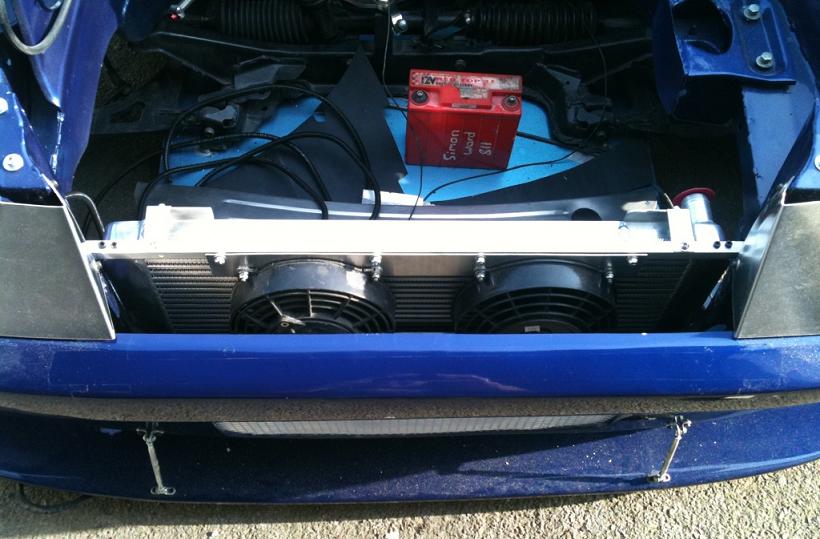

A few more pics of the latest works:

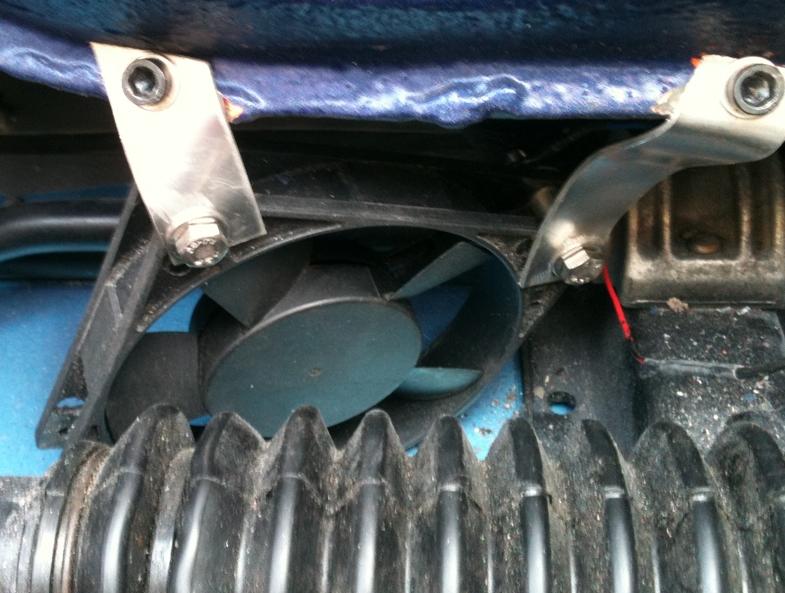

> Rad Cooling Fans now fitted and tested
> Exhaust Tunnel Cooling Fans now fitted and tested
> 6 point Harnesses now fitted

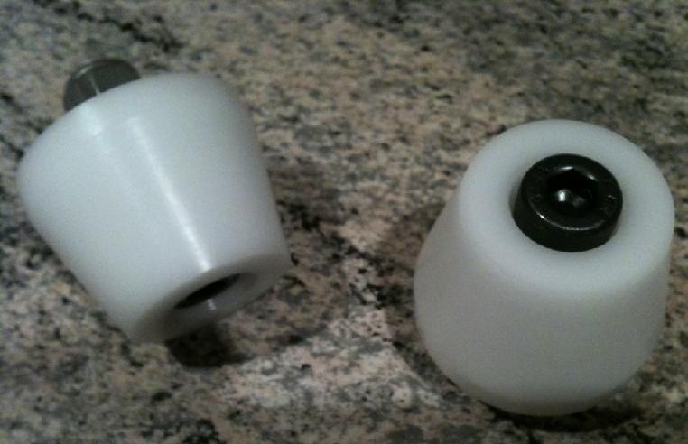

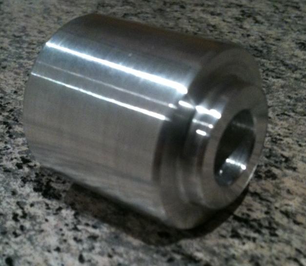

> Bottom engine mount arm solid bush made (thanks Colin)
> Top mount solid bushes (again thanks to Colin)

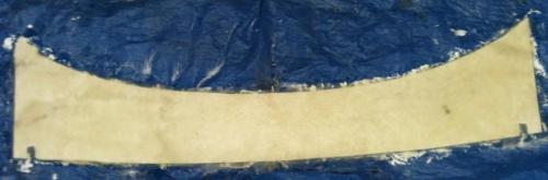

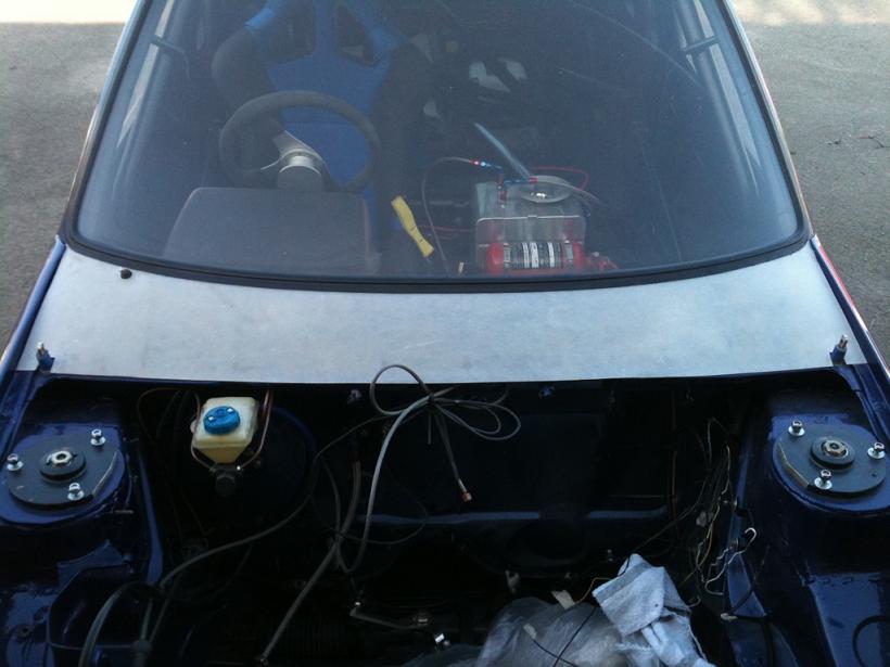

I have also cut and test fitted a GRP scuttle panel and it looked great and was very easy to fit however it wasnt quite long enough and didnt reach either side so i have added bits on and now have a perfectly fitted template but have run out of GRP sheet big enough so need to source an alternative.
wardy18
Scuttle panel in the making, i can re-produce these if anyone wants one but ill gets some pics up of it fitted first.

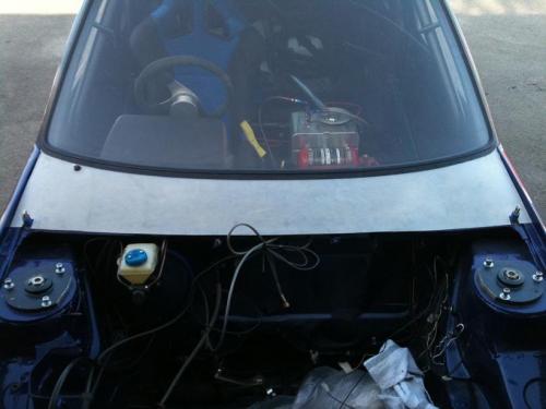

Very happy with my latest GRP piece i have just pulled from the new mold i made and fitted, my new Scuttle Panel, fits perfect so my measurements worked out great and i am so so happy to loose that old piece of plastic crap.
Even though the old piece was very light this new scuttle panel is easy half the weight, rather flimsy as i only made it from one ply fibreglass and no Gel Coat but its only a decorative piece so works perfect.
What do you think? (many more pics of it in my photobucket account, click my signature)

Looks good to me!
EdCherry
Looks the tits to me too. Like cameron said interested in making a couple cause id take one in either carbon/black gel coat.
I guess you've got a Roof scoop now you've blocked off the fresh air intake to the cabin?
wardy18
Yeh i can make some up, do you have your bonnet pins in the same position, its just the mould i have has these cut out already
Nah one of my goals in this was to cover over that gaping hole under the scuttle panel so atleast no water can come in now also its a racer not a road car so it has no door rubbers at all letting in alot of air around the frame and also the hole in the drivers window, think roof scoops dont look so good on hatchbacks!!
Am tempted to wire in a little elec fan inside to circulate air, pointing partially over me and onto the windscreen to de-mist if needed.
PM Me if interested in a scuttle panel.
