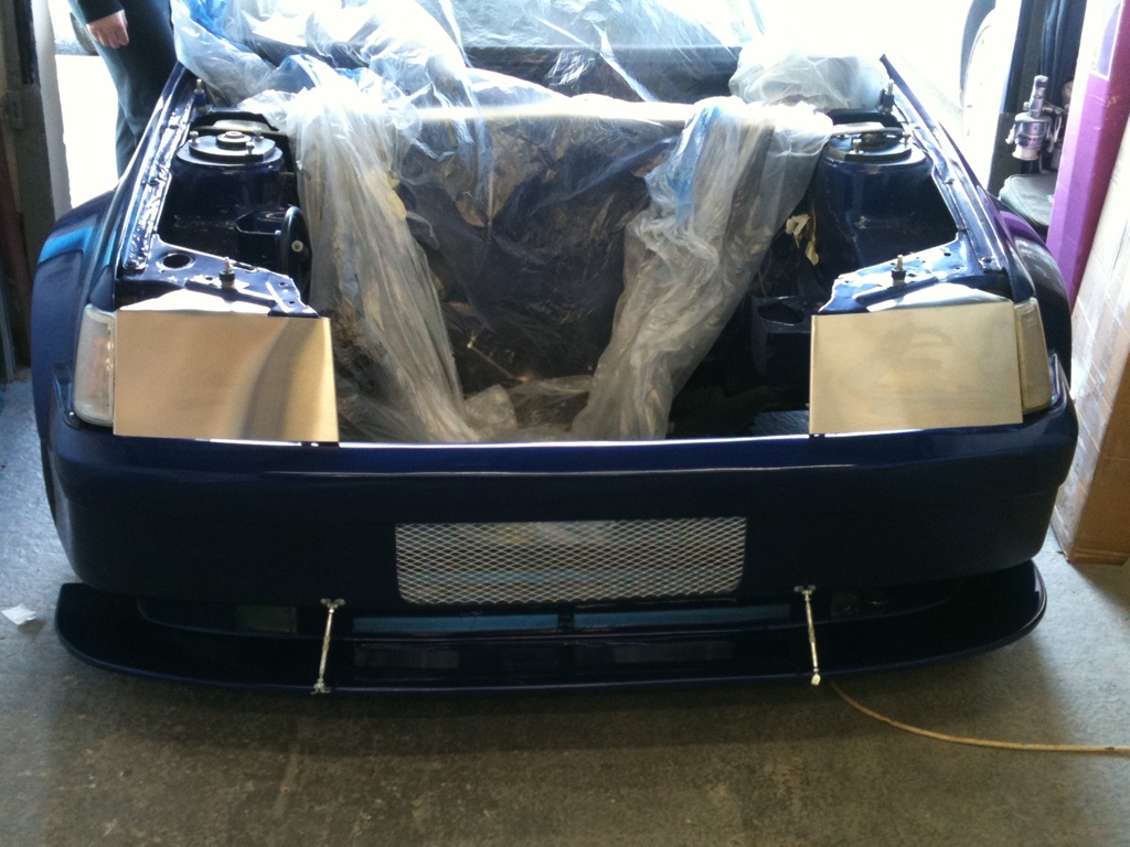

Made myself some new Headlight blanks at the weekend, new improved version that box in the headlight area rather than just a sinle plate with a bracket. Dont worry about the fact the splitter stabiliser bars look pi$$ed, this is because they arnt bolted down in that pic, these are now bolted back in place and also matching mesh has been put in the grills on the splitter at the bottom, ill get some more updated pics asap.
