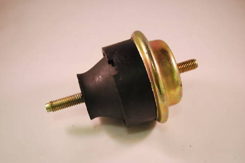

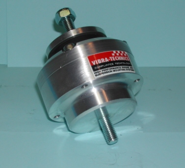

What to go for:
Std Top engine mount at £9.99
or
Competition Top engine mount at £87.00
Bearing in mind i am replacing the 2 rubber top mount bushes with solid bushes.
See pics, i really want the Competition one but its alot of extra beer tokens so is it really worth it???
EdCherry
I went for BBM stuff all round, seems the tits.

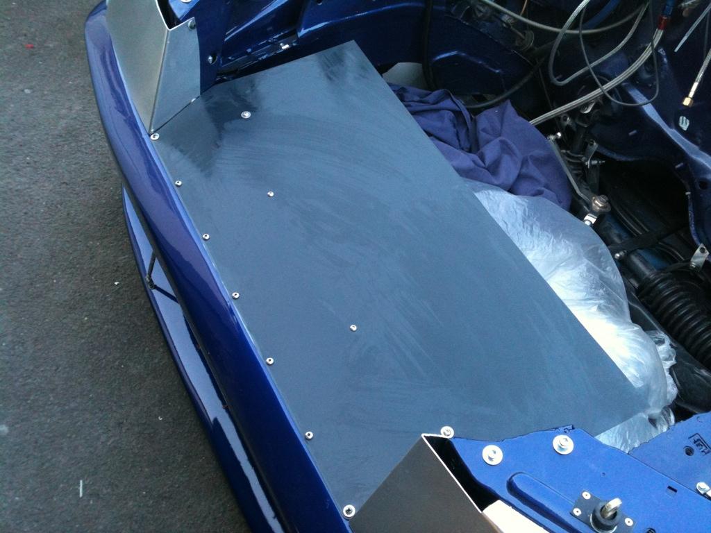

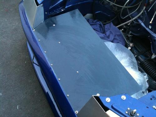

wardy18
I have thought overnight of one design flaw in my scuttle panel which if I'm going to make and sell them to you guys I'm not gonna hide from you, if it rains all water run down from the windscreen will now run straight down the scuttle panel and into the engine!!
Unles you have a STD bonnet with the long sealing rubber which when closed will seal down onto the scuttle panel end to end.
I have a fibreglass bonnet (you may be surprised haha) and so will now have water running into my engine bay, my only solution will be to buy a length of 90deg bent ally strip to fit and bond under the front of the scuttle panel then screw through this onto the car, this will catch any water run down and divert to the side to run down top of the arch sills.
Let me know your thoughts?

wardy18
Problem solved so easily too, I just fed a but of electrical wire down into the window rubber along the bottom of the window which lifts the rubber off the window a couple of mm then the water will drain into this channel and then drain down the actual drain holes in the rubber either side of the windscreen bottom corners, happy days!!
I'll get a couple made up, I can make in 1 ply fibreglass with or without a layer of gel coat, only have White gel coat I'm afraid, if you really want black gel coat I can get sone proper die for it, obviously price will be more for a gel coat layer, will come back with prices ina bit

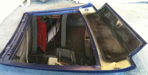

Update on todays work:
Hacked off another 1.5kg from the inside of my boto lid, never seen them taken this far and as far as the bottom half goes this is as much as you can take out cause its now fairly flimsy, all i wanna do now is get a set of them hole cutters to cut lightening holes in the inside pillars of the boot lid.

I think you should drill a s*itload of holes around the inside of the window frame to make it even lighter! I'm going to do this with my doors, just need to get some sikaflex to bond the windows in first. :D
wardy18
Cheers, yeh thats my plan but I need to buy a set of those hole cutters, all I have is a set of Step Drillbits one of which goes from about 5mm to 20mm which is perfect but it about 30mm long so it will hit the outer skin before I get to the 20mm wide step, I might just have to map out and drill loads of 10mm holes instead, just as affective!
Just a little concerned about regulations, MSA state that I am not aloud to drill any lightening holes other than to run Fuel, Brake or Elec lines, but it doesn't specify if this applies to doors and boot lid. However it does say Doors, Boot and Bonnet can be changed for other materials so if this is allowed surely I am aloud to lighten original with lightening holes seeing as hacking the guts out is aloud!! Need to clarify first with a scruiteneer!

wardy18
Oh and i have now managed to cut my boot lids weight down to 9.8kg, further to the pic above i have not cut alomst 100 holes from 8mm to 15mm diameter, dont really wanna cut anymore in it as it bolts as standard and uses just 1 std boot strut to hold it up so it didnt want it to start flexing when open on the strut. Will get a pic up once ive touched up the paint work!!
Really not sure whether to do the same to my doors or not, they are pretty flimsy already so dont want to over do it to the point they become a pain opening and closing.
