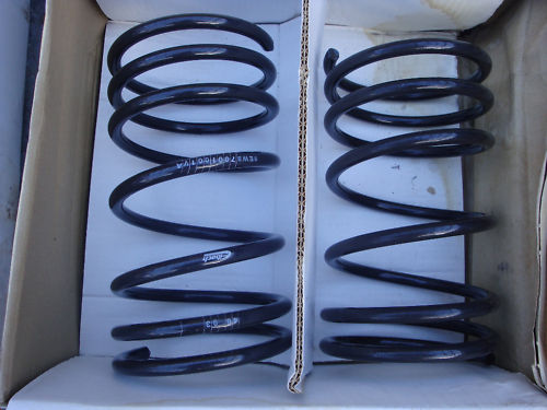

post-2857-1292792221_thumb.jpg Total bargain from someone on the forum.
Then due to the baby getting me up early then going back to sleep on me.... I ended up with these from ebay... should give me a drop of 25mm.

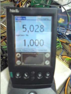

I have also been playing around with some electronics in the garage. The car runs a Megasquirt ecu, and to log data you need to have a laptop connected which is a royal pain in the bottom. I was also looking for a small display, so I can monitor some on the ecu parameters whist driving. So I've been playing with one of palm III PDA and this software:
Palm Logger
It bloody worked straight away, no messing! Not only does it have a good little touch display but also provides a data logging capability and was dirt cheap!
Here it is up and working with my Megasquirt.

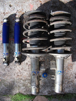

Got the new spring mounted to the dampers, bloody hell I dont like spring compressors.
Then I cracked on and installed them the 205, along with new bolts (thanks Baz) and drop links. I've also pulled the front and read brake discs off before they become totality unusable! The next mechanical job is to drop the rear beam one click, which will be fun!

i like the idea of that palm logger.
does it hook up via a usb?
what model are you using?
pete
madspikes
Palm logger is serial - Thats why you have to use an old one!! I just connected it up, and it worked!
You just run a 'twisted' 3 wire serial cable between them.
To transfer from palm to PC you replay data back into the PC all but faster than real time.

Before...
Now... With new dampers, springs and refurb beam.

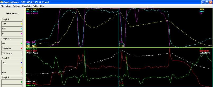

Did a little test the other night, here is my 0to60mph data log. Note that I'm running a gearbox from a 306 derv and not a gti box. By may calculations 0 to 60 was 6.7seconds, not bad given the poor traction in 1st gear!
