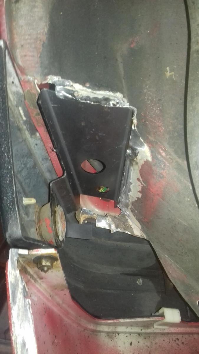

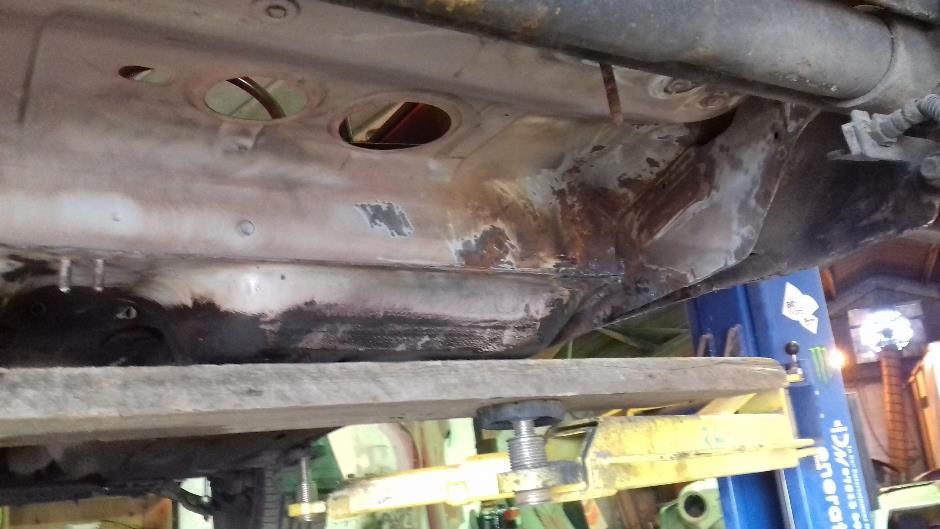

Heres the rear pre bought rear bumper bracket/panel tacked into place- both sides have needed replacement:

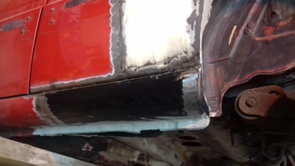

I would remove and fit a new sill. That's been bodged before as can be seen by the amount of filler.
that's probably what will happen- id like to keep the car as original as possible- waiting the outcome on Monday!

At least you'll know what's what for future reference and if it's done right will be worry free for the next decade or so.

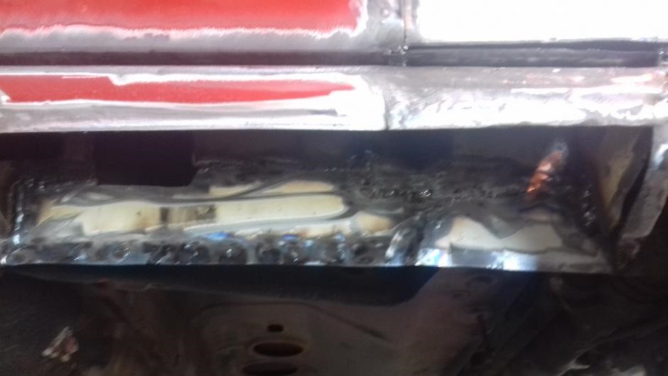

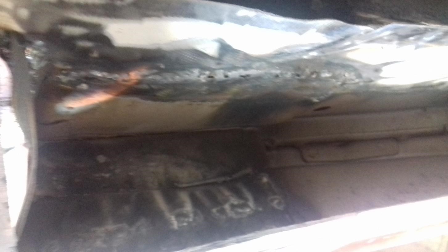

So Ive decided to buy a sill and just replace the rotten part in an attempt to save as much of the car as possible- and also not to disturb good metal.
Sill is on order and the inner sill has been welded with fresh metal

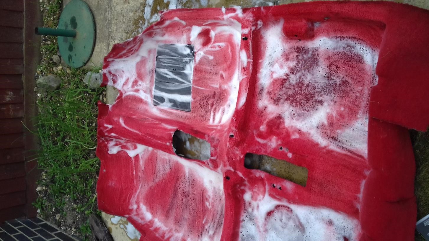

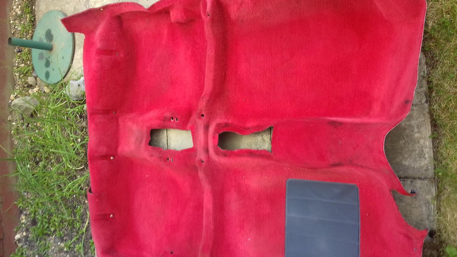

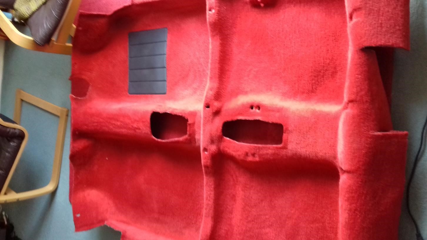

Whilst the carpets out I thought Id give it a clean. Fairy liquid, hot water and a scrubbing brush seem to have worked a treat.
Surprised how much dirt came out and how quickly it dried!
Finally a week after ordering a new sill has arrived!
Some progress over this week, The sill is now on and the rear bumper hangers are fitted.

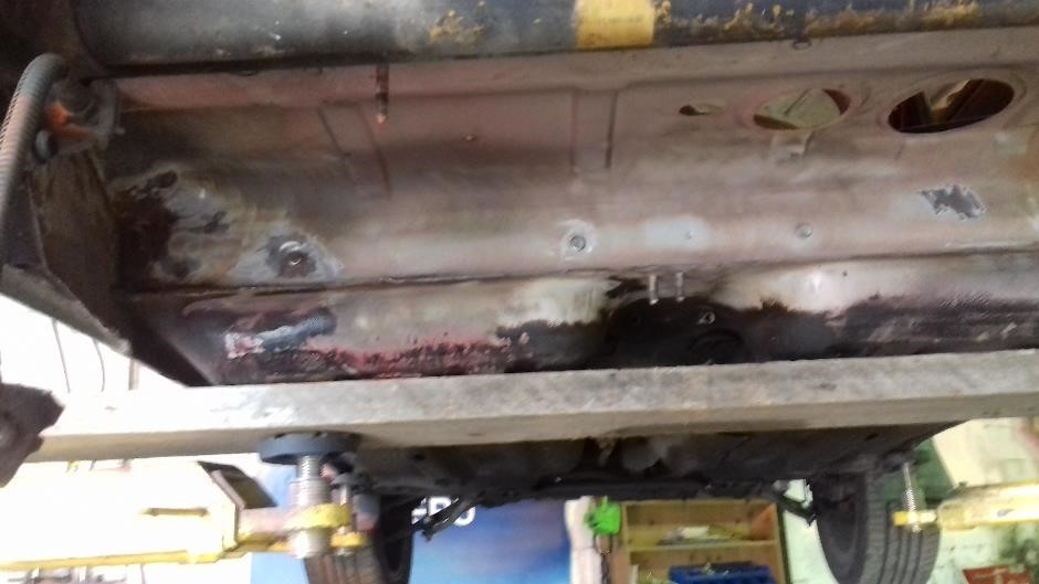

The underside is now being prepped for a fresh coat of paint and stone chipping.
Its being finished in the factory red rather than the horrendous black that was there. Hoping to have 1/2 the underneath done by the end of next week then spinning it round and starting on the front half and the rotten scuttle panel..
So heres the sill in and almost ready to paint, just the rotten rear 1/3rd removed in an effort to keep as much of the car as possible original.
And heres the rear 1/2 of the underside stripped back with a bit of derusting to do prior to painting
