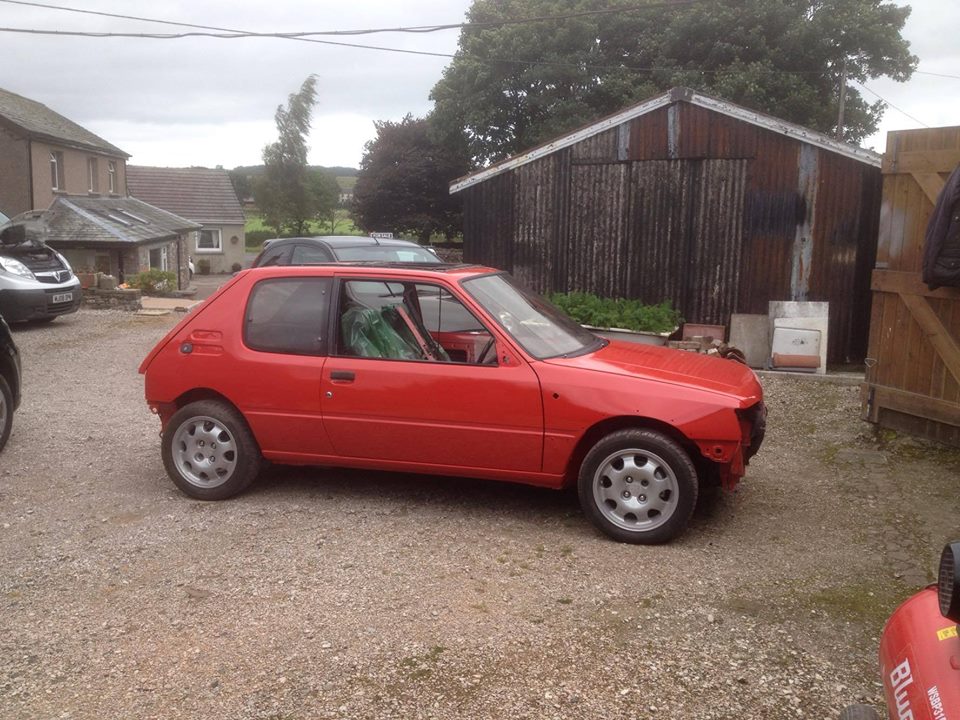

im confident I can sort the surface rust- im trying to decide what product to use- looking at the bilthammer deox- c gel which seems to eat the rust- or a rust converter which FE123 seems to be. Not sure the best route.
Telf
As for the rusty bits and the holes I'm now edging towards cut out a patch with parts from a pattern sill. I'm trying to keep as much original car as possible.
Telf
paul - how long did it take you to take it all to bare metal? My floor seems ok- its covered in a thin layer of stone chip. I'm thinking of removing it all but thought I'd do more harm than good as I believe its galvanised and therefore protected reasonably well

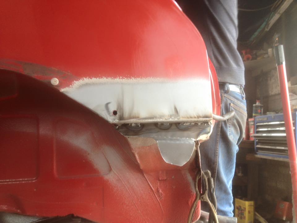

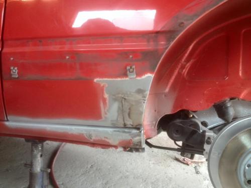

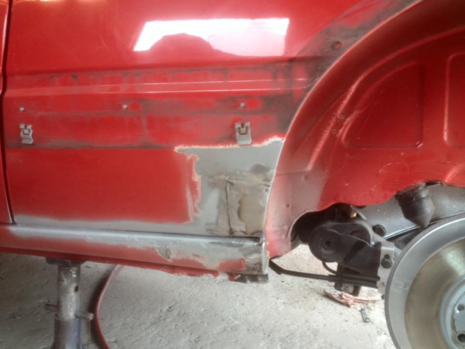

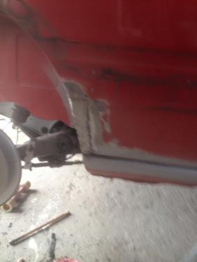

Also had the problem with one crusty rear bumper mount, looked quite bad but my mate Rob made up repair sections as per the photo, also did the rear end of the sills which weren't actually too bad.

Telf
205rallee- mine keeps rusting in the same spot as shown in your pics- nearside rear arch- repaired twice now- I cant figure out whats causing it- I've seen the metal cut out at the bodyshop. I figure its the hole at the rear of the arch (by the bumper bracket) allowing crap to accumulate and rot it?
205Rallee
Could be, I will make sure there's a good coverage of wax in there.
And
Make sure you haven't sealed any drain holes up too.. as that could be sealing water in got I feeling there is one in there,

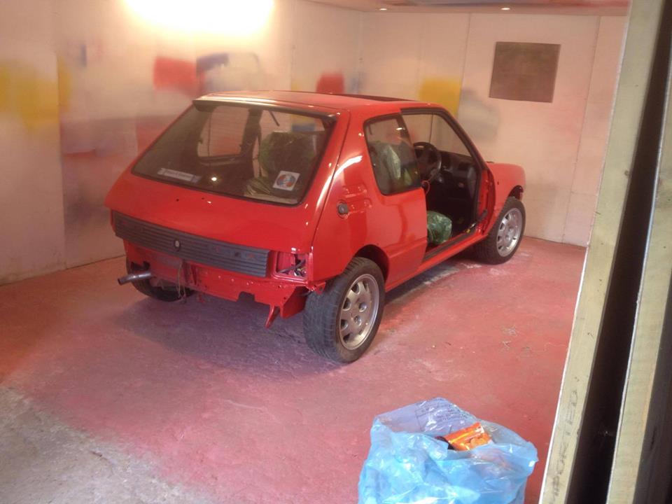

I start stripping the car to carry out the work and the insurance company asks for a new set of photos for the agreed value insurance. Guess I will be putting it all back together at the weekend!
Telf
Today I'm going to try and remove the front wings. Can anybody offer any advice? I know to undo the top bolts and the hidden one behind the kick panel but having carried out anow assessment yesterday I'm not sure how to get in and release the sealant.
