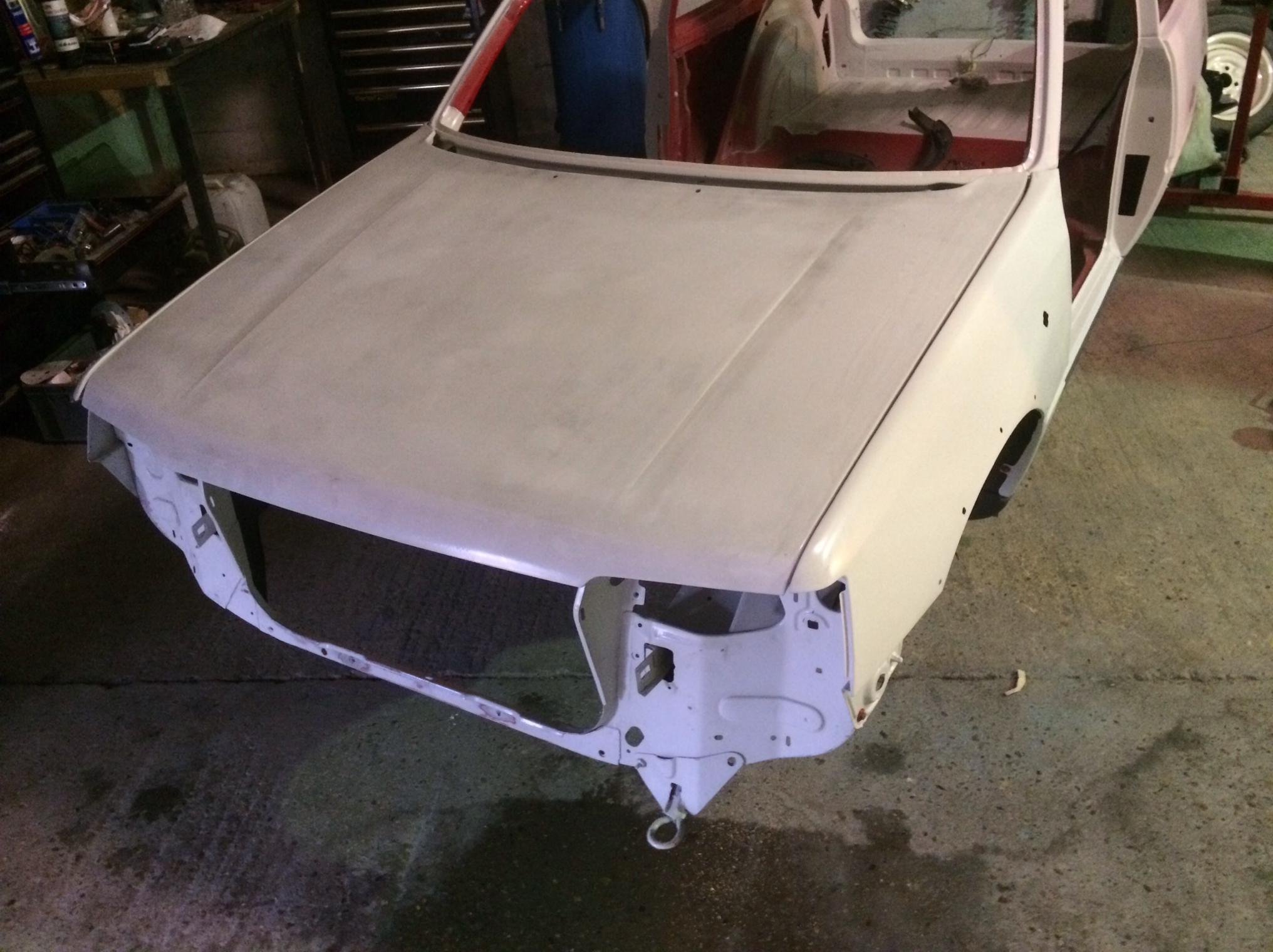

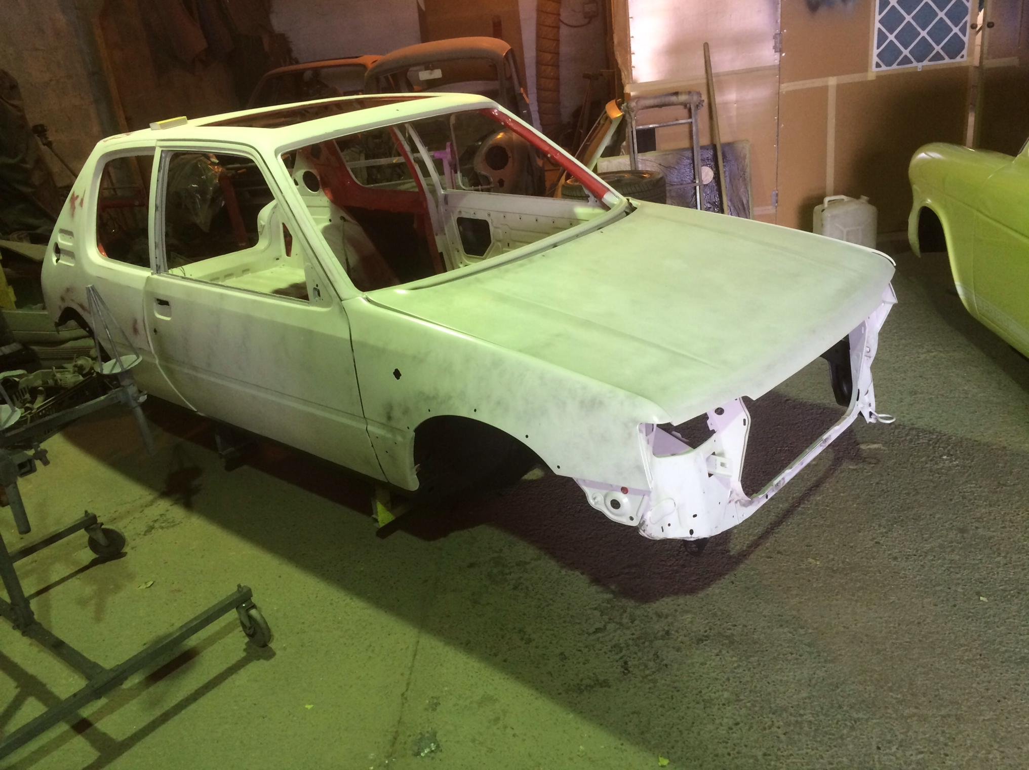

Bonnet and wings all lined up
Telf
Doors fitted and lined up. Afew high/low spots to sort but all lining up nicely

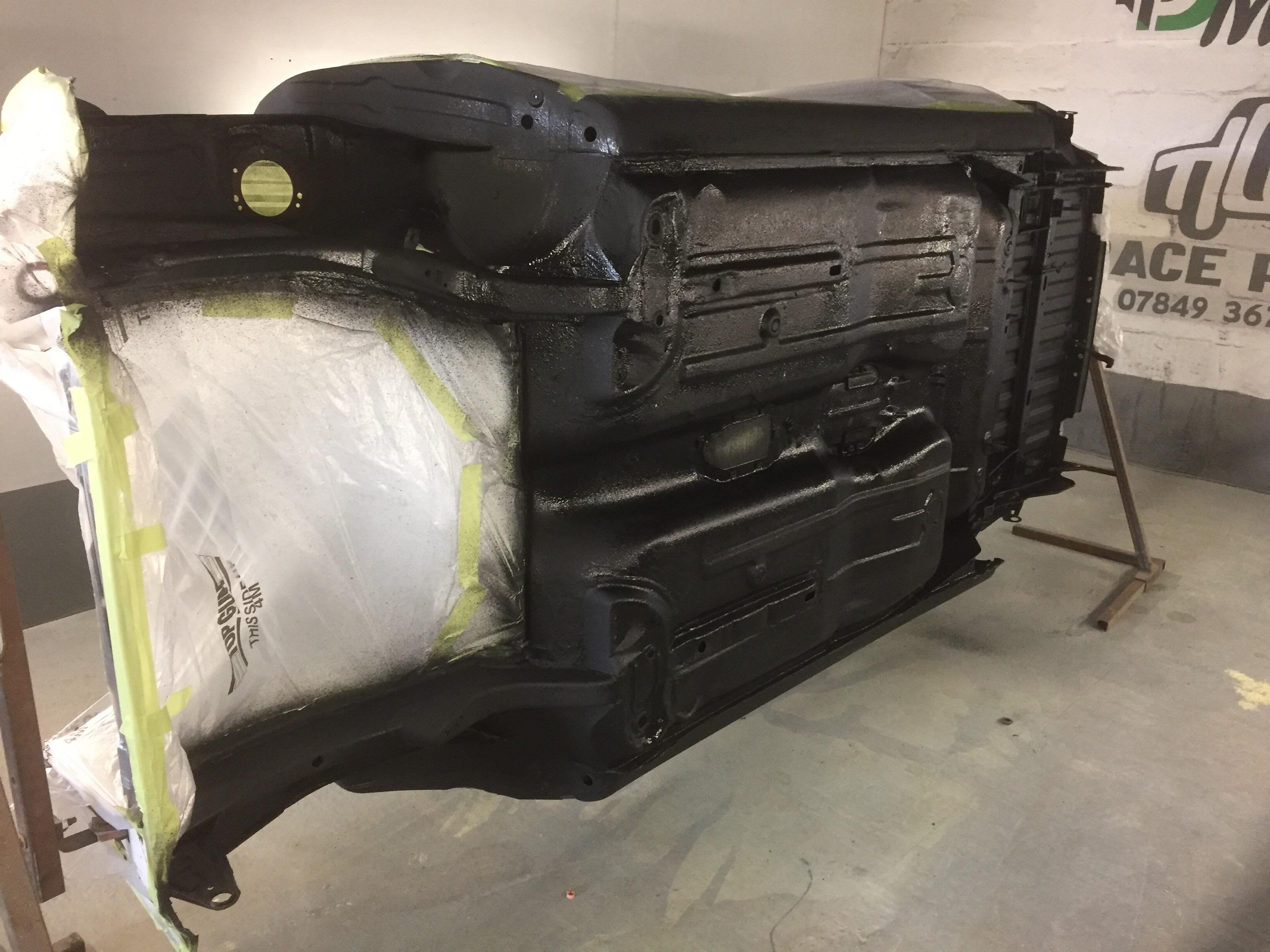

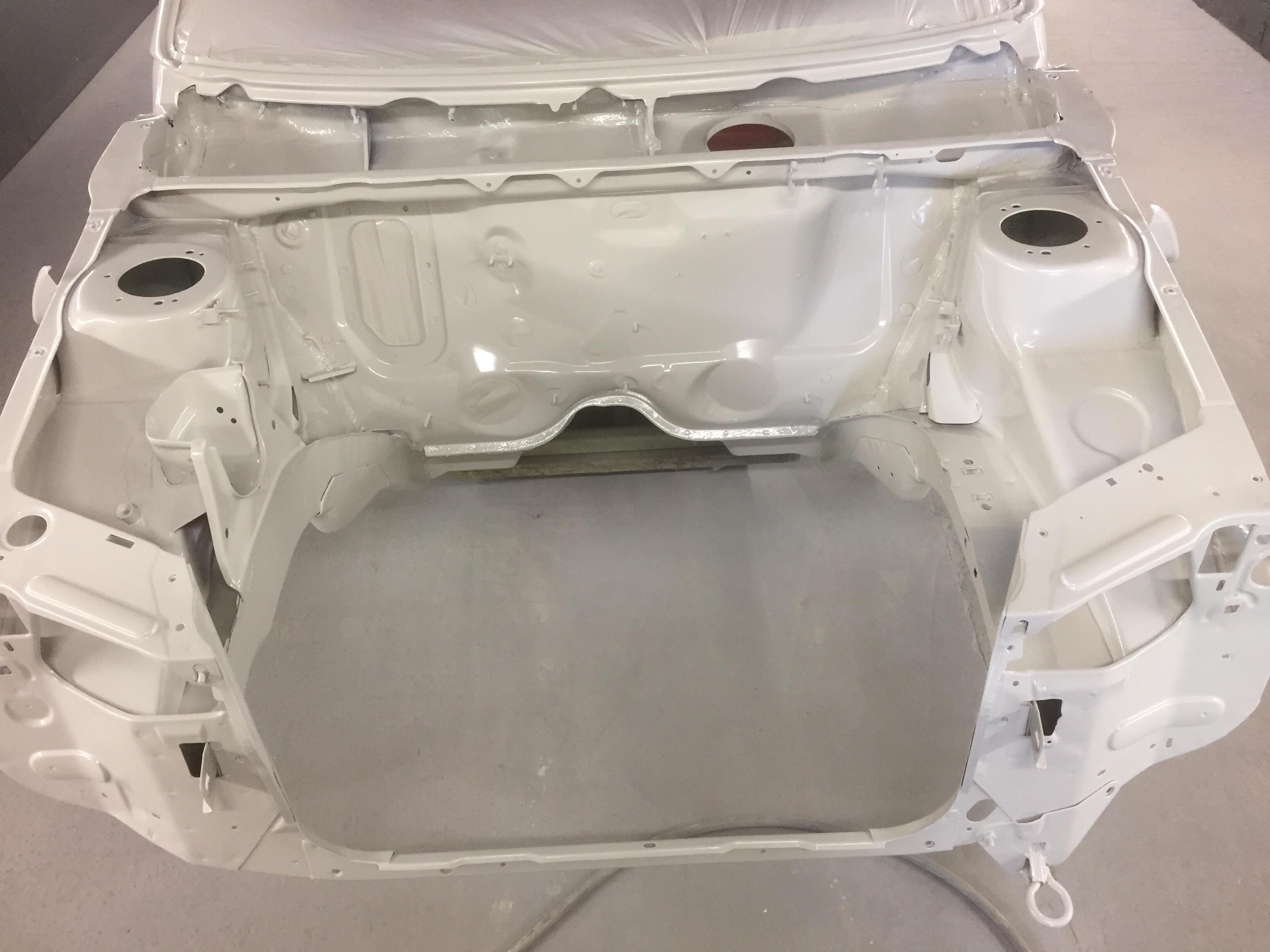

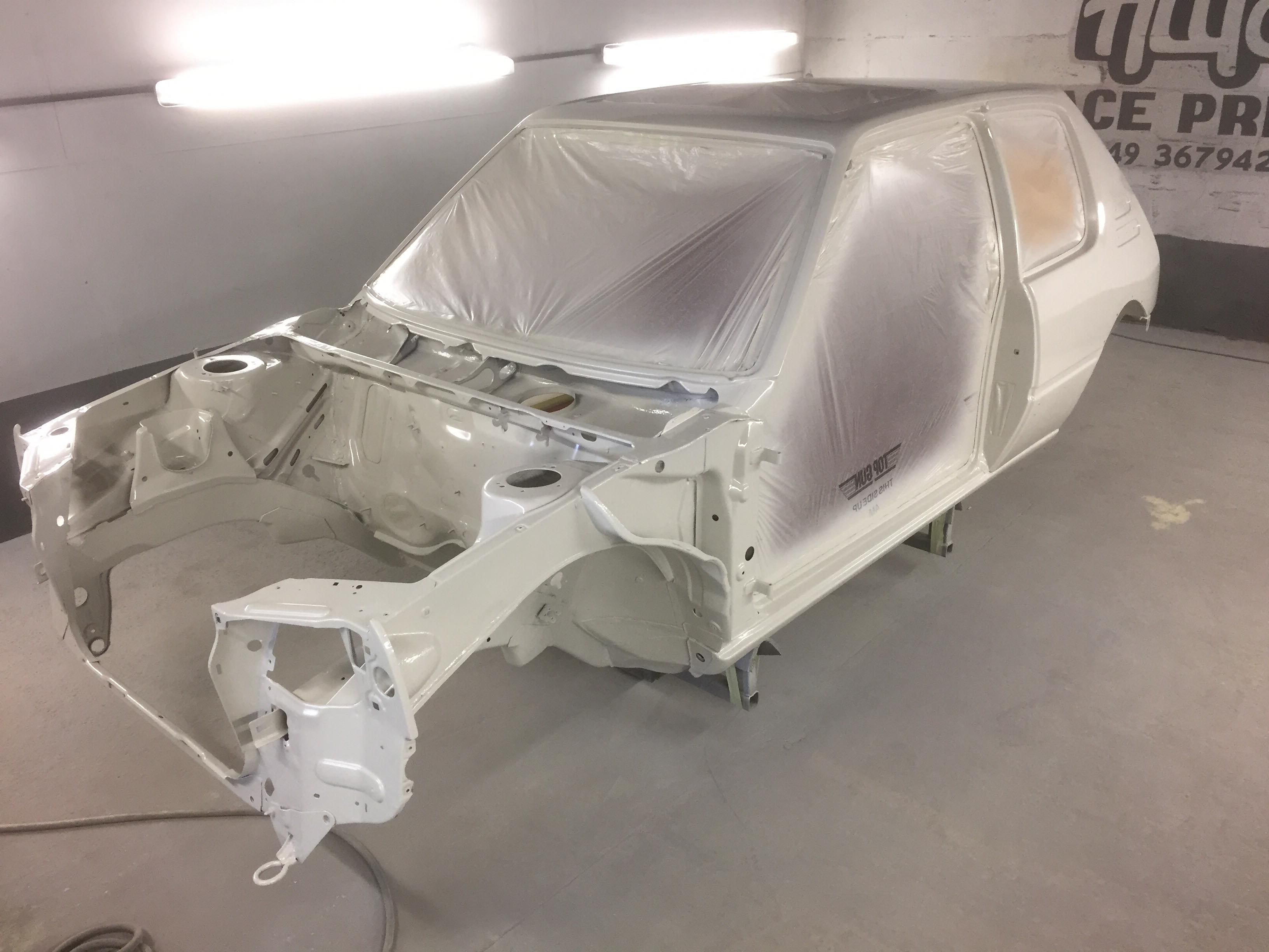

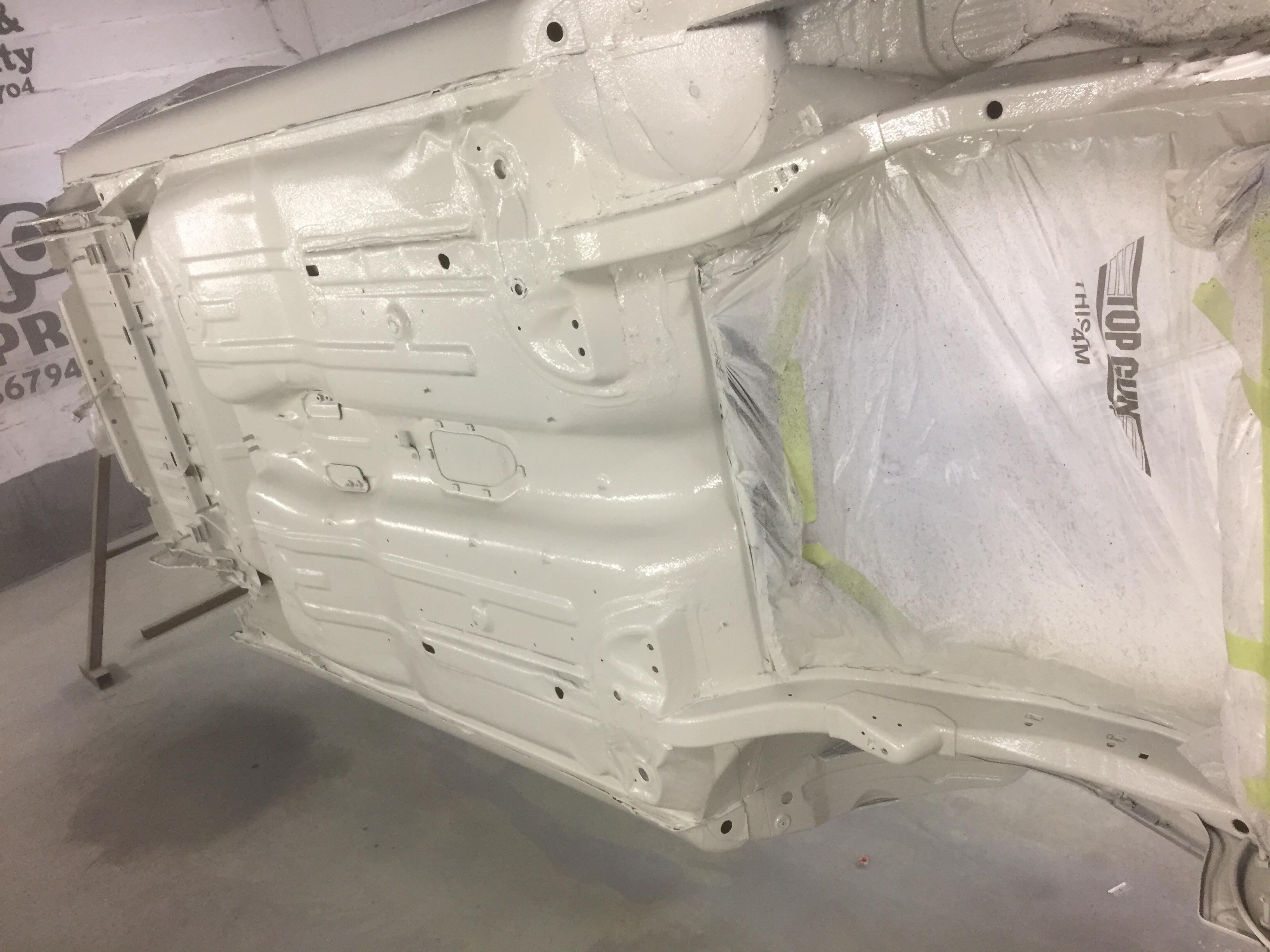

Under side prep now we'll on its way. Stone chip added prior to an epoxy coat then a red topcoat. Next will be the engine bay so we can get the engine back in and get it back on 4 wheels

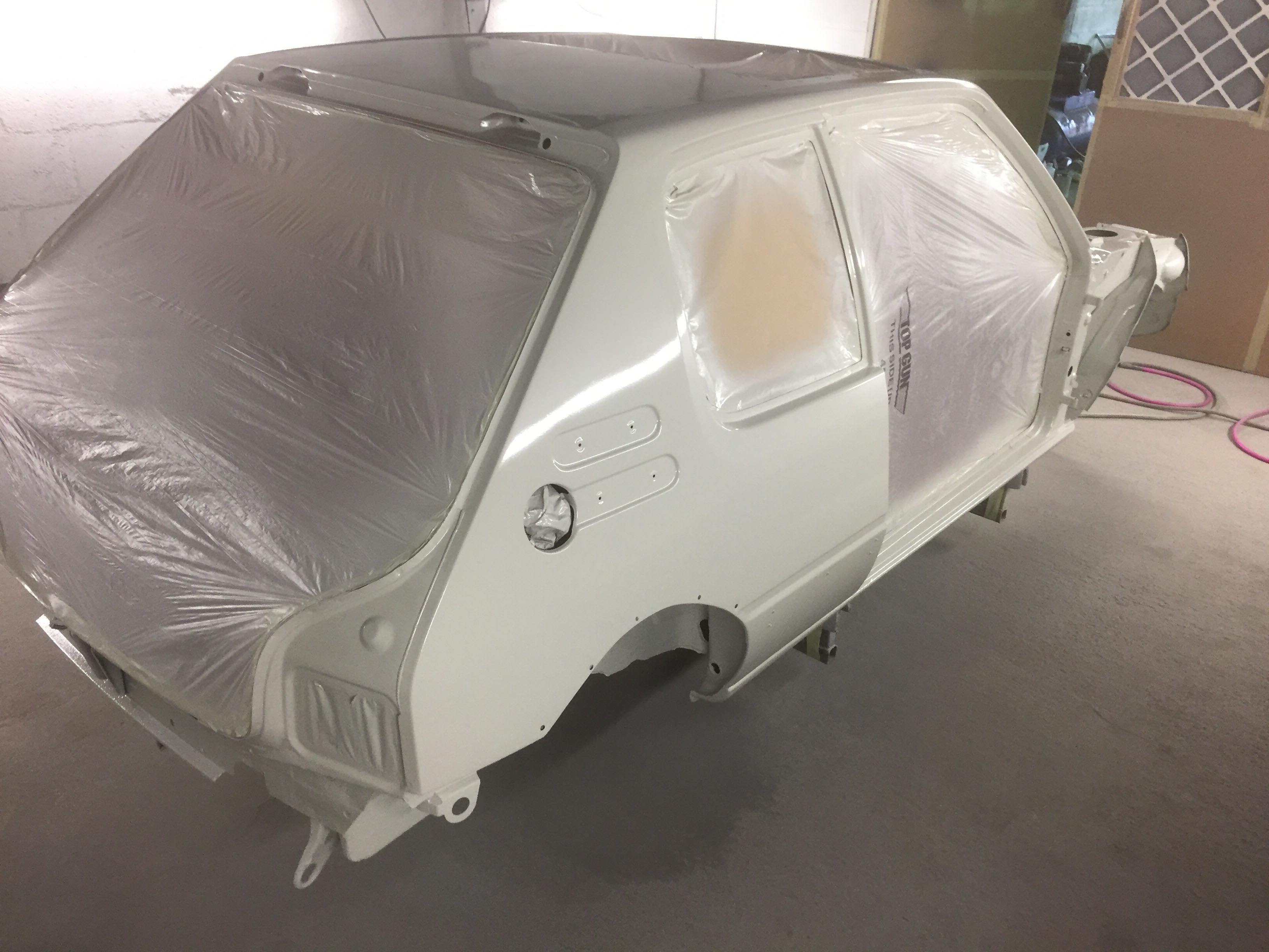

Telf

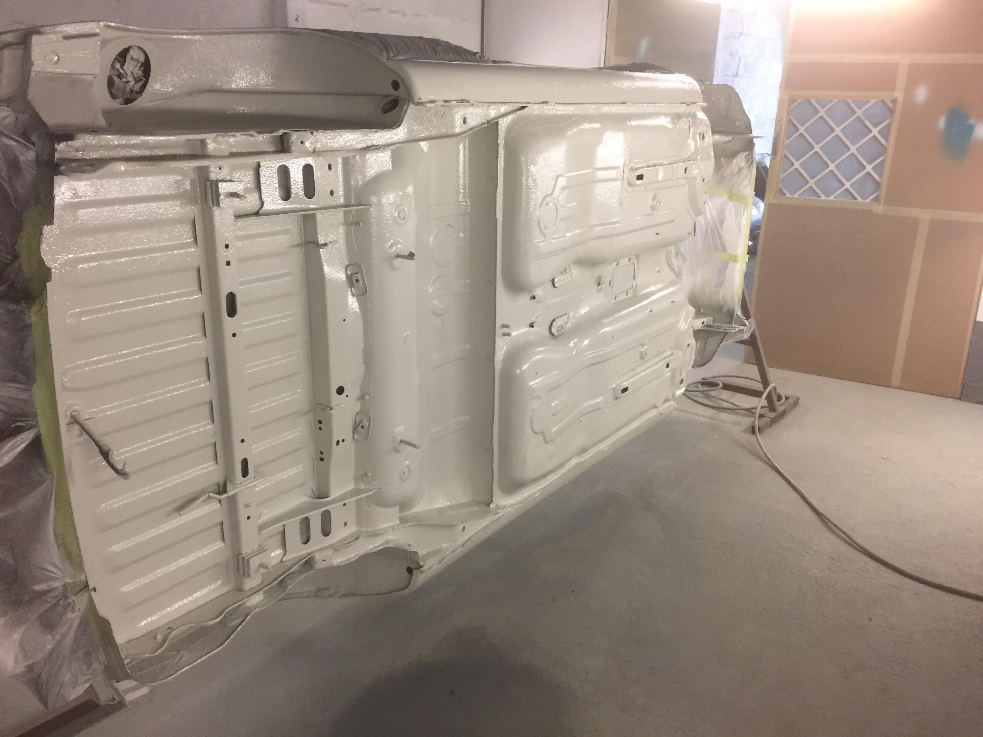

Final epoxy coat. Looking very straight and tidy I think.

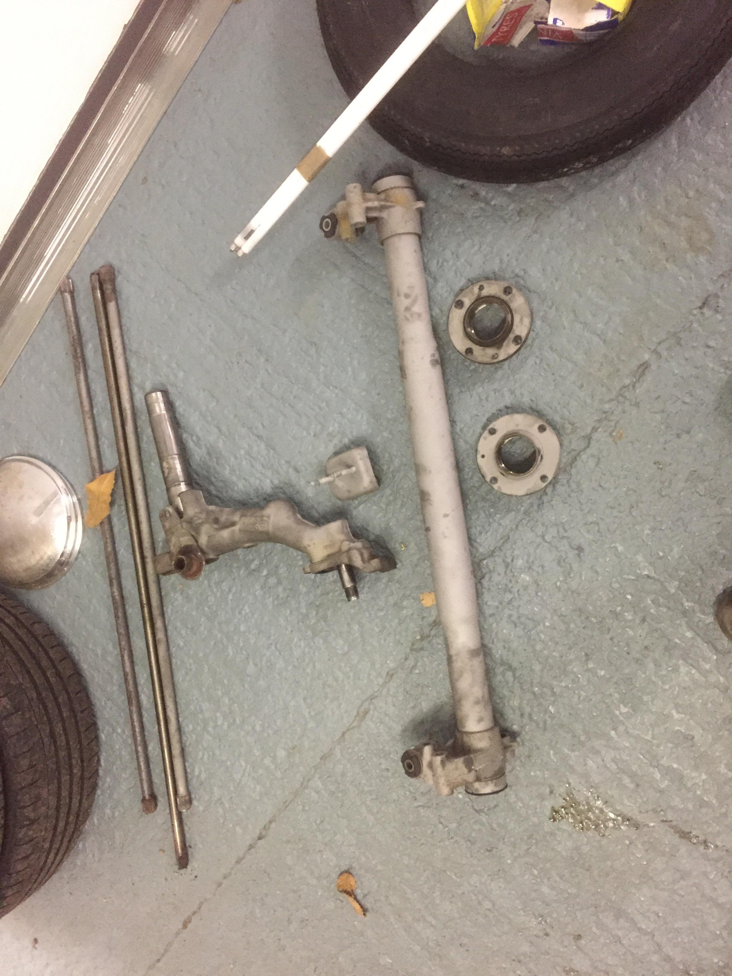

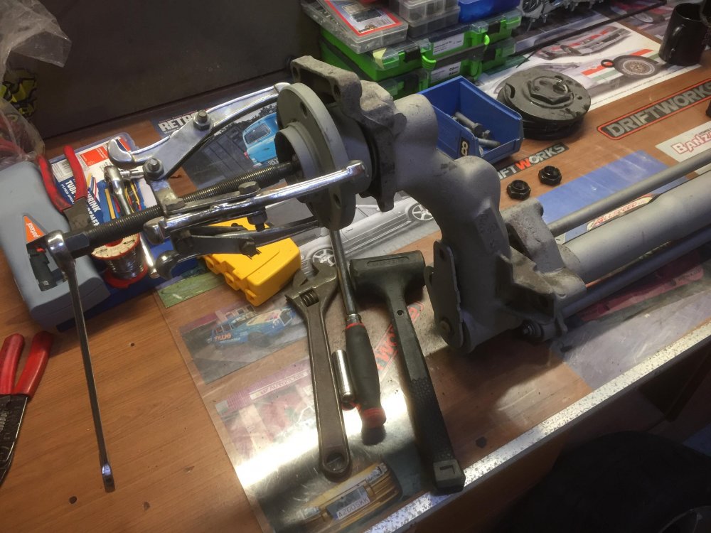

What have they done to the rear wheel bearings? Those are scrap now, the bearings are not replaceable in them as you might expect to be the case.
Telf
Tom , I'm not sure I just got the pictures sent through. I take t the whole bearing will need replacing?
Whole hub is one part with the outer bearing races integral. Throw those in the bin and buy new. Sit down before you price up good quality replacements.

Sorry  confused! I need to buy a new set of the item I've circled? At £300 each?
farmer
Yes,you need new but 300 was the last dealer price
You'll find Firstline on eBay about maybe 75 to 80 each.
The bearing is integral with the hub. You cannot replace one without the other. Looks to me like your body shop has assumed they can buy a replacement bearing and press it in. They cannot.
