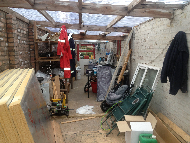

So the weekends task was getting the CJ and GTI into this!
dobboy
A day and a half later, a dismantle and rebuild of my homemade racking and several visits to my loft and the local dump, my car came back to the house for the first time in about 10 months.
And both the CJ and GTI got tucked in for the night.
It was an emotional moment for me :)
I've exceeded my disk space on here so can't post a pick..... but the cars fitted with plenty of room to spare.
