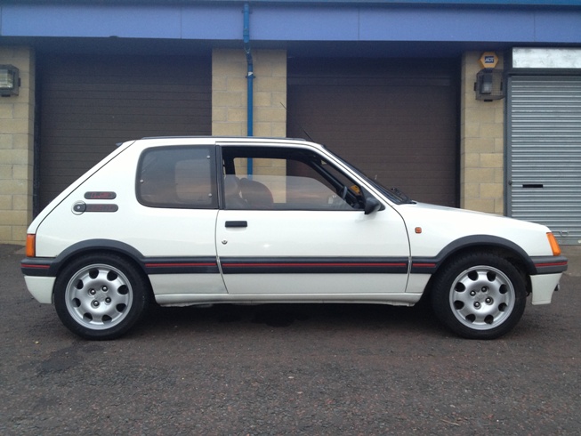

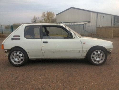

But one thing i noticed was the difference between the back wheel and arch on both sides of the car.....investigated, and rear beam was the prob.
Look at where the wheel sits in the arch.

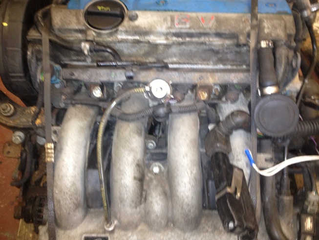

It's obviously a bit ugly, but i was assured it was alright.
The wiring loom was cut to bits, so i got a new one for £10 which i thought was a bargain.
I wasn't having an engine looking like that in my nice car, so i set about cleaning it up. It took quite a few nights with wire brushes, drill fitments etc etc..... then gave it a paint and lacquer etc. I had stripped it down, and what could be blasted was given to a freind to take into work to be PC'd..... "any colour i want as long as it's black".

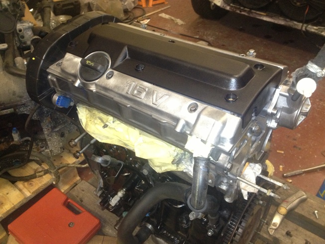

I was aiming for an "engineered" look on the engine and finished painting around xmas, then started building the bits i had taken off back up.

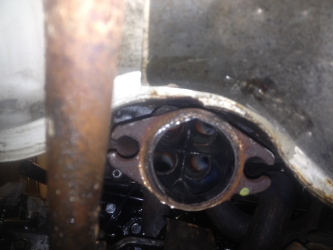

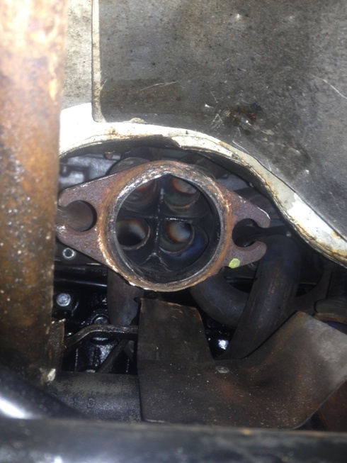

I was under the impression that the exhaust manifold could be adjusted before dropping into car...... so i had read bits on here, and got it all done..... (wrong).
Malc arrived the following week, and swapped my Gbox over and we tried the 16V in. The exhaust was hitting gear linkage, so out it came, and he left and i was in a downer lol
During the week, i went back to it took exh mani off and got it chopped.
I put the engine in a few times, trying to get the angle on the manifold correct, by shoving washers with a cable tie through them, into the cut, as it was too springy to bend in position.
At this stage it was border line,,,,, finish it or phone the scrappy......
But i got it fitting nice, and welded back up.

Now, bearing in mind at this stage i know little about the engine, (and i'm electrical biased), i decided that i would fit "the other side" of the 16V's big round plug to my 8V wiring, and the few new wires i need to run in (from NS to OS) to marry it all up.

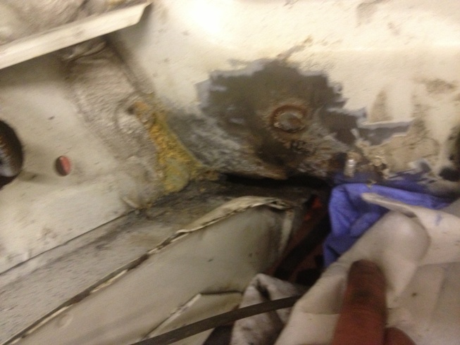

But then i spotted a rotten patch, caused by a leaky MC. This was another feck about. It involved removing the drivers seat (2hrs!), carpet, underlay, dropping fuel pipes, as the welding would be in too close proximity.
Now bearing in mind i'm working alone with a grinder prep'ing it for a freind to come and do the welding, next to fuel pipes with a full tank of gas.....in an industrial unit filled with work materials, with the car on axel stands! it was fecking hairy.
So welder came, and plated both sides, albeit not his best job ever, i did the fire watching duties, but there was no 999 calls.
The prob was also inside the car with his flame, the insulation/dash etc etc.
But it got done.

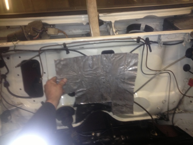

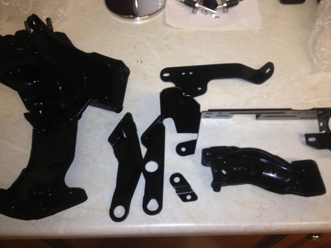

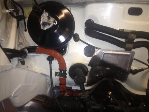

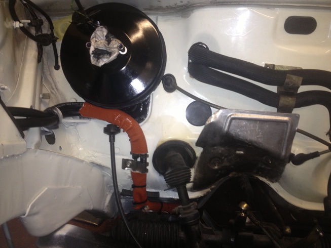

After reading on here about exhaust heat etc, and having access to good heat proof materials, i thought i'd slip some over my fuel lines. Probably OTT but it does no harm.
I also attended to sections of painting that had been scratched throughout the yrs, and cleaned up/t-cut'd other bits etc, and done my servo while i could.

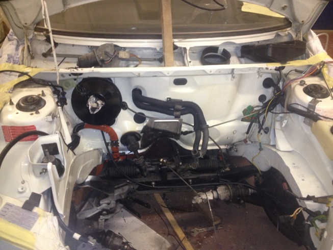

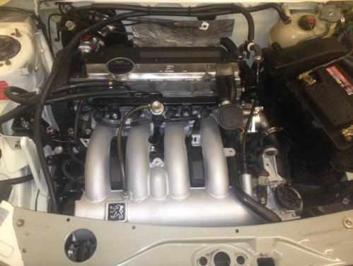

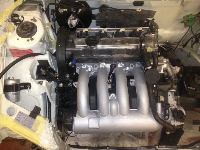

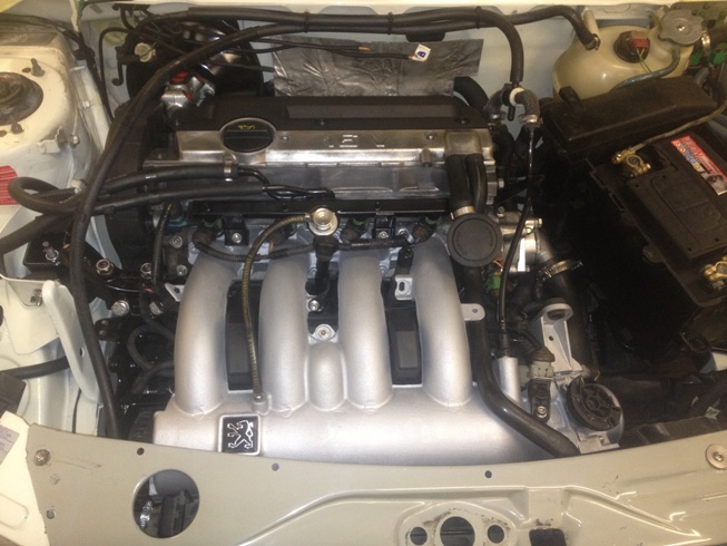

I was/am happy with my bay at the minute, so decided to drop the engine in. Changed all the mounts etc, (vibra tech's to the bottom, new OE to L&R).
So dropped it in again for what would hopefully be the last time....

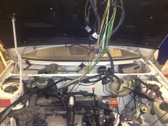

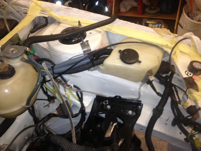

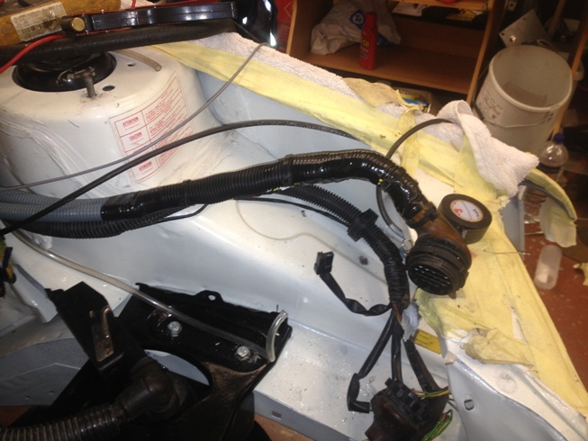

It was then time to focus on the wiring. Now bearing in mind i didn't/don't know much about the engine, and had only performed a simple test on it, i thought well i want to make this easily removable if i have to. So i fitted the "other" side of the big round plug to the new wiring i had ran, and also to the 8V dash wiring at the NS.
I had bell'd out all the 16V loom several times, to be safe, with the "other" side plug fitted at the time, and had cable marked everything...... and as i had the 8V loom all cable marked, then it was "paint by numbers" with a soldering iron, generally as the guide on here. However, i have changed over sensors from the 8V on to the 16V block, and done a few minor mods to make it all work.
I made it fit/hide behind washer tank.

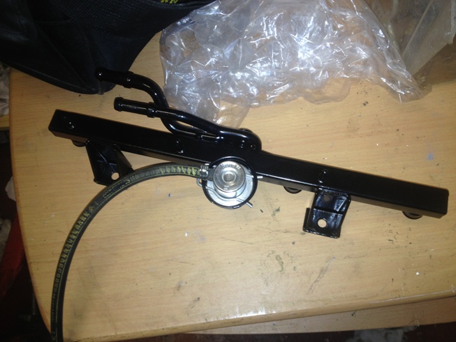

Sent injectors away and had them cleaned/checked out.

So, got oil, filters etc, plumbed it up, (using a combination of 8V and 16V piping), plugged my plugs in ........ and although i still have a pipe or two to re-route neater, I went for it.
Bit of a hick-up (1)..... eventually realised that i had the fuel pipes the wrong way round. I had them marked up on the bulkhead but must have mixed them up when i dropped them to get the welding done...... sorted it by swapping the flex's over where they meet the solids at the back of car.
Hick-up (2) I've used the 1.9's battery.......and it's near dead after sitting so long. So i rigged up two sets of jump leads head to tail, through my unit door, and tried to jump from a transit connect van
After a few seconds of whinning, it runs!
As no exhaust on, its hard to tell anything else, but there is life in it...... what a relief!

Looks good! what was the problem with the beam? Sits too far back I the arch? Did you find out why?
The bearings were away, as far as i know..... got the beam removed/dismantled, took it to be blasted/ powdercoated, then back to be rebuilt etc with new mounts.
yeah it was different in both sides, iirc, two fingers one side from sill, three the other side.
GLPoomobile
More likely the beam mounts were on the wrong way round
dobboy
Na, it was a bearing(s), remember seeing it being all flat at one side, a tidler of a bearing hardly fit to be in a washing machine never mind on a rear beam.

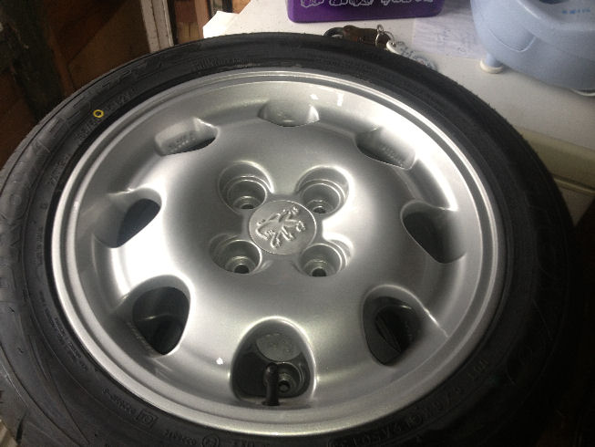

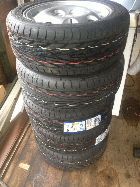

Picked up my refurb'd wheels and new tyres (Toyo TR1's) this morning, quite happy with the finish on the wheels.

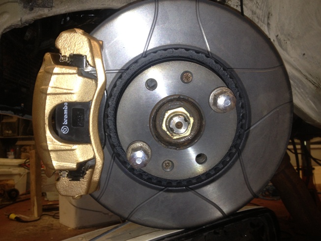

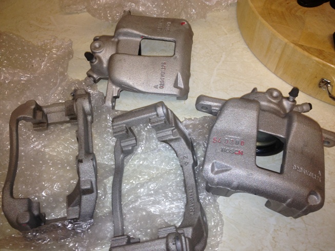

Before xmas i bought GTI180 calipers from a scrappy, had them blasted, fitted repair kits, and painted them up. I was wanting annodised colour, but this was the closest i could get.
Fitted them with new Brembo Max disks and pads.

Dobboy, calipers!!! Was there a cheap sale on gold paint?
dobboy
Malc, there is about 5 coats of VHT on them, took ages to do. They aren't bling in the flesh. Honest!
Malc
Need to see them in the flesh!!! Sorry just not a gold fan. Hey I can't say anything, mine are a sort of power washed/flaked paint sort of finish, at least you put some effort into making them look reasonable, to be honest I don't care, they stop the motor!!
dobboy
They're not gold, more a kind of brass/copper lol

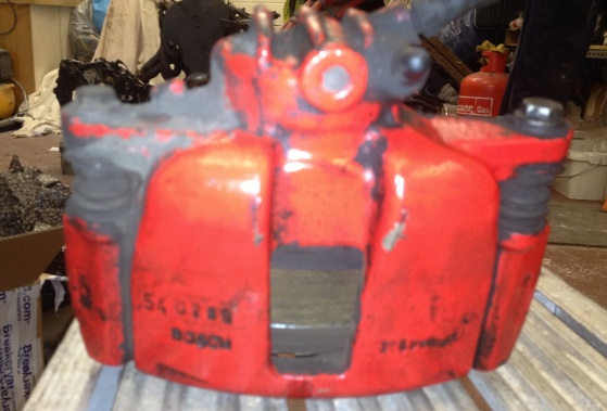

Got all the brake line terminations done and connected up etc, ready for bleeding. Single pipe to the back with a T-piece and compensators removed. Davie from EK (on here) brought over his brake line vacuum pump to help bleeding the brakes. Ended up snapping the NS rear bleed nipple..... tried drilling it out and EZ out but it wouldn't budge, so we bled the pipe connected to the caliper as best we could to at least give me some brakes to move the car if i need to.
Managed to get two rear very similar calipers locally (£30) from an Xsara, So cleaned the caliper bits up and hopefully fit them with new pads this week to my carriers, and ordered another litre of brake fluid from Opie. I should be blasting and painting the calipers but i need to get the car mobile and away to get painted, so the calipers will have to wait until a suitable time. The base model Xsara brake pads and 205gti rear brake pads are same part number so there shouldn't be any problems (i hope).

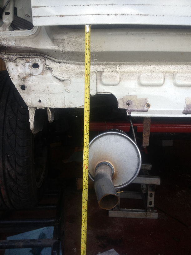

Also, messed about with my temporary exhaust which i now intend to make permanent. It's a 306 decat downpipe, on to a 2.25" (205) stainless pipe with a "cherry bomb" looking thing on the middle of it, on to a new Ph2 backbox. It sounds quite quiet at idle and gives of a nice rip at higher rev's without being too loud. I had only recently noticed that when the back box was hung with the two brackets, it meant the middle section sat too high and stopped the car going into reverse, it was also a bit close for comfort to petrol tank and a brake line. So after a closer look, it looks as though the brackets on the backbox might actually be welded on at the wrong positions..... more work. As i don't have a bumper and valance fitted i'll try measure up from another car to make sure the exhaust will fit correctly when the valance is fitted (after painting).
Difficult to see from this, but the back box needs rolled a little, and also the brackets removed and refitted to suit.
If someone could measure up from the bottom of tailgate to top of tail pipe it would help, a horizontal measure from the bit of metalwork that hangs down to the side of tail pipe would be great too.
Its currently 225mm from tailgate to top of box which i think is too high.... looks like the box needs to shift to NS further too, which a clockwise roll may sort out.
