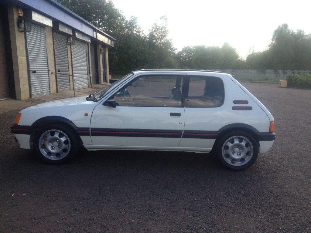

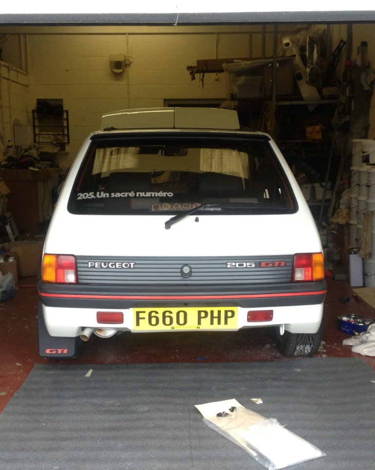

Gave the car a coat of wax and a gloss protector.
T-cut'd the red trims, wax'd them, and gave them a gloss protector, and then started to empty bags and boxes.
Beginning to clear the boxes and bags i have....
Thank feck!
Edited by dobboy

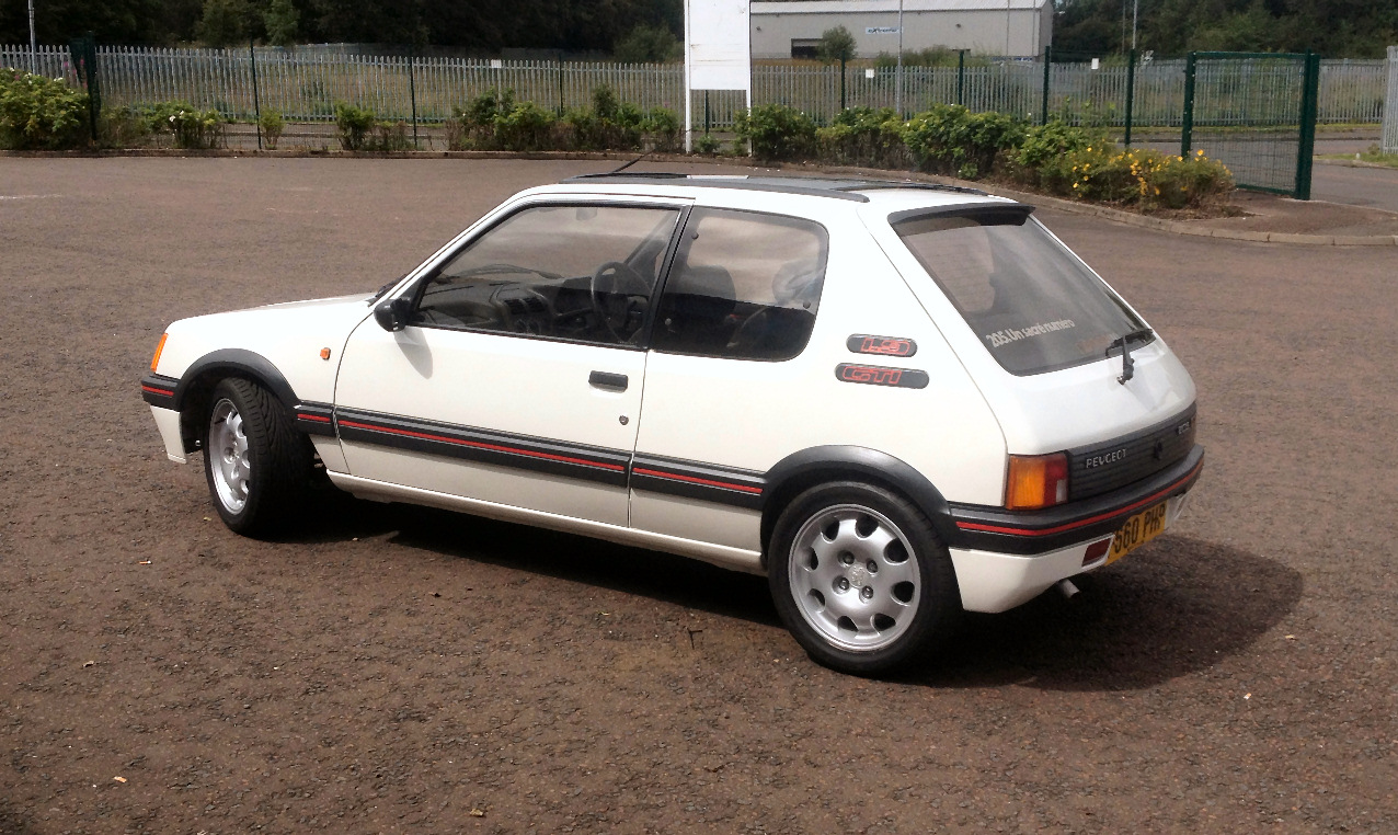

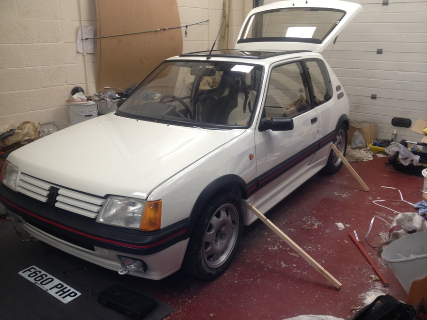

Not entirely convinced about the skirts..... i like them at some angles and not others...... and i like the look of it without them.
Malc
Need to see these skirts in the flesh, really not convinced as you have kept the rest of the interior/exterior so original (won't mention the engine, suspension and brake upgrades) I do like the wooden stabilisers though, great for keeping the missus from kerbing the wheels.
Mac Crash
Fast work, sweet looking motor, don't fit the skirts, they look gash.... and you will regret it, nice work, Jack
dobboy
stabilisers lol....
Aye, i don't hang about! (had two full days at it right enough).
Treating the Mrs to a curry tonight to celebrate the re-arrival of my GT-fookin- I !

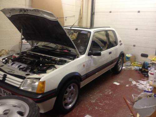

Seats should be here tomorrow.
Still a few little jobs to do, but it's coming together fast.
Not enough hours in the day!

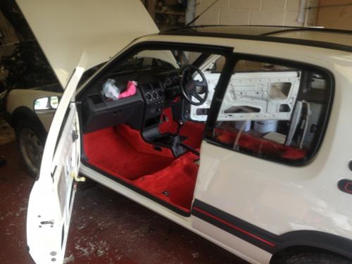

Fitted carpet and centre console last night (had previously power washed it and hit it with a can of fabric spray/paint, it didn't need the spray which is just as well as you don't get a lot in the can......the power wash brought the carpet up excellent.

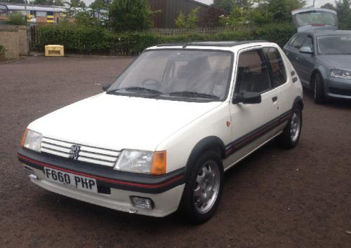

Fitted my refurb'd wheels.....
Gonna have to get the fronts rebalanced as the weights foul the big brakes. I'll take them back to the place who done the wheels as the local tyre fitters are a bit rough.

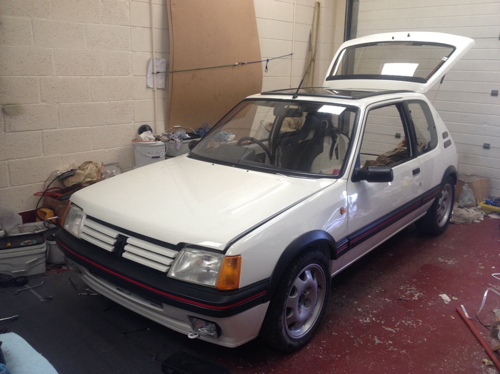

Received my seats and i'm very happy with them. (will post before and after pics at some stage)
So, got 95% of the interior fitted now. Only a few plastics and half a dozen screws to fit and also the back bumper red stip still to do.
Also adjusted my bonnet and it's sitting correctly now.
Exhaust is getting modified next weekend, it needs an inch chopped off it to give a bit of clearance around the bottom of valance.
Had a go in the car around the industrial estate...... holy sh1T!!!, i did not expect it to feel anything like this. The longest street in the estate allows me to go full whammy 1st and 2nd and stop. It's like a bullet out a gun, and i think i can feel the Quaife working, even in a straightish line. The brakes even though brand new are working great and stop it great.

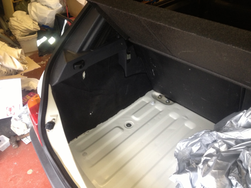

Been away for a few days but had a shift at it today and the car interior fully fitted, and now only have exhaust to get an inch chopped off (and possibly reangle somewhere near the back), and extend my front window washer pipe, and i'm done.
I fitted the rear arch felts with tacky spray glue, the OS could have went on better but you only get one chance with this this type of material and glue, and the washer bottle covers it a bit..... but they look alright.
I'm gonna look into getting some kind of sound insulation for underneather the boot floor cover.

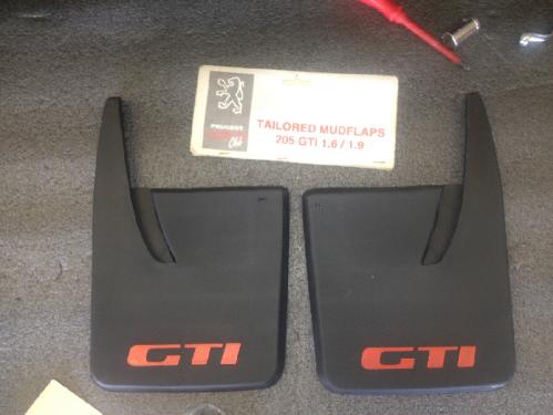

I trial fitted my mudflaps but have decided not to fit them as i think the back looks too busy.

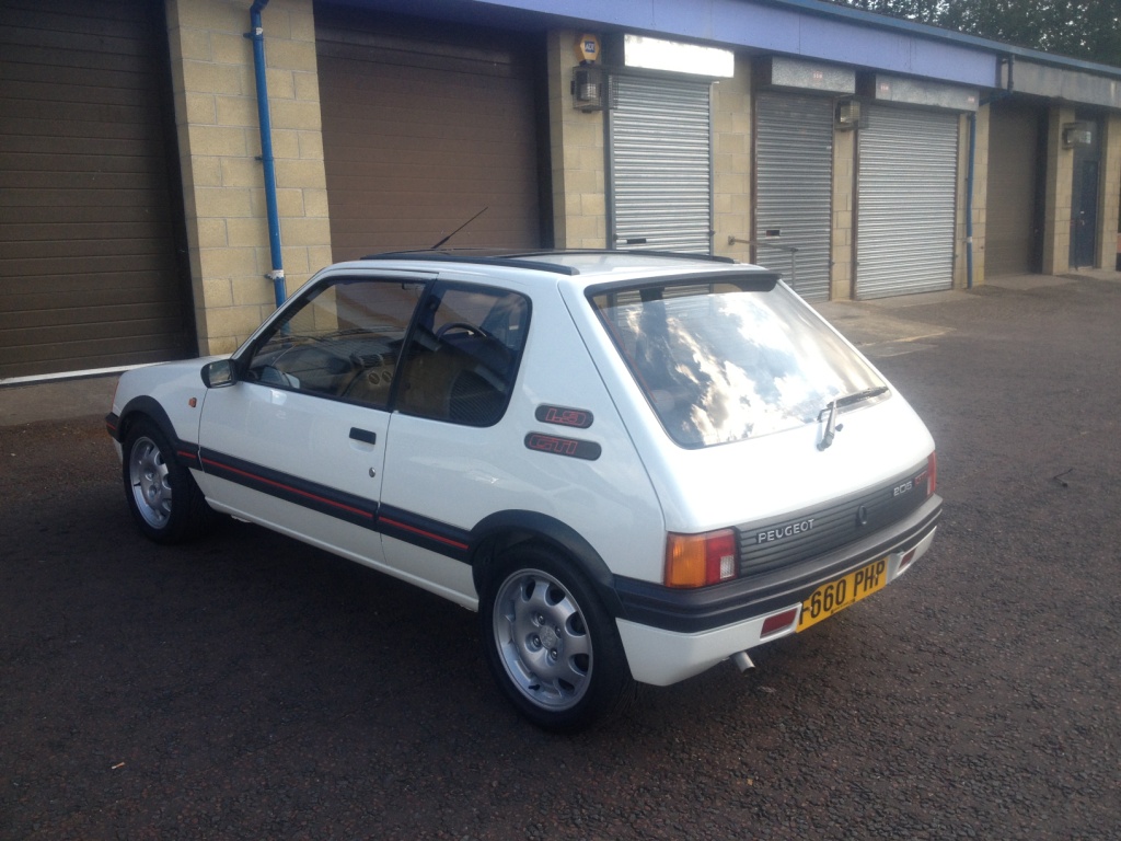

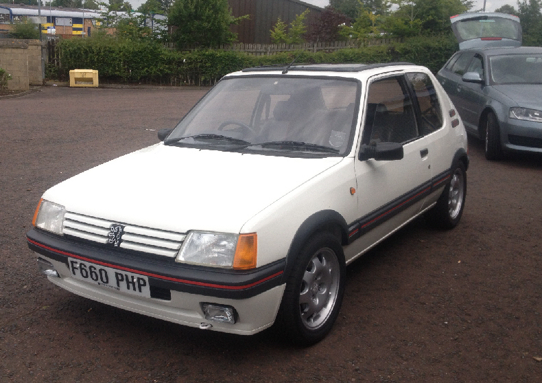

It past MOT first time and is now road legal, and has brought a smile to my face all day.
woooooo hooooo!
