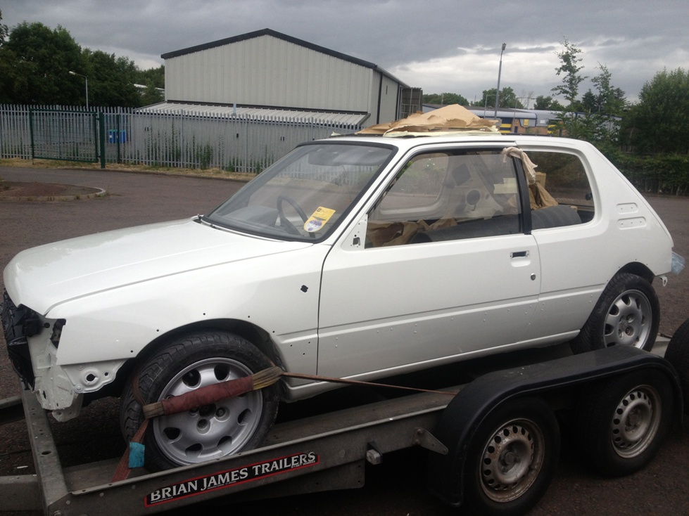

Not much progress on my car this week, other than it went on the back of a trailer and off to the paintshop.
I'd previously tried to get it there via an "A" frame last week..... it didn't work..... don't even try it..... they are far too crude.
But, the guy who did transport my car for me this week, (nephews, girlfreinds, brother) had a look over my car and a listen to what i've done.
He won his class (A1) scottish road rally championship in 2012 (by a lot), in a home built enginbe/car, 141bhp 1.4 Pug 106, (his dad did all my PC'ing and the bit of welding for me).
He was fair impressed by the aesthitics and the parts chosen/changed, and say's "feck a roll cage and a bucket in it and never mind the paint!"
I explained, it's not a track car, and that i'm trying to make something half decent for the road which is capable of going round Knockhill on an odd track day...... and that i don't intend going round the track on two wheels.
Anyway, after he explained the pitfalls of how the extra weight of the 16V, my brakes, the ATB diff, and rear suspension, will all operate together, he's offered to take me to Kames (where it's quiet, but single track) and teach me how not to go into a hedge backwards. He also thinks it's likely i'll need to fit a back brake bias valve. (Fortuneately i've pre-empted this and left spare brake pipe in a couple of places on the run to the rears.)
On a more positive note, he saw the CJ and asked ,,,,, is that the 1360 version?, i said yeah, he said let me know if you want the best out of it, that's the engine i based my engine on.

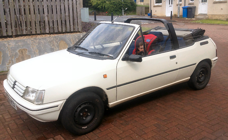

Not had too much free time this week, but what i did have i've put into this little darling.
Had a few decent nights weather wise, so made excuses and popped the hood back and headed for the B roads several times, sometimes accompanied and sometimes not.
I really love this little car, it is great fun. Just now it's a bit hesitant to start, (or i haven't mastered the manual choke) or, which i'm putting it down to is, it needs a cap, rotar arm and plugs etc, but once it's going it never misses a beat and is very eager to please.
Even in this CJ (which most would likely describe as an 80's hairdressers car), i'm swiftly reminded of the nimbleness of the 205 and how it wants to follow the curves and camber of the road. It really reminds me of my old 1.6 from back in the day. It might just be my age/fear, but once rolling i don't think there would be much separating them,....... apart from braking power. The braking power is pure sheet, and going down gears is a must if you plan to stop, i'm not sure you could stop in a hurry!

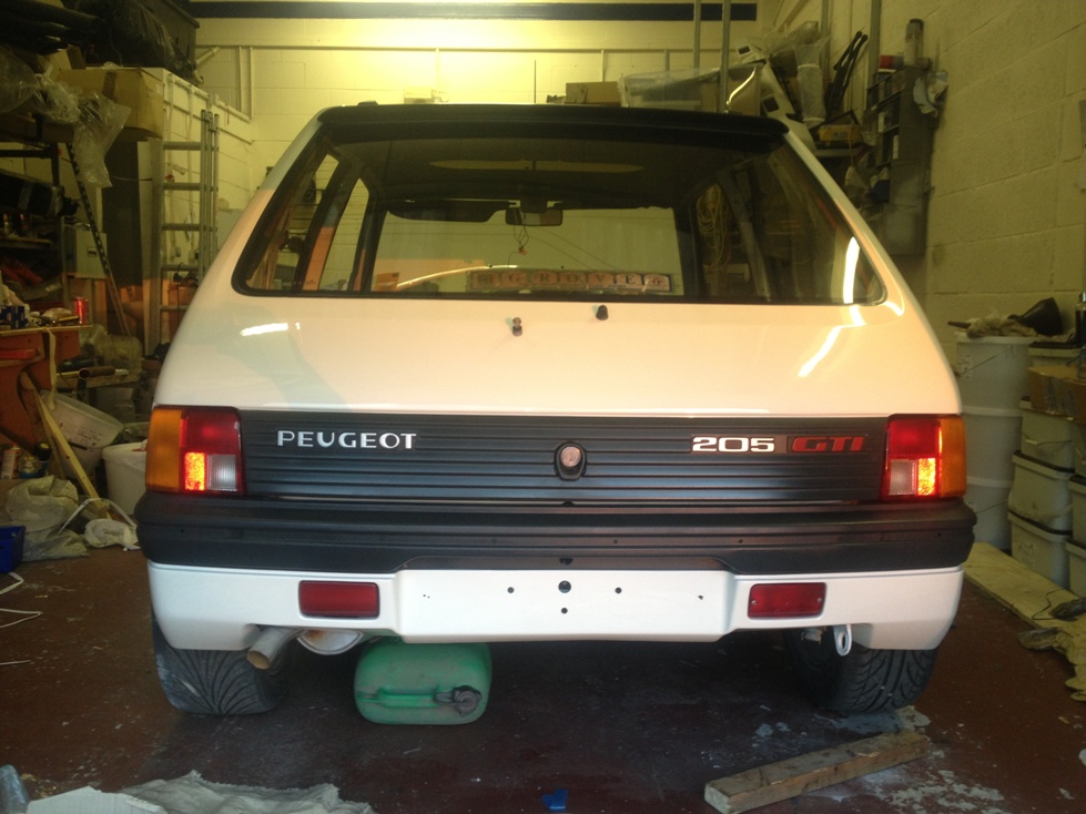

What's the chances of this happening..... cleaned all the windows inside and out and gave the car a wipe, and parked it up.
Went back to the car 20 mins later only to find, not a birds*it, but a (blackbirds) birds egg! splattered on the side of the window, with the shell broken up all over the front interior!
I recon a bird has stolen it from anothers nest and dropped it, or a bird has laid it in mid flight! lol

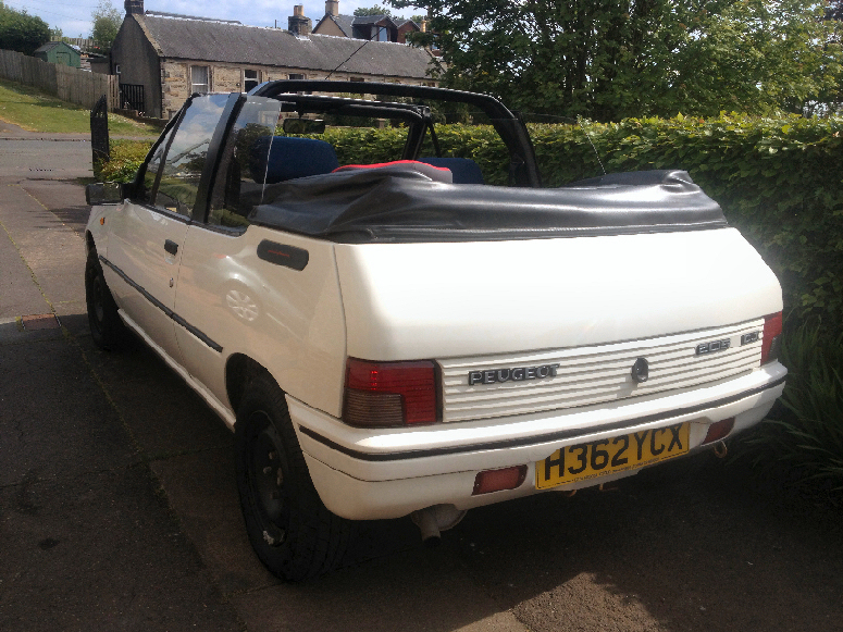

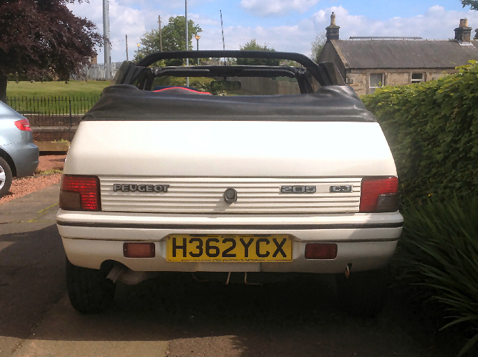

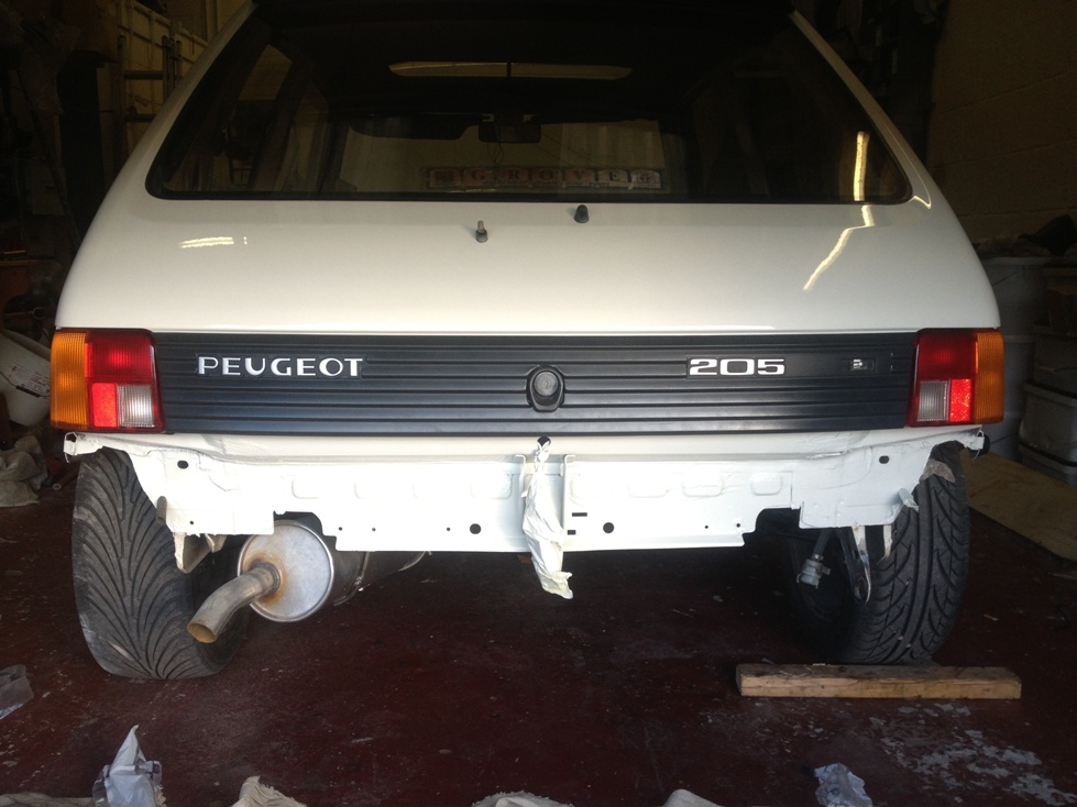

Anyway.... a couple of pics showing how the back end is tidied up with the removal of the tow bar.

Anthony
There's nothing intrinsically wrong with an A-frame and I've towed hundreds of miles using them over the years - most of that has been towing 205's too, the record being dragging one back from Thurso (a few miles from John O'Groats) to just outside London in a single hit one (long) night.
If you were having issues I can only assume that it was down to you either not fitting it properly, the towed car isn't in a fit state to be towed, or your technique is wrong. The towed car will behave differently to a trailer and you need to drive accordingly, but providing that you keep that in mind and ensure that the towed car has steering/suspension/tires in good order they are really nice to tow with I find.
The only reason I don't use it so much these days is that a friend of mine has a decent Brian James trailer that he's happy for me to use and because the cars I've needed to move recently haven't been roadworthy.
Sound like you got a good buy on the CJ though and it's scrubbed up nicely :)
dobboy
Thanks Anthony, I don't know much about A frames, but when I seen the angle one my wheels were at and how close it was fixed to the drop links I called a hault to it, and got it trailered.
Maybe it was that particular one they had, I don't know, a few days earlier they had pulled a car from Dublin to Glasgow on it without any problem but I wasn't happy with mines getting pulled with it.

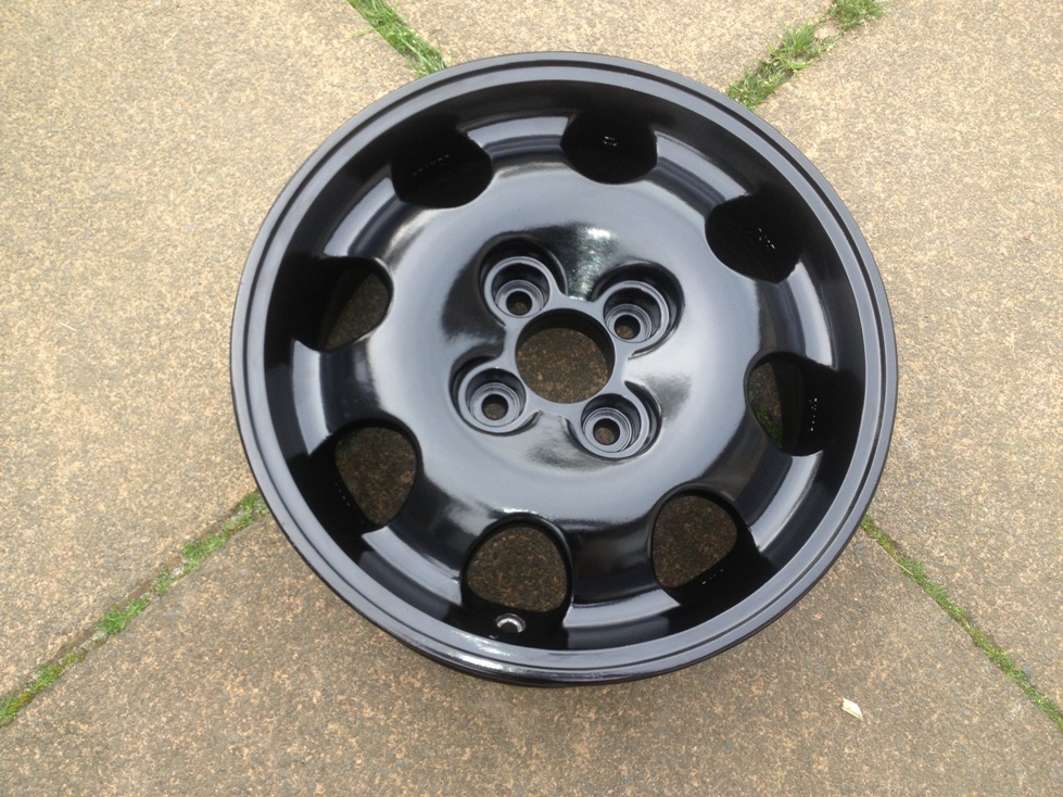

Collected a set of wheels i had had given to a freind to take to work and get PC'd on the fly. They have a bit of orange peel about them as they were bead blasted.
Thankfully the wheels for mine have been done at a wheel refurbishers and are like a sheet of glass.
These ones only cost me £40 quid to get done compared to the £200 mines cost so mustn't grumble.

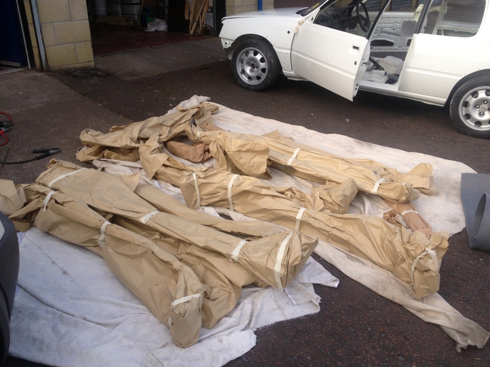

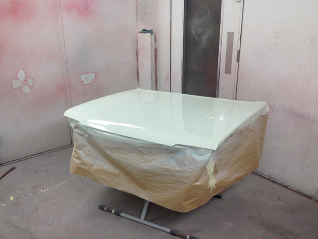

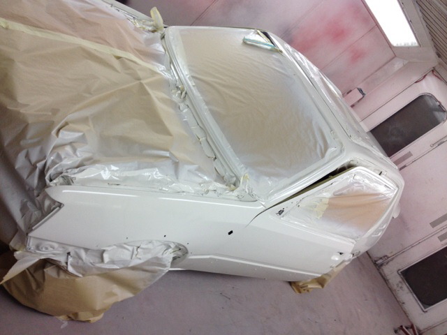

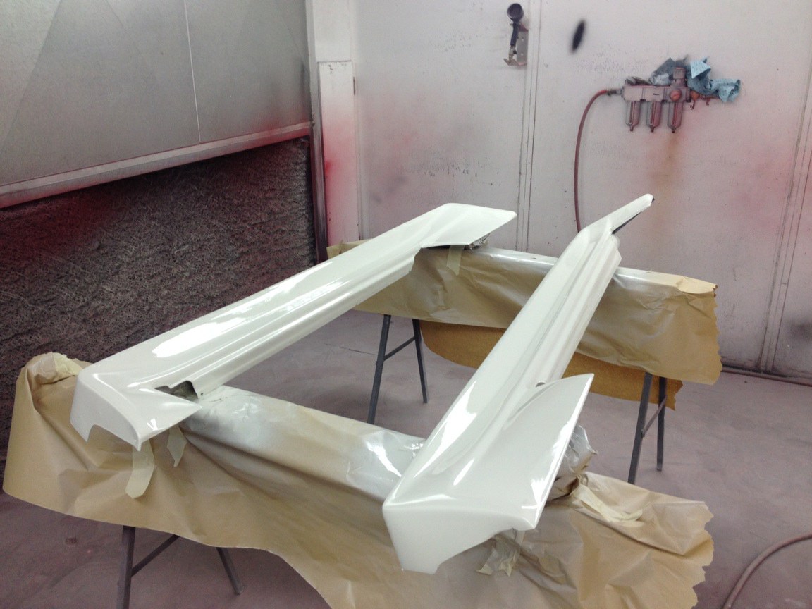

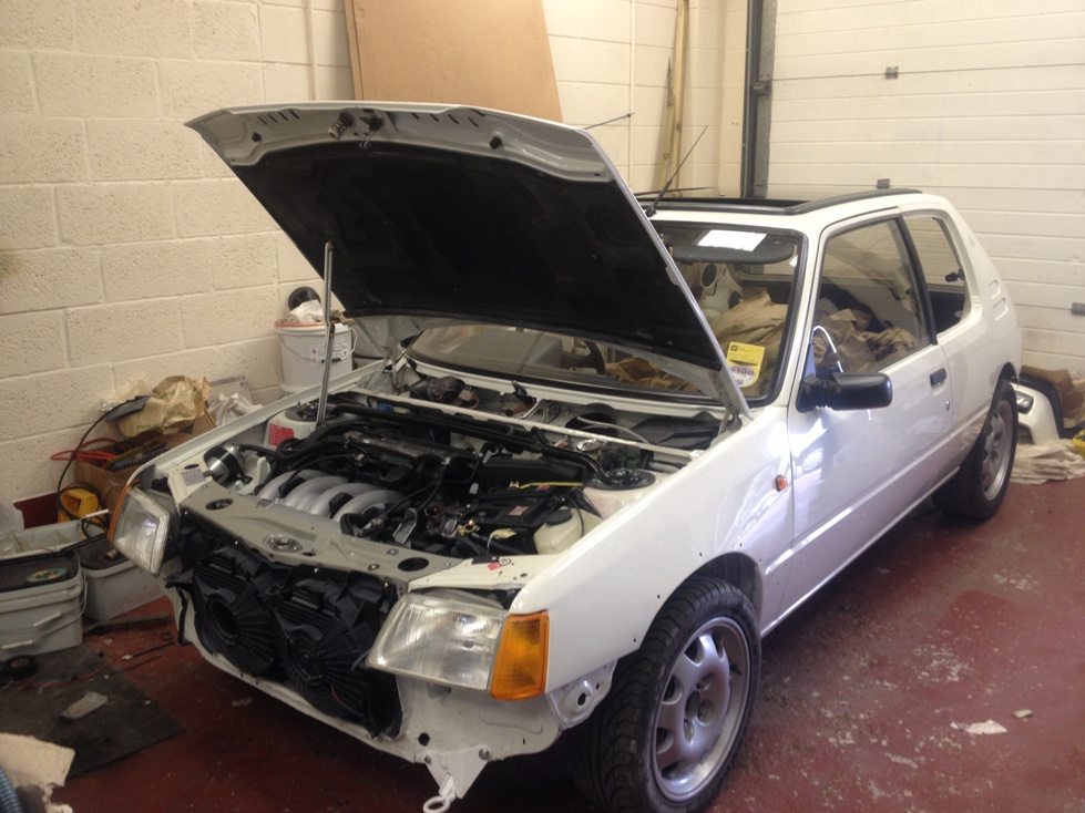

Went and seen my car on Fri night and it's sitting ready to go into oven/booth.
They uncovered some underlying catty/fibreglass on the OS lower back quarter when sanding down, but have cut it out and welded in a plate.
They've also put some kind of treatment on any bits that might cause problems in the future.
The doors bonnet etc are all off and sitting on stands, prep'd and ready for painting too, and there are a lot more dings than i had thought that have been fixed right accross the car.
The painter said he managed to get a deal on some kind of paint, which he was surprised about and stressed was top stuff.
He showed me the mixed paint (code EWT), and we compared it to the car, and to the CJ too. It looks white, until you compare it to something that is white. Far from being white it's more a concretey/milk colour.
We also agreed what colour i want for my bumpers/kit etc, I used the back of an unfaded bit of trim to show him, and he txt me on Saturday to say he got it mixed.
So far i'm really happy i chose these guys as they seem to be trying to do the best they can and make the paint job last.
Here's how my skirts look

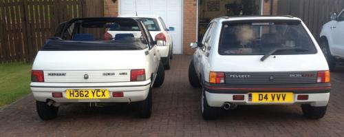

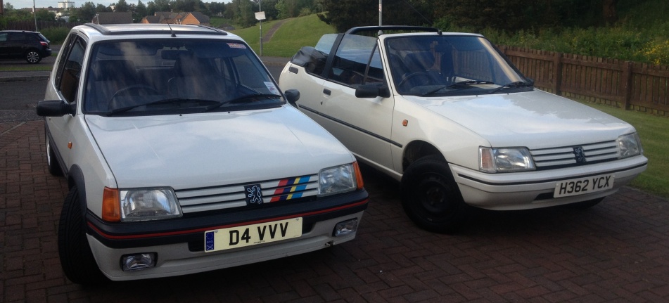

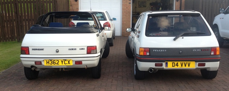

Went over to see "happypatrol" from this forum and we had a wee blast of each others cars. He's put a load of work into his and it's looking very healthy/smart indeed, inside, outside, and underneath, and it drives great.
Had to get a shot of CJ and GTI together.

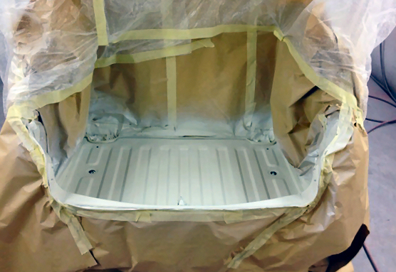

boot floor now painted.

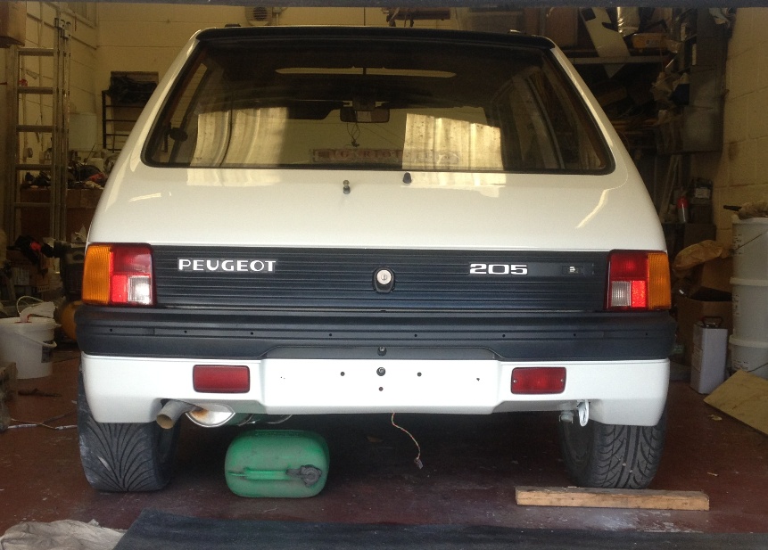

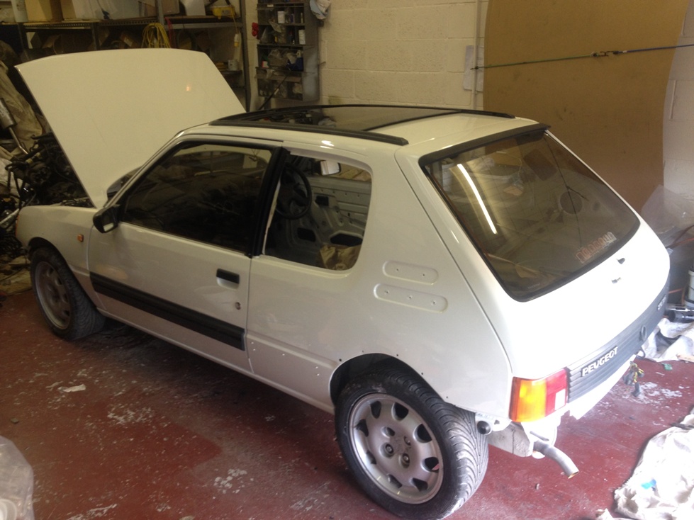

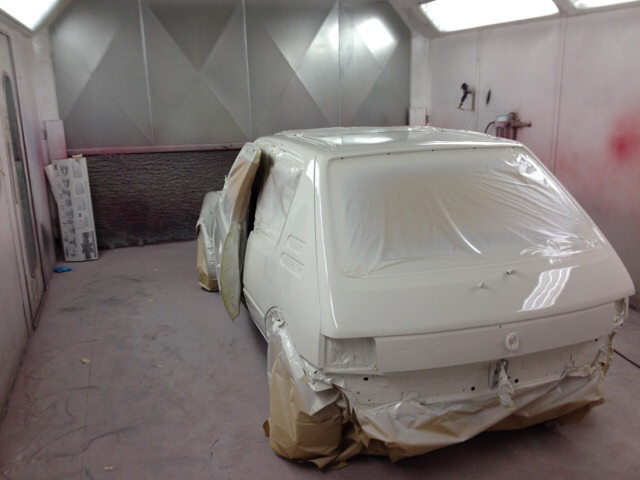

Collected the car as planned on Saturday, and to my relief i am very very happy with it.

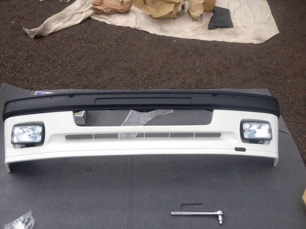

And all the trim painted.....
dobboy
Blew the car out with a compressor, and set about the rebuild.
dobboy
Managed to crack both lips of the tailgate trim......but the painter has more paint left, but will try glue first.
Looks like it's beginning to take shape (after a full day at it), and i couldn't be any happier with the colours of trim and the paint job on them. Any little nicks were flattened and a haze of texturizer put on.

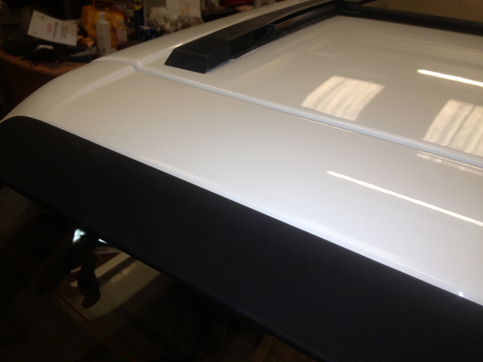

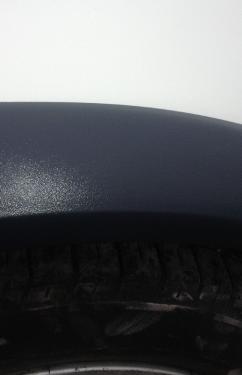

GLPoomobile
Can you get a close up of the trim to show what the texture looks like now?
dobboy
GLP, this photo i have at hand sort of shows it.... the bright bit is my flash, the trim has very little sheen, but you can see the texture.
I'll try get a better pic next time i'm at the car.
I also got my mirrors done in black (without texture), and the roof spoiler (not sure if he added any texture or not).
All the plastics look like new and the painter is confident it will stand the test of time.

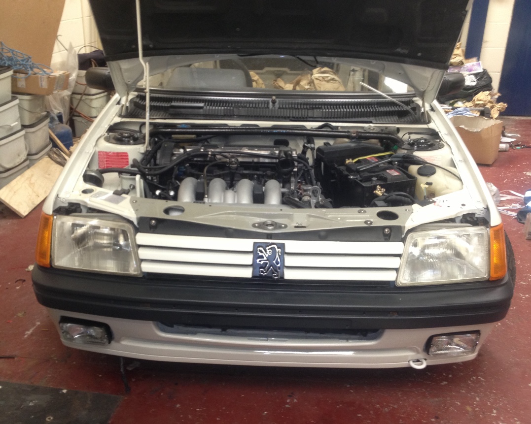

Fitting the scuttle panel has been the most difficult job since getting the car back. I ended up running a bit of 1.5mm wire under the window rubber, and fitting it like a windscreen.
So far so good, but think i'll need to get exhaust adjusted as its sitting a bit close to rear valance for my liking.
My refurbished seat should be here on Monday, and all the interior is sitting power washed, cleaned, and treated.
dobboy
Some progress.....
