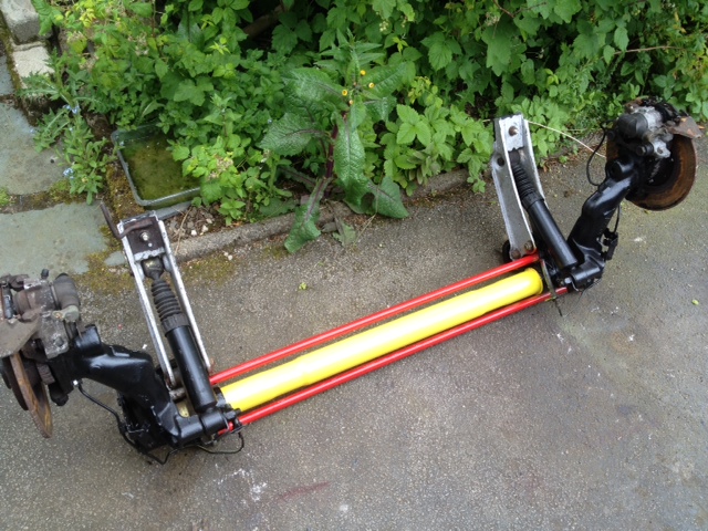

Had a whole weekend scrabbling round under the car! Dropped the rear beam, which has been replaced from the original at some point - I assumed it was a 1.6 beam, but turns out it was a boggo one! Anyway, removed the beam and then spent a very unpleasant day grinding off old underseal, removing paint, rust etc. The rust was fairly superficial at least. Then applied rust stabilzer, then Epoxy mastic, then Tetrasyl underbody chip guard, and then a light coat of body colour.
I bought a beam on here which had been refurbished with 306 arms and shocks and slightly lowered. Before fitting this I cleaned it up and painted it (black arms, yellow tube, red torsion bars). Got it all back together last night, with new brake pipes, brake hoses, handbrake cables....just back plates to fit now. Perhaps not as pristine as Tom Fenton's recent photos on this thread, but a definite improvement!
chipstick
I also fitted my new beam today. Was annoying to find a couple of marks on the paint from jacking it into position. It's funny how you spend ages painting everything up, but for those 15 minutes of fitting/occasional wrestling you no longer care about marks and just want to get the thing located and the nuts started :lol:
I'll be touching the marks up in the morning though ;) I did laugh when the wife piped up saying why did I bother painting it all when you can't see it. Her exact words then were 'maybe if you ever roll it over people will be able to say how pretty it looks'. Let's just hope it remains hidden from view.
Shame you live so far away, i'd get you too come and do under mine..... :lol:
hoodygoodwood
Dropping the beam and tank then sorting the rust in the floorpan is the best thing you can do for your 205/309 , if they have not been done already they will need doing soon before the rot takes hold .You've got peace of mind for 5 to 10 years now in that area .Its cheap to do but a bit time consuming to do properly , although the brake lines will usually need replacing .
Ordered even more nuts, bolts and washers for my beam from Peugeot today . Put a 2nd coat of blue engine block/caliper paint on my front brake carriers hopefully they will suit the Miami well .
