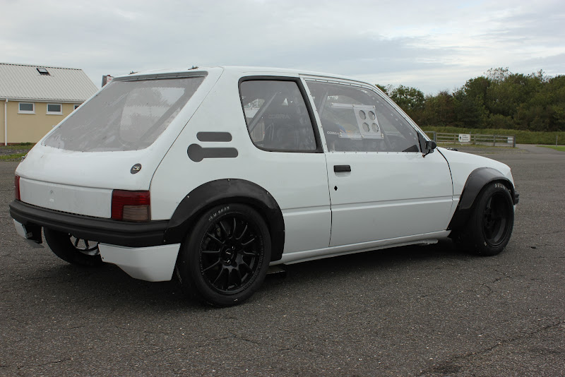

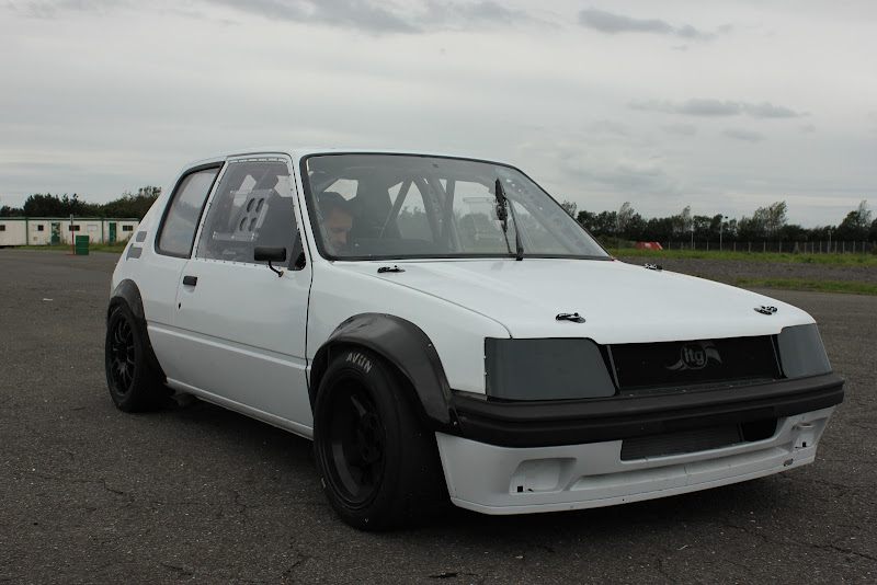

The front end was still raised a bit from the rollers, but Colin just wanted to get out there and do some laps, in case there was a problem. I had to hurriedly tie up the loom and fasten the switch box while warming the engine up. Dave changed from the "road wheels" to the slicks on the front and we were about ready:
https://lh3.googleus...00/IMG_0947.JPG
https://lh4.googleus...00/IMG_0951.JPG
Out he went for the first stint and after a few brake dabs to be sure, it wasn't long before he was squeezing the throttle properly on the straight, what a noise; I knew it was likely to sound nice, but I was not prepared for this, an absolute wailing, searing, complex, high and low pitched induction bark that simply made me emotional. Yeah there was alot of emotion involved, we've worked so hard to get it to this point, but despite all my assertions to anyone that would listen over the last few weeks, that I'm seriously considering whether I'll continue building engines (due to the stress, hours and general lack of sense in trying to earn money doing it to the standard I want); suddenly I remembered why. This is why.
https://lh3.googleus...00/IMG_0958.JPG
Colin only did about 3 laps, the super soft Avon slicks are made to work from cold and and any heat build up can destroy them. A cursory look over it and amazingly, it all seemed ok! That must be a first. We had witnessed some blue-ish smoke at times on the straight under the hardest acceleration, there didn't seem to be any reason why it would be burning oil, it hadn't until now at any time and with dry sump it's not normally an issue. There was evidence of tyre rub on the back from the old arch, which may have occurred under extreme squat loading! So hopefully that's all it is.
I asked Colin what it was like and he said fast, really fast! 1st-3rd it won't really take full power, but if you "let it have it all" in 4th and 5th, it tore forward. He was nearing the top of 5th before braking, about 120-125mph.
https://lh3.googleus...00/IMG_0983.JPG
https://lh6.googleus...00/IMG_0985.JPG
https://lh6.googleus...00/IMG_1006.JPG
https://lh4.googleus...00/IMG_1007.JPG
https://lh4.googleus...00/IMG_1009.JPG
We managed three more stints before close and coming in off the last session, we thought if we'd had all day, we might only have done this much. The tyres were on the edge of reason, we knew it worked and we were all very much in the mood for KFC!
