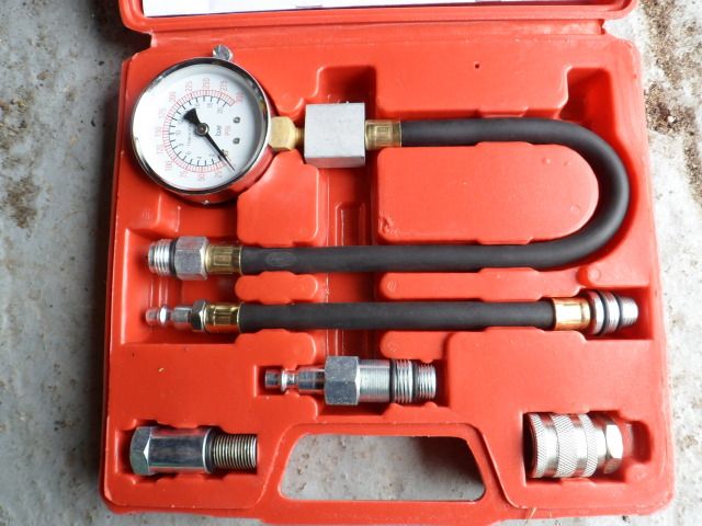

Now onto the engine..... my compression tester turnt up this morning so i though id give it ago, it only cost me £11 off the 'bay but i thought it would do the job..?

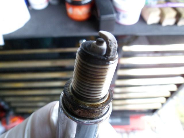

On removal of the first plug i was left with this. They all looked the same and are gapped at 0.85mm
After a quick comparision in the haynes manual, it would imply my car is burning oil...... lol
I followed the instructions in the manual for testing but i dont think ive done it right somehow, my process was
Remove all leads from plugs
Remove all plugs
Remove main power supply to coil pack
Remove power supply to injectors
Start on cylinder one and work over to four
Turn the car over until the gauge stops (turning over for no longer than 15 seconds)
The results where poor to say the least, the first three cylinders made 75 psi (5bar) and the forth cylinder made 73psi (4.9 bar)
It said in the haynes manual anything under 10bar is poor, but my results cant be right as with half pressure the car wouldnt run at all surely..?
Opinions anyone..?

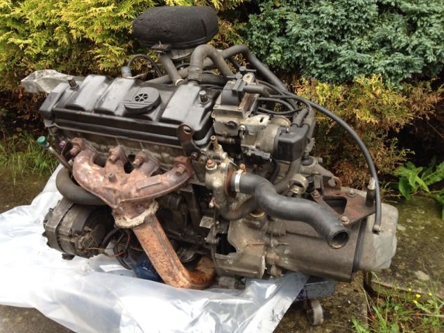

Set off to Windsor this morning to pick this up,
Its a 89/90 alloy 1360cc XS engine producing 85hp, the engine ive been told has covered less than 100k miles but even if its done more it dosent concern me as its coming too bits..
It came as a full engine with box, exhaust's, shafts all ancillaries and two carbs. I just need to check the codes to see what gearbox it has etc..

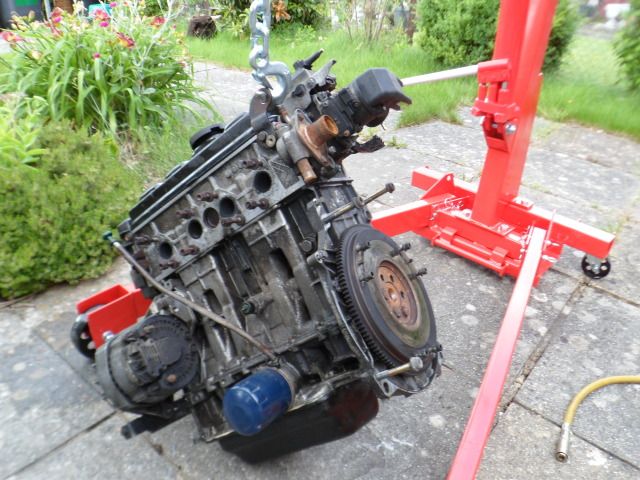

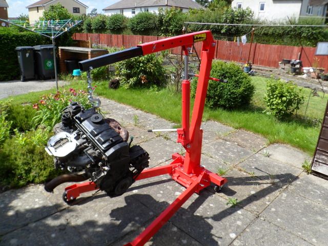

Bought my self an engine crane and stand today as lets be honest building and fitting engines is nearly impossible without them lol..
up up and away,
having these allowed me to crack on well i say crack on i didnt start until two as i was late getting up as i didnt get in until late this morning :panic:

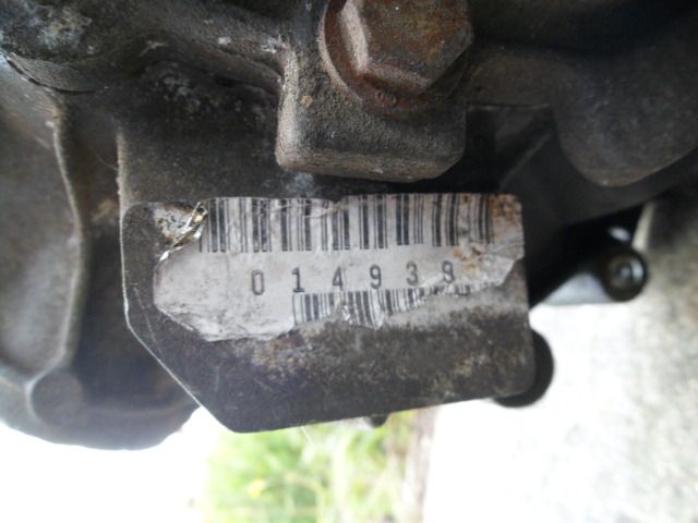

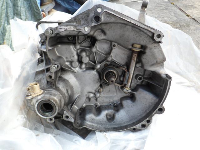

box came off with ease, i cant find a code engraved on it like my rallye box but found this if anyone can identify it off this..?
and the shape of the bellhousing,
end of play it didnt really come on far, that wasnt out of choice but more the fact my windy gun stopped working so i couldnt get the last three flywheel botls out :wall:
wedge a big screwdriver in the ring gear and just use a ratchet :)

stop slacking and get on wiv it :P you don't need an impact gun.
afaik that engine should be the same bellhousing as a 106 as its an 89, pre 88 is when TU bellhousings were different.

lol... i havent used it yet but i dont know anyother way to get the fly wheel bolts out with the windy gun and didnt understand your comment tbh :blush:
I hope so, thats why ive taken that photo to see if somone more clued up could tell me.
If i cant fit my box id like to fit a BE box which ive started a thread about.

What welshpug meant is use a big flatbladed screwdriver to jam into the flywheel teeth, in order to stop the flywheel turning, and then use use a ratchet/breaker bar on the tight nuts :)
Miles
Easy to swap bellhousings if you need to, Got a 1.3 Rallye box at work which I think I may have claimed
MiniGibbo
Yeah I was hoping I could swop the front half off the xs box onto my Rallye box.
