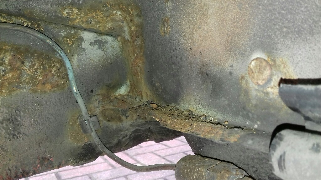

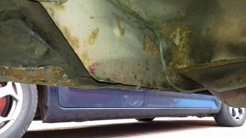

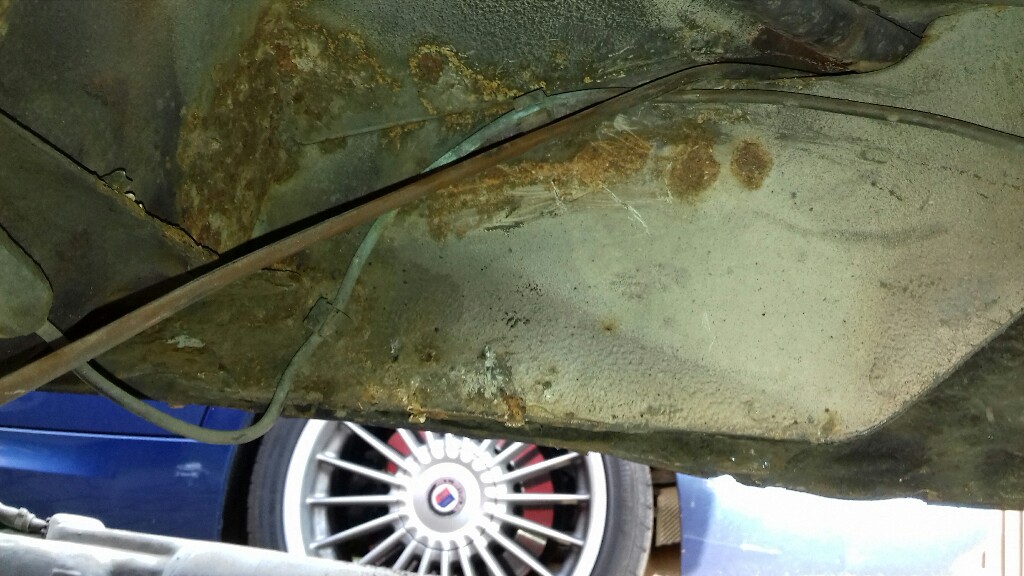

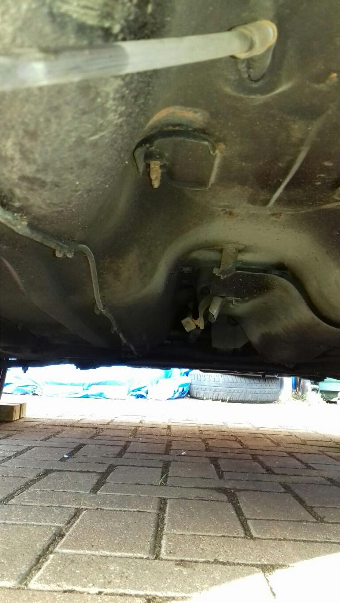

tanks out and heres the results:
Telf
so theres a hole as can be seen on the top right picture but most of the tank enclosure seems to be surface rust.
Not sure how to proceed! I'd been set on ripping the sills off as I know there is a hole in both. they both have a hole in the space behind the rear side trim(were the seatbelt emerges from). I haven't yet stripped the interior.
So do I keep and try and repair the original sills or go for a new set? I've had various advice- some think keep and repair the old based on they are made of better metal?!? Apparently the new pattern ones aren't that great?
Any thoughts on this from the various folk that have restored and repaired this area?
I'm not wanting to turn this car into a concourse shiny example- I use it daily so just want to keep it in good nick- if I make it too shiny I'll just get precious about it!

If you're crapping yourself about that amount of rust I hope to hell I never take a look under mine!!! From those pics and what you have said it sounds like normal age related wear n tear.
Look forward to seeing how you tackle it.

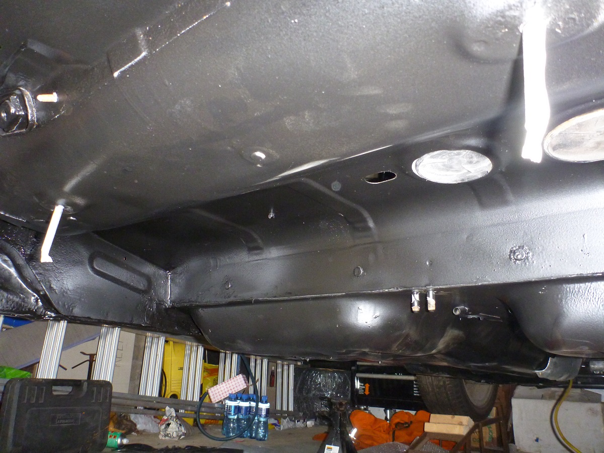

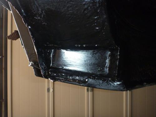

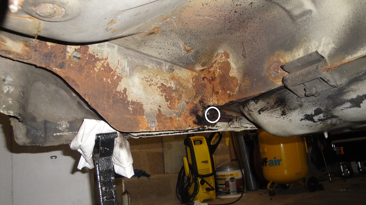

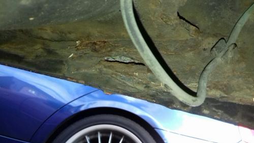

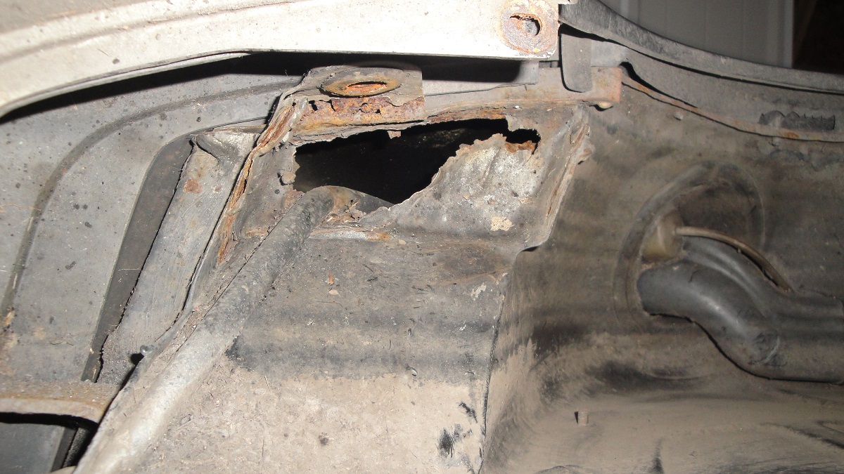

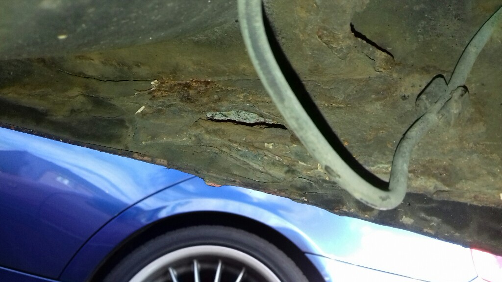

That level of rust looks to be near identical to mine when I did the floor pan a couple of years ago and funily enough, I had a holes both side in much the same place (marked with the white circle) which has since been welded.
I also had to fabricate and weld in a couple of repair plates as per the 2nd & 4th photos (then the proper repair sections became available)
I then used a wire wheel on a grinder to clean up the rest and treated the area with FE123 before spraying with Epoxy Mastic. It still looks good today (although it has not seen much action since)
