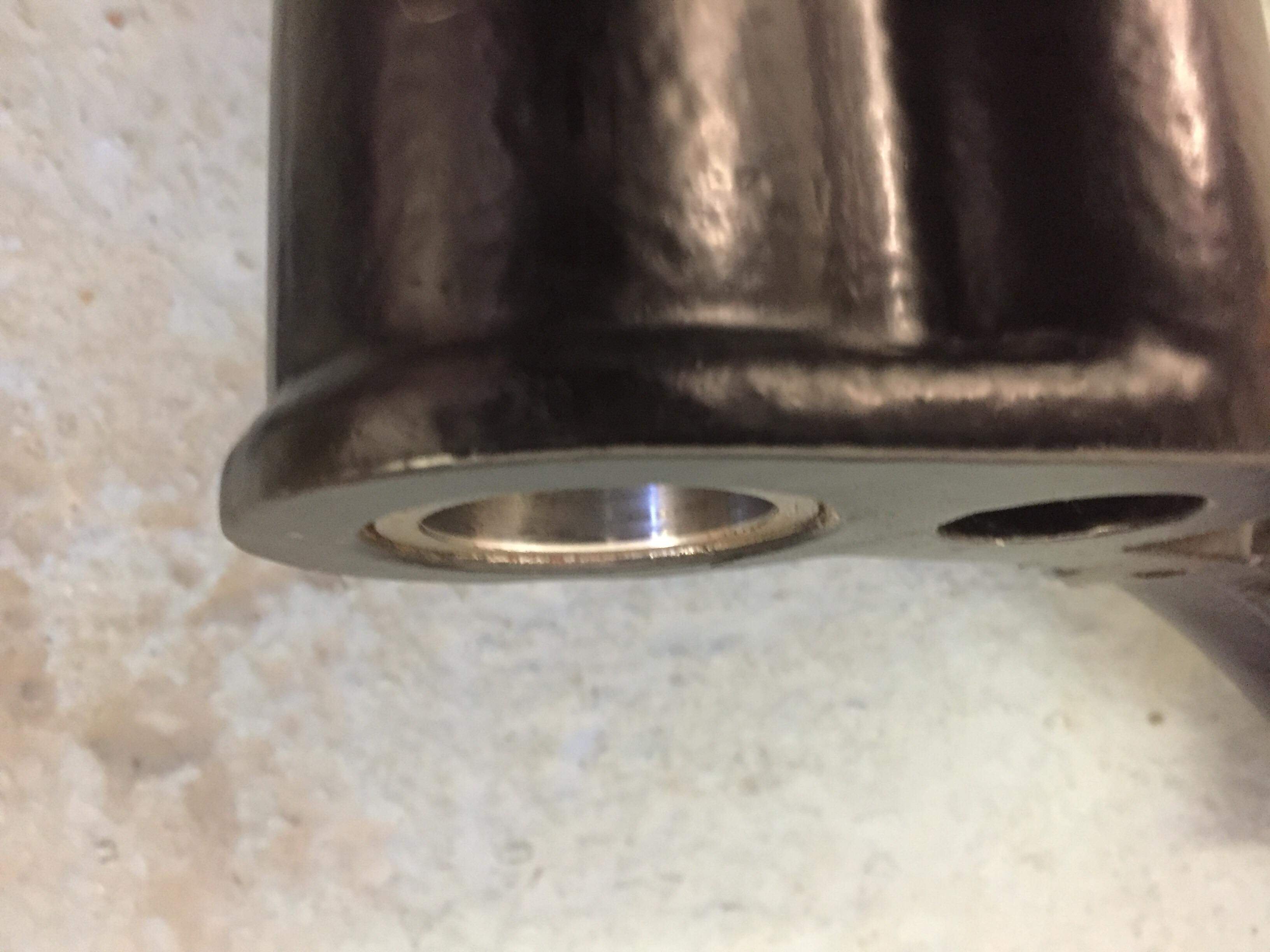

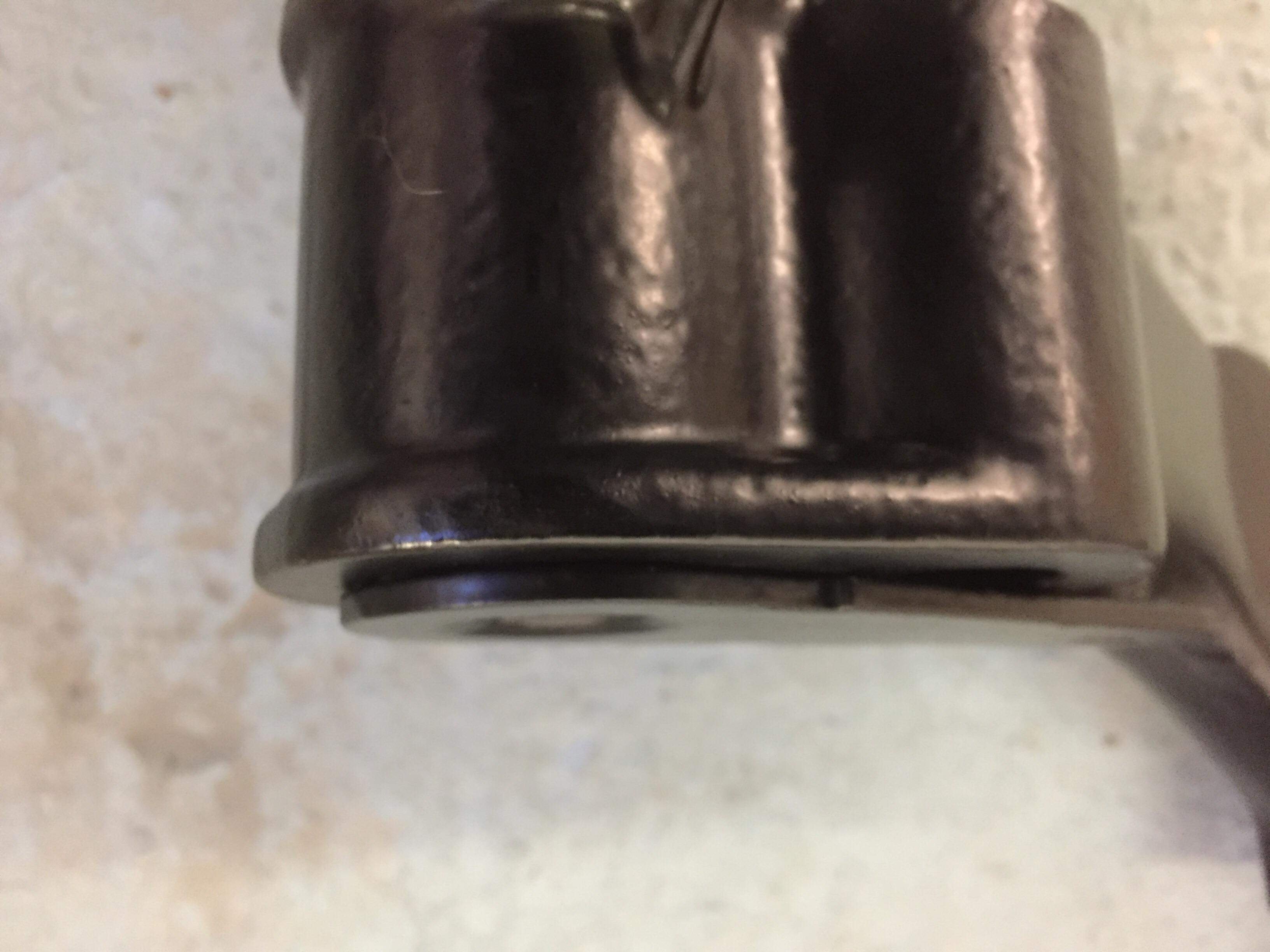

That powder coat needs removing from the front hub disc mounting face and wheel spigot. The wheels won't go over it for a start, and the coating on the hub won't let the disc seat properly either.
The trailing arm shafts are pressed too far into the trailing arms. There is supposed to be a rebate for the anti roll bar end plate foam seal to sit in. If you build it like that the anti roll bar end plates will sit too far out and rub on the tyre sidewall.

1 hour ago, Tom Fenton said:
Not trying to pick fault but be constructive here
Hi Tom, thanks for the info- I'm posting these pictures up here because I'm fully aware that I might do something wrong so any comments are very much appreciated !

-A-
if that shaft is 2mm inset then yes that is spot on.
