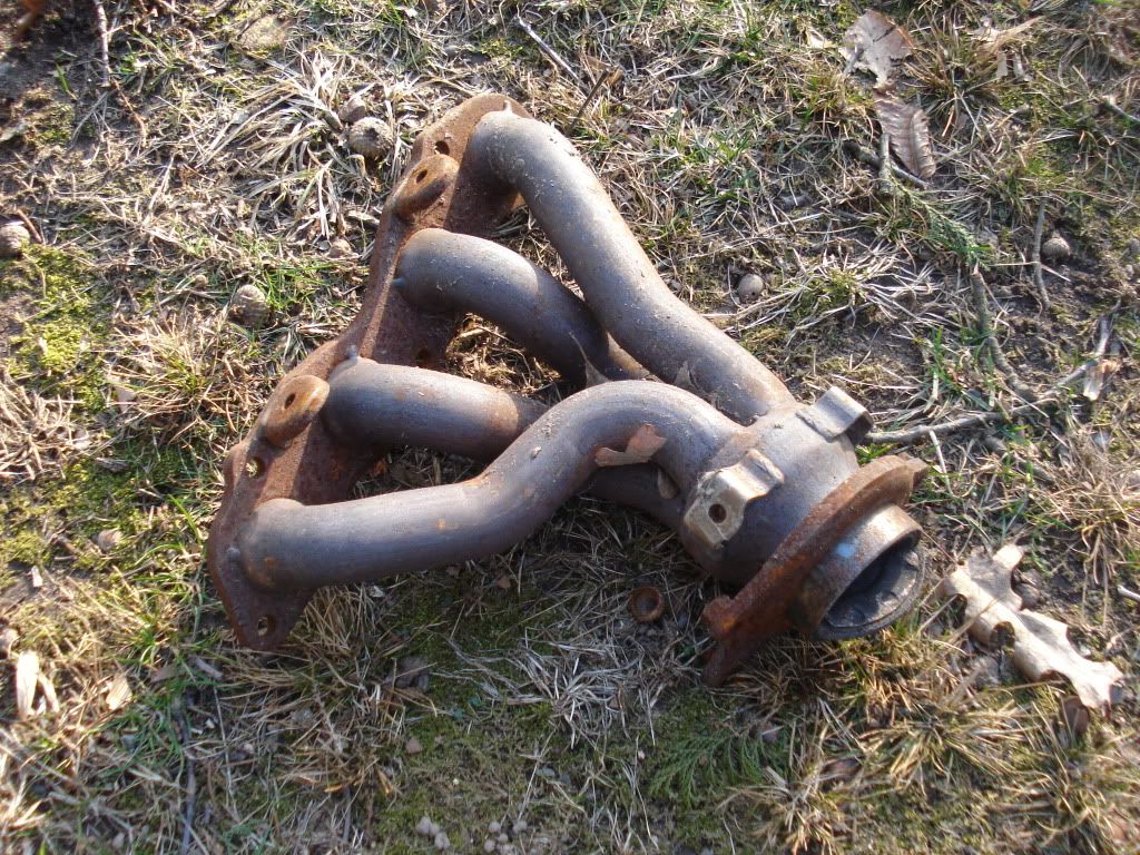

Won this 4 branch last night.
http://m.ebay.co.uk/itm/391059514117?nav=WATCHING_ENDED
They have buy it now at £179 and also run lots of auctions, I was determined to pay under £130 and I missed out on about 4 by now. Got this one for £109! Can't moan at massively produced tuning parts prices
looks allright, what does the standard one look like though? bargain price!
rallyeash
It looks less flowing than a GTI6 manifold, not sure if it is however.
I would of preferred a mild steel manifold as I may look to chop the end off this one and extend the secondaries but I'll measure them once it arrives.
I was struggling to re angle the K20 manifold enough to get it to work.
Powers
From my experience that manifold can be modified to fit quite well.

This is your standard K20 offering
you could always get a small reel of stainless wire and some argon, I did a magnex manifold :)
Powers
I meant the one that you have bought on eBay.
rallyeash
Yep :) hoping it isn't going to just point directly at the subframe like the standard K20 one does
