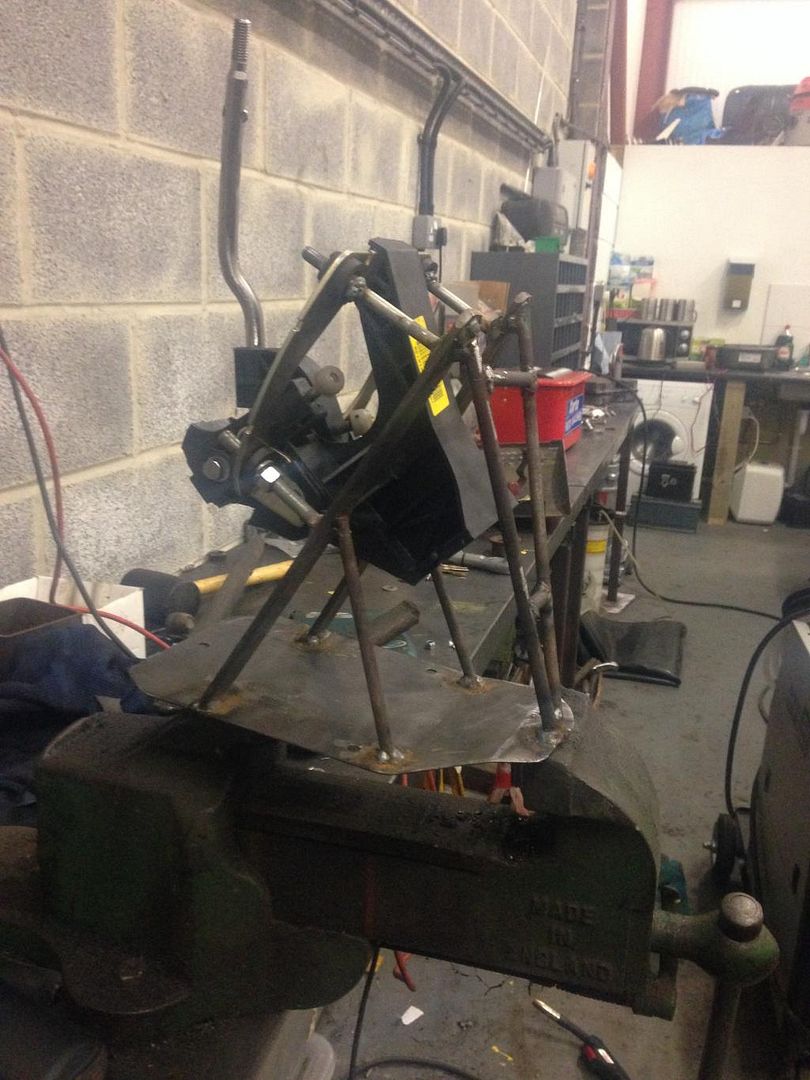

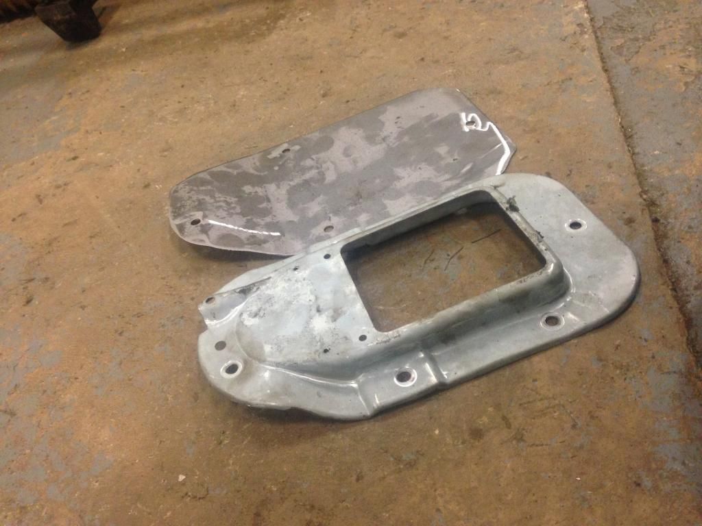

Made a new plate to cover the original hole
Then after a few hours I had this. Completely a bolt in job

j_turnell
Very cool project and credit to you for taking it all on, it's looking really good. How much does that gear stick assembly weigh? I'd have been tempted to mock it all up in aly and get it tig welded up. Maybe could re-use the original cover plate and just blank over the hole.
Next to nothing. It's 2mm sheet and 8mm bar.
