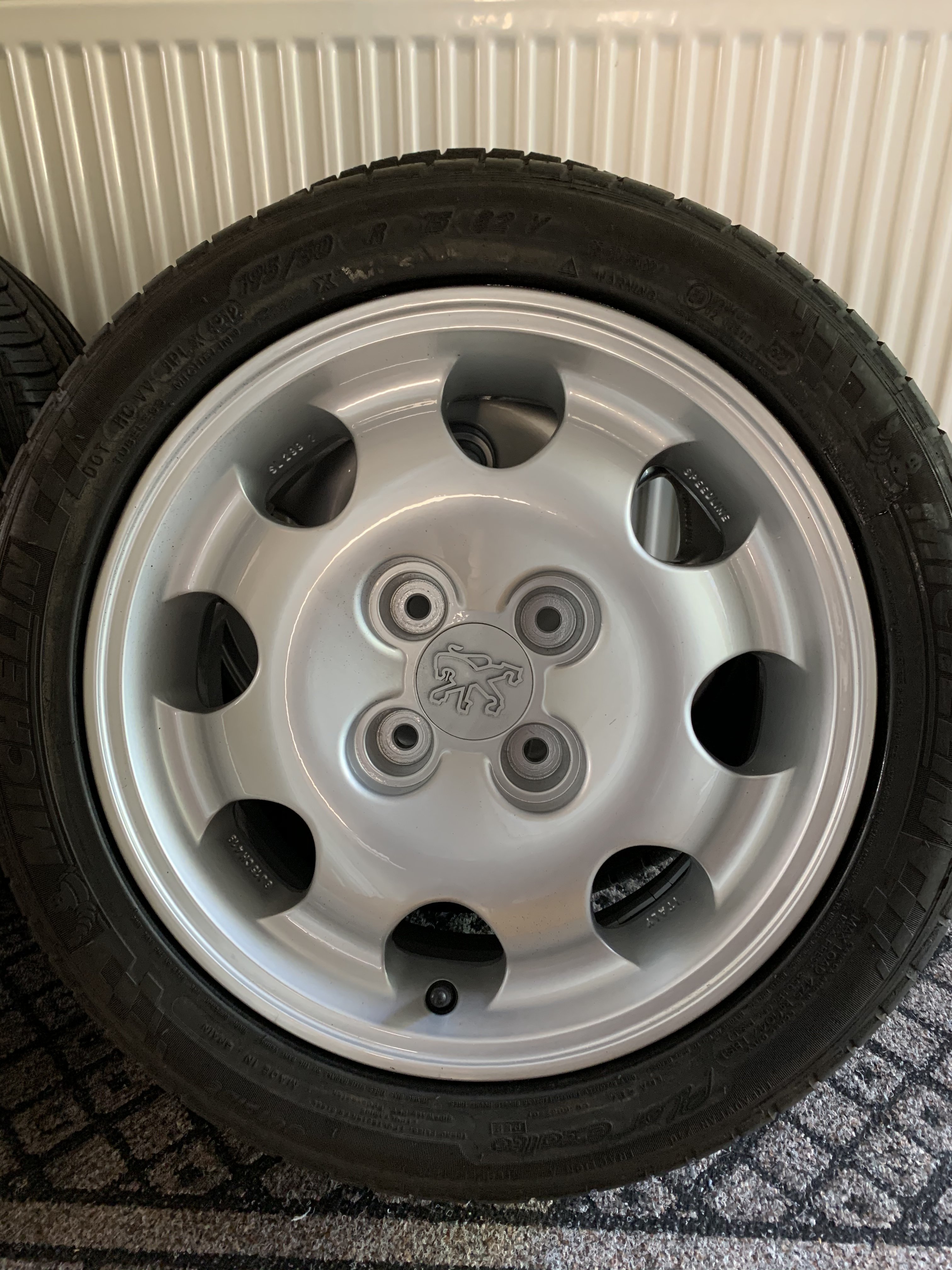

Imaxle rear beam arrived. Gutmann mesh wheels almost done. Hit 360.000km's on the clock, still going strong :)

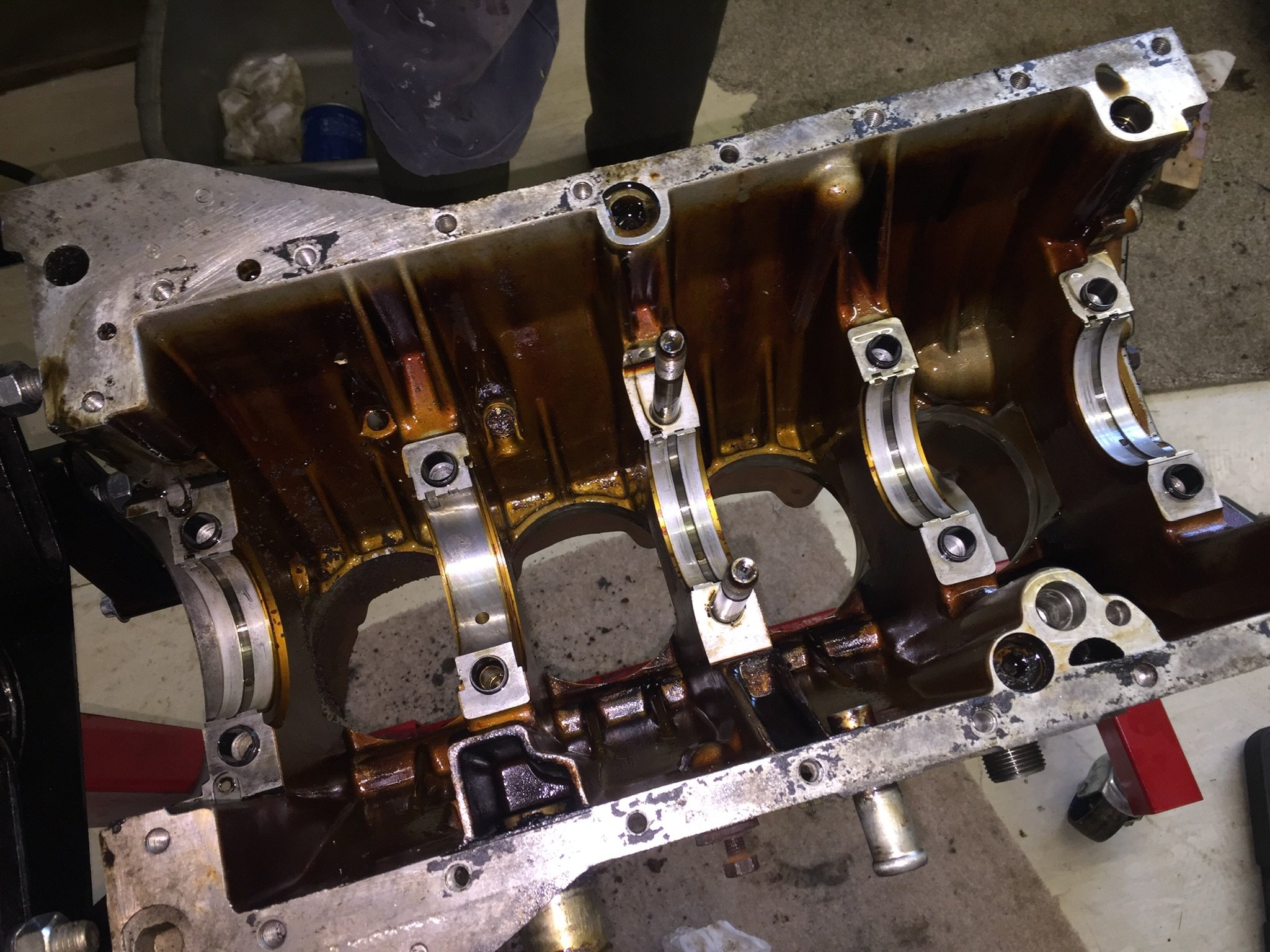

Engine is out again. Something went wrong on the rollers. Another vinter project.
Philpooma
55 minutes ago, mmt said:
Thanks :-)
Thats bad news, sorry to hear it.
I’m just about to rebuild my engine, so I hope that I dont have to do it twice.
I hope that you find what the problem was so you can avoid it happening again.

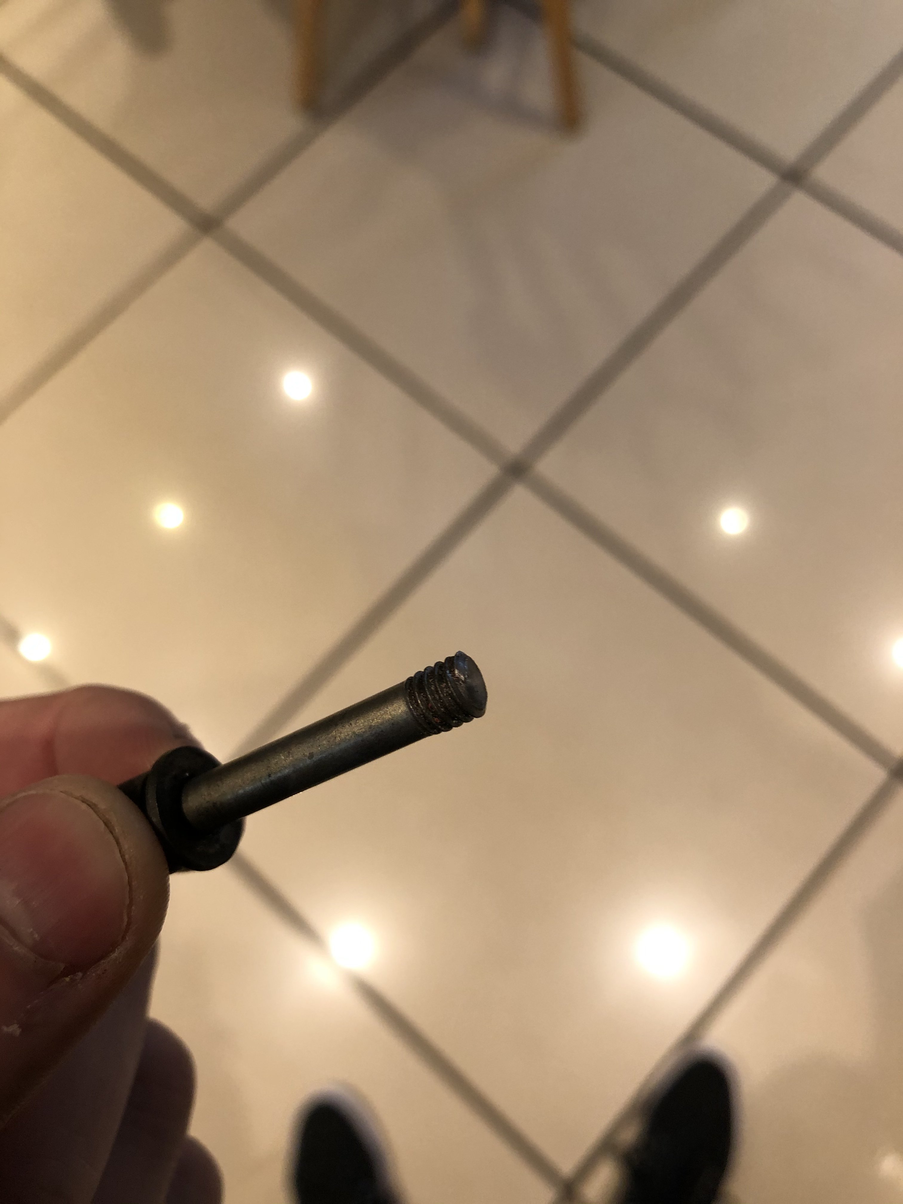

Snapped a bolt in my inlet manifold. Swore a lot, locked garage and walked away 142CF7DB-AF75-434F-9D0E-E23998EEA231.thumb.jpeg.d79a040a5eb9496470316ac08ec301fd.jpeg

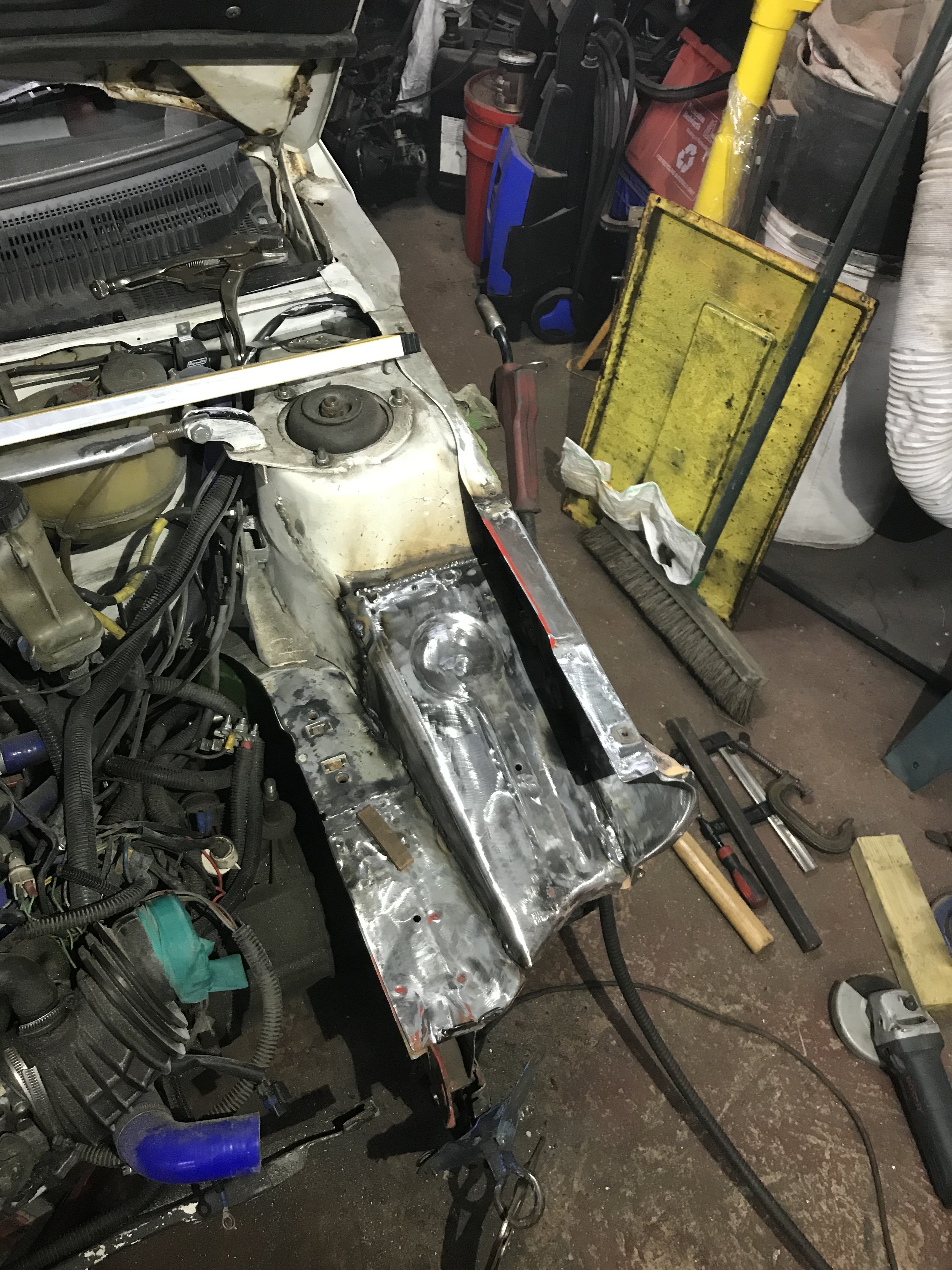

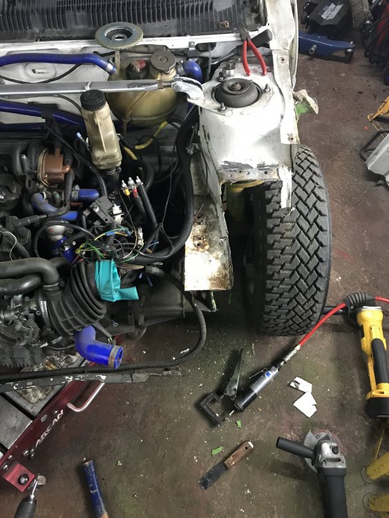

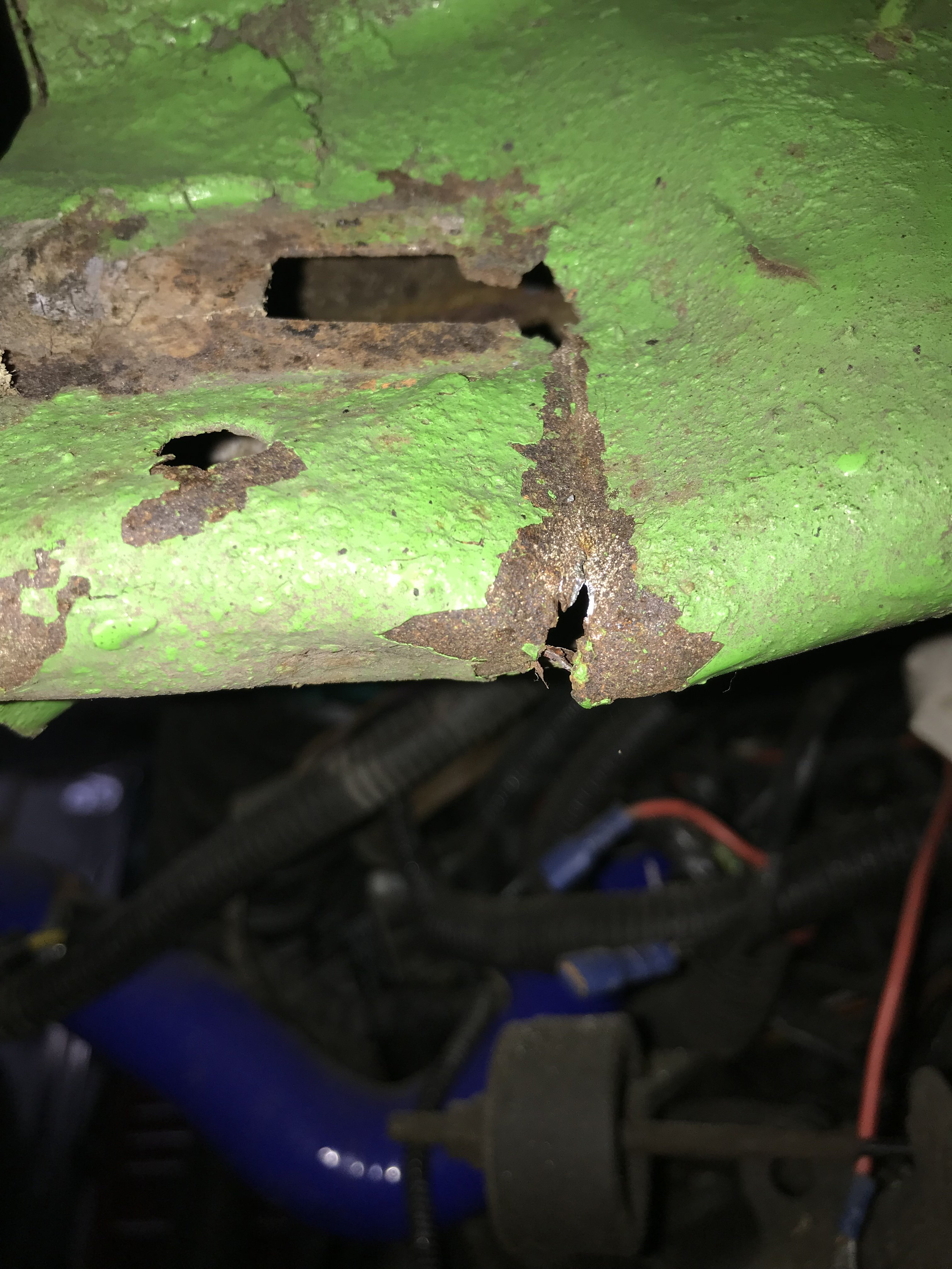

13 minutes ago, Andy said:
Err. What happened .
A previous owner had crunched that corner, not horrendously, but the leg was already kinked slightly.
When I bashed the sump guard on the last event I did (hard enough to bend the cross bar, which is 2-1/4" by 1/8" wall CDS) that front end of the passengers leg cried enough.
Kawasaki green was not me!

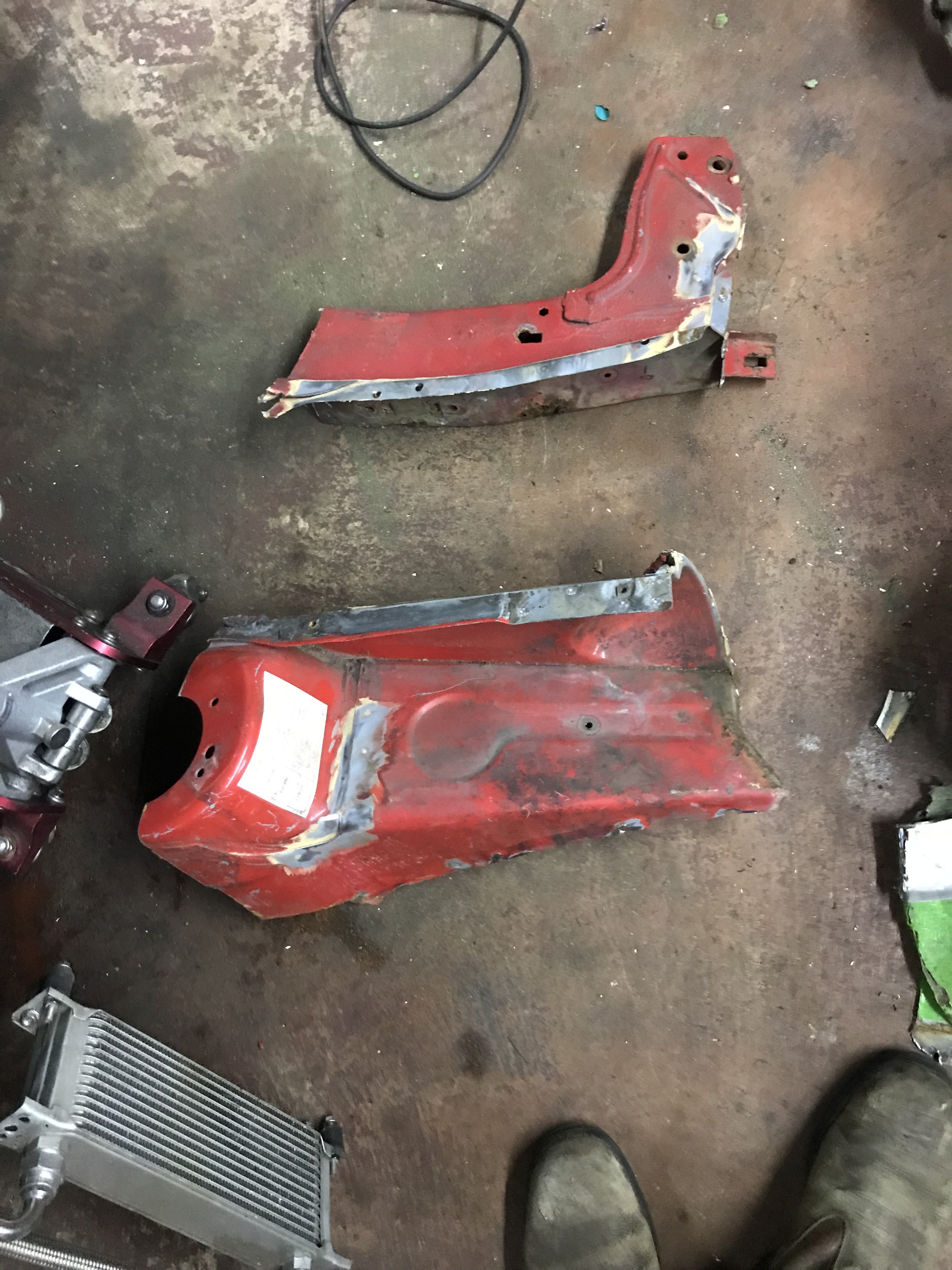

Steve C broke a CTI a few months ago and kindly lopped the front corner off for me. A few hours carefully unpicking has yielded these sections. More trimming to do to make them fit nicely. I was initially thinking to try and fit it as one lump, but it soon became apparent that would be very difficult if not nigh on impossible. The headlamp panel wasn't in the best shape, and replacements are cheap enough and easy to get hold of. With it split down I can make a good job of trimming and fitting the leg, then piece the inner wing etc back together.
I tell you one thing, when you start splitting it all you realise that there are only 5 spot welds holding the inner wing to the chassis leg !!
Andy
Impressive surgery Tom. Point taken regarding the spot welding of the inner wing to the leg . When I was ‘doing’ my engine bay and replacing the headlamp panel, I added a few stitch welds to that joint on both sides as I thought that the joint was pretty flexible.

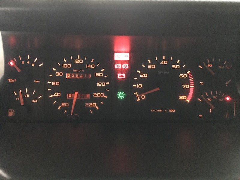

AlexRS2782
Nearly 1 month since Miles did the heater matrix, tacho relay, etc, finally got the chance to take it for an extended (4 hour) run.
After today, it definitely looks like the tacho relay was the current cause of the on & off again (whenever the car chose for the last couple of years) non running, cutting out, starting issues, etc.  Performed perfectly today, started & stopped with no issues, etc.  Not had that feeling in quite some time :)
Also on the plus side - with the new heater matrix the car's actually hot inside now - rather than the luke warm temps on max heat i was used to since 2011 / 12 :lol:

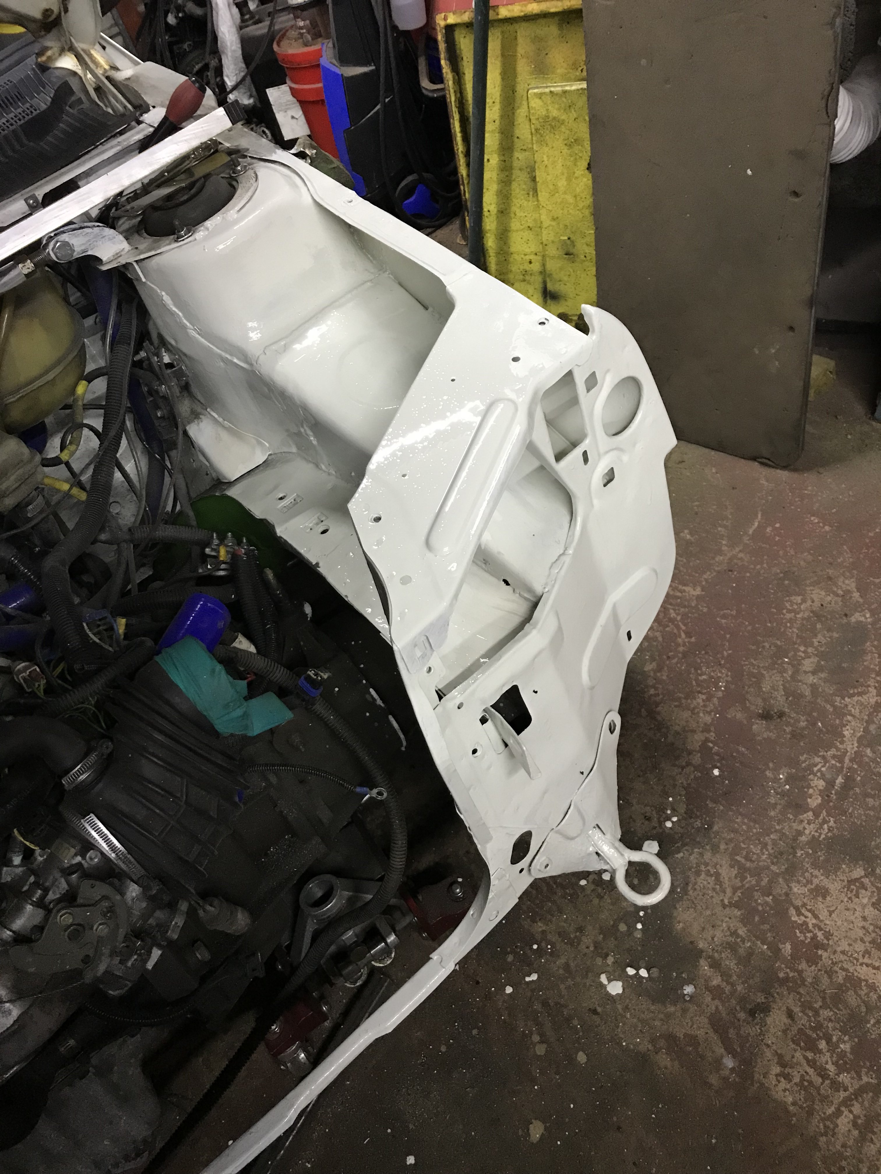

Leg section welded in then inner wing and a headlamp panel. Followed by some 2 pack white lovingly applied with a brush!

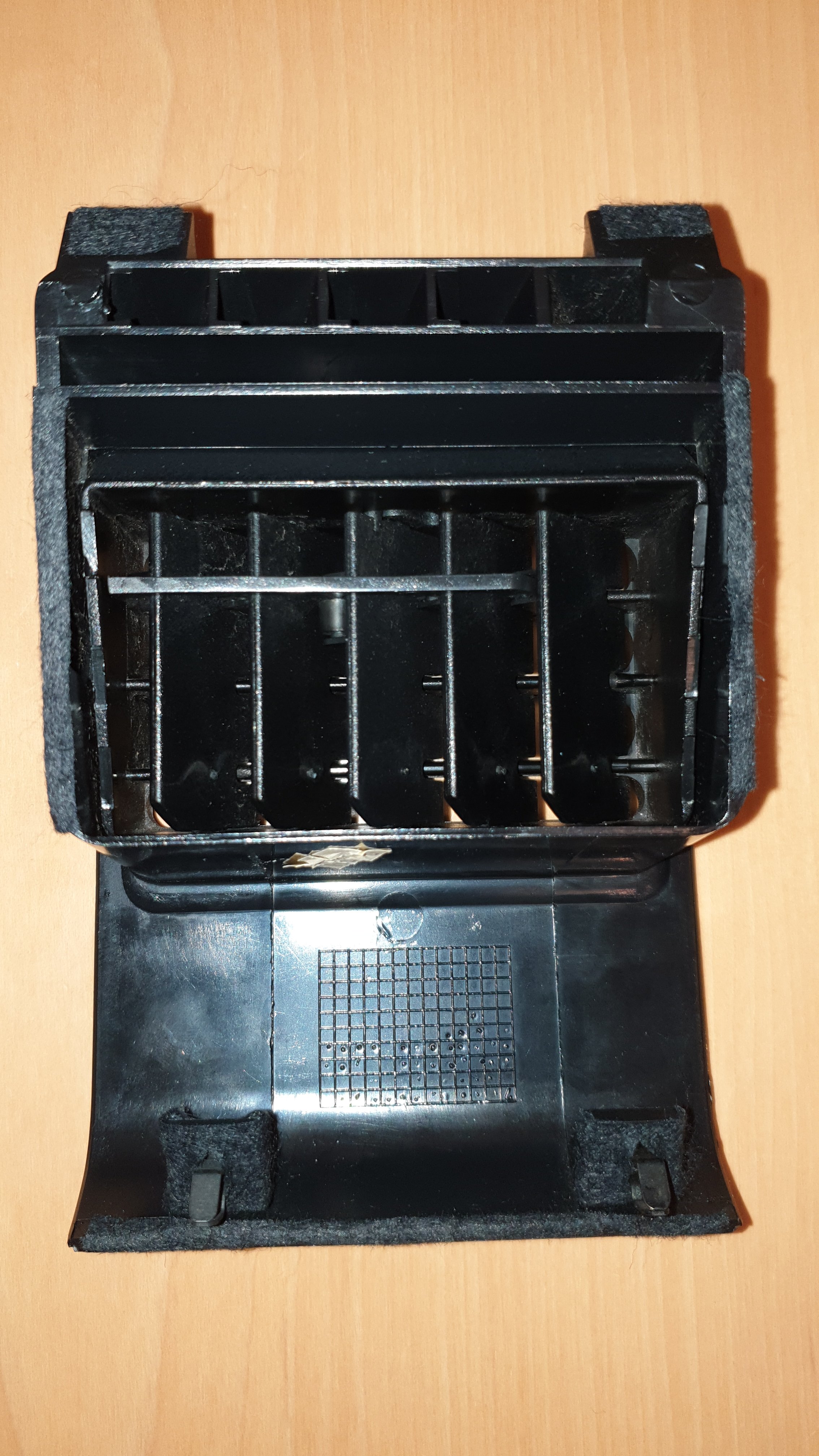

While the interior is stripped and replacing a bulb or two in the binnacle, I decided to put furry anti-squeak/rattle tape under all plastic surfaces that come into contact with each other and tidy up the cables.
Another good idea from T.Fenton Engineering inc. which I should have adopted when my dash was in bits, but it is never too late !
