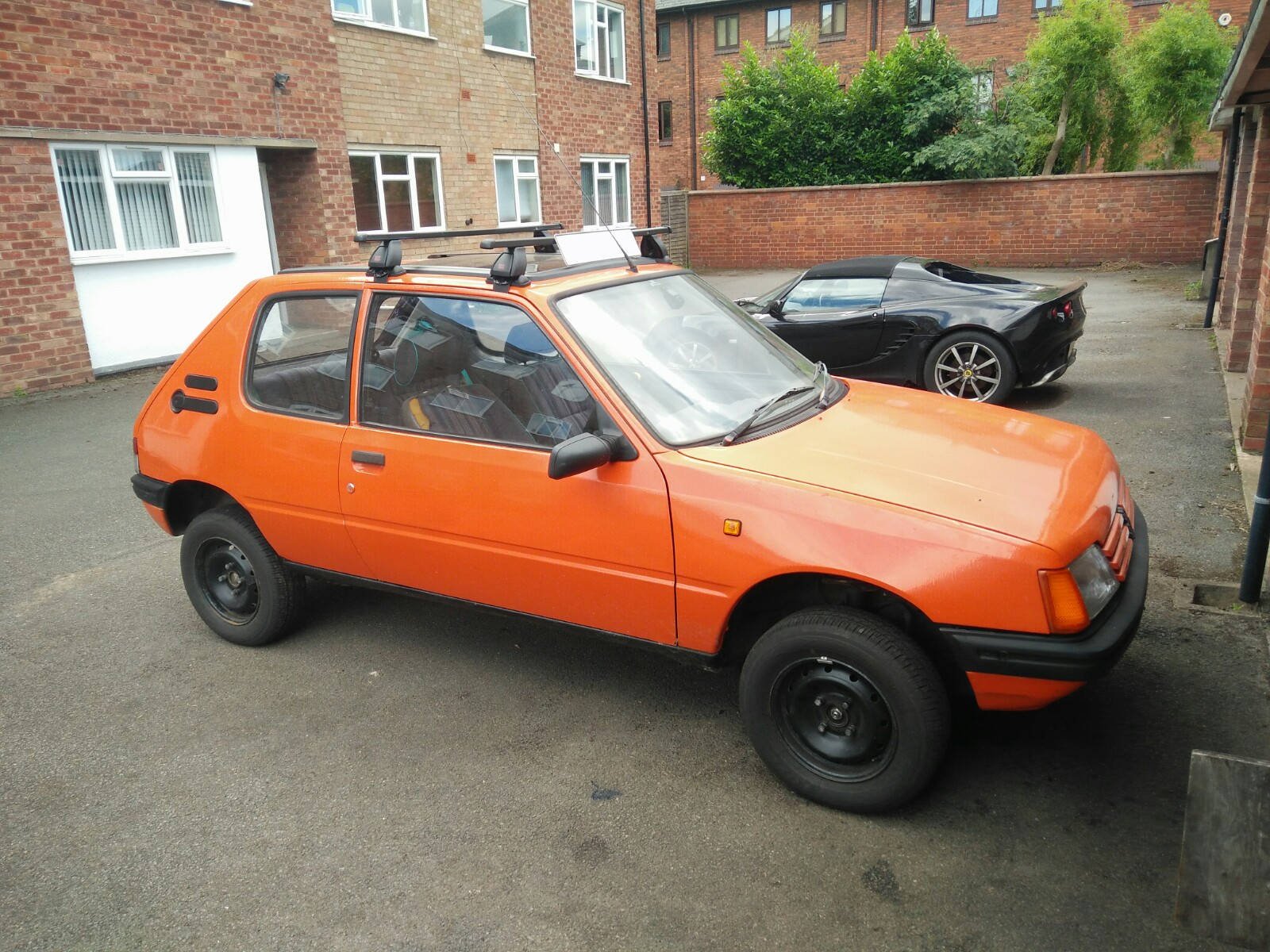

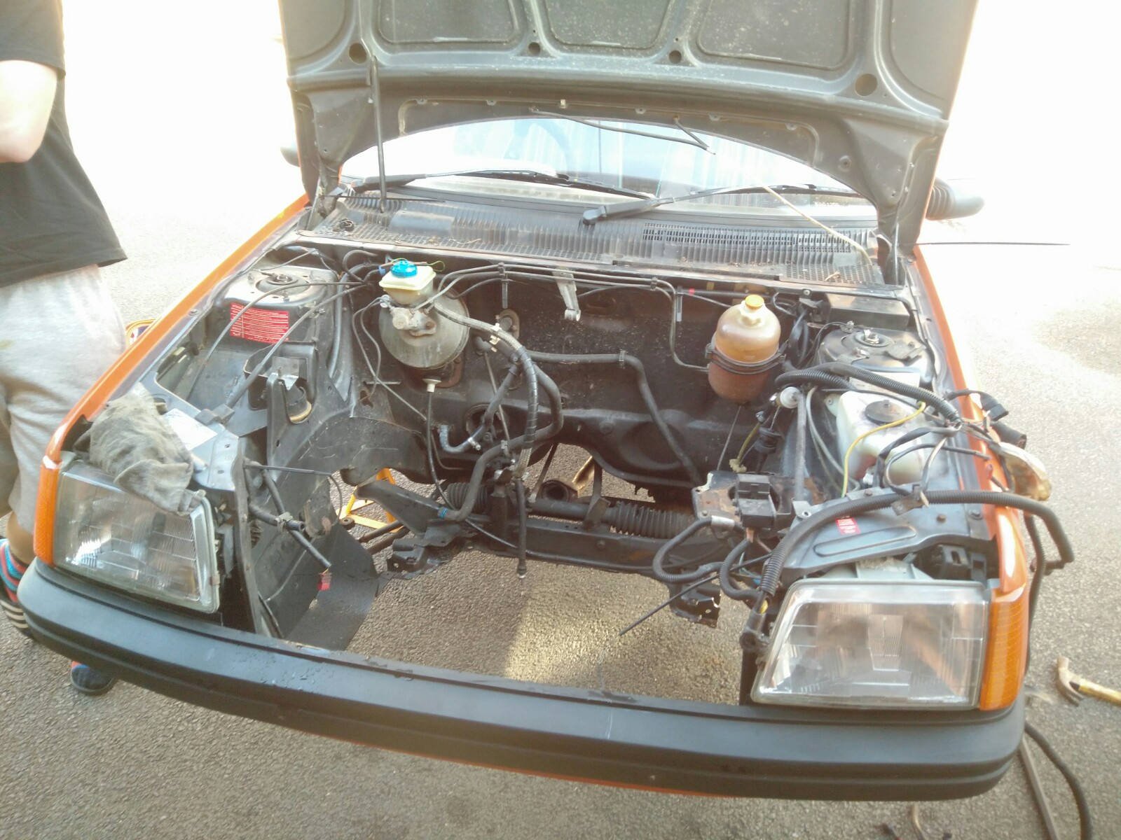

Well I started this weekend with it like this...
I'd never taken an engine out of a car before so this was a fun new time, helped by mine having no silly electrics to worry about :P Just a couple of wires that I had to work out what went where since I didn't take photos before removing it... Flushed and changed the coolant along with a hefty service (timing belt included) and gaskets for the sump, cam cover and intake since they basically only had some bad sealant doing half a job! Didn't need to remove the engine but I wanted to and it gave me a chance to clean everything and make it much nicer.

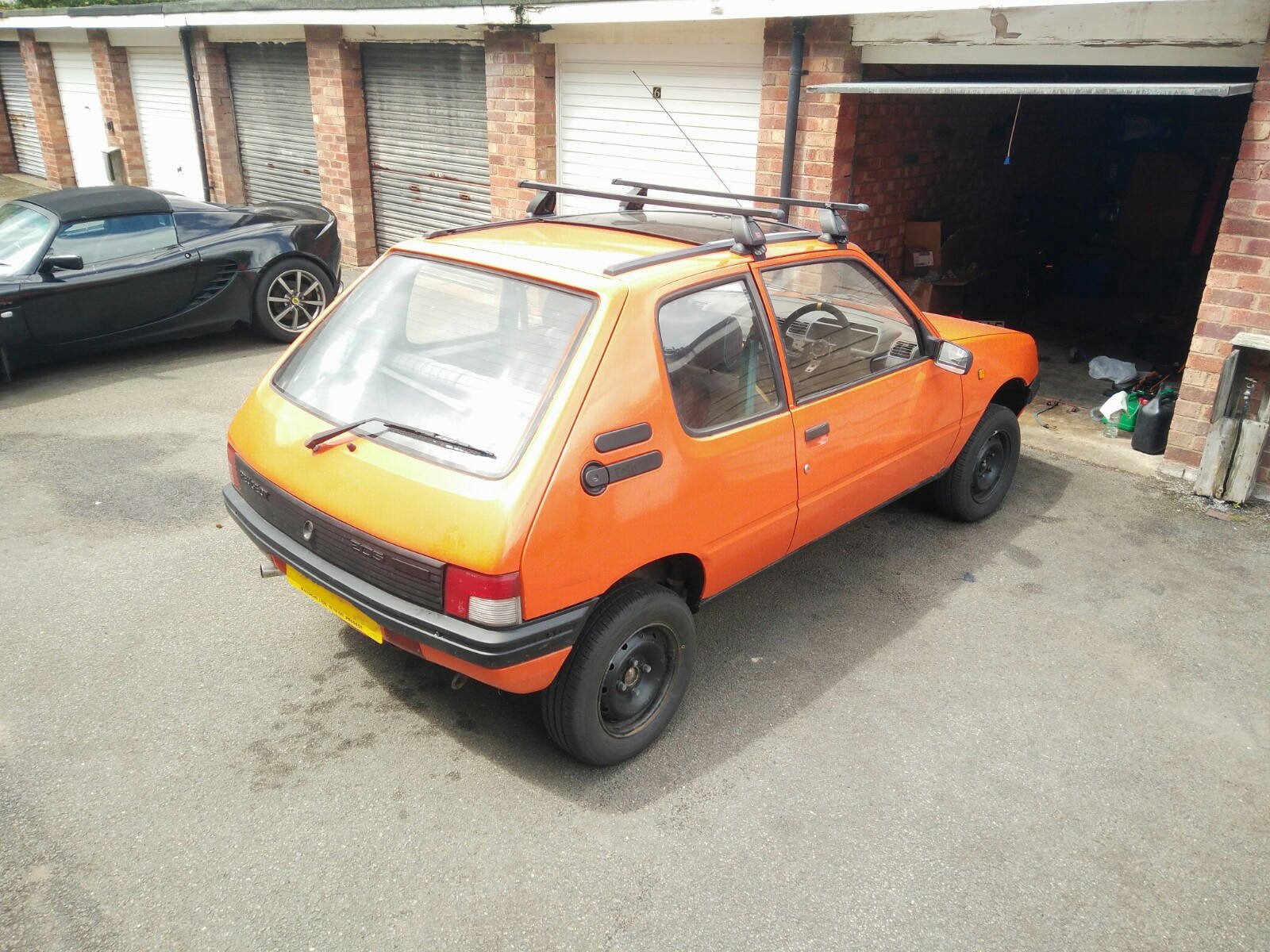

Ended the weekend like this;
IMG_20190630_130739.thumb.jpg.169470971e40404d35b588f9b9718399.jpgIMG_20190630_130513.thumb.jpg.d525613c3154dcce3b1a23b7c2b86e77.jpg
Its now got 405 diesel struts, 309 control arms, adjusted rear axle all the way up (40mm lift is the max you can get out of it btw!) and some roof bars ready to mount spotlights onto. Also new metal numberplates for added beauty. :wub:

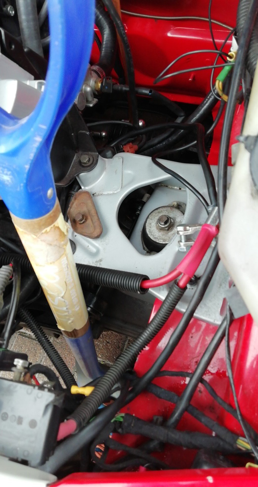

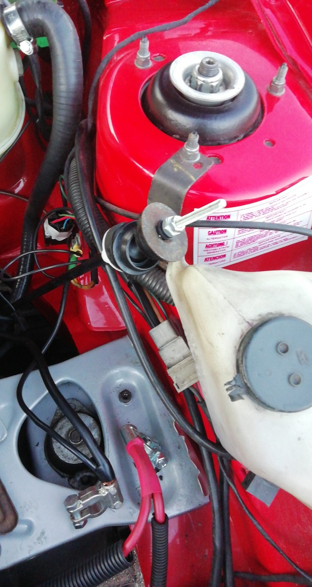

Prepped the car for our local car meet that was being attended by Practical Classics team. Got 1/2 mile from the house. PoP! Clutch cable snapped.
Managed to learn to drive without a clutch . First few miles an experience but once I got into it I made it 20 miles to the show. It turns out you really don't need a clutch for 3rd 4th or 5th.
By the time I got home I think I'm a full Pro at clutch less driving in a 205.
Today I set about changing the cable. All.ok until I tried to fit the cable at the gearbox end. Nightmare. Ended up levering the clutch arm using a spade. So two firsts .. clutch less driving and using a garden spade as a car maintenance tool!
No need to make it hard. Back both adjuster nuts off and you can seat the cable by hand. Then adjust it up.
tom the adjuster bolts removed still didn't give enough slack to allow fitment- as in the threaded end didn't protrude through the arm eye end- hence I had to lever the arm aft to get it to fit - I don't know why this is the case - could it be because ive got a crank sensor driveplate or something?
most likely its not seated at the bulkhead, did you compare the new cable to the old one?   there are a few variances around the age of yours.
the cable is slightly longer- and the cable is fully seated at the bulkhead

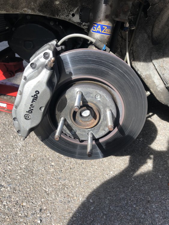

Had a great day at Brands GP in the 205... with almost no issues...
My mate complained of a long brake pedal on the last few laps of the day, thought it was due to pad knock-off as the pedal firmed up after a few pumps so didn’t check further. Drove it to a garage to pick up some tyres, and it wasn’t just a long pedal, it was no front brakes!
took a closer look to find this!:o
Hub nut missing and Outer CV had sheared where the hub nut bolts on!
Thats a new one on me, no wonder there were no brakes, the calliper was the only thing keeping the wheel on! Anyway a quick driveshaft swap and I was on my way, but will need a new wheel bearing now :(
Also tried out some winmax W5 brake pads - once they were bed in I was really impressed, very easy to modulate, helped a lot with trail braking.

Flywheel doesn’t make a difference, I’m wondering if it’s mismatched fork and clutch arm bits to be honest? But as long as it works, it doesn’t really matter, but the standard setup does go together without a fight.
ive owned the car for about 8 years and haven't changed any gearbox components so I dunno. I presume as the cable wears in Ill have to wind the 2 nuts on the adjuster in so it should all be ok.
Clutch cable problem solved. Wrong cable.. cable changed .. fits perfect. Cheers all
cables dont wear and get longer, just the sheath and coating, they may stretch a little but not very much with how thick they are.
8 years is not very much in the grand scheme of it, for a 30 year old car on a crossover year :D

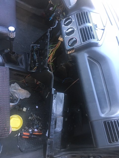

I tried 3 times with spending more than 1,5 hour each, today achieved success to attached the 2 screws of under dash part. There must be a trick to do this in an easy way...
If there is I didn't find it either... It took me a good hour to engage all the screws under the dash lip when I built mine recently. I believe the trick is not to loose your patience/mind as it then takes even longer!!!!
I put the complete upper and lower dash in as one section, rather than trying to attach the lower section afterwards.  Means that it's a bit unwieldy but only takes a few minutes to fit.

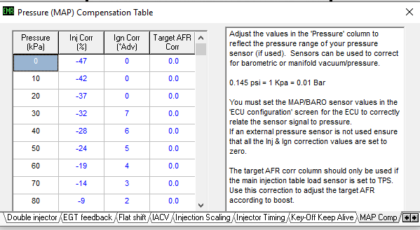

messed around with MAP sensors...
