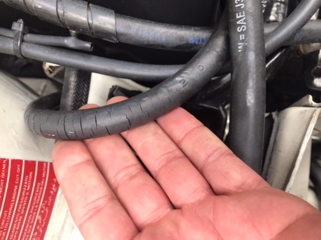

Stripped down my fuel pipes, these pipes are date stamped 2013, and fuel is spraying out the cracks at bends..... very annoying.

That's disaponting about the old rubber hoses!
I've just done my TVR with Cohline hose, in the hope that it's better than the dodgy Gates hose that's been kicking around.
If I rust treated the hard-pipes on my 205, I'd think they would disolve completely! LOL!
Ive done my rally car in the “best spec” Cohline hose from Merlin Motorsport. 18 months so far so good.
dobboy
Yes it’s a pain, the cracks are only really at the bends. There’s no manufacturer stamped or I’d be getting on to them, last time I turned car over if it had started it would have been on fire. I’m hoping the reason it never started last time was due to low fuel pressure caused by the pipes, does that sound reasonable?
I was going to buy Gates hose! I’ll not bother.
I’ll have a look at the Cohline stuff.
gates is fine if you get the right stuff, think its called barricade.
Bogsye
I agree Barricade is likely the right version. I think it also boils down to source that it comes from, ie sourcing from companies that deal in hose in decent quantities and not eBay sellers.
There was a period from around 2016 where there was seemingly fake hose kicking around.
The main issue was ethanol content rising in fuel (which many earlier hoses were not suitable for), plus for the TVR lot, high under bonnet temperatures causing hoses to deteriorate. Ethanol obviously damaged the interior of the hose, so apparently good hose was in reality on the verge of failure.
Initially I looked to get Gates hose, but I couldn't verify anything I was seeing as genuine, hence I looked to Cohilne.

Got all my fuel pipes done and now up and running, but need a couple of bigger fuel pipe clips.
mine from Baker lasted 7 months and started cracking ( about 3000miles!!)
