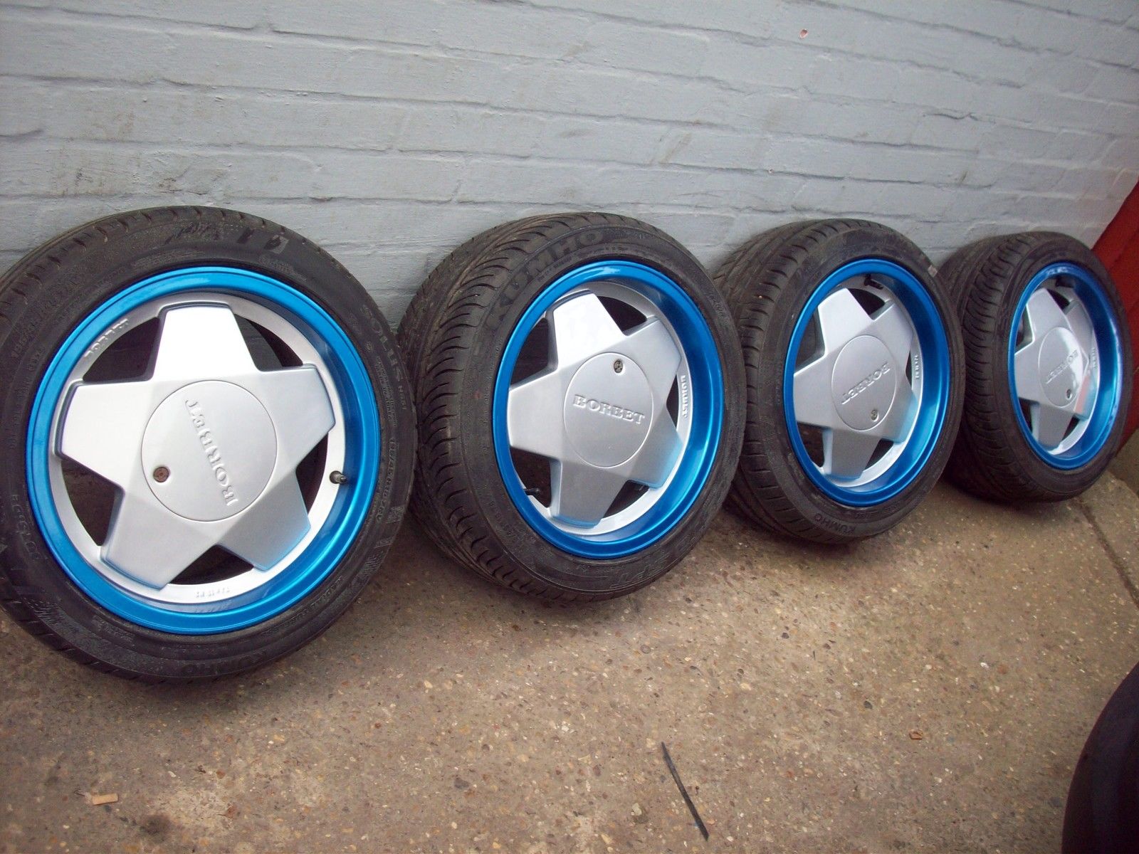

Slo
Bought some new wheels i'd been after buying for a very long time, not keen on the blue might polish it off
