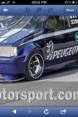

wardy18
Just an idea as the extent of the LH front tyre roll I have, this is at 21psi before tyre warning and the most part of the run so expect to gain a couple psi with the heat!!
alexcrosse
Doesn't look like too much of an issue. 3 is a bit much with crossplys.
Why not just ring BMTR if you're worried, they will be able to tell you a solution, or if it's a problem.
wardy18
I've phoned them and also Avon and both had no answer for tyre roll.....useful!!
One said use 26-28psi and the other said no more than 23psi
Checked tyre temps last hill of this tyre and they are a good even spread
