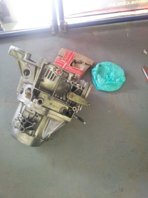

woowoo Samsonas DogBox on its way back to me today!!!!
Will be fitted by the end of the weekend ready for my next event next Saturday 13th

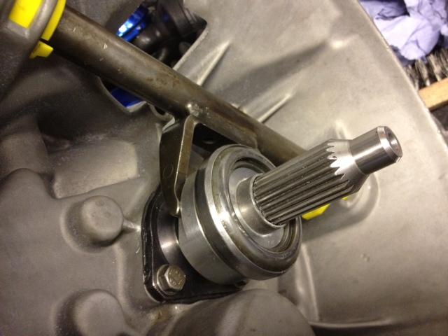

So the Dogbox has arrived....................... and my wallet started quivering when i realised that the input shaft had been beafed up considerably.....THANKS FOR TELLING ME!!!!!
This means 2 new 7 1/4" clutch plates (no problem) and a new Release Bearing (BIG Problem)
AP Racing supply a release bearing just for the BE3 box which is what i have been running but this is to suit the standard diameter input shaft, i now need the same design but with a larger input shaft diameter (26.4mm).
I have got onto Clark Motorsport and they are sorting it out for me but its goingt o mean i miss my 1/4 sprint event this saturday!!!

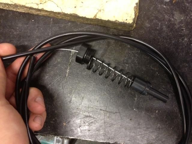

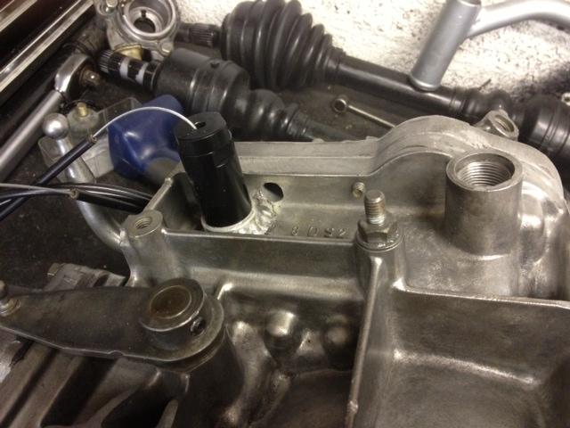

Also Samsonas has fitted a lift reverse cable to my BE3 box but its at the opposite end of the selector shaft as to where the BE1 is fitted, this is VERY close to my oil tank and i am yet unsure if it will clear.....

Pictures of reverse cable & gearbox?

Ill get some pics tonight and post up tomorrow, looks pretty standard from the outside (i would love to see the inside)
Colin Satchell has come to my rescue and already has the drawings to make a new carrier to my input shaft sleeve OD so i have sent my release bearing to him today to pull apart and fit to the new carrier!!
This all means i miss the 1/4 mile sprint this saturday but i want it ready for when the British Championship come over for the National Hillclimb next weekend as i have a record to break....

Yeah I'm just interested to see how they have done the reverse cable as that is an issue of mine at the moment. I have had to do a plate at the gearbox end.
Chap I bought my gearbox off had told me if you run a plated diff and close ratio box without a breather and drive it HARD you will blow your drive shaft seals out. Which is why all of the GpA 205's had a breather replacing the BE1 reverse cable and then a lock off plate at the gearbox end.
wardy18
No worries, here's some pics, i can see sown the hole that they have made a notch in the selector shaft thus not allowing engagement of reverse unless the bar if lifted.
alexcrosse
that's trick, I like it. I think I will put an extra breather in my gearbox and then use the original reverse. When I have time to build it into a production casing.

that looks exactly where the gti6 reverse stop is from memory.

Release Bearing arrived back yesterday with its brand new carrier compliments of Colin (again many thanks for gettin me out the sh*t) and it fits like a glove, very happy with it!!
The box is now ready to lift into place now which will be happening tonight now i have finished raising my oil tank up 30mm to clear the new lift reverse.
Im intrigued about utilising the oil filler hole (BE1 Lift reverse cable location) as a breather so am going to ask if its actually required before i do anything!!
alexcrosse
Better breathing out of there than your drive shaft seals...
