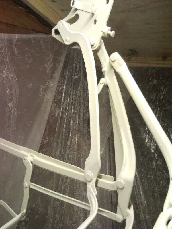

I sheeted up my car port up this evening so i could start painting the hood frame. I had thought about having it powder coated but the possibility of it knackering all the joints was a bit too mch for me so i decided to spray it instead.
Seem to have gone ok

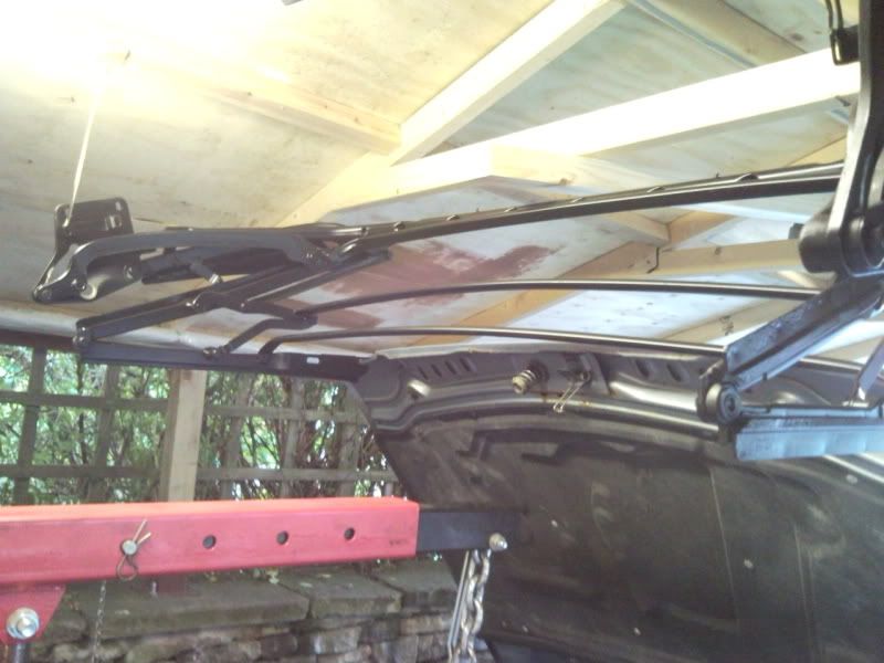

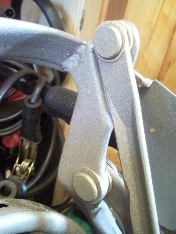

i finished spraying the CTI hood frame in it's black basecoat over the weekend along with a set of wing mirrors to replacing the M3 style mirrors on my black GTI6 as i'm now sick of them :lol: I need to get some more clearcoat tomorrow to finish it off but i'm pretty happy with how its turned out so far. My sparing hs certainly got better, and the sheeting up of the carport is working really well as i'm not getting any bits of dust or dirt in the paint
I've also removed the engine again so that i can respray the engine bay. My shed is now once more crammed to the rafters.

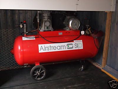

a 2nd hand 150l 3hp compressor off ebay (picking it up on saturday)

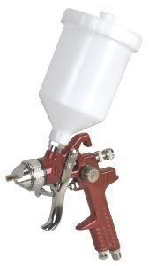

New Spray Gun - hopefully a little better than the one that came with the aldi compressor but tbh i was getting pretty good results with it

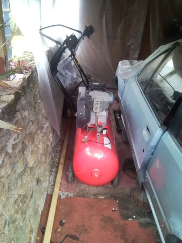

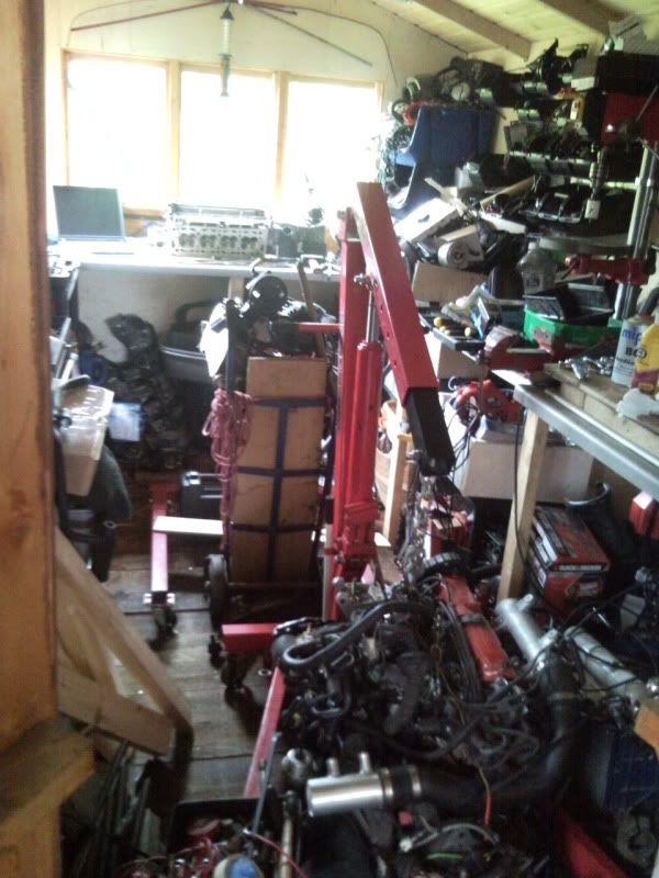

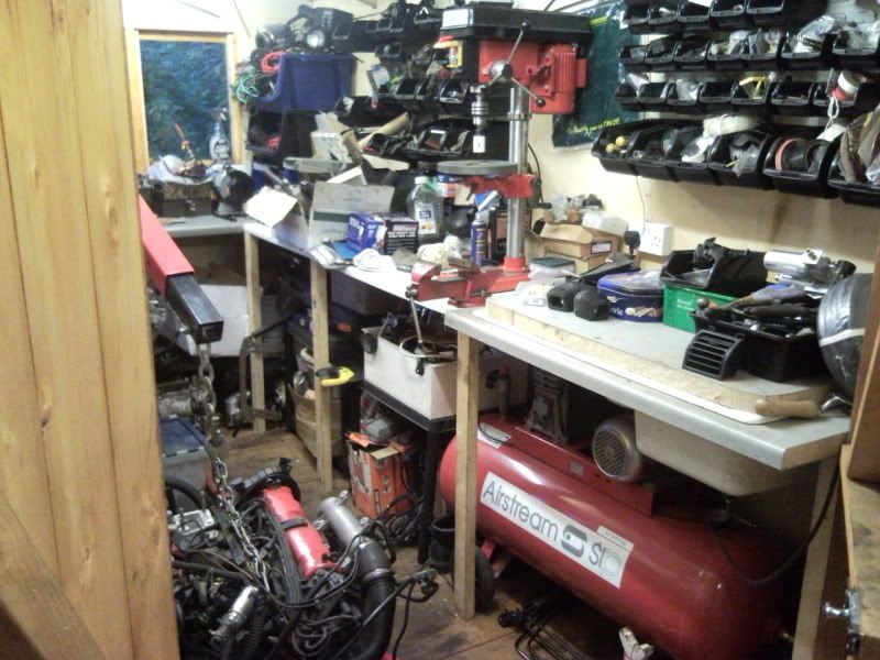

I picked up my new compressor today, i didn't realise quite how huuuge it was :P took me a 4 hour round trip to collect it even though it was only 35miles away thanks so some useless prick who crashed on the A1 shutting it :)
anyway the job was to try and get this
in my s*it tip of a shed
well a couple of hours later i'd managed it with some major tidying up (not that you can really tell :P)
So i'm almost set for the respray :P
jimistdt
The fold-away spray booth is a stroke of genius! I did a couple of little bits of painting of some backplates hanging off a tree yesterday and the greenfly for some reason loved to land on it. :)

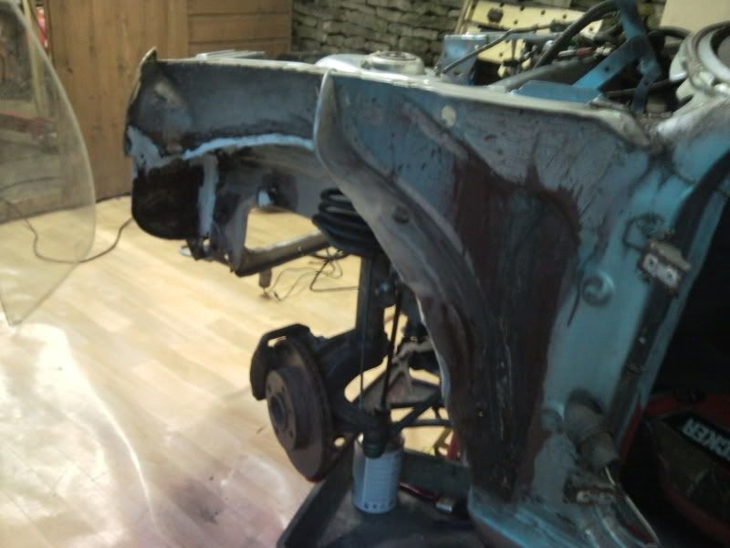

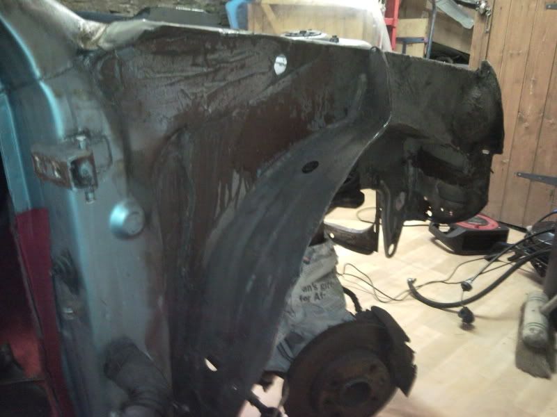

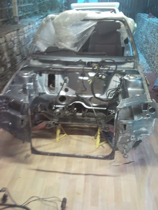

still cracking on with the body work prep. I'm one those people that can't help picking at something so tonights stint on the CTI resulted in the bonnet, both doors and both wings being removed!! Both the wings came off without too much of a struggle just with the help of a small pry bar, a stanley knife and a long sharp kitchen knife.
It will allow me to clean up the arches alot easier but has highligheted some creeping rust which will niglle me unless i get it sorted.
Any way a few boring stripped down pics

It needs to! Not exactly a great deal of room around it for painting :D
Loving the floor Matt, good idea for keeping the dust down, but it might not look so good once it's plastered in overspray :angry:
