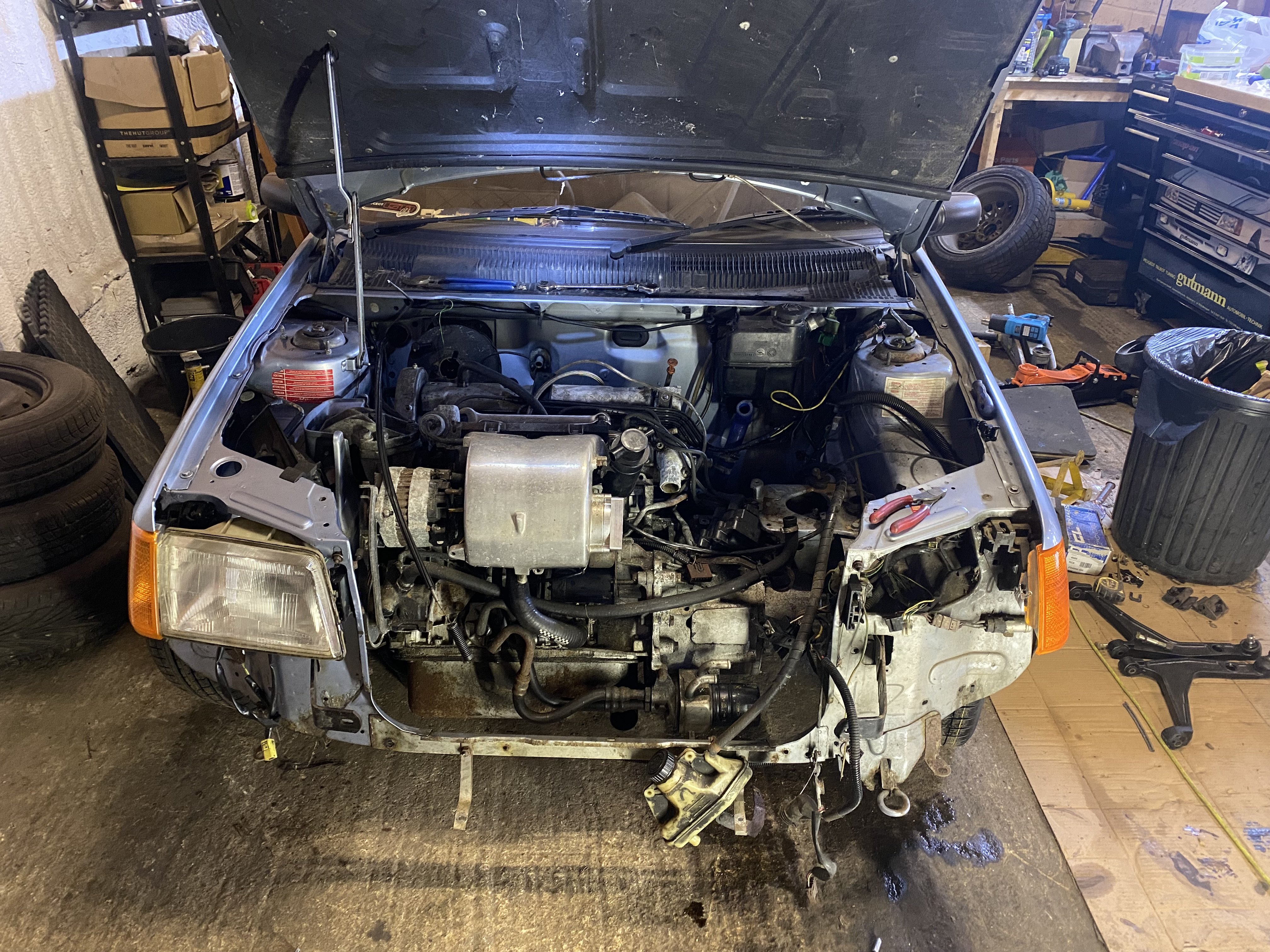

Rolling resto continues, engine and box ready to come out for a check over. Back end back together.

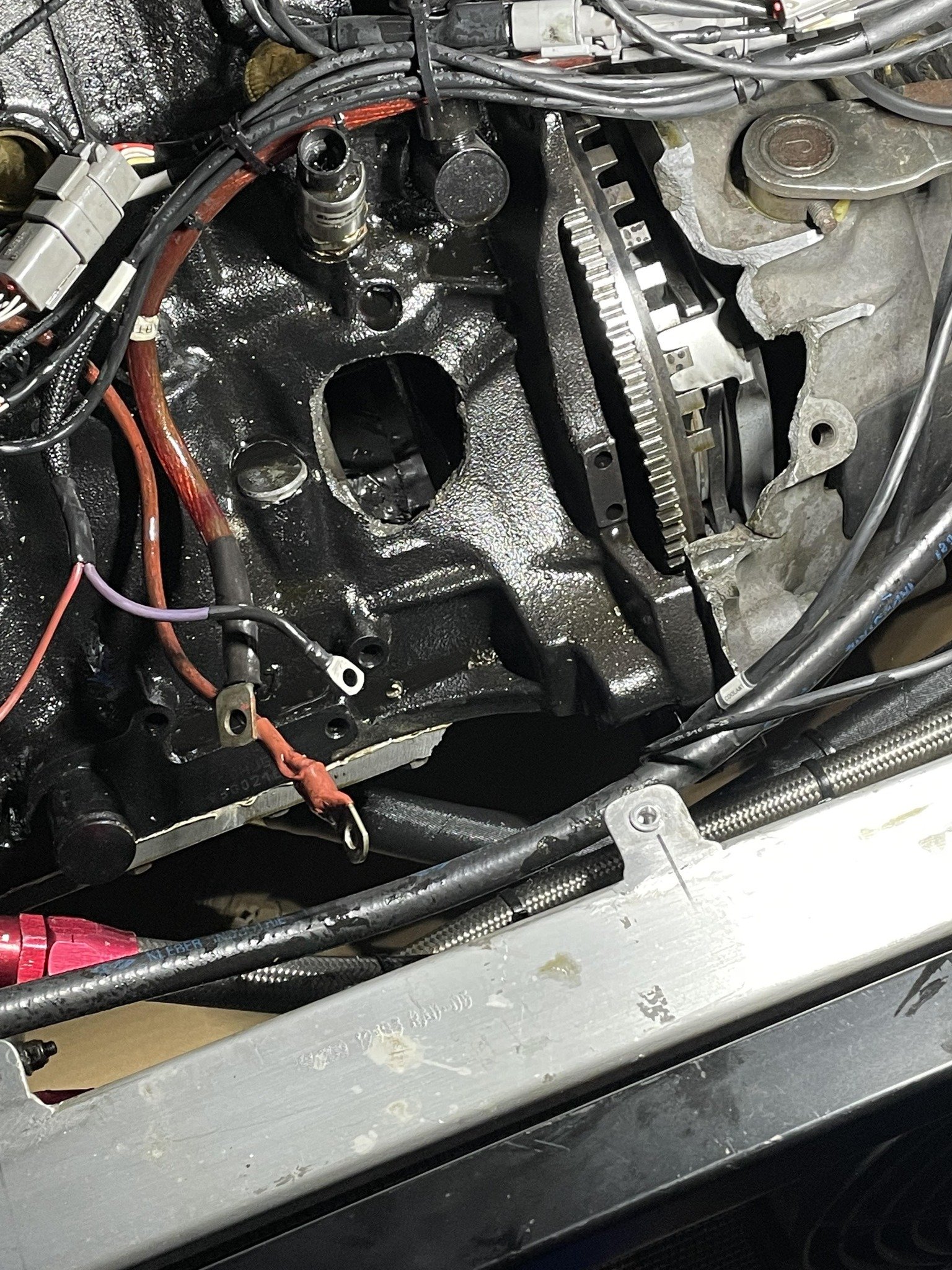

I did this on the weekend.
  • Sad 1
Ohh! Box and block? What let go?

parry
23 minutes ago, welshpug said:
Uncle rodney :blink:
Uncle Rodney did not like the party and on his way out he kicked the starter motor and cracked the bellhousing!

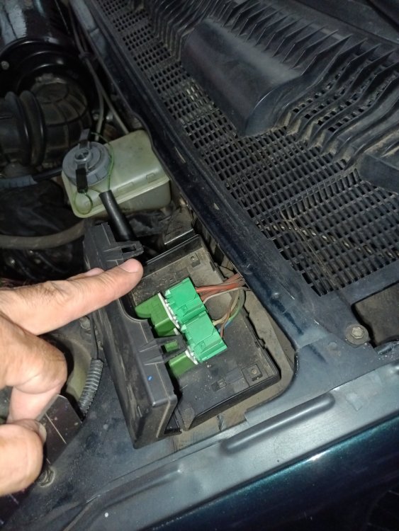

Dimi

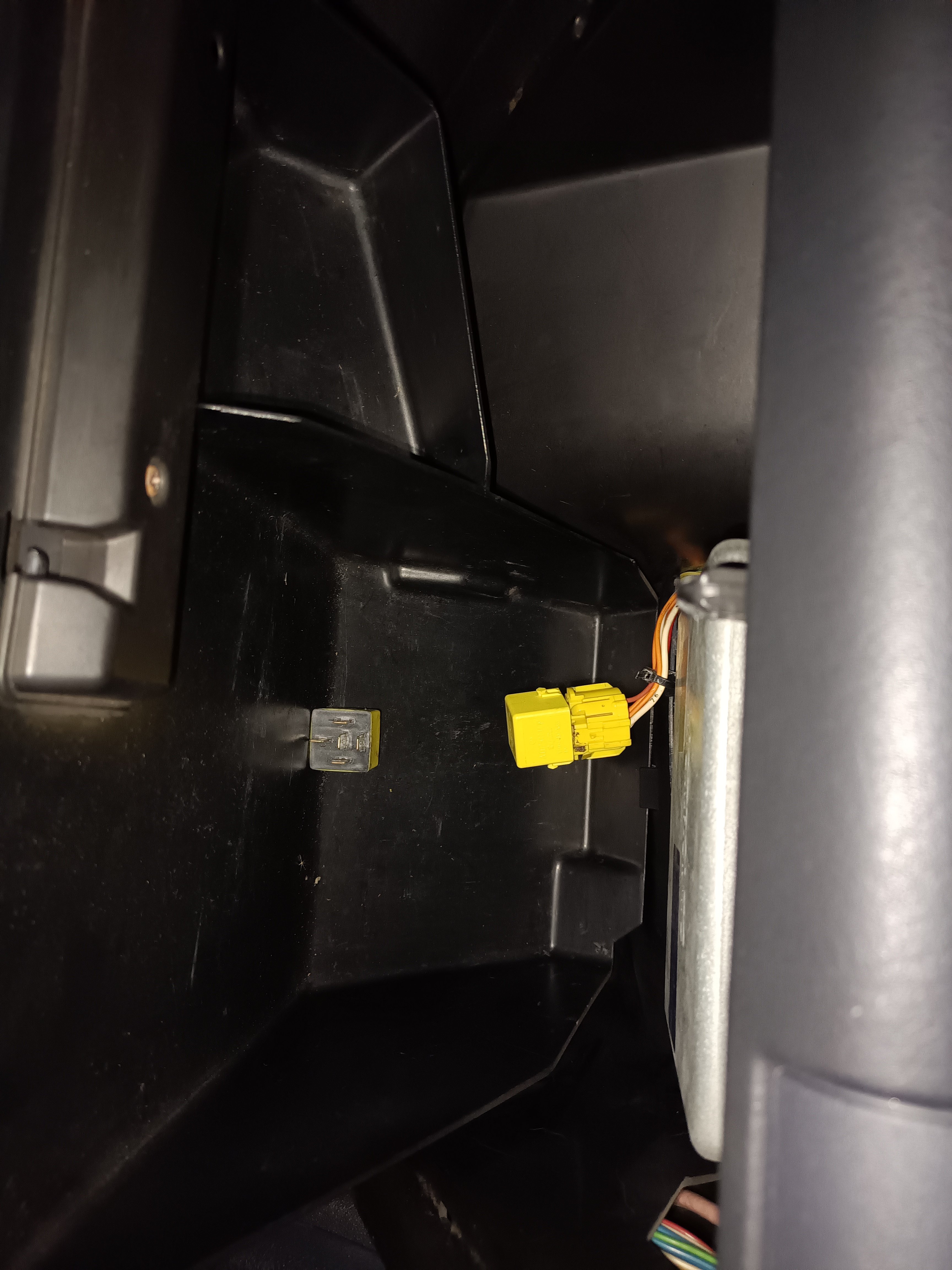

Thanks to Damir's write up about the fuel pump relays, I found my relays ('93 model 75k km). Prior to this the engine stalled a few times and I replaced the fuel pump, only to find the old (newer) pump working when tested on the battery. My original pump worked too (had it in the collection). So, this raised a flag about the relays. Swapped the 5 pin yellow one, as it looked as if the PO has been accessing it, so I tried that first. Next morning my battery was flat!
Now I am chasing the battery drain. When I unplugged the relay there was no change in the drain, same for all fuses except after removing the 10A fuse (O2 sensor) in the engine bay, the drain got lower.
I will take the car on a ride this weekend to see if the relay swap worked (if the car will stall again). Also, will update if I could solve the battery drain mystery.
You need specific 5pin relay , not the usual "ordinary" 5pin type ..
Ordinary/common 5pin relay which you have is called - "5pin changeover type"
With this relay there's constant +12v supply across/between pin 30 and 87a = battery drain , better unplug it asap .
For Motronic system you need - "5pin dual output type" relay : Bosch Part No. 0 332 019 150
Replace it with correct relay and it'll be fine ... recharge the flat battery asap , it'll still be good if not old and left uncharged for longer period (the lower the voltage and the longer it stays with low charge , sulfation process begins which is kinda hard to reverse back ..)
While you're at it check the injection supply relay too ..
Injection supply relay you'll find in black box near left strut tower , should be green relay socket and green or black 4pin relay plugged in .. you'll find it easily by following the wiring - goes trough the edge of the firewall and into the cabin where it cross connects with the fuel pump relay .
So , in essence , IIRC the injection supply relay "kicks in" first (powers/energizes fuel pump relay) and then the fuel pump relay afterwards .

Dimi
Wow, appreciate it, Damir! I am only going to say that every knowledge of all of you that this forum is collecting for our cars will be well used to keep the 205 GTIs purring for generations :-)
I unplugged the incorrect relay, promptly found a Hella dual output 5pin one and ordered it (bosch number was showing me the normal type here in CAN/USA). Recharging the battery now.
Found the box with the two green relays (one is for injection) as per your description.
Will report back when I get the relay and go for a drive!

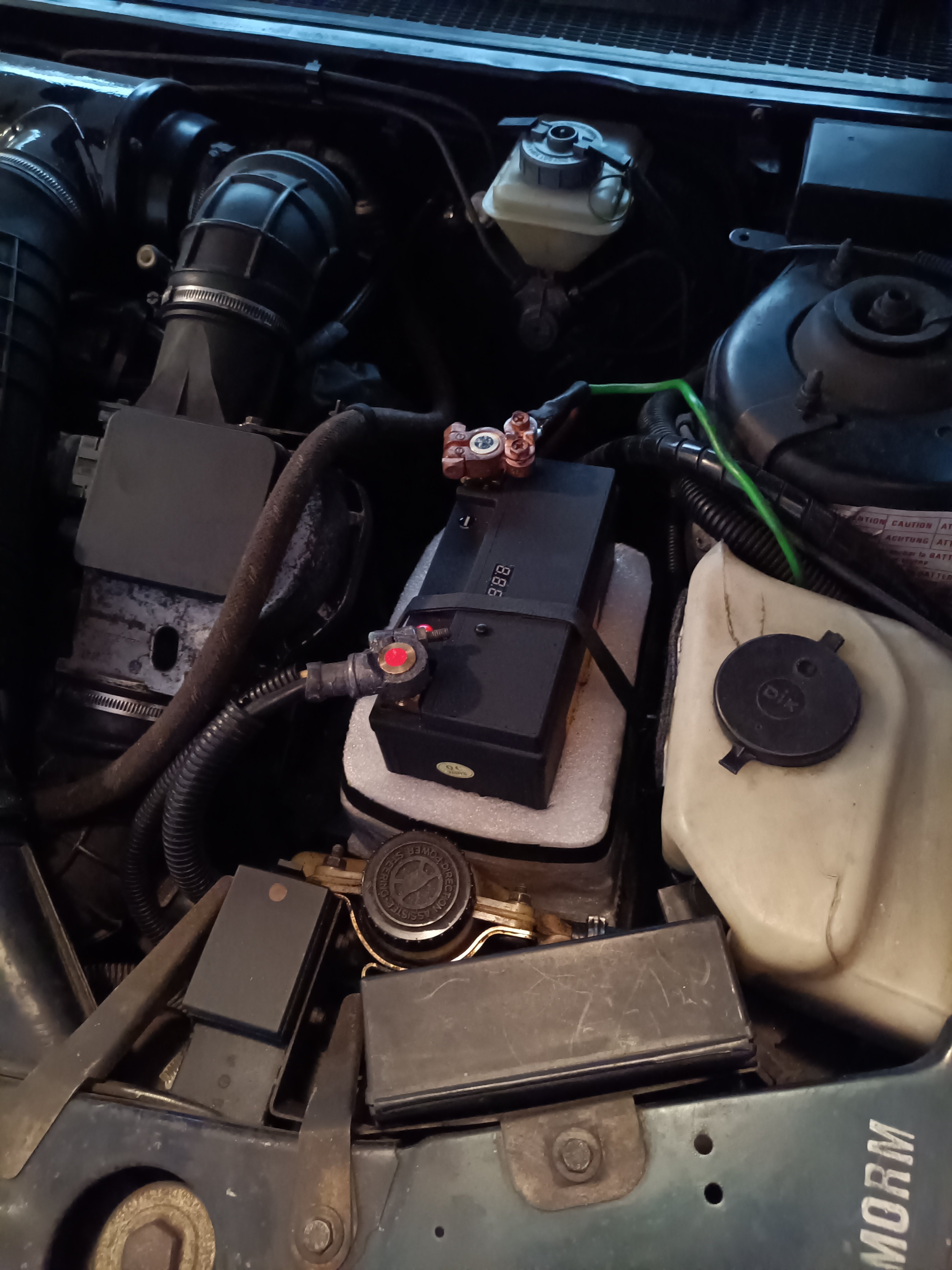

Dimi
After Damir alerted me the wrong relay drained my main battery , today decided to install a bike LiPo battery 12v, 38 A/h, 200A. Looking at the calculations, it will be able to handle the fan for 5min on its own and still have enough juice to crank :-)
It is saving the car 10kg

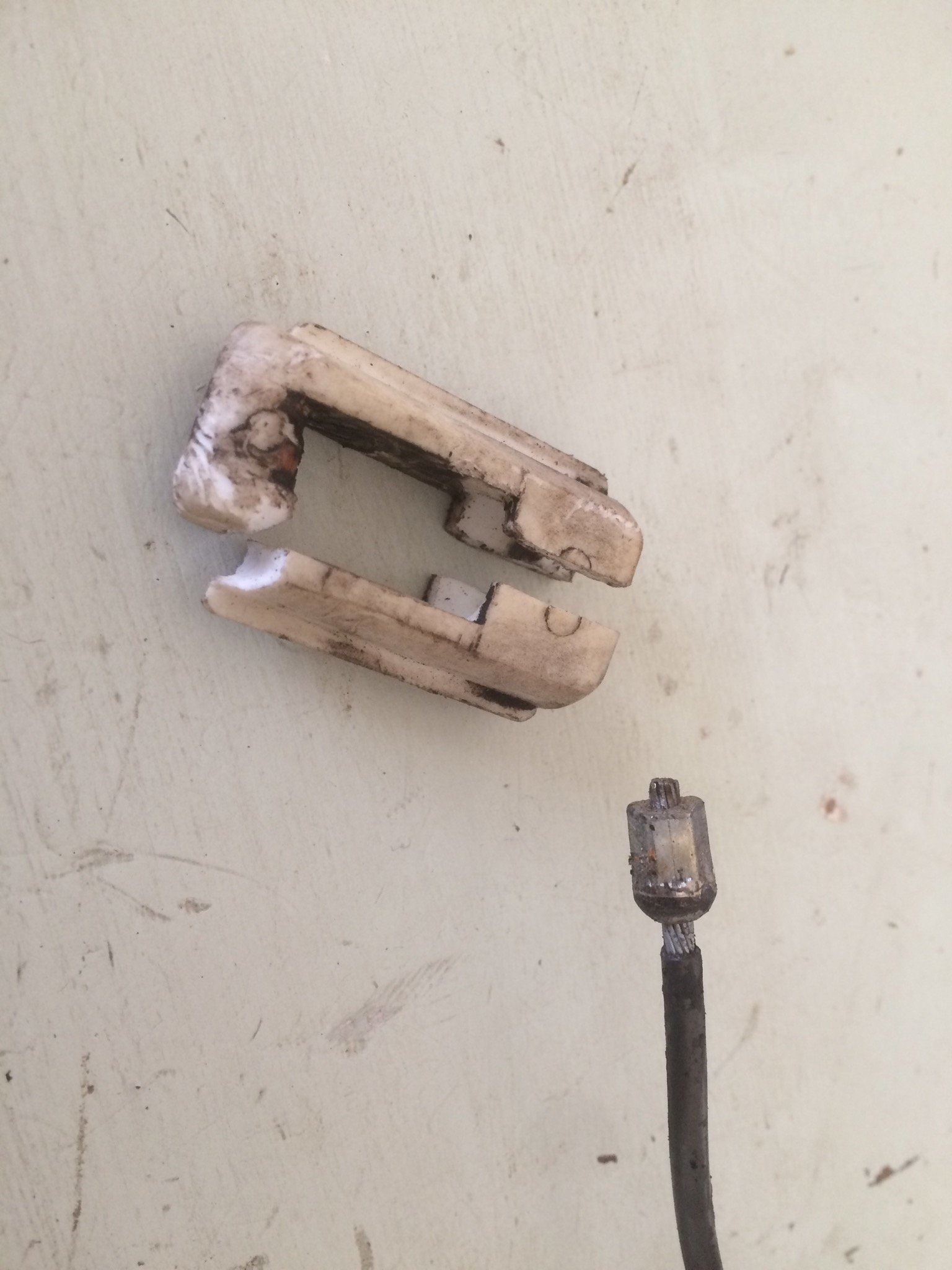

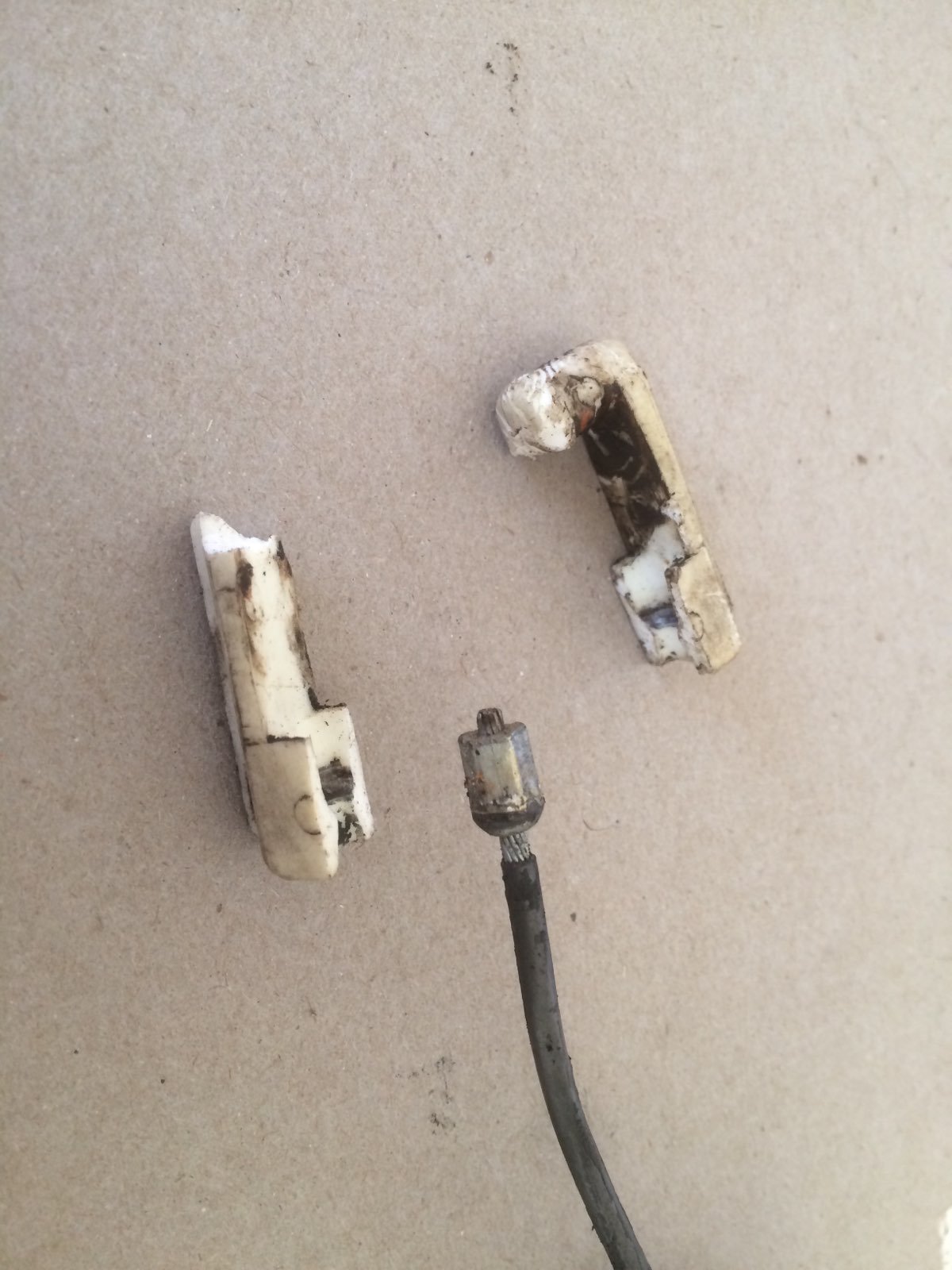

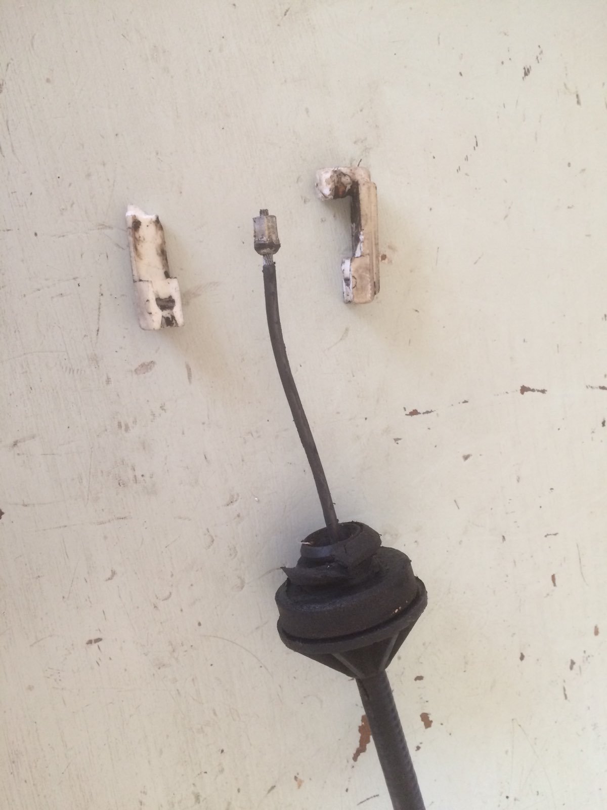

Gohn
clutch cable broke
drivin along , last change before turning in to get some diesel and splat !?.. pedal just drops out
matched engine speed to 3rd , selected route without traffic lights and drove home
its old n all that but still, pretty disappointed at the rubbish plastic part
had a new spare ready so its in (the gimble on it is plastic too)
had to take out the RF driveshaft to get decent enough access to where the cable plugs into the firewall
spose I better go get a new spare (hopefully one of the brands still uses metal for the end)
AFAIK, it's only BE1 cables that use the metal end - all BE3 cables are plastic at the pedal end.
That said, I don't think that I've ever had one fail where yours has - every clutch cable I've had fail has always done so near where the cable joins the metal threaded part at the gearbox end, so hopefully your replacement cable will prove to be long lasting.
I've just been looking in too a lithium battery for my race car, how did you get along with the alternator output? The batteries I've been looking at have can only take about 20 amps max. I  would need fit a  regulator so I don't fry the battery..

Dimi
Hi Fallowsnz, the battery description said that there is Voltage protection built in BMS. Also, I read that the only concern is if a car's fans run after the key is taken out, they may discharge such small batteries and prevent a start up, but other than that, I did not find oher potential issue. There is a button on top and display that now shows 13.6V. Before I left it was 13V as the car sat for two weeks.
