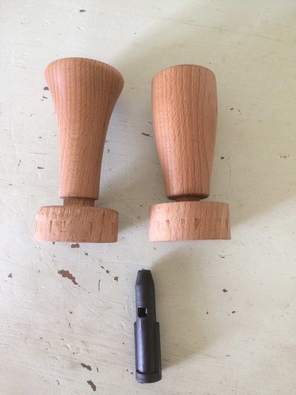

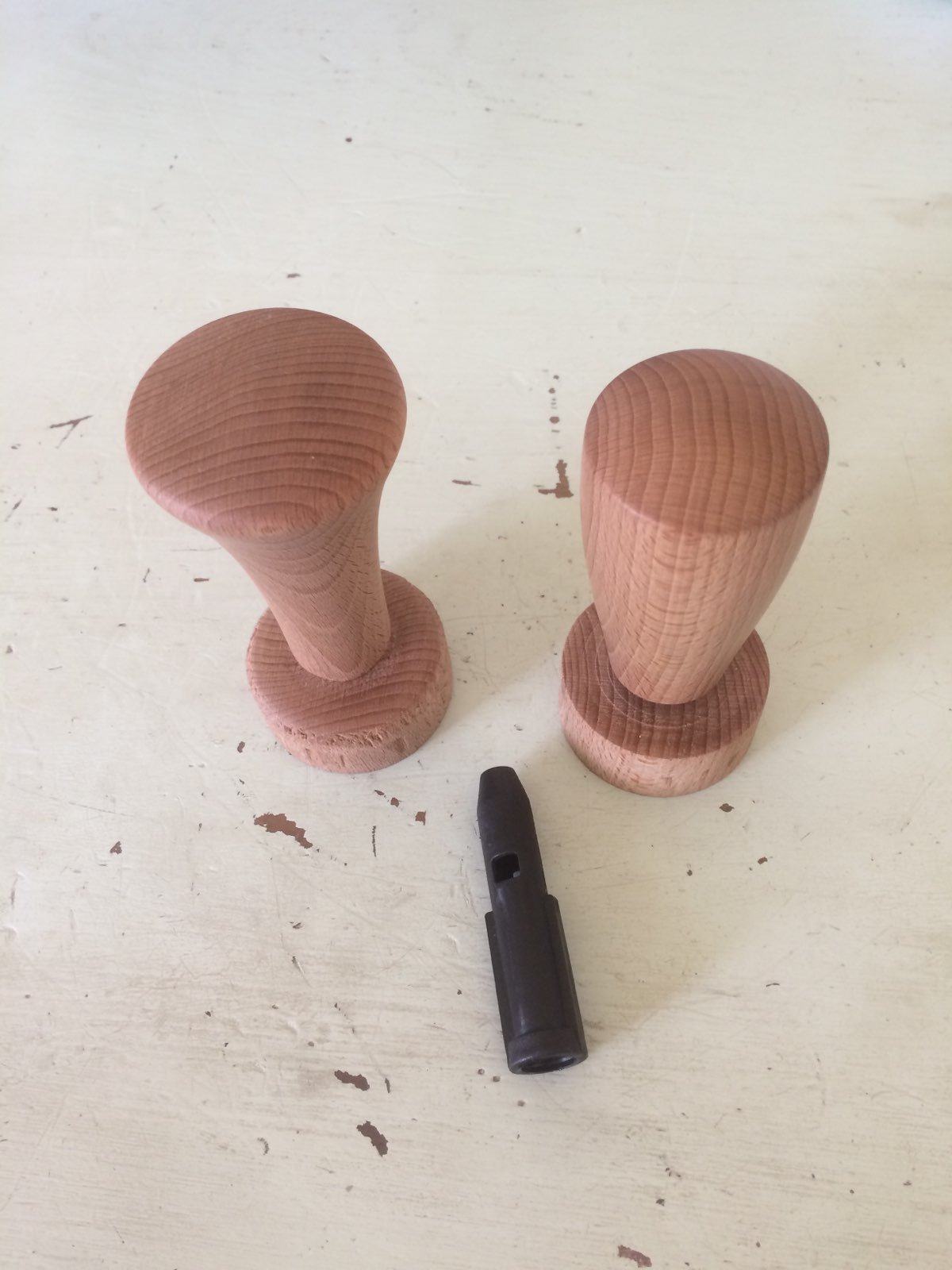

got sick of replacing the peugeot plastic gearshift knob which just crumbles after a while
so managed to get access to a lathe for a few hours and made a few different shaped options out of wood
(the wood blank was a lump of lumber that came on the pallet with the XUD7TE engine from the UK)
few bucks on ebay for a plastic sleeve for the top of the gearstick which I trimmed down a bit lenghtwise and took off the side bits
it slots onto the odd kind of thread on the gearstick and the knob is then drilled out and slots over it for a snug fit
its summer here, thought the wood might have split to heck and broken up in the heat but its been very steady

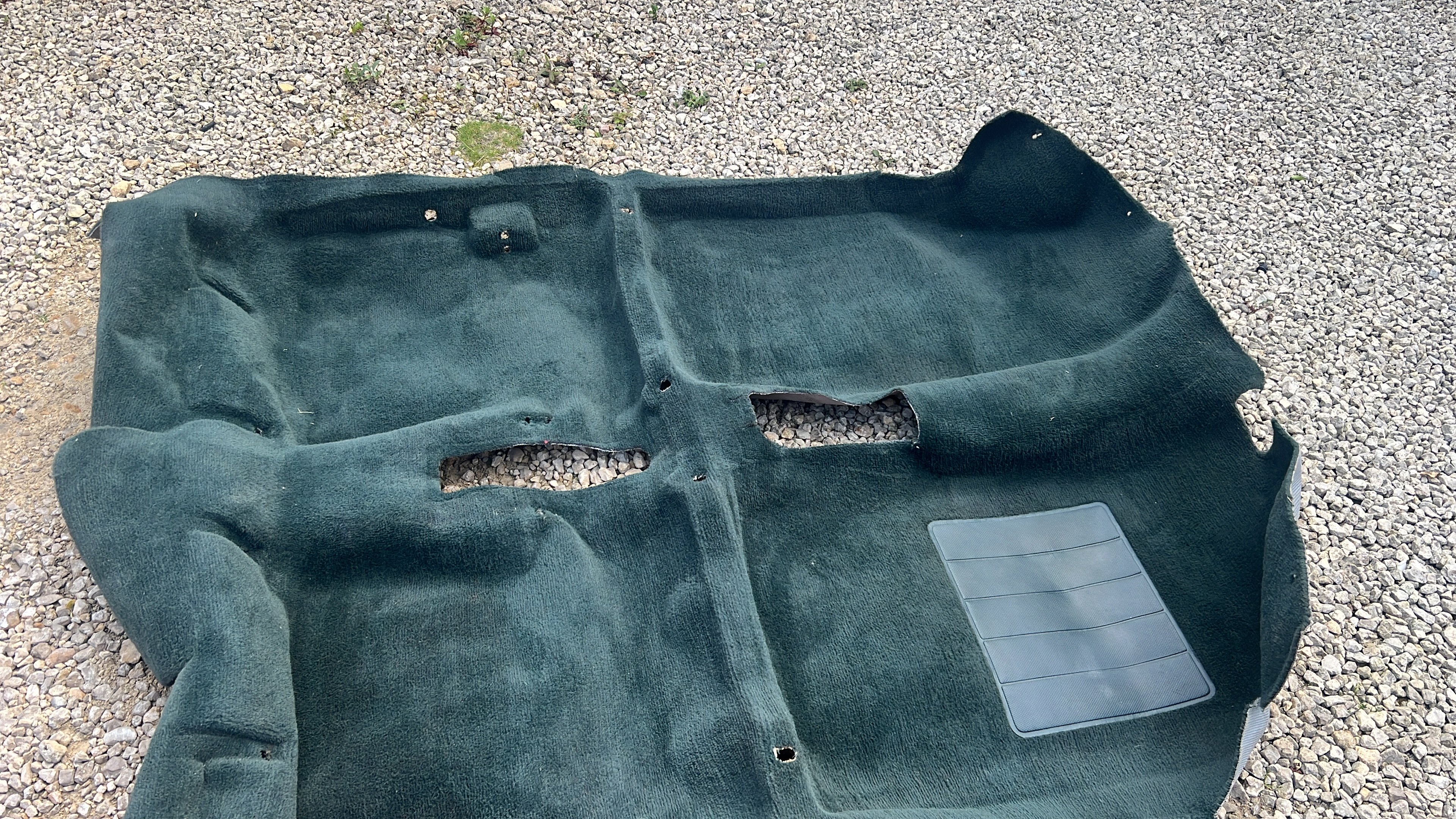

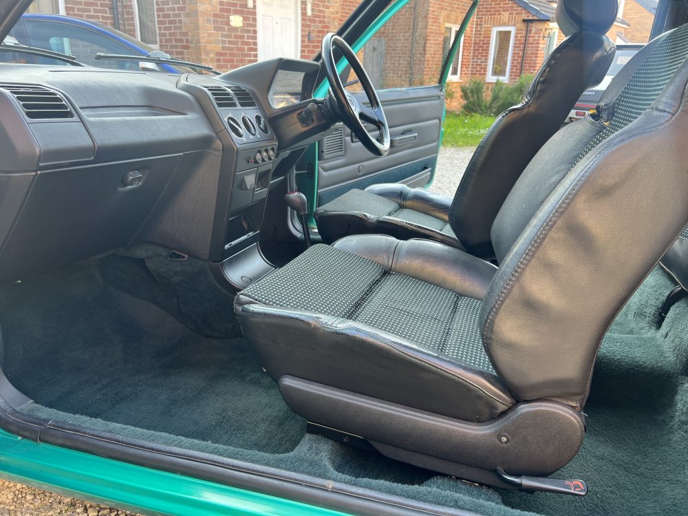

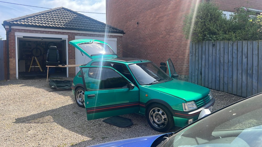

chris 417 mi

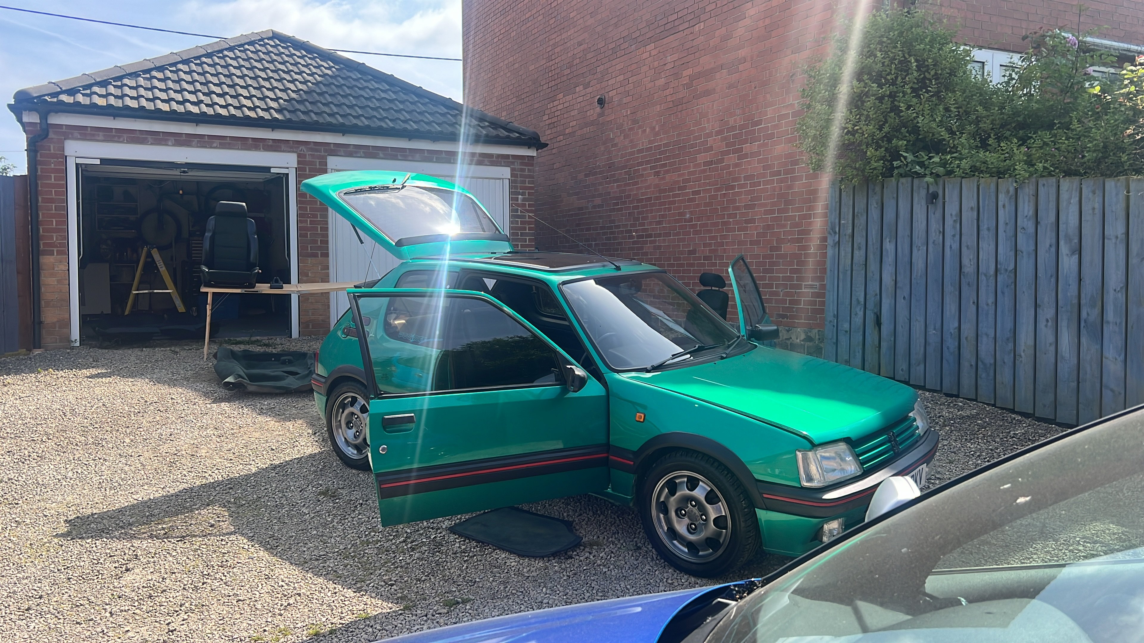

Finally got round to swapping out the stained carpet I had in the 205 for an upgrade I’d bought last year … good excuse for an interior clean aswell :D
