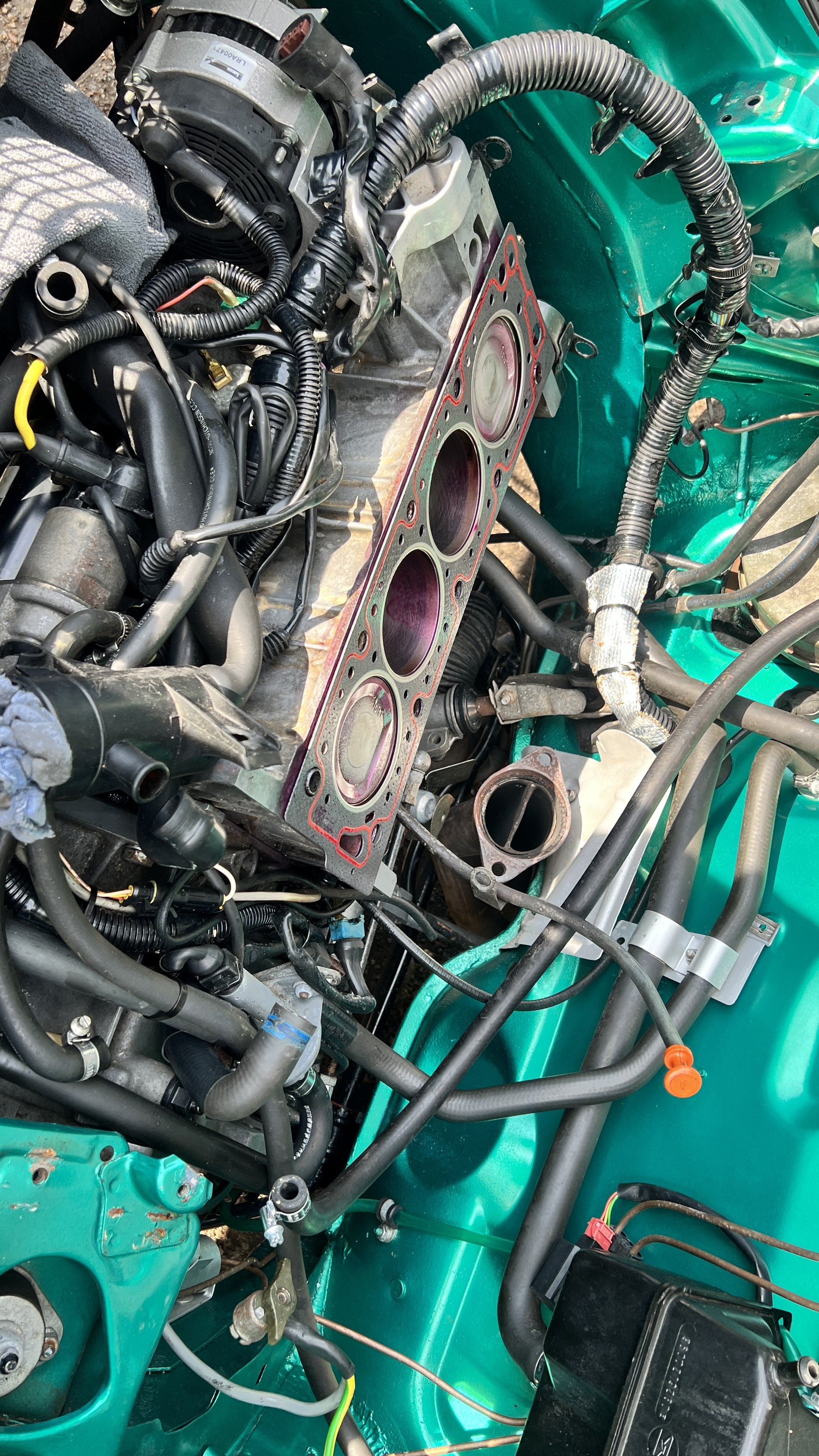

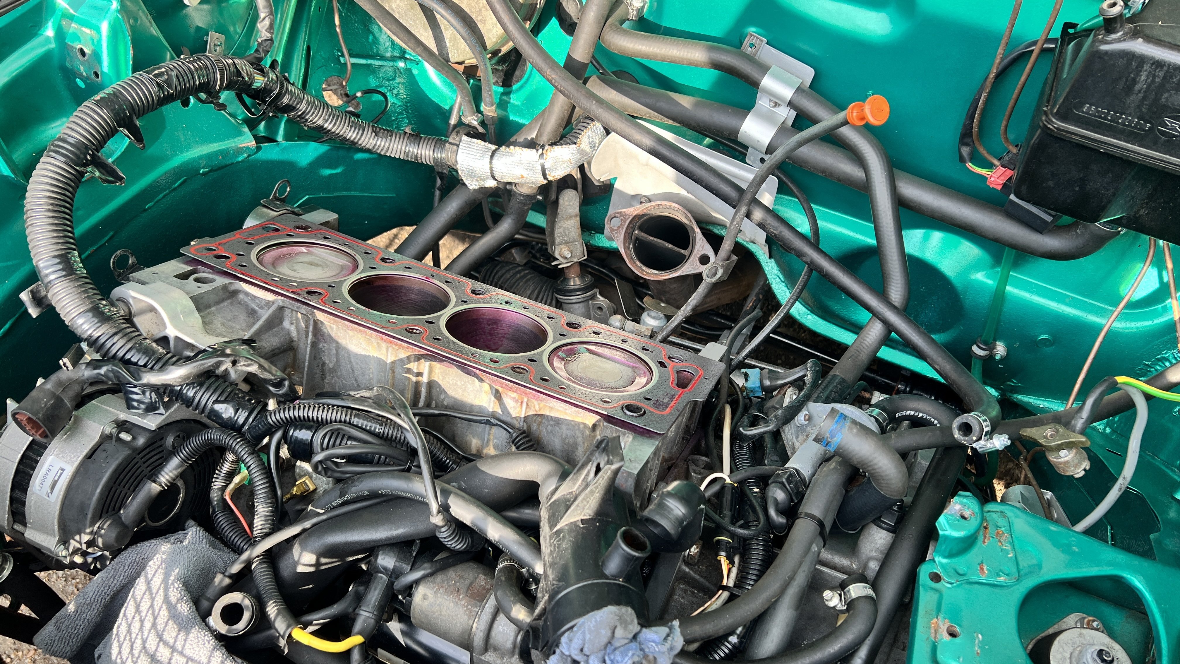

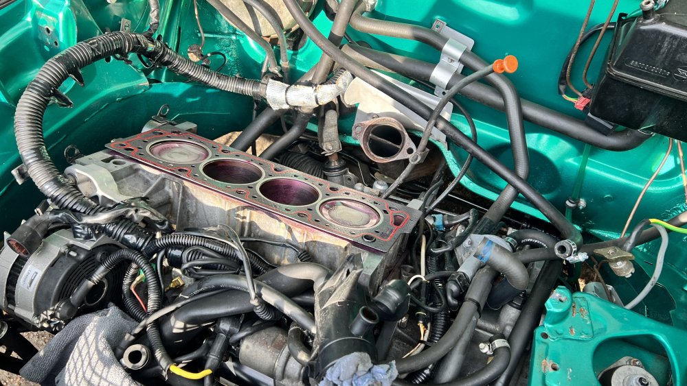

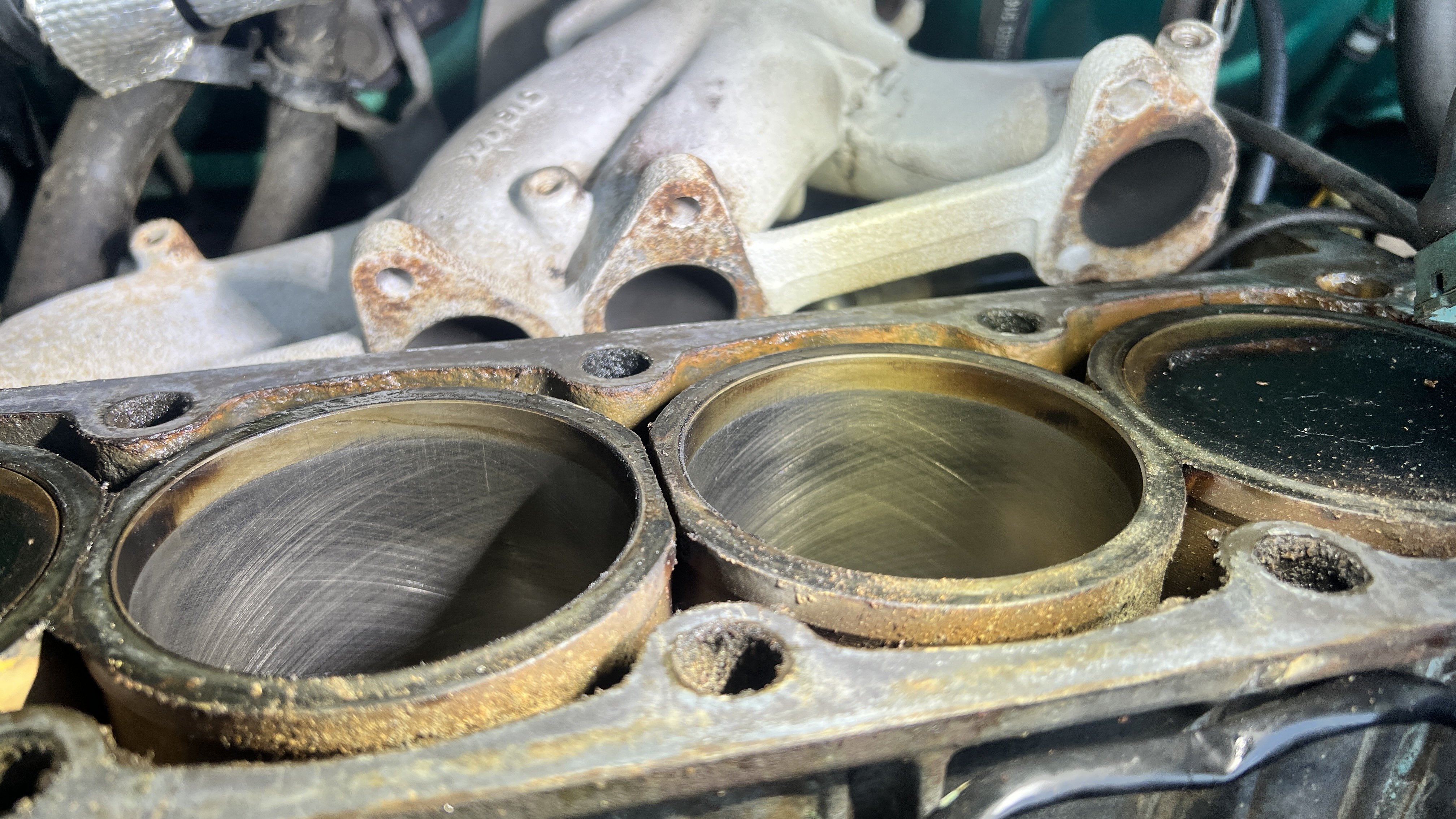

Having laid it up because of an external head gasket leak, 2 years have passed without it being touched so decided it was time to drag it out the lock up and take it to work where I would crack on with it on lunch breaks & evenings. All came apart lovely, gave it a good clean up. It still comes up well considering it has been 10 years since its refresh. I did a leak down before pulling the head, all readings were very even which was a good sign as the car has clocked 109,000 miles. Once the head was removed the bores looked very good with no lip of bore wear & the original cross hatching is still visible. I’ve had a head done ready to bolt on for a while that’s been flowed, with 3 angle seats, modified back cut valves & increased CR to pep it up a bit being a 1600, I’m retaining the original cam but may swing timing on the dyno. If I can teased 125+bhp I would be very happy. We shall see.  IMG_1512.thumb.jpeg.f8dfae7bed3a0e3361ef21554a8e794e.jpeg

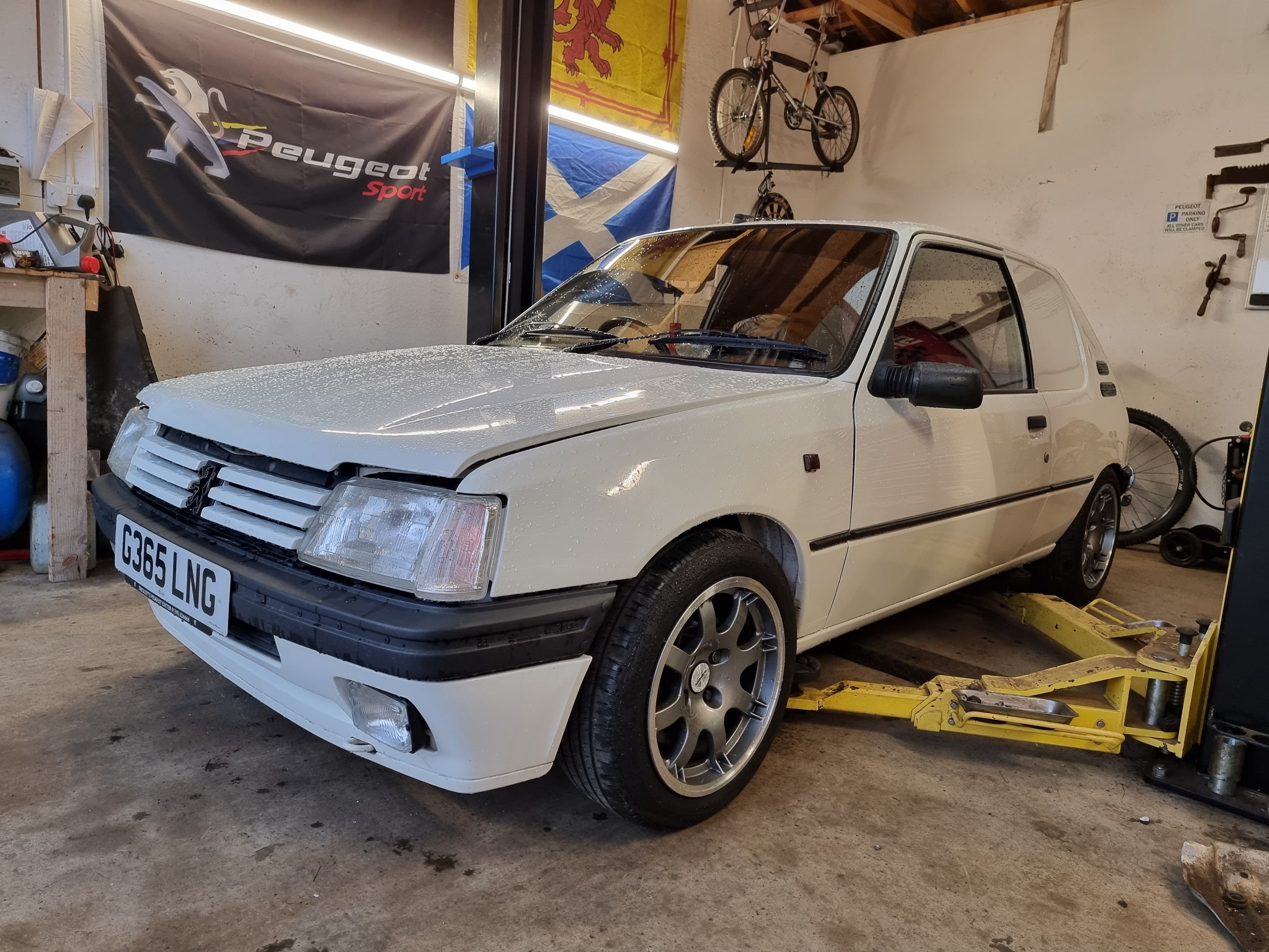

Had a good day on the car today. Got the modified loom to suit the new Emerald ECU instant. Along with a few dodgy lights and wipers fixed for the MOT.
Even washed it!
Next Friday its off for mapping, then I can hopefully get a track day in this year!

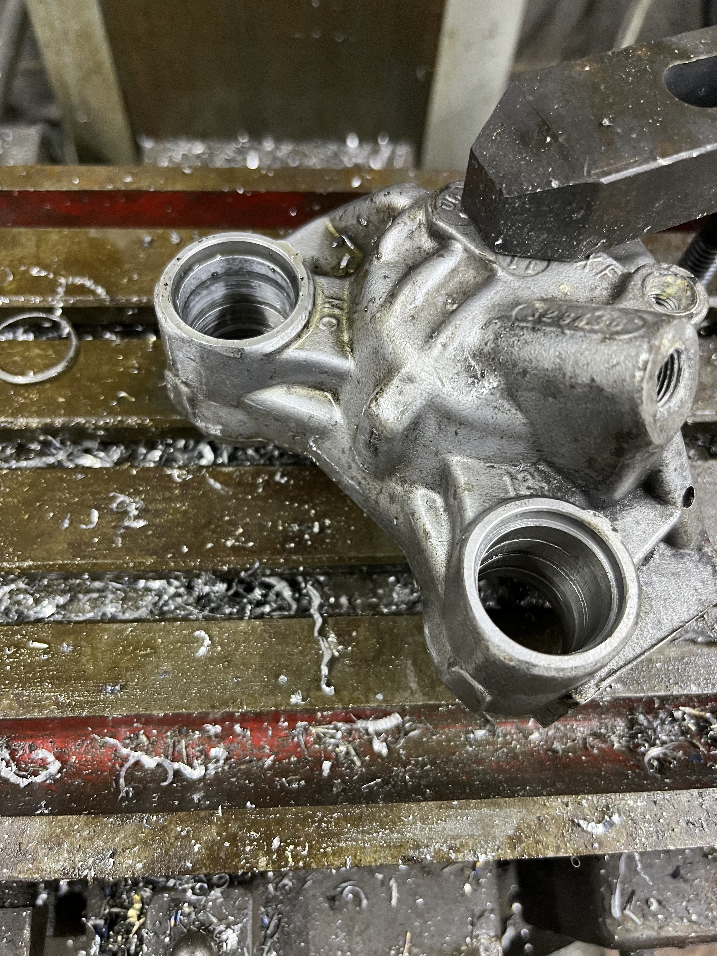

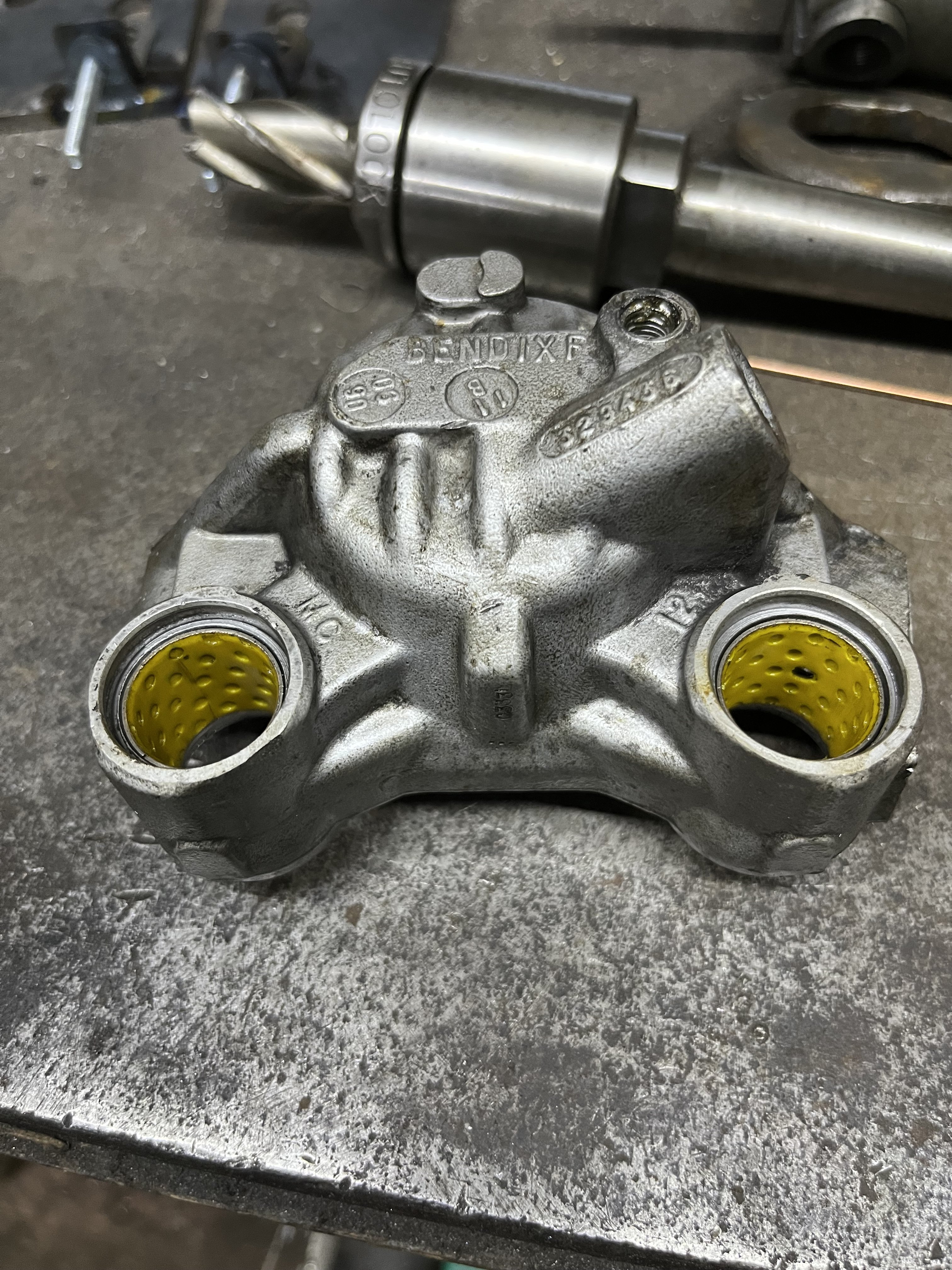

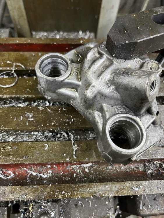

You can’t rush a good job, I’ve been mulling over doing this for at least 10 years.
1.6 GTI Bendix calipers are alloy bodied and run on a pair of steel slider pins, I’m assuming ground and plated, so a lot harder than the cast alloy body. The body wears over the years and the result is a horrible knock especially when you change direction, so when reversing basically.
So finally bought some tooling for the mill and some glacier bushes and did a thing :D
New slider pins and rubber gaiters etc ordered, then I’ll build them up. I’m also considering adding grease nipples to be able to pump some grease in there to properly lubricate it all.
  • Like 5
Nice work, there are some availability in the unbranded aftermarket but I'm not sure of the quality on them, George bolted some up to his cri this week and they didnt slide as freely as I think they should, though the bolts went in easy.
