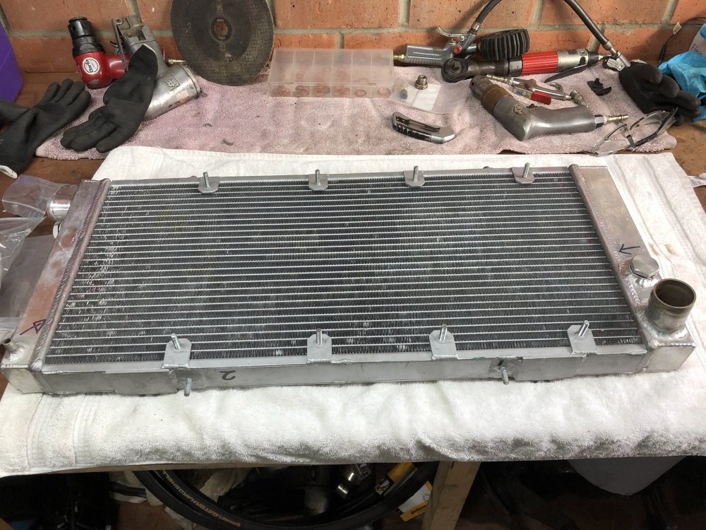

Removed the rad to get it leak tested

Thats a clean looking engine bay Graham, very nice

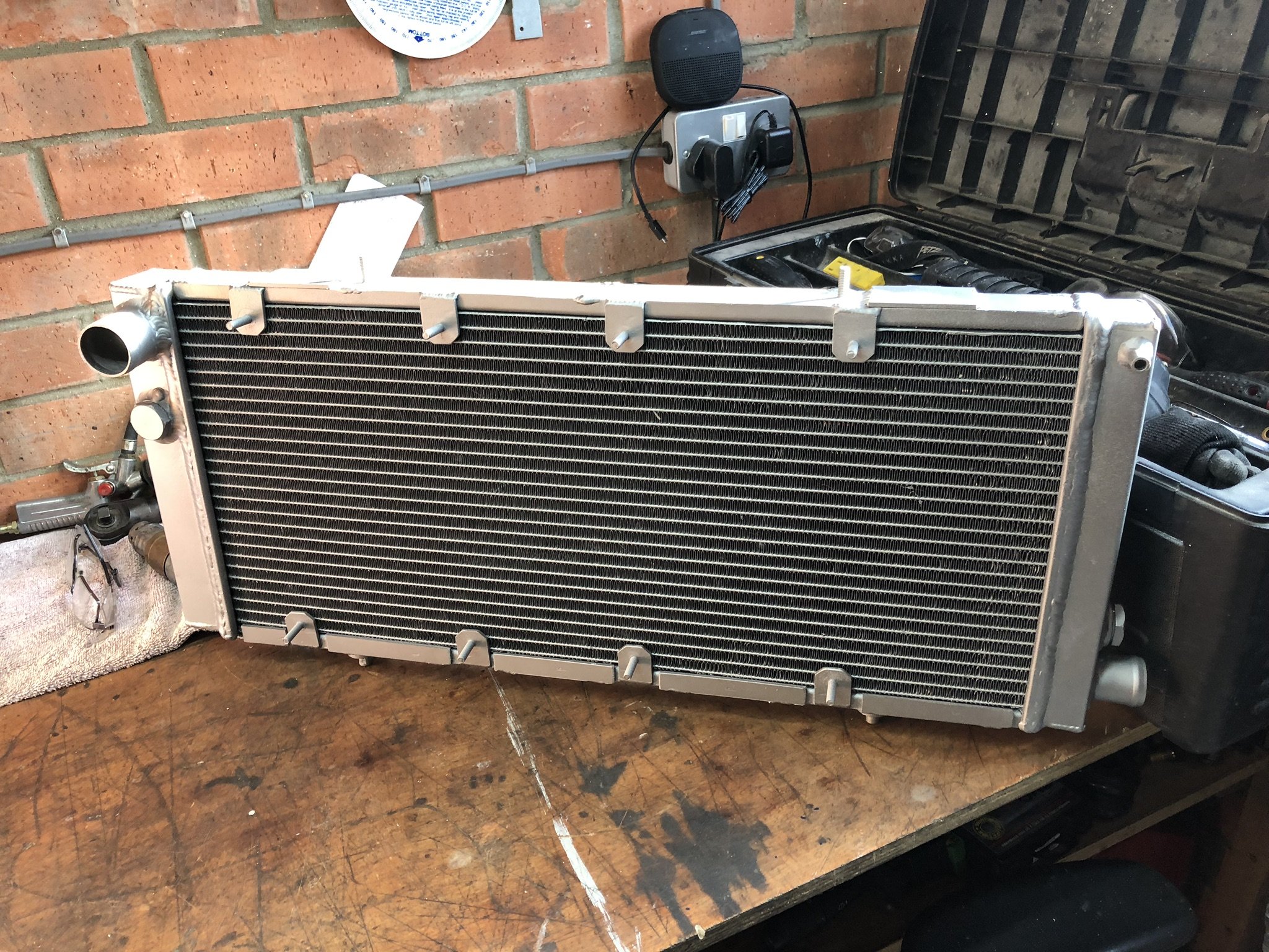

Cleaned and oiled my air filter and refitted my rad after having a new core fitted

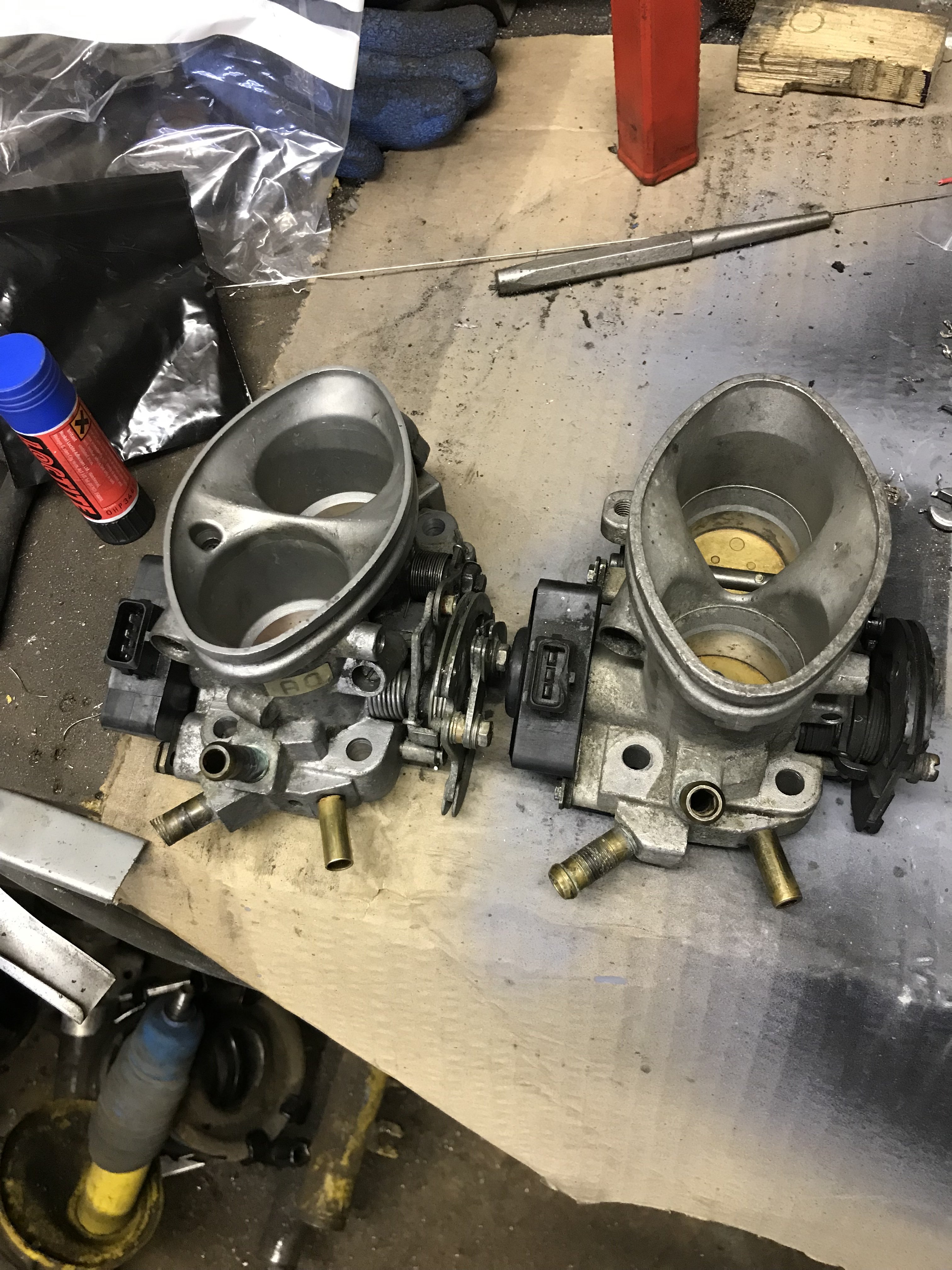

Rebushed a spare AMC Mi16 throttle body I had. It went so well I took the Weber one off my rally car and did that too. Good as new now, all the slop gone out of the spindles.
  • Like 3
  • Haha 1

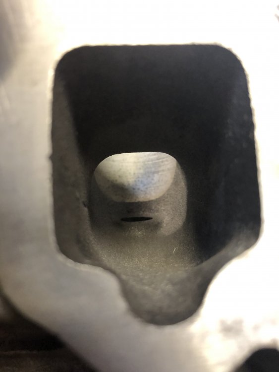

Starting cleaning and opening up the the throats on a spare cylinder head and improving the radius on the short side today. Looking to improve the pick up and torque by giving it a bit more compression & 3 angle seats. I’ve already modified the backs of the inlet valves and slimmed the stems down slightly. I will be very happy if I can get near to 1.9 power out of a 1.6.
