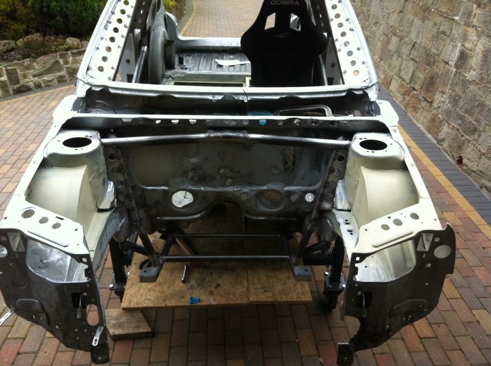

Its been over a year since I last updated this project thread. Work and family commitments have taken priority this year but things are progressing pretty well recently. My target is to finish the car late spring/summer 2016, iron out any issues and hopefully compete in time attack 2017!.
Big changes with the car. First off I cut out the inner arches and fabricated new tubs to allow clearance for 9J wheels at my desired ride height. I then moved onto the T45 roll cage, steering column, seat rails etc.
The one thing I wanted to do is reduce the amount of understeer. Along with the new 9J wheels, I have decided to widen the track and make it fully adjustable. I am currently working on a tubular subframe, wishbones and fabricated uprights. More pics to follow......
