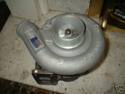

He he, look what I've just bought :D
Who needs two turbos when one from a train will do :huh:
miamistu
Pop a coke can next to it and take a pic for a sense of scale :huh:
Lillpete

Take it you'll be running more than 7psi with that! Looking good!
M3Evo
Apparently the standard bottom end for a late engine (8.8:1 compression) will hold 20psi and in so doing generate around 360bhp at the wheels, which will be fun :huh:

tom_m
holy mother of god that turbo has to be the size of your head!!! surely thats going to be a lag-fest????
M3Evo
Apparently they'll start to make boost by around 2500rpm (not all that much though, couple of psi)
I'm considering the possibility of doing another twin turbo setup only this time using something like a T25 to make boost pretty much off idle followed by the Holset to carry it through to the red line.
However, sequential TT setups seem to be pretty complex and I can't imagine it's gonna be easy to implement on a DIY basis.

M3Evo
Well, there's no going back now!
I've bought another turbo! This time it's a Holset HX27 which is good for around 230bhp on a petrol engine or so I gather.
Looks like that piccy up there isn't too far from being right too when you compare it to BMW's own effort:
I'm quite excited about this now, aiming for 450bhp and mountainous torque being available everywhere in the rev range.
Gonna order a forged crank, pistons and steel rods at some point too to make a 2.8 with a nice strong bottom end :ph34r:
