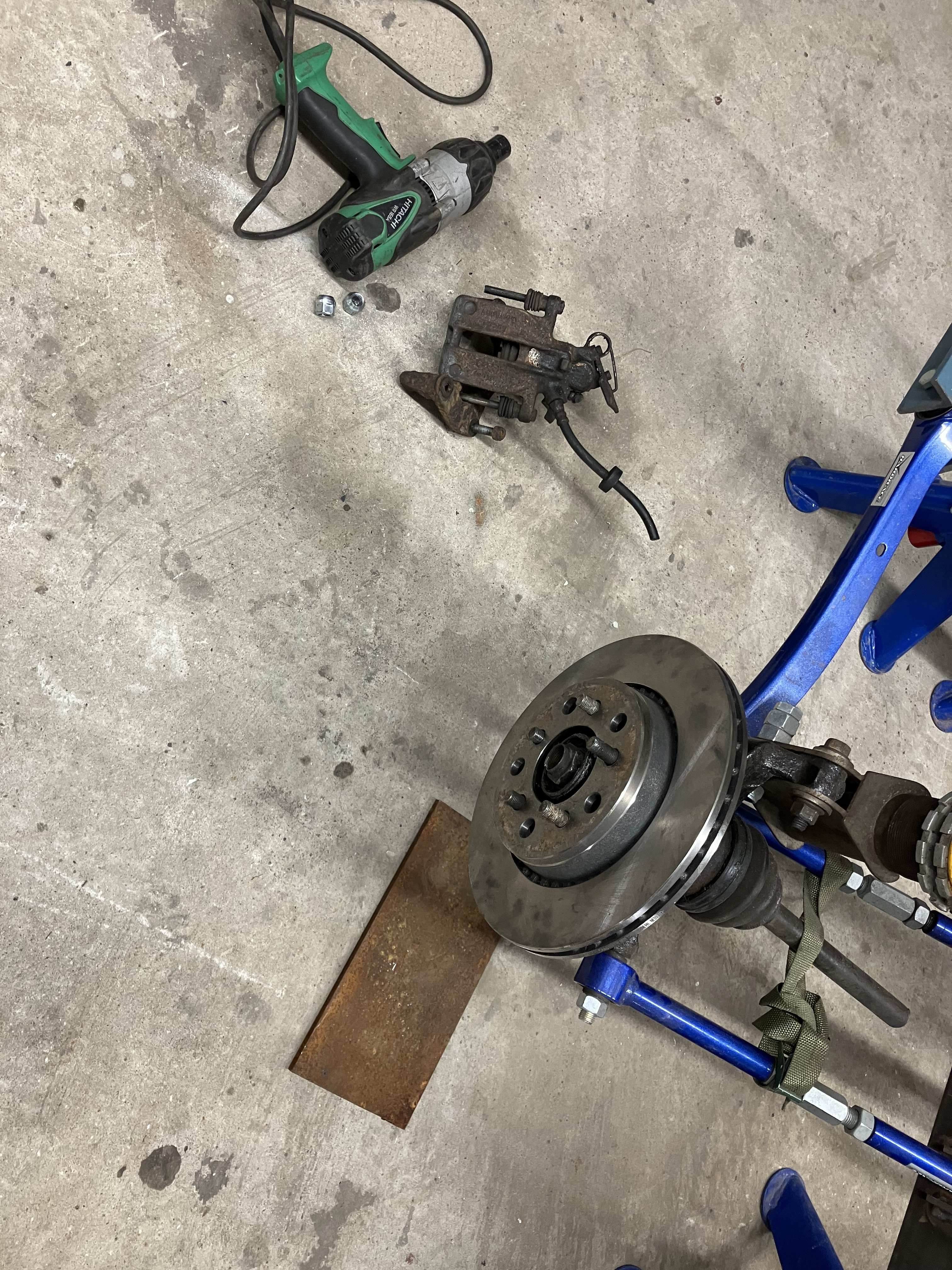

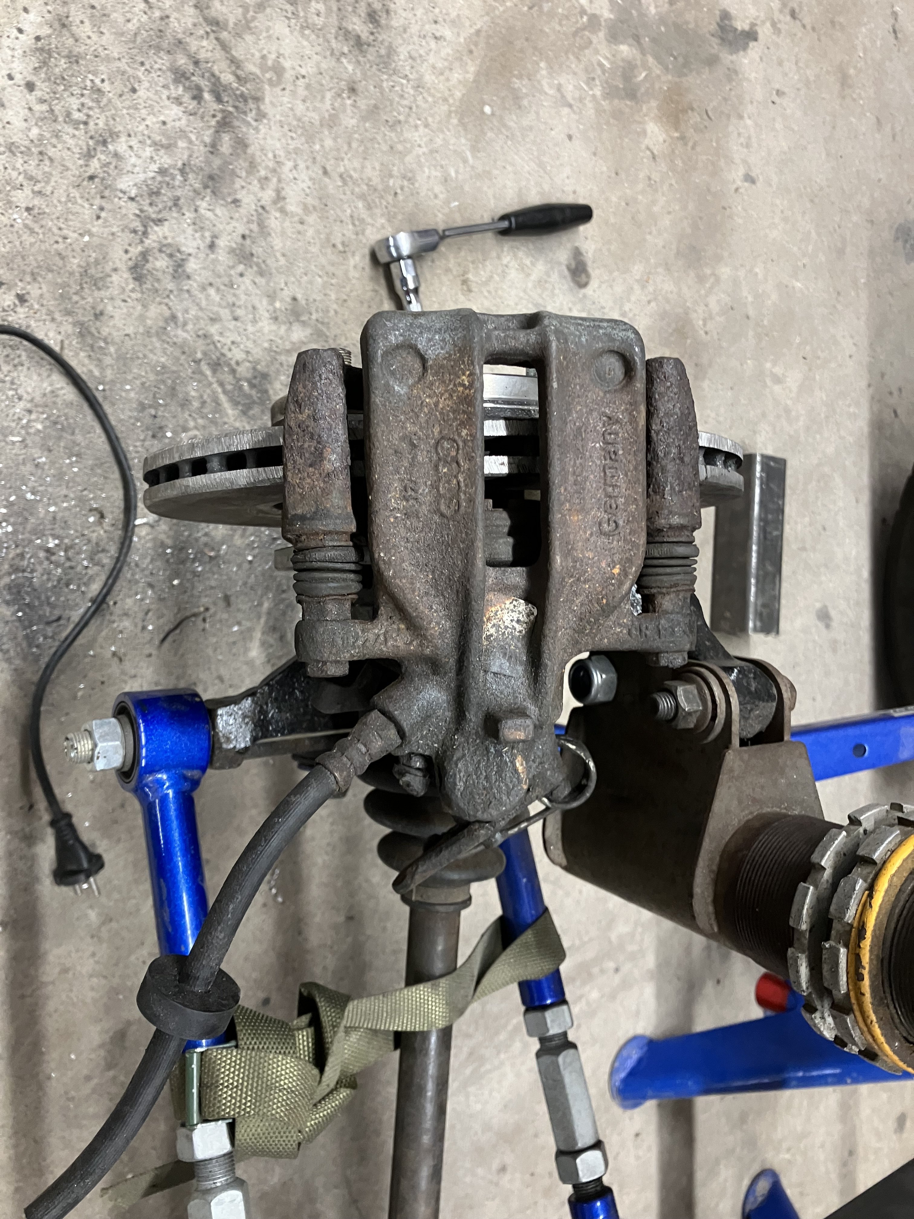

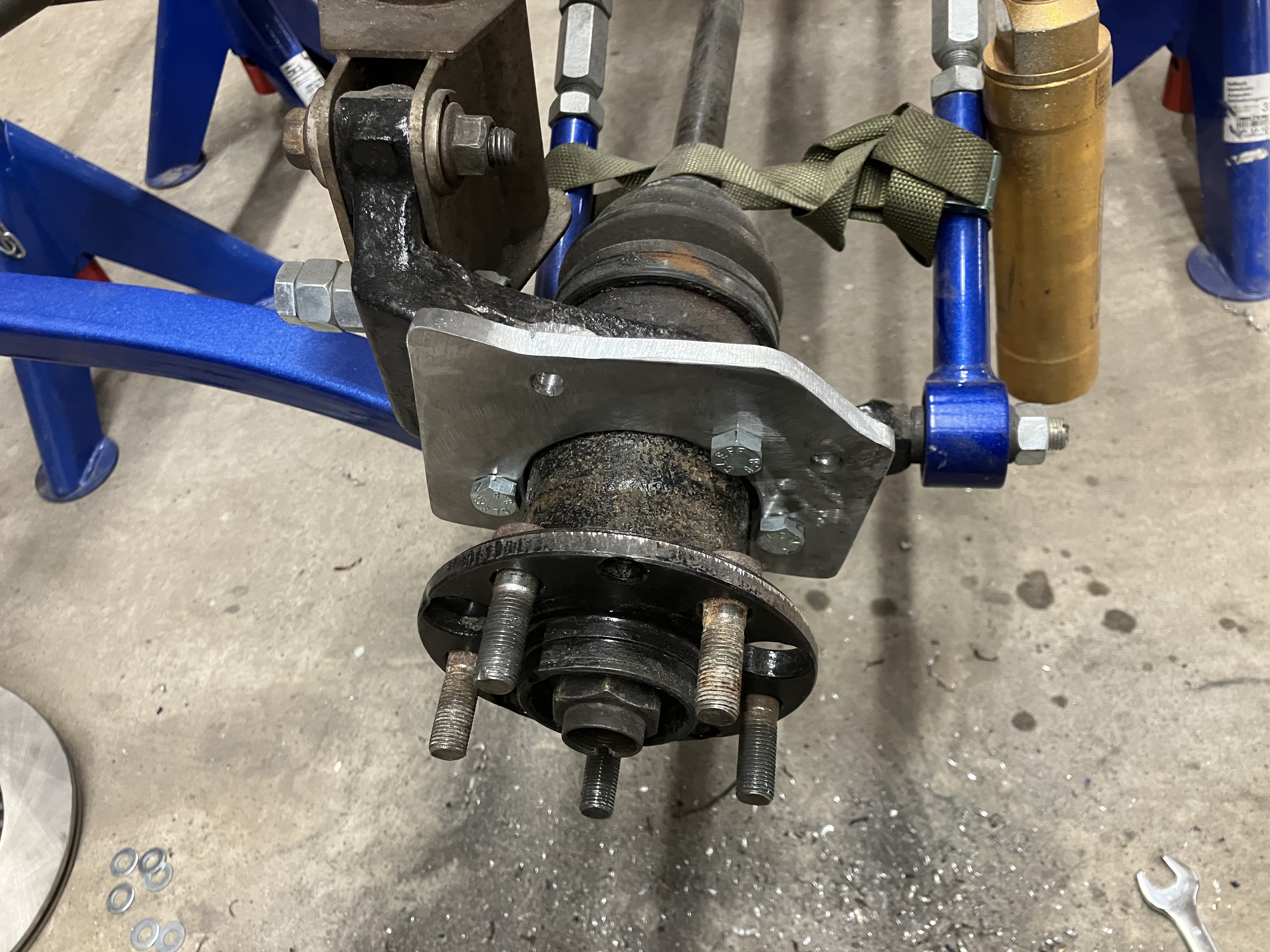

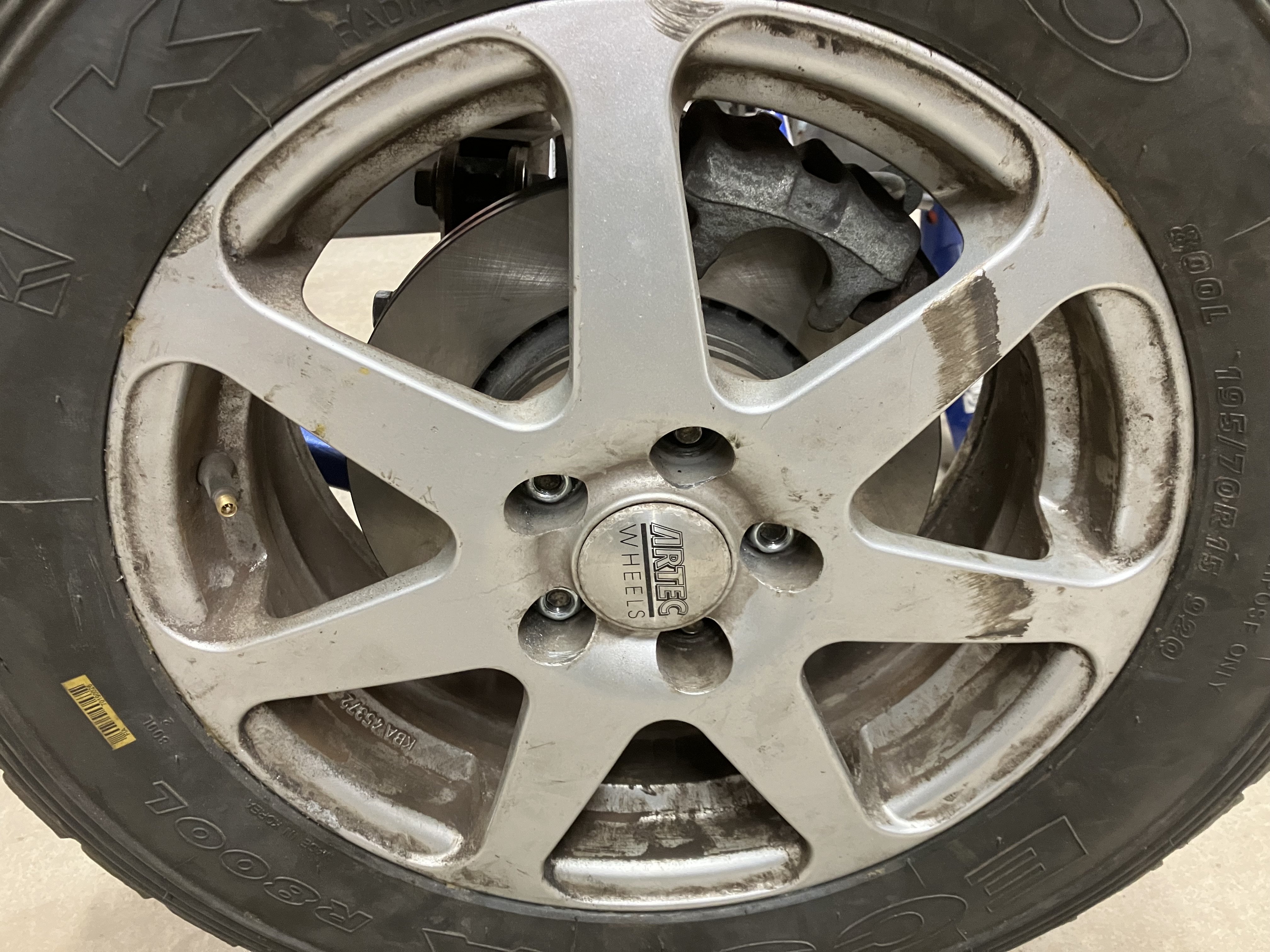

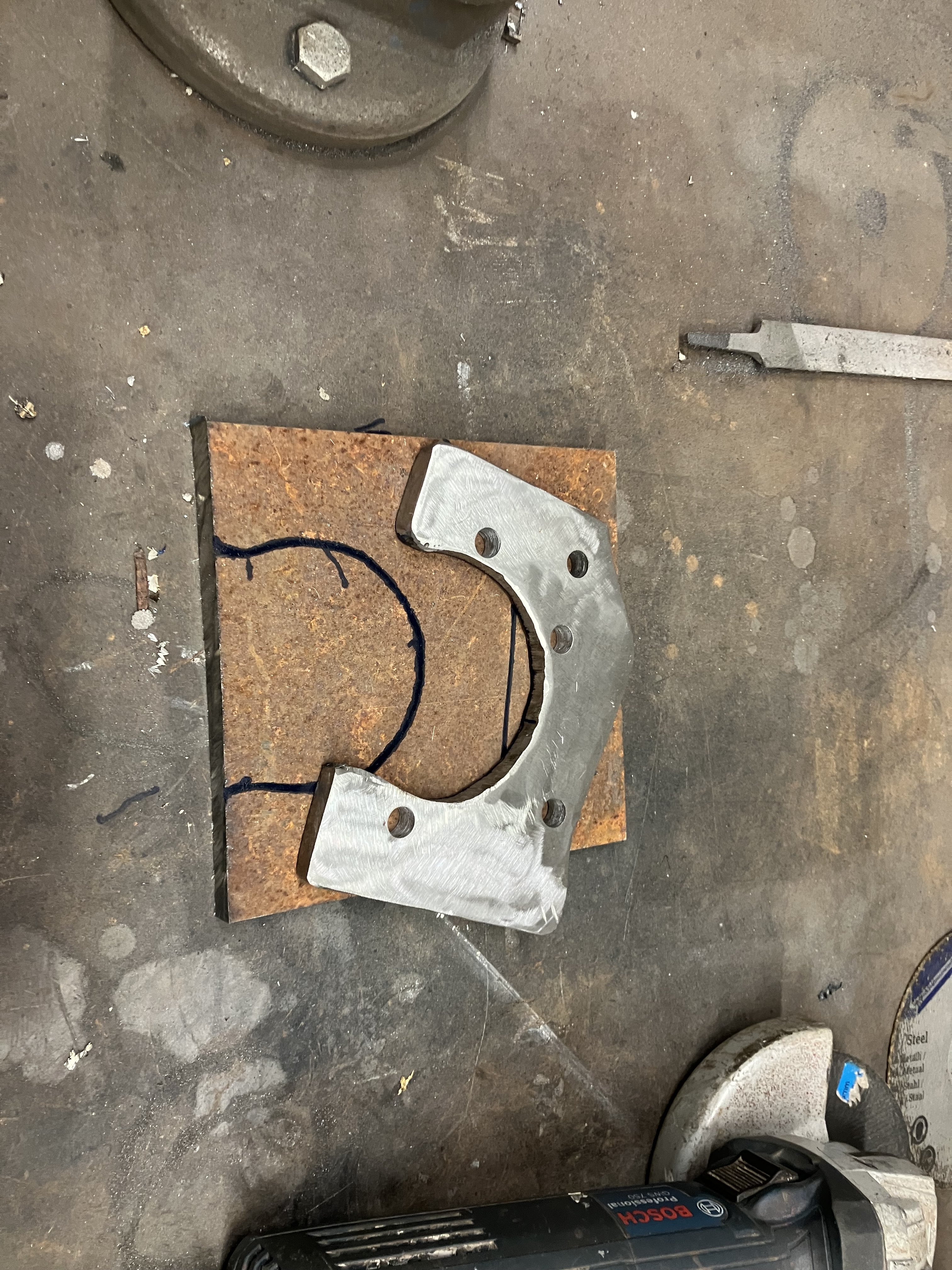

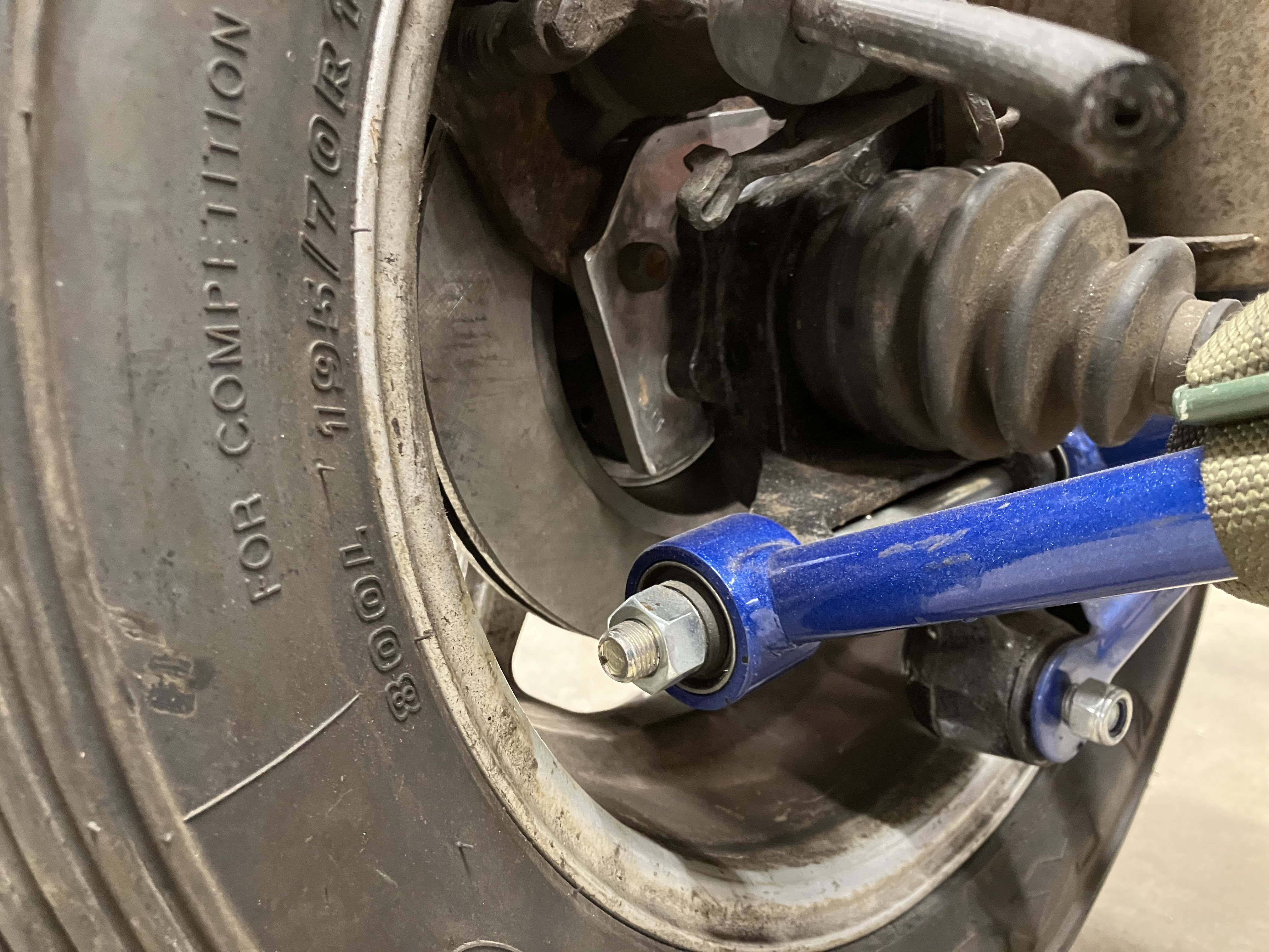

Brakes are done. Audi A8 discs and calipers with homemade brackets. I will probably weld the brackets to the hub later. Its mockup discs, I have freebased the Subaru pattern on the Audi discs.
The right way to go is to change the hub pattern to Peugeot. Then its possible to change weels between my cars and it looks more correct.
Tomorrow I will do the final welds on the rear frame.

I have saved som material to attache a gravel protection inside the wheel

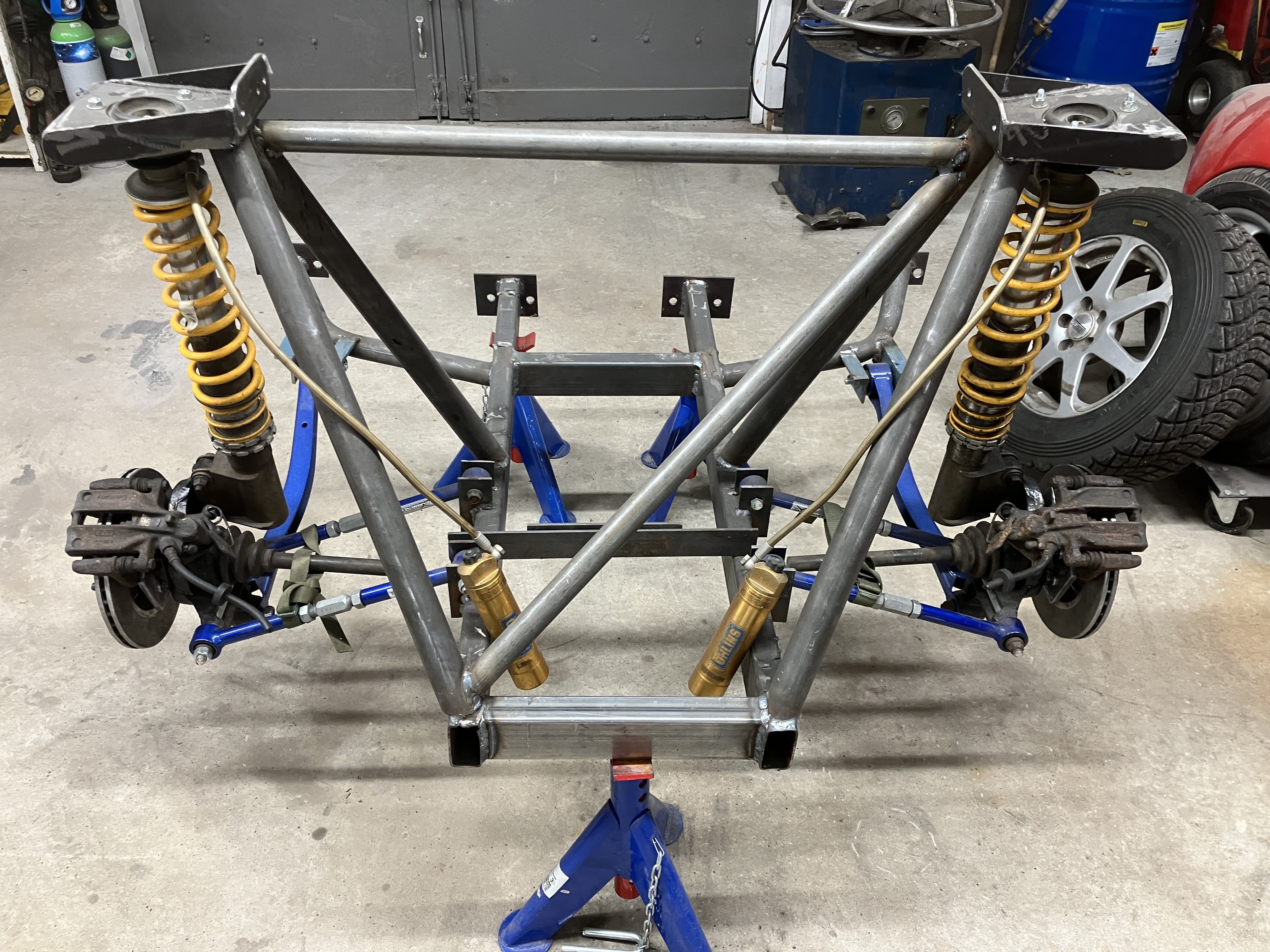

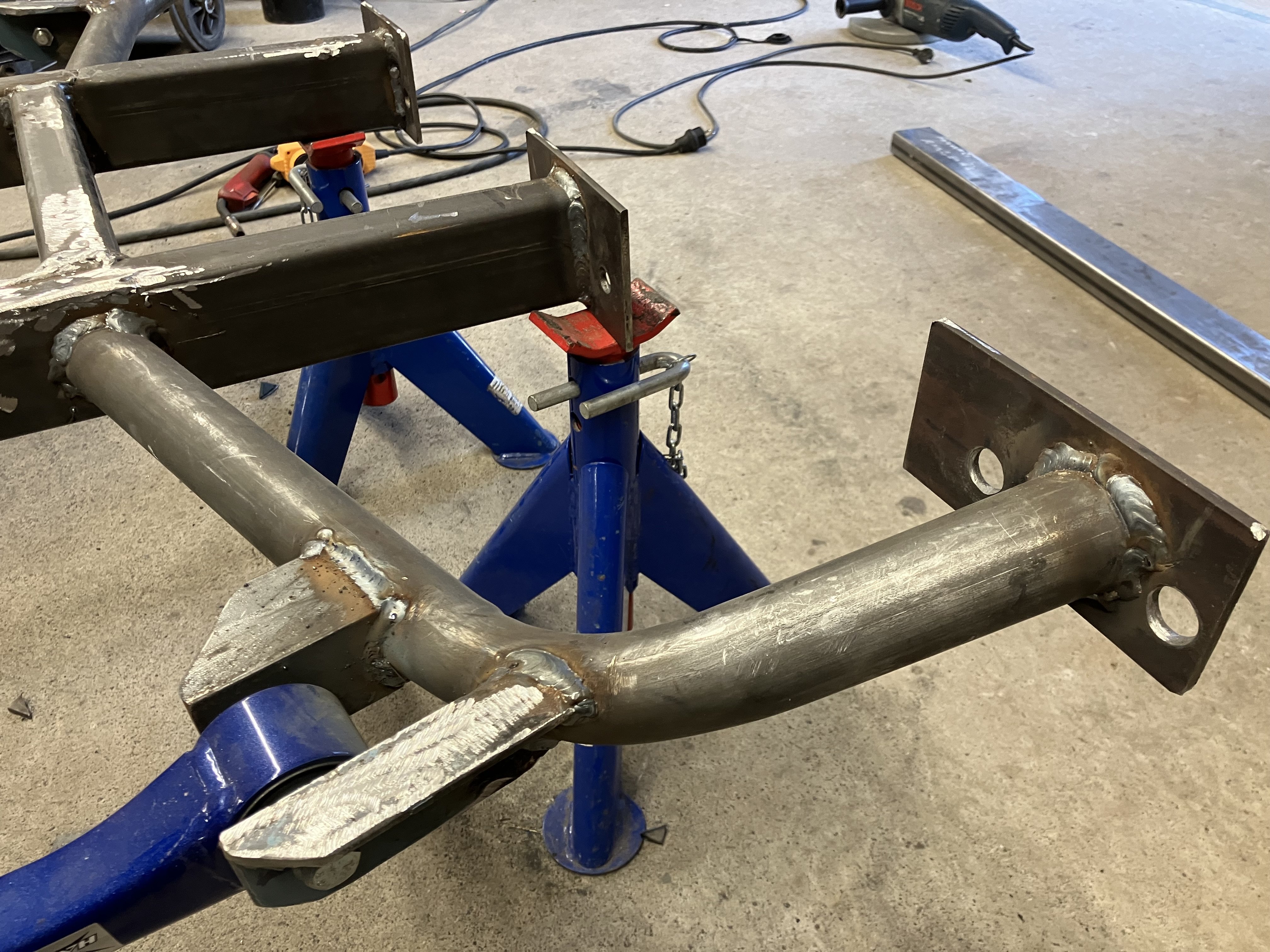

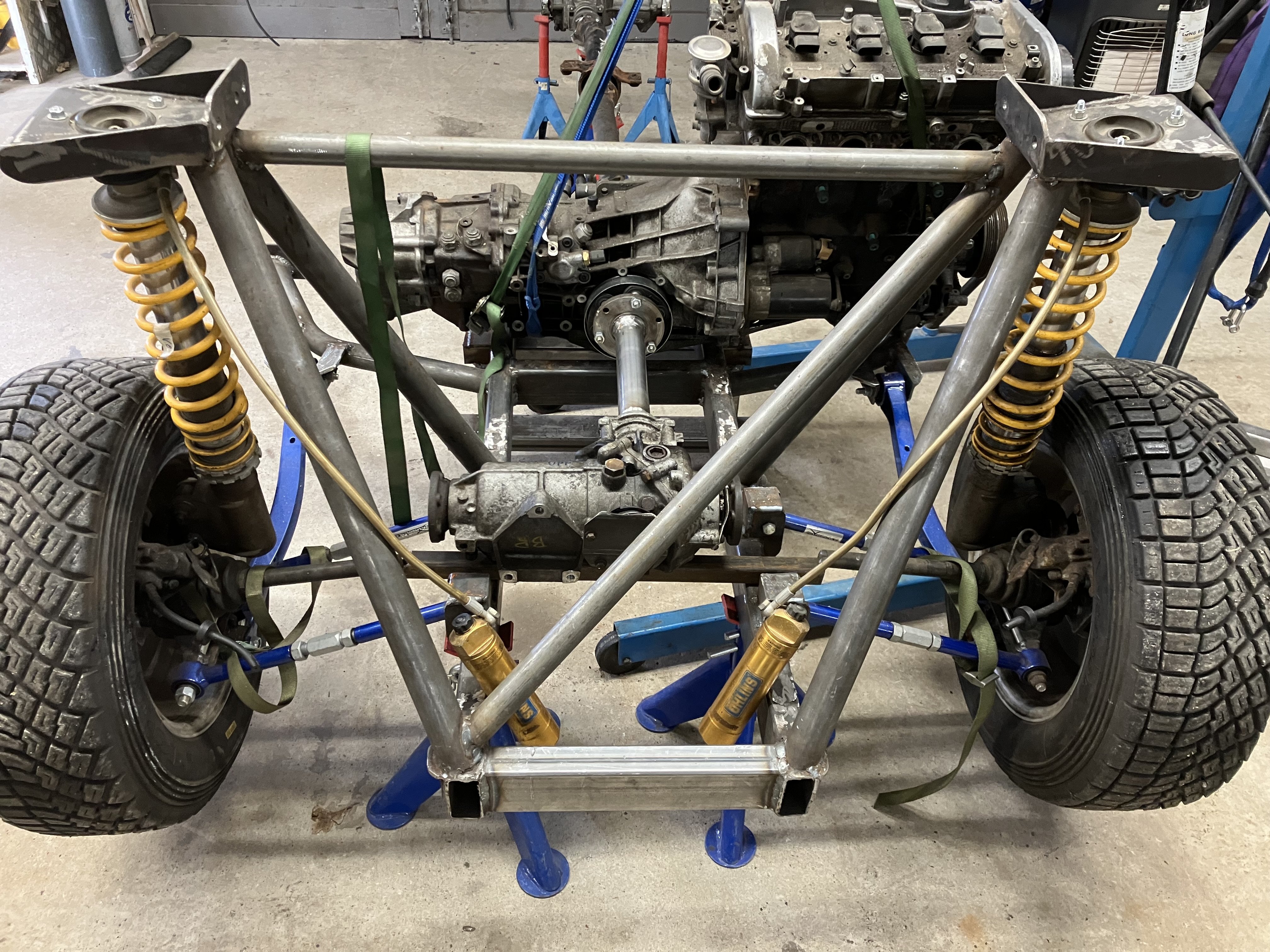

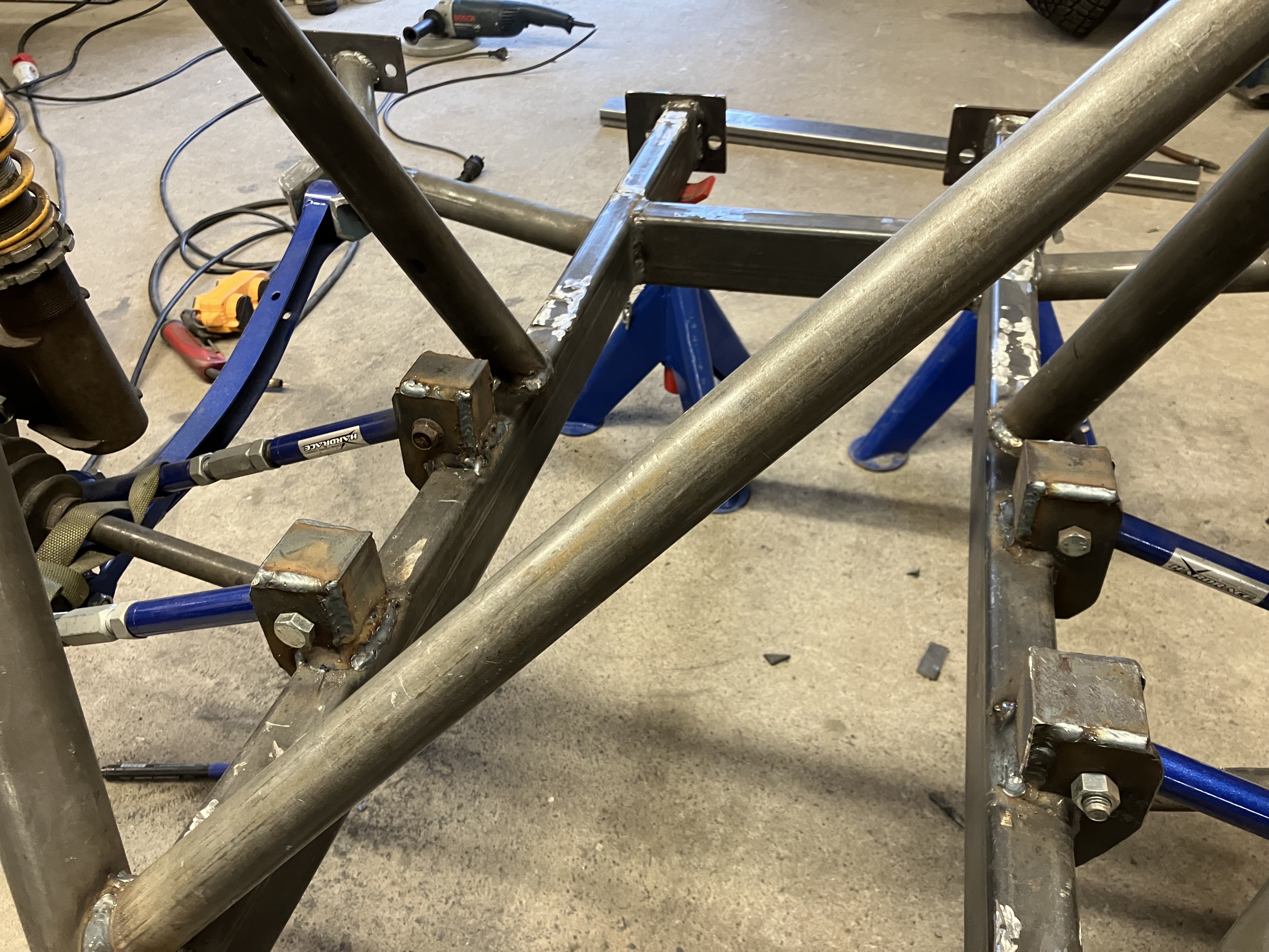

Todays work…. Final weld of rearframe. Next decision is how to mount the drivetrain. From start I planned to have it solid but now I leaning towards polyuretan instead

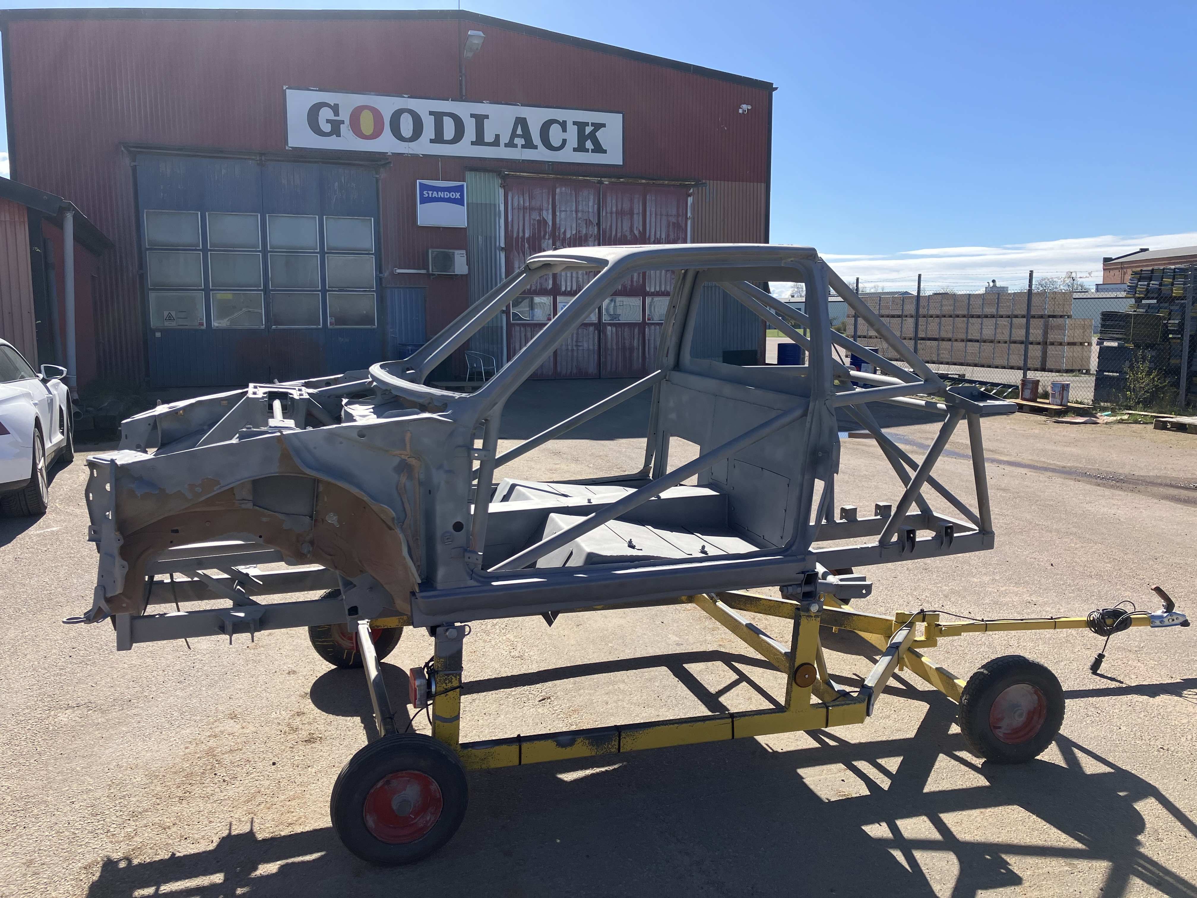

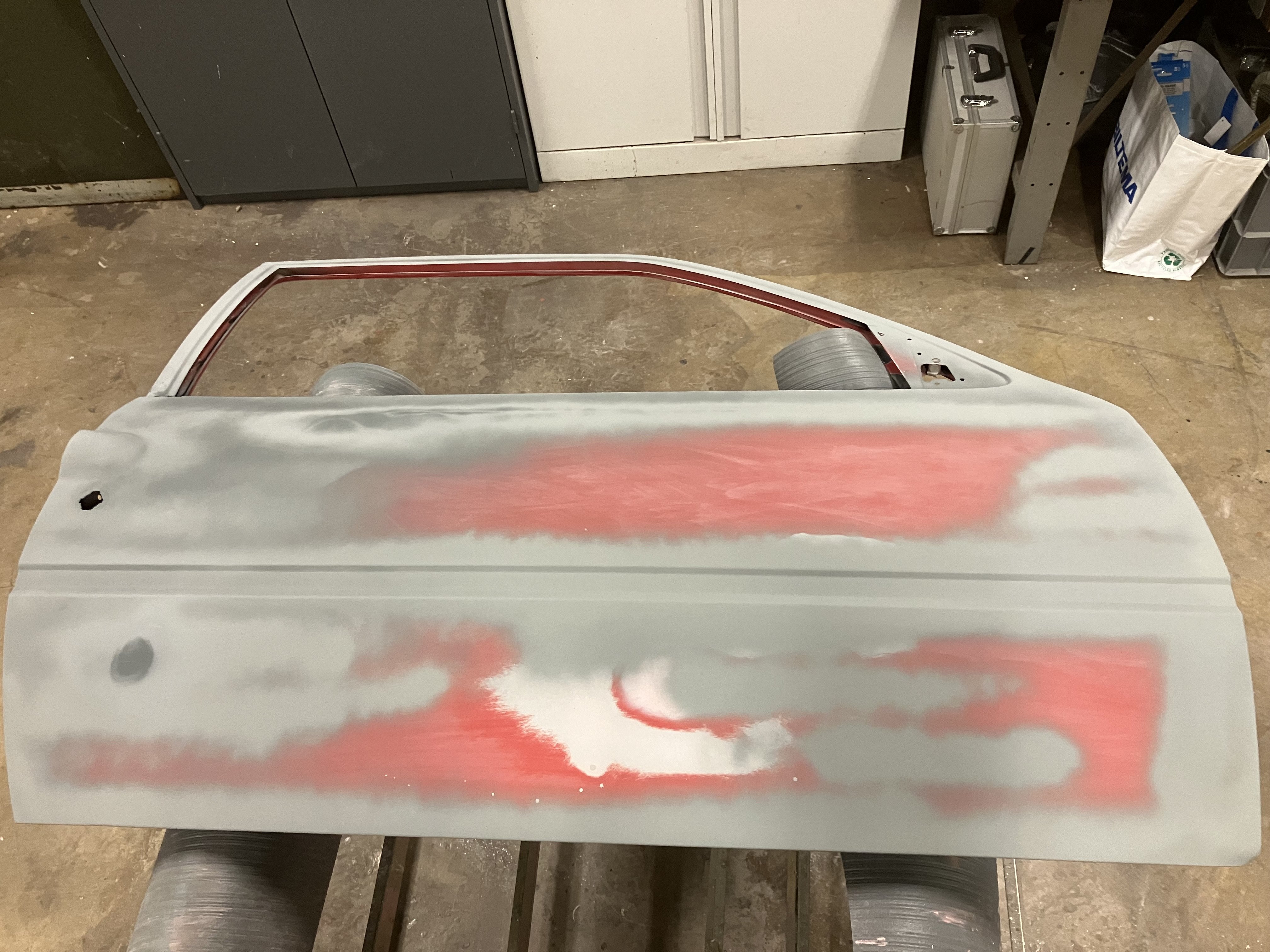

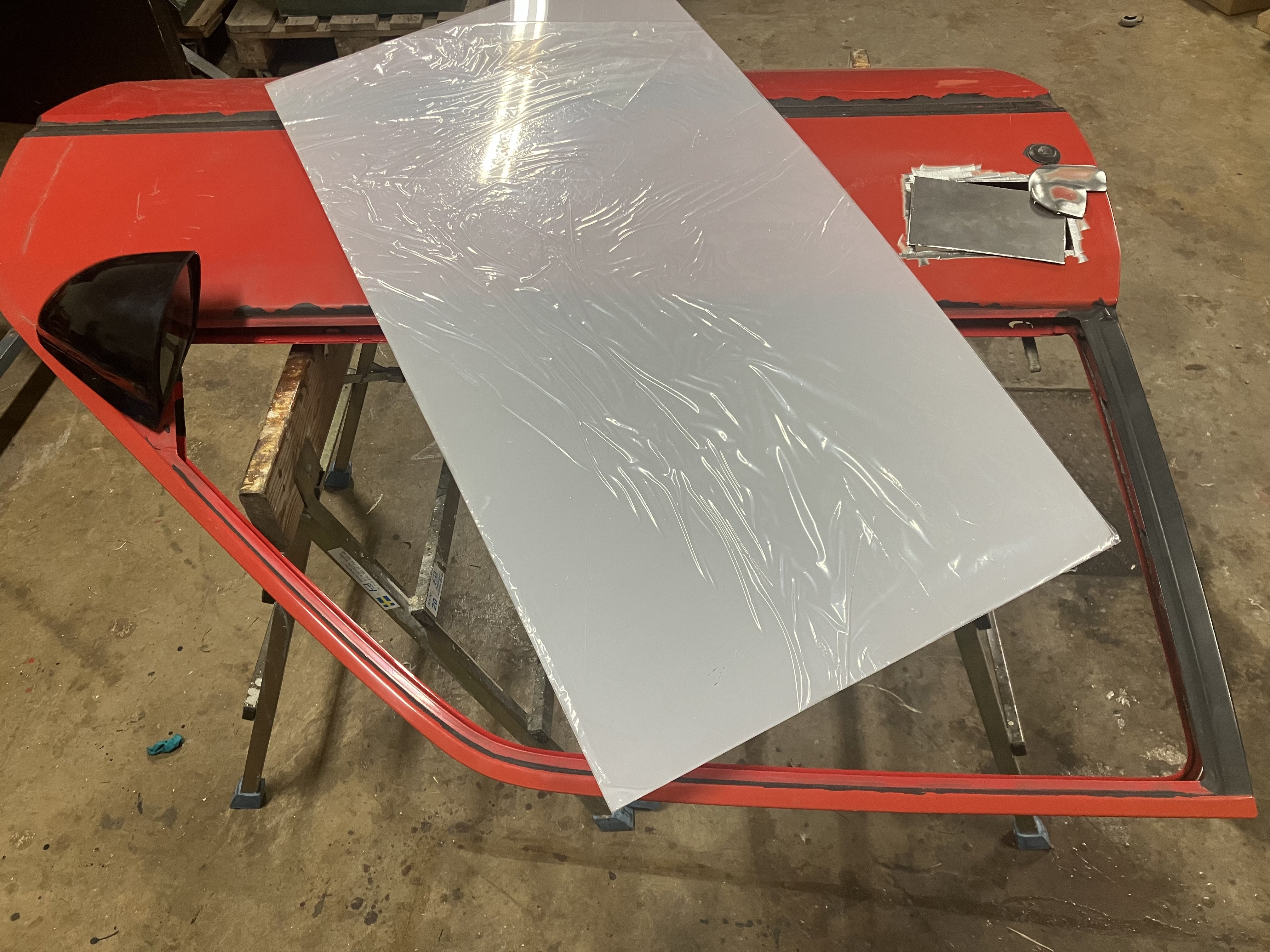

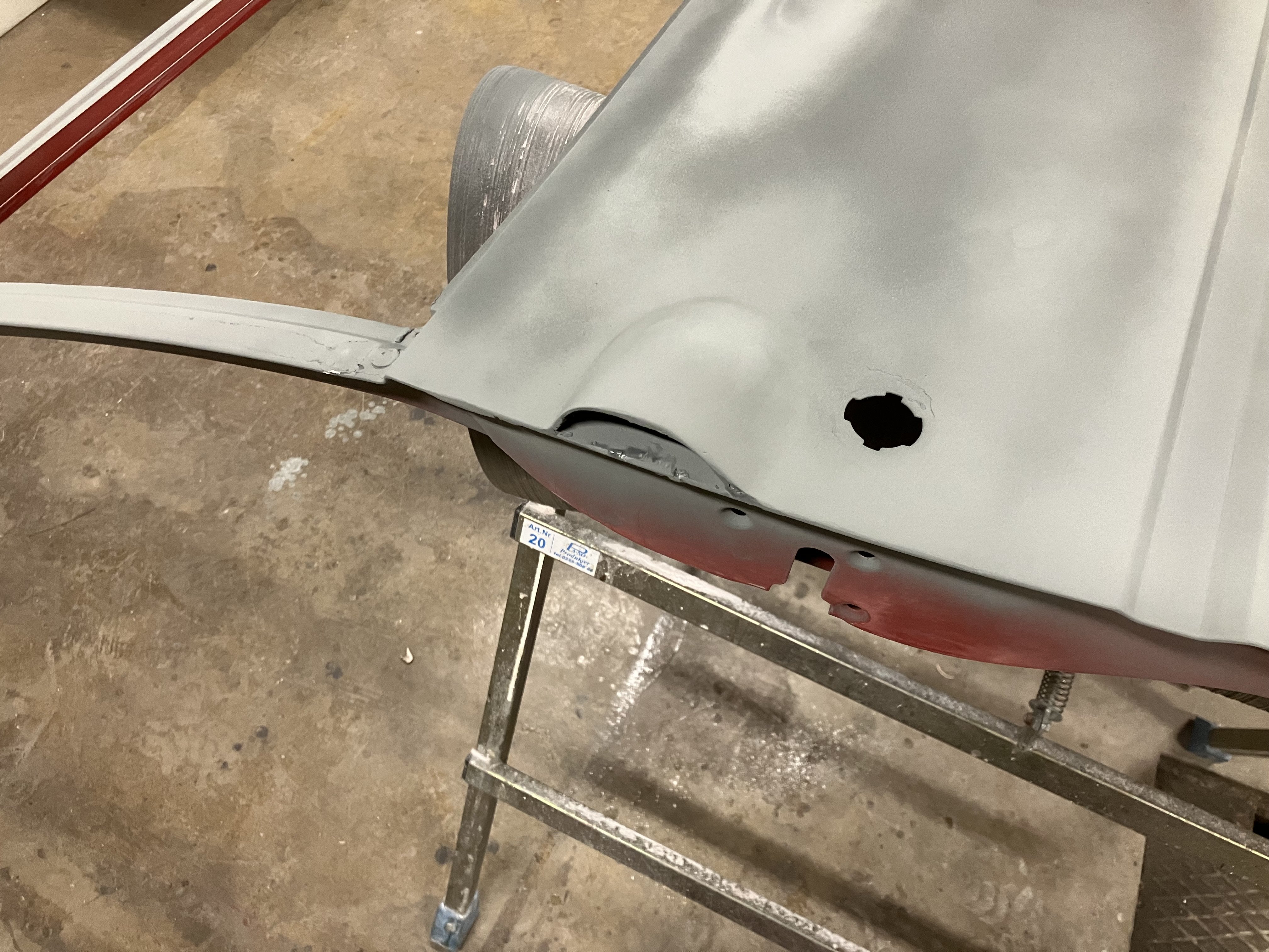

Buildprocess little slow right now……

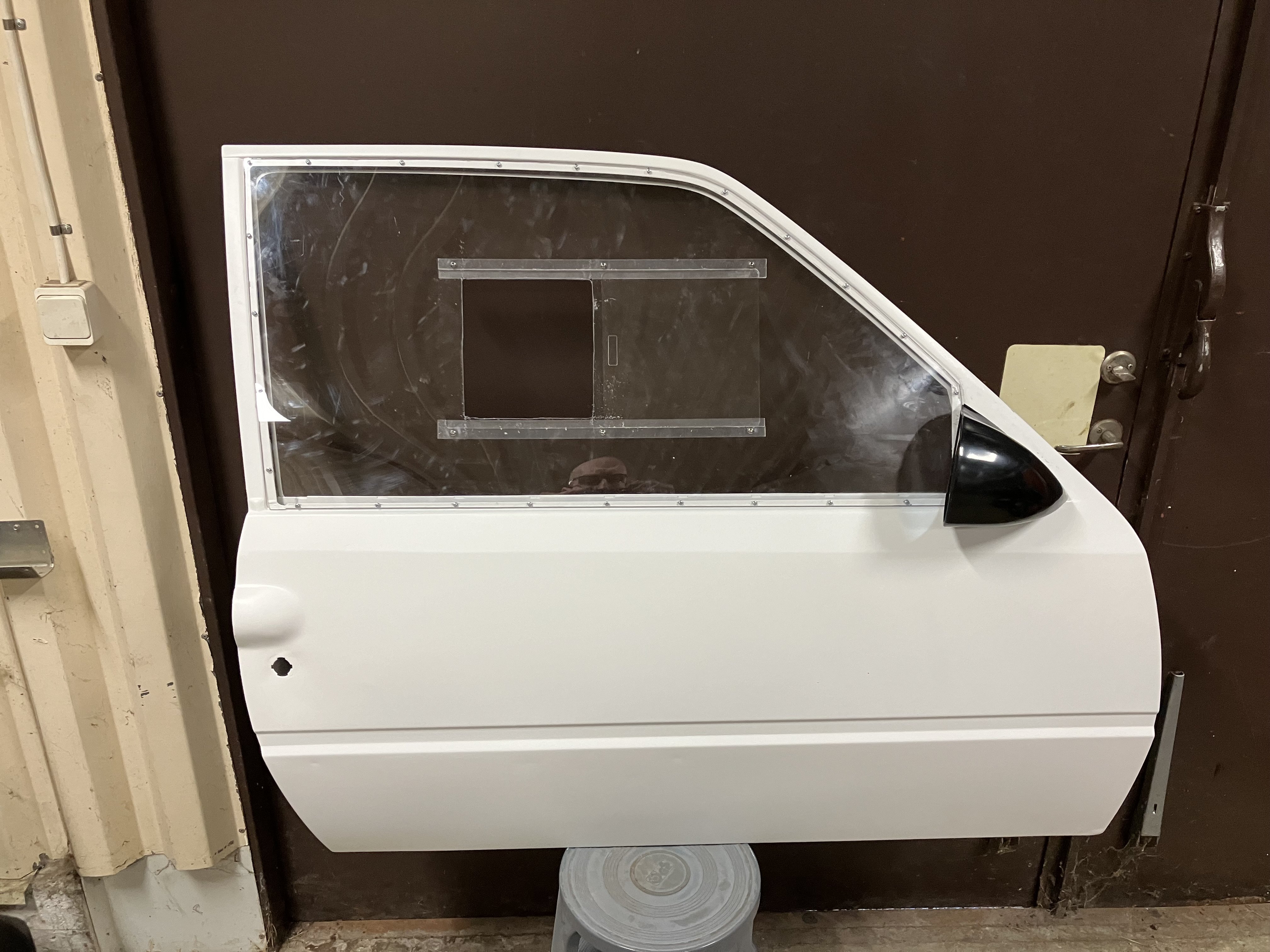

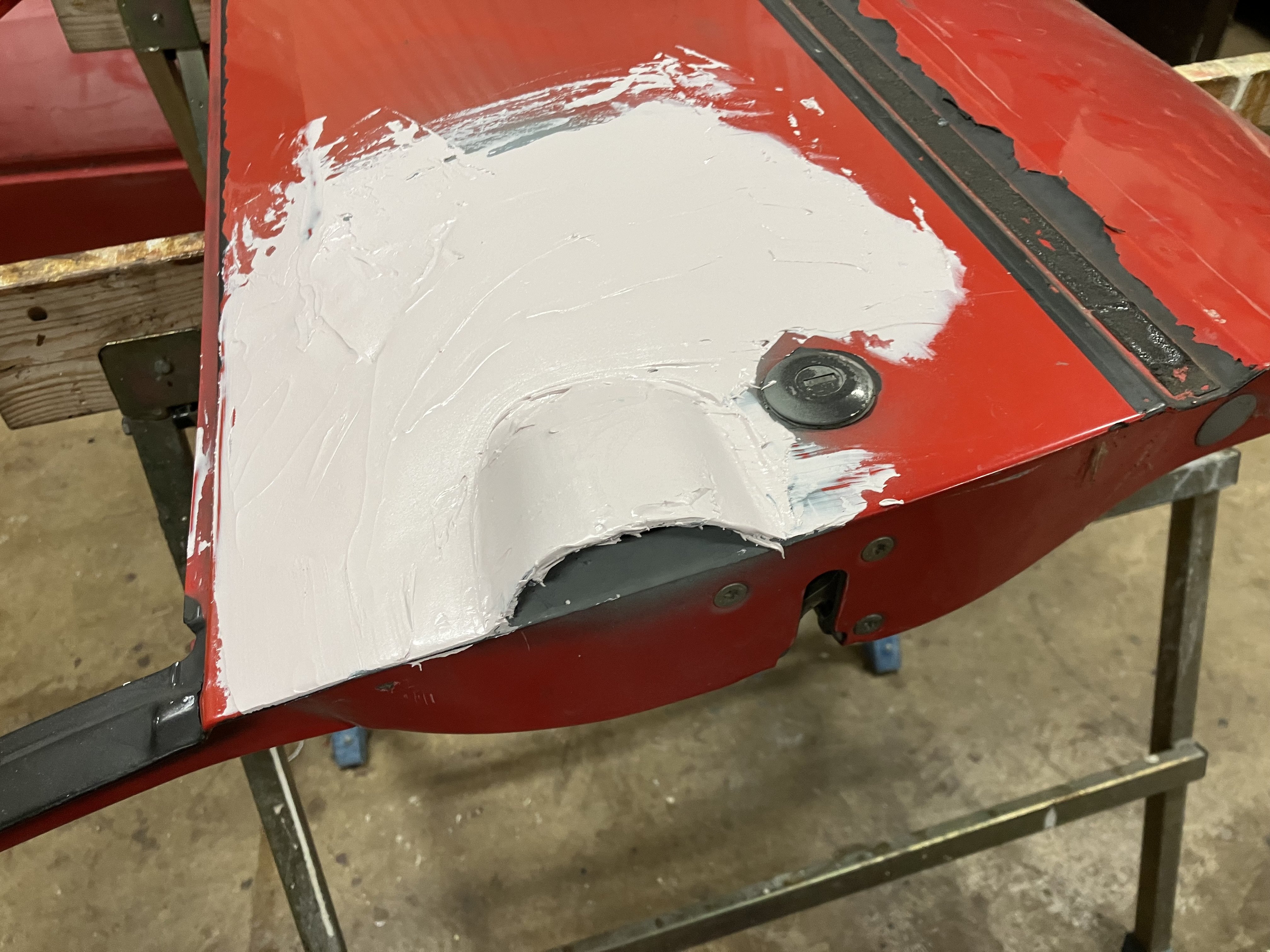

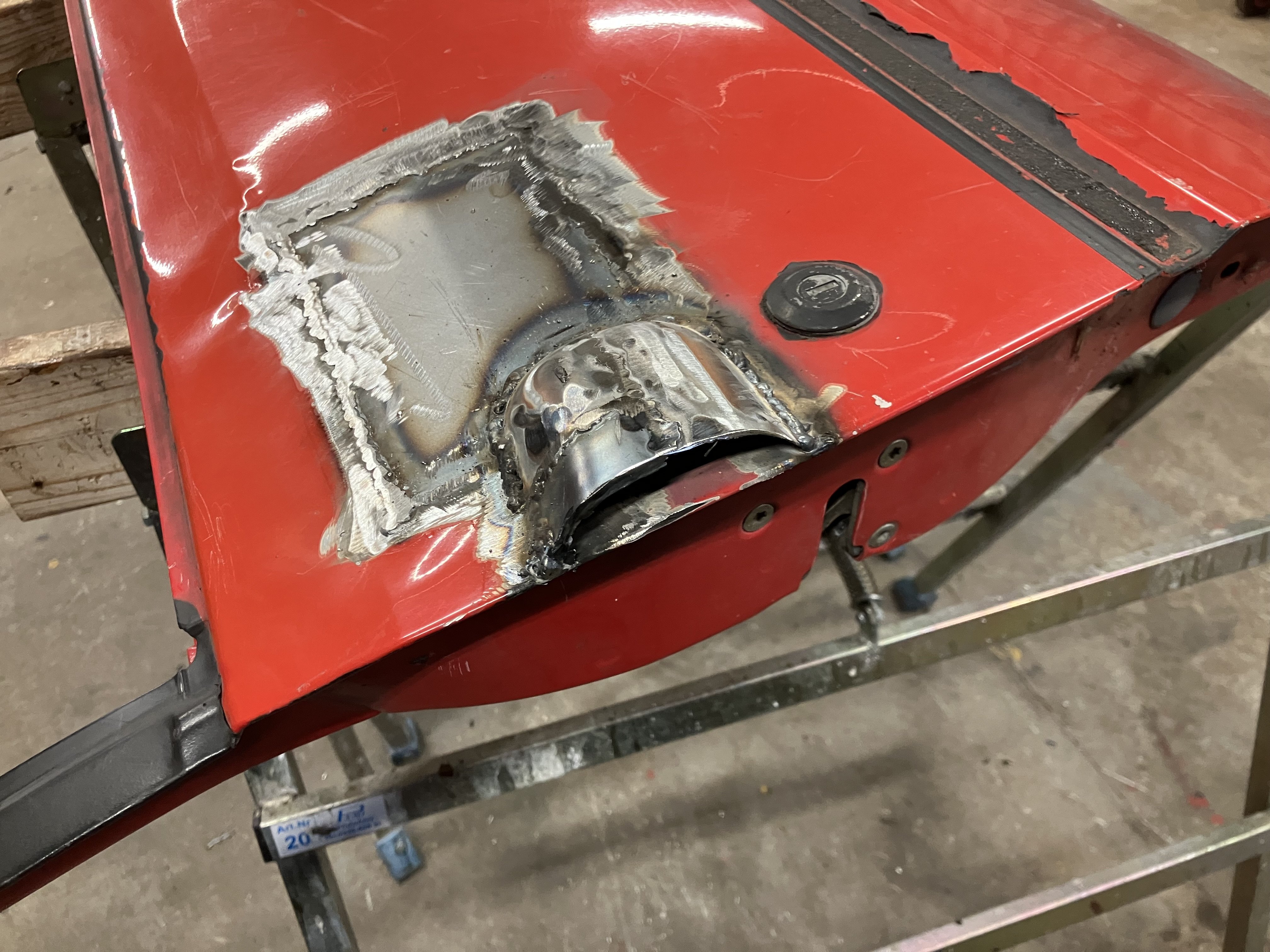

Working on the doors beacouse I would like to have some parts 100% done. I will even paint them and add some grafhix.

Enyone now the coulurcode?
I will paint it white with some 2K boat paint I think.

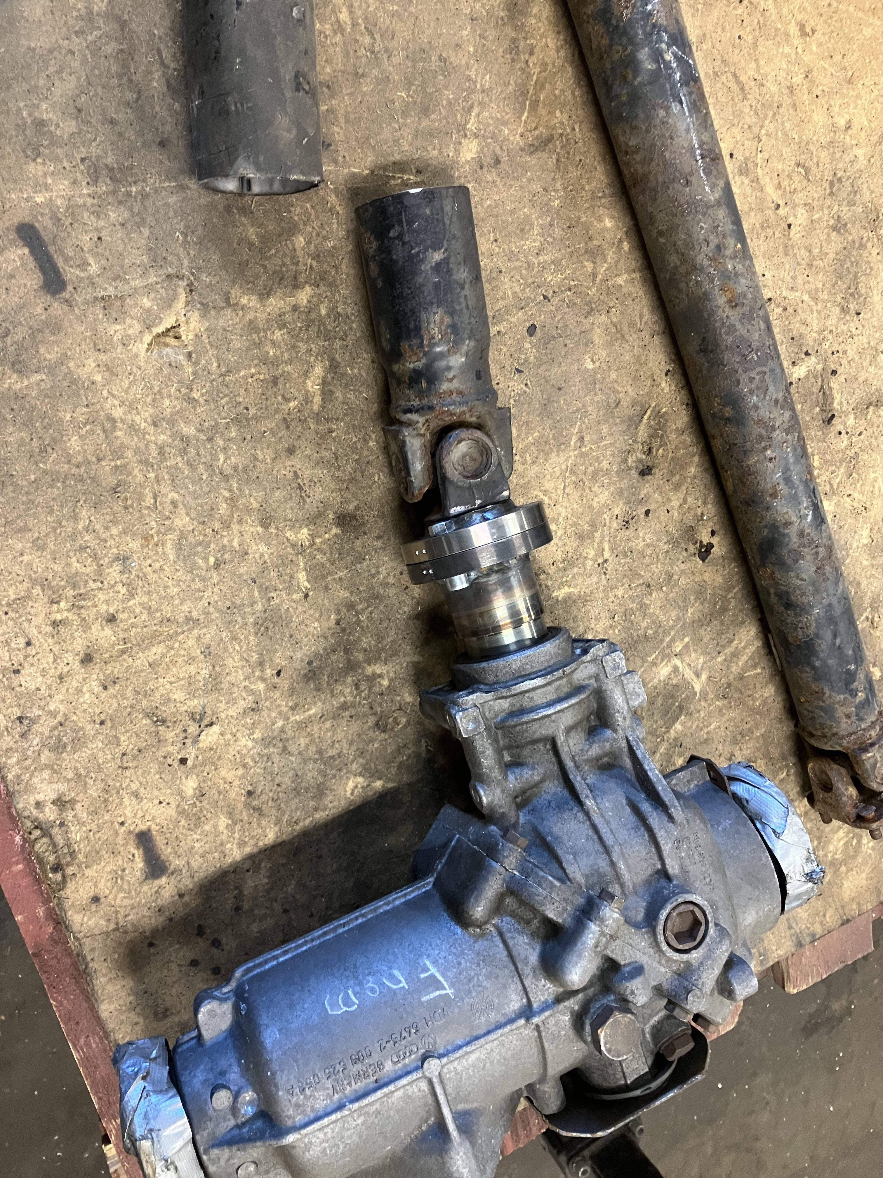

I have visited a metal mechanic helping me with brackets for the diff and gearbox. Thr bracket to front diff is done. After weekend the rest is done I hope….he is good but old……

Hello Thomas… EWT is the white used those years…
but i prefer the modern EWP, that is more « white »……
congratulation for your job
wicked
I had my gti resprayed in EWP and it looks so much better than EWT.
Keep up the good work!

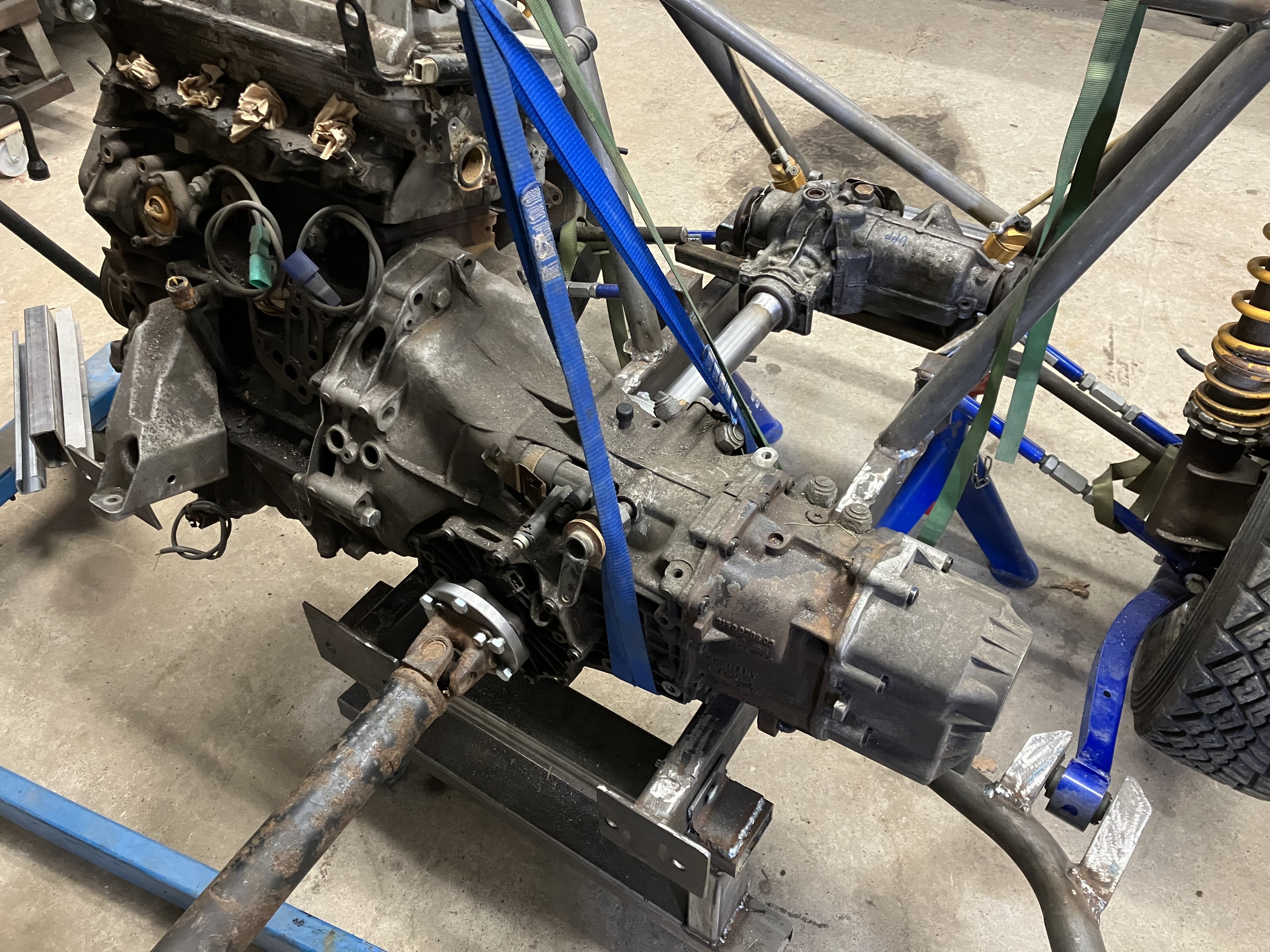

Berglundracing
Thanks Cedrik and Wicked! EWP it will be!

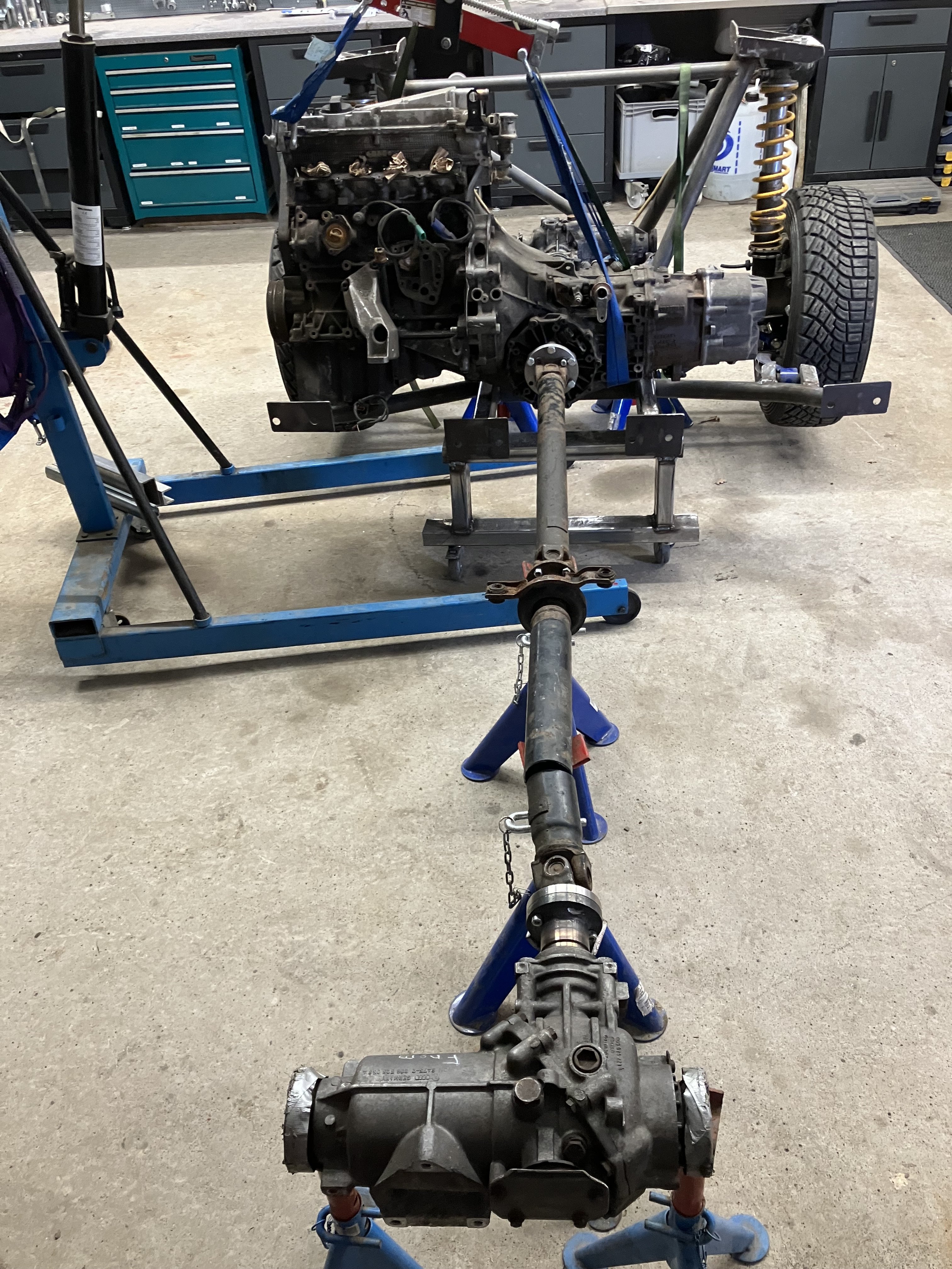

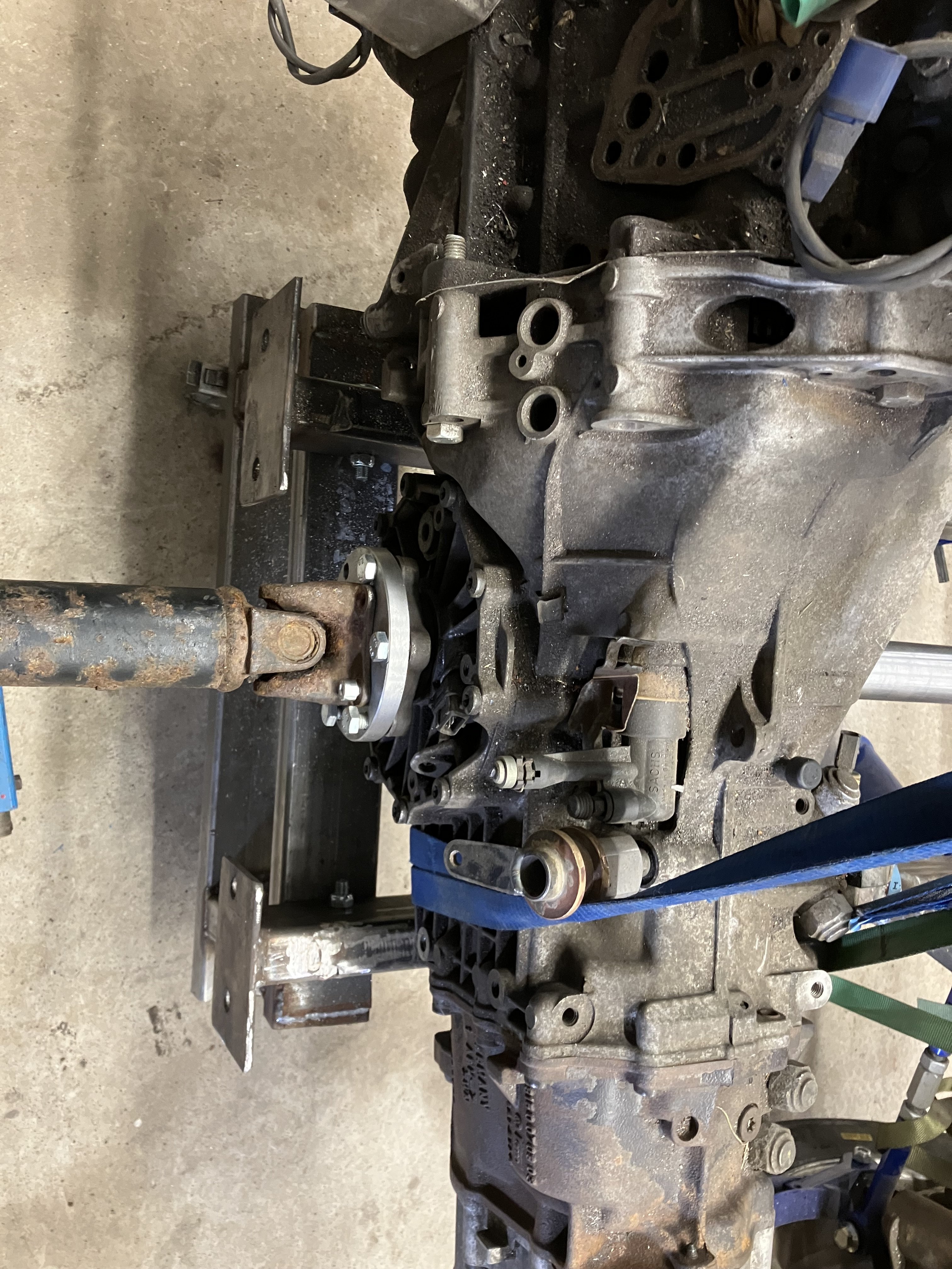

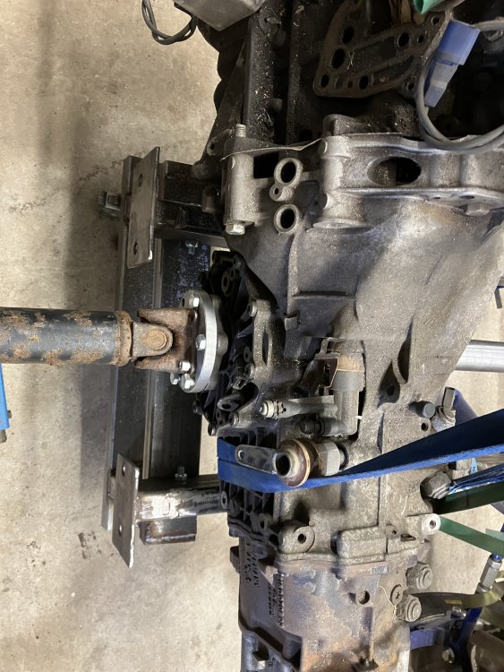

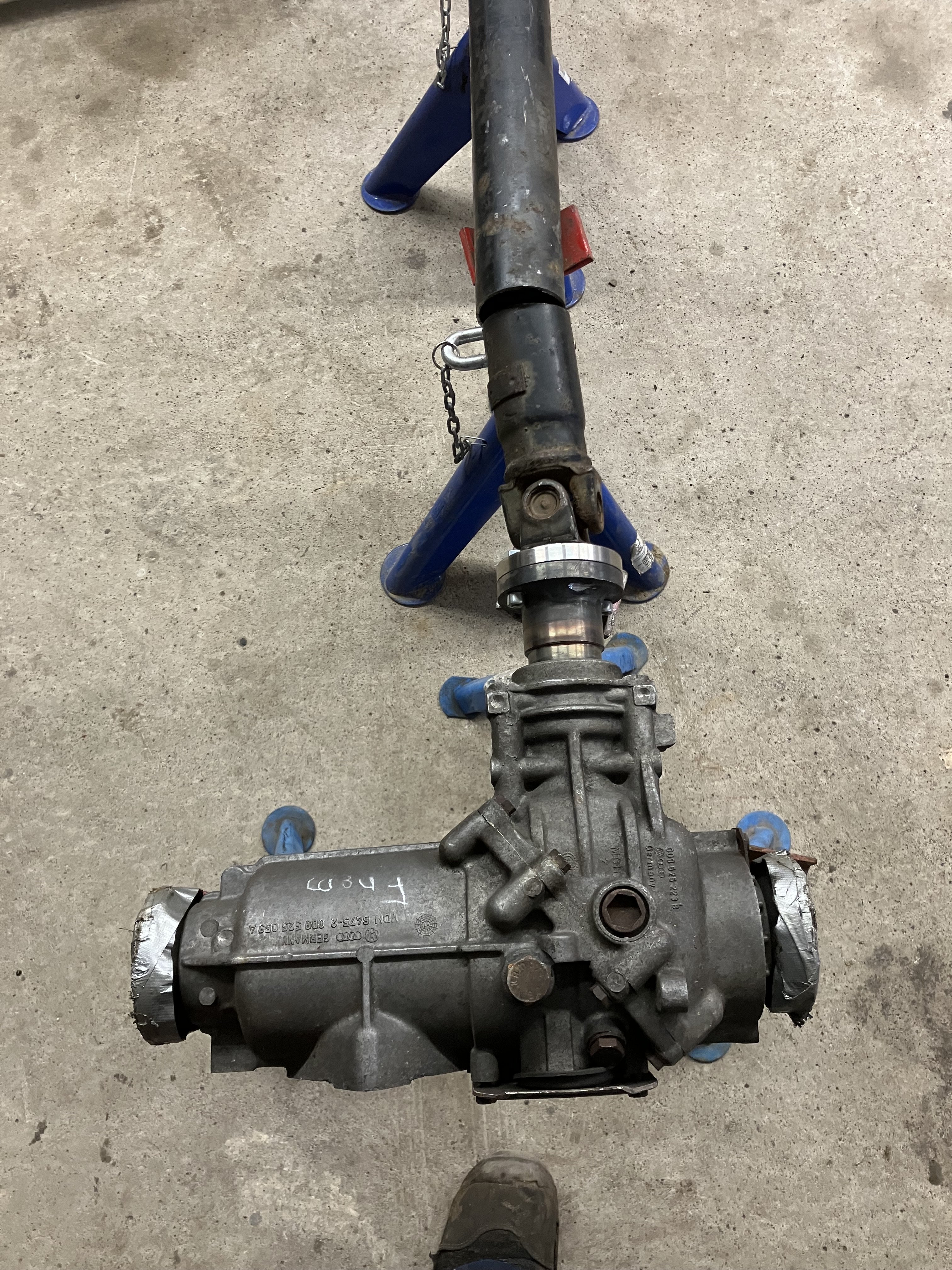

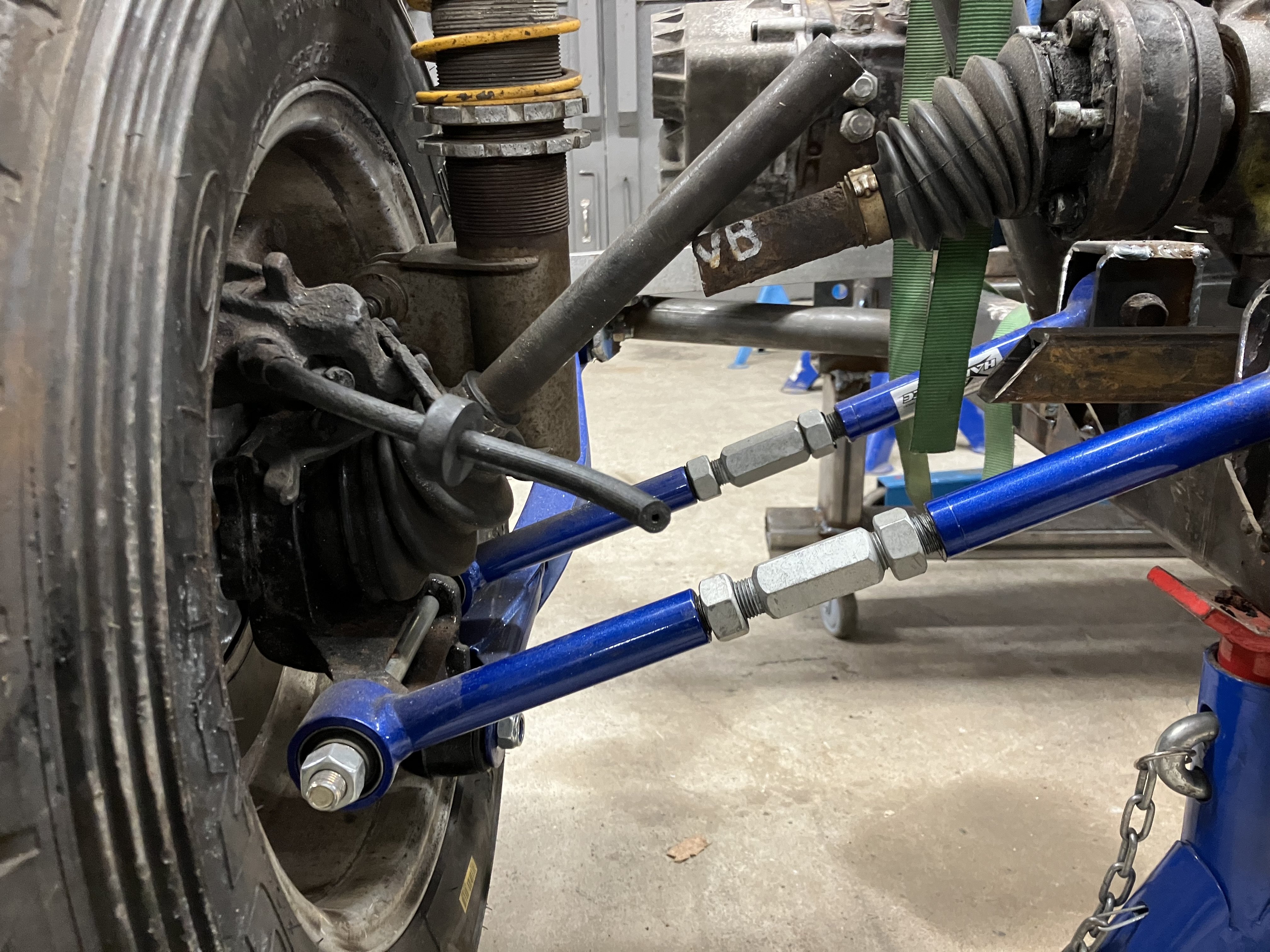

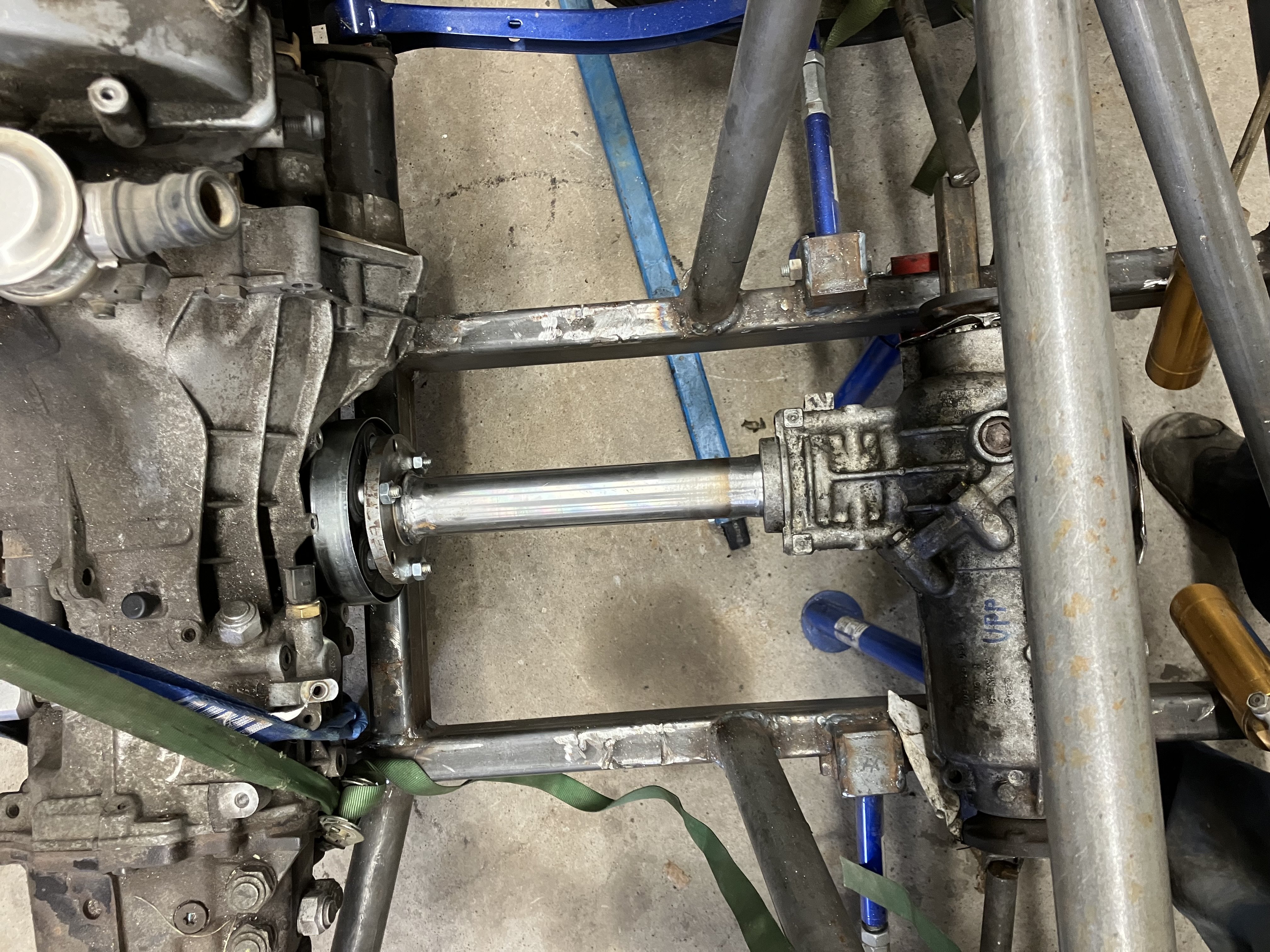

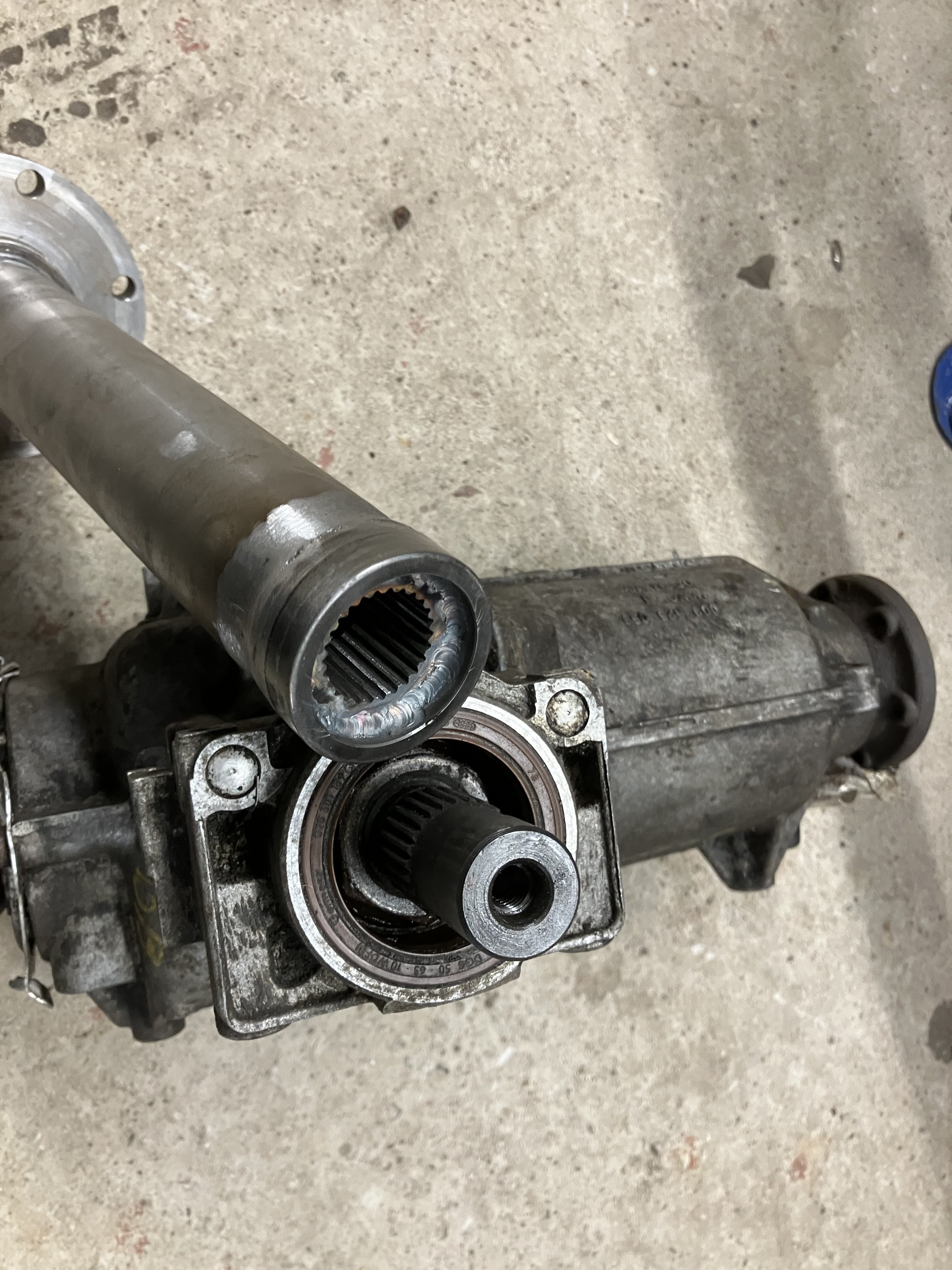

I have recived the parts for gearbox and diffs and testfitted them. Some struggle with angel for left rear inner driveshaft witch get to big angle. Could move engine more to the right but this is not good fore weight balance. Could also raise the topmounts on rear suspension but it require som heavy welding on the tubular frame. I will search for more flexible driveshaft for starter. The one I got is from VW rear syncro.

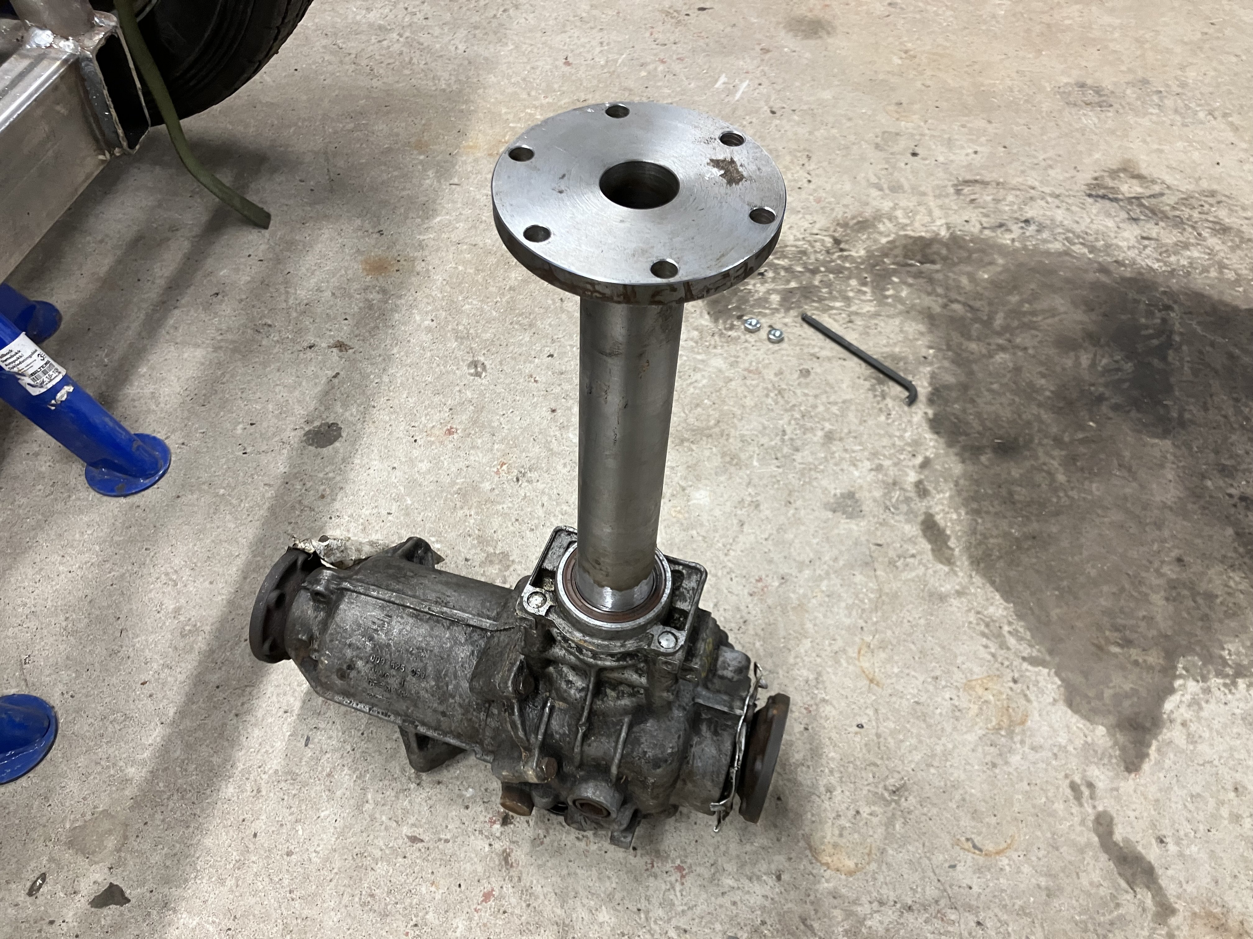

Im searching for some suiteble polyuretan buchings to build engine mounts. The diffs probably will be solid. Have a hardyplate to rear diff and to the front the center driveshaft is flexible with cv joints and rubber mounted halfway.
Dont want to many vibrations from the engine though its not a 100% racecar. Also wants to go shopping icecream on holydays…..

Berglundracing

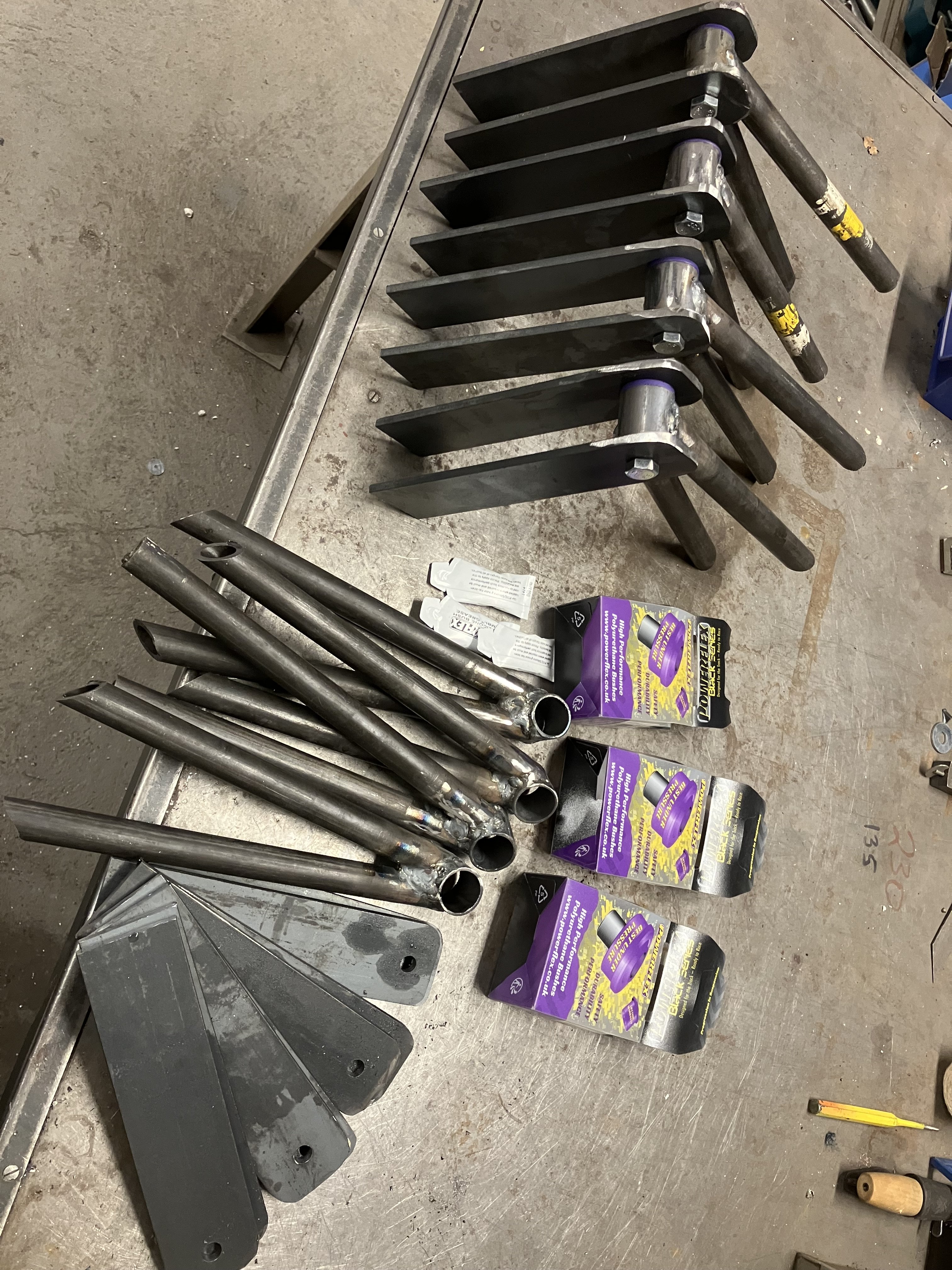

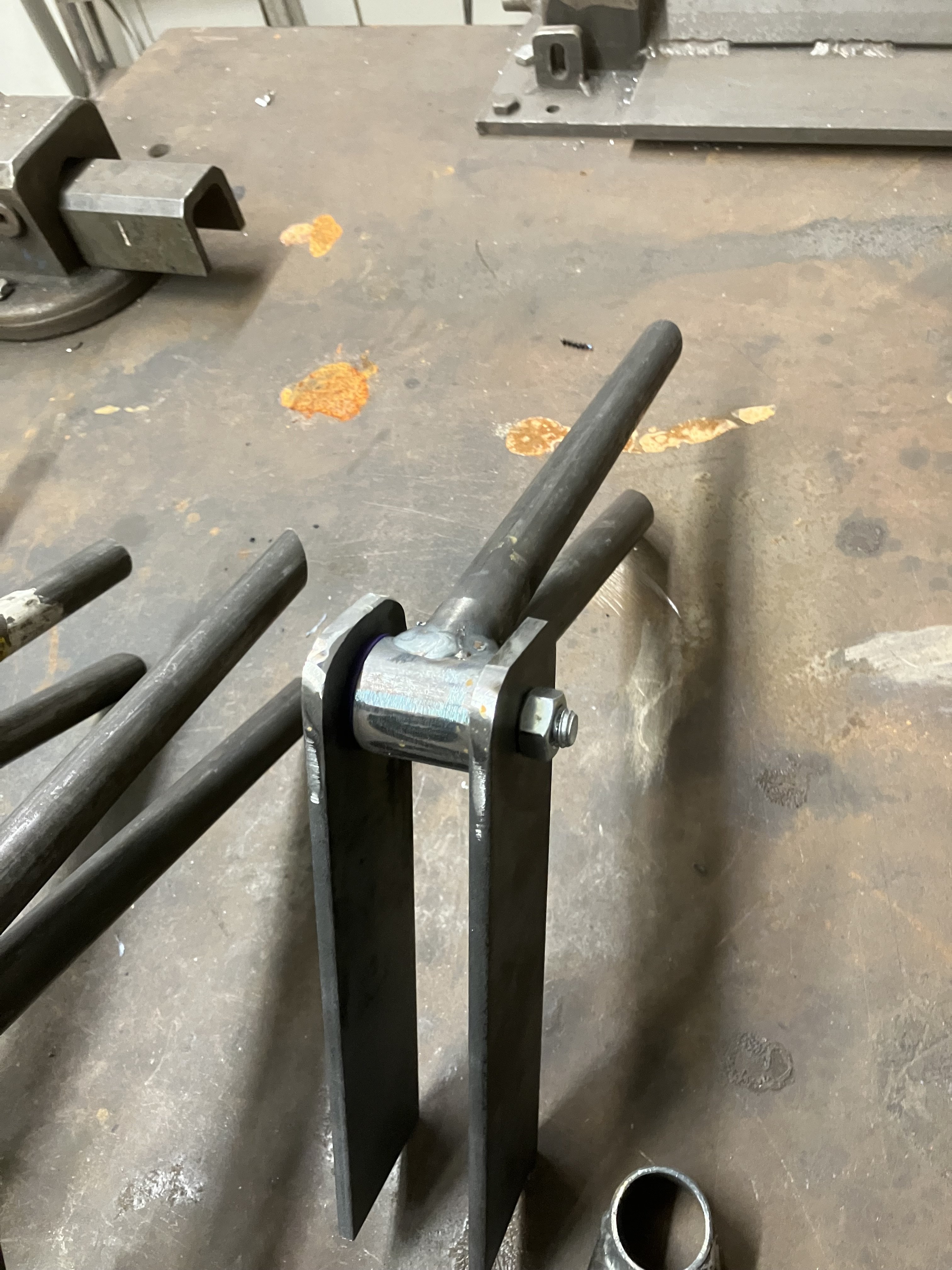

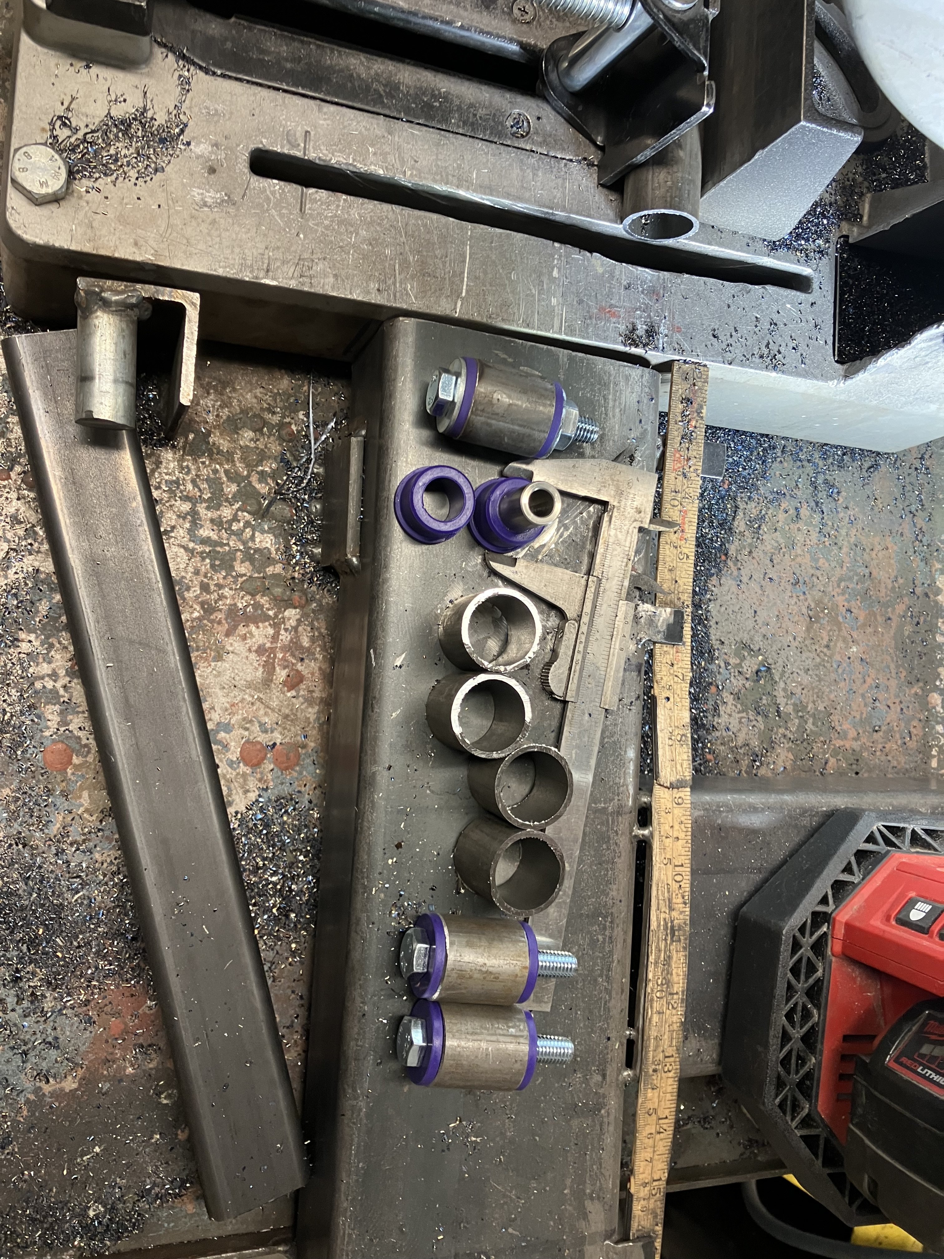

Have made some engine/gearbox brackets with polyuretan bushings
Berglundracing

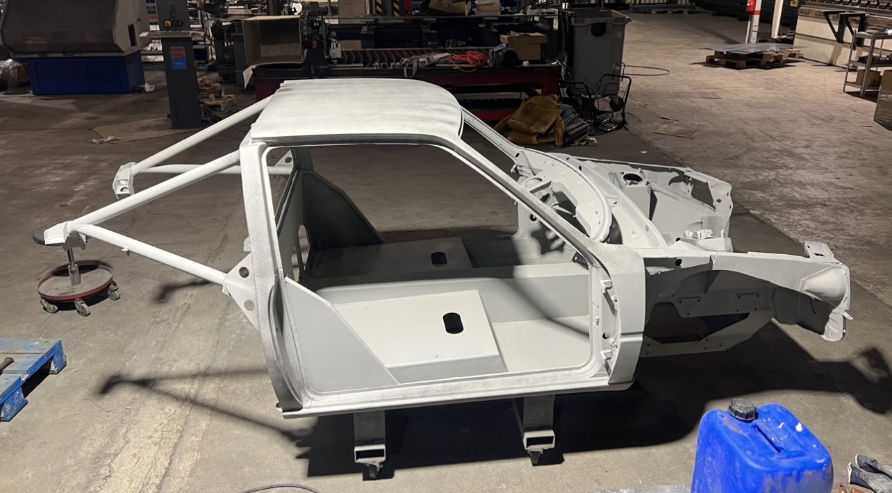

Its only basecoat so far……..little to big mirror compared to stock
