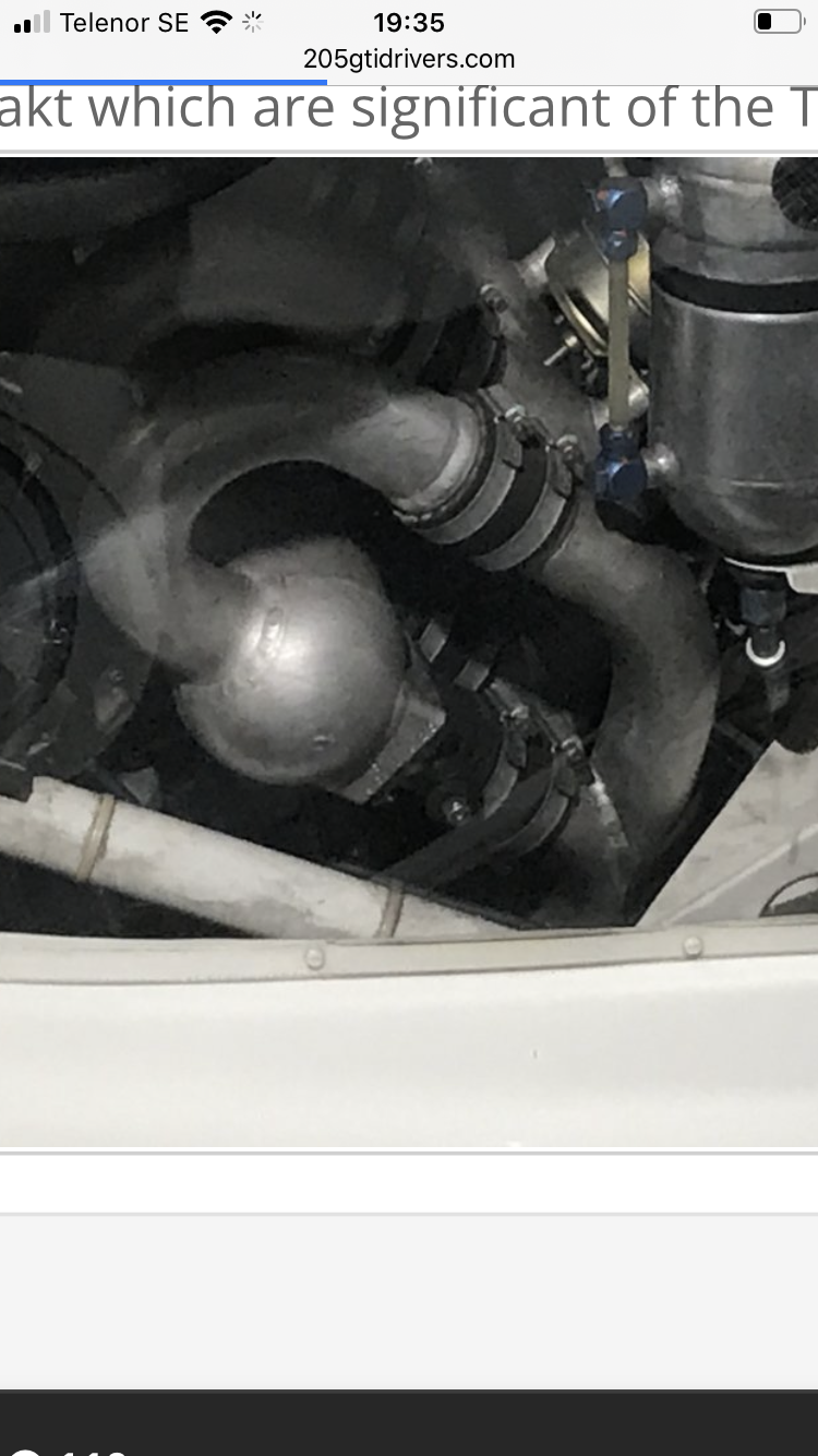

Berglundracing
Is it a variable airintake? Looks like its a slidevalve under the ”tubeshaped  intake”?
Berglundracing
SRDT
Yes, the real ITB are stuck to the head and the other valves are for variable length:

Berglundracing
That one will be hard to replicate,
I will be stuck with long intakepipe
 then.........Low end power is not so bad

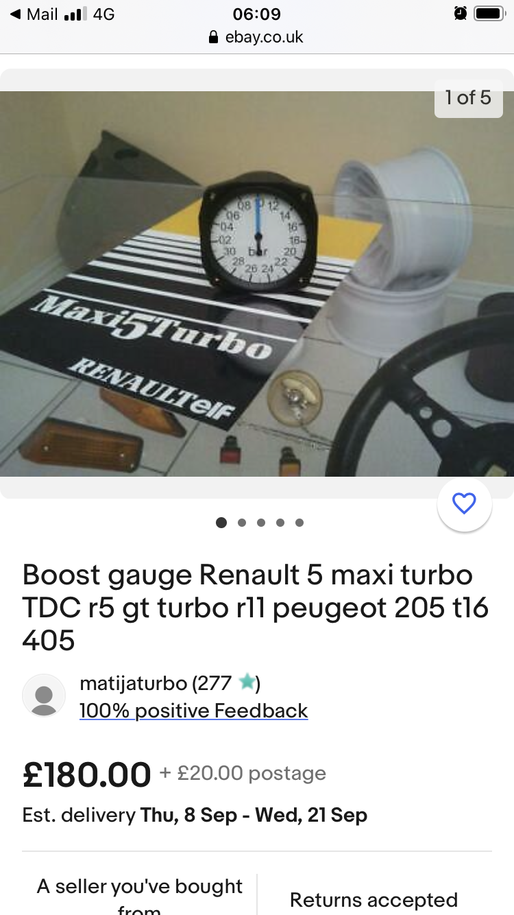

Found  a used turbopressuregauge on eBay.

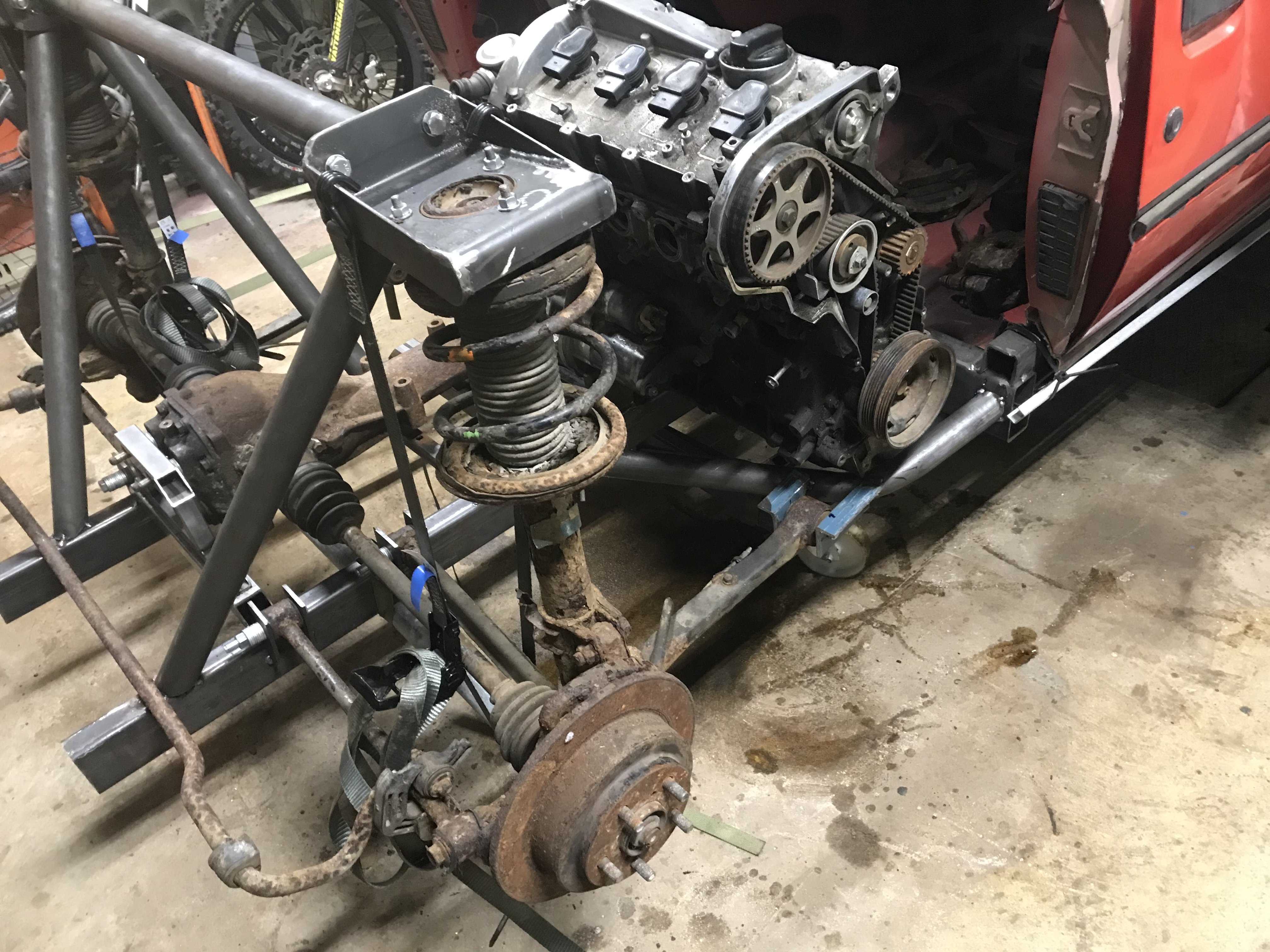

Berglundracing

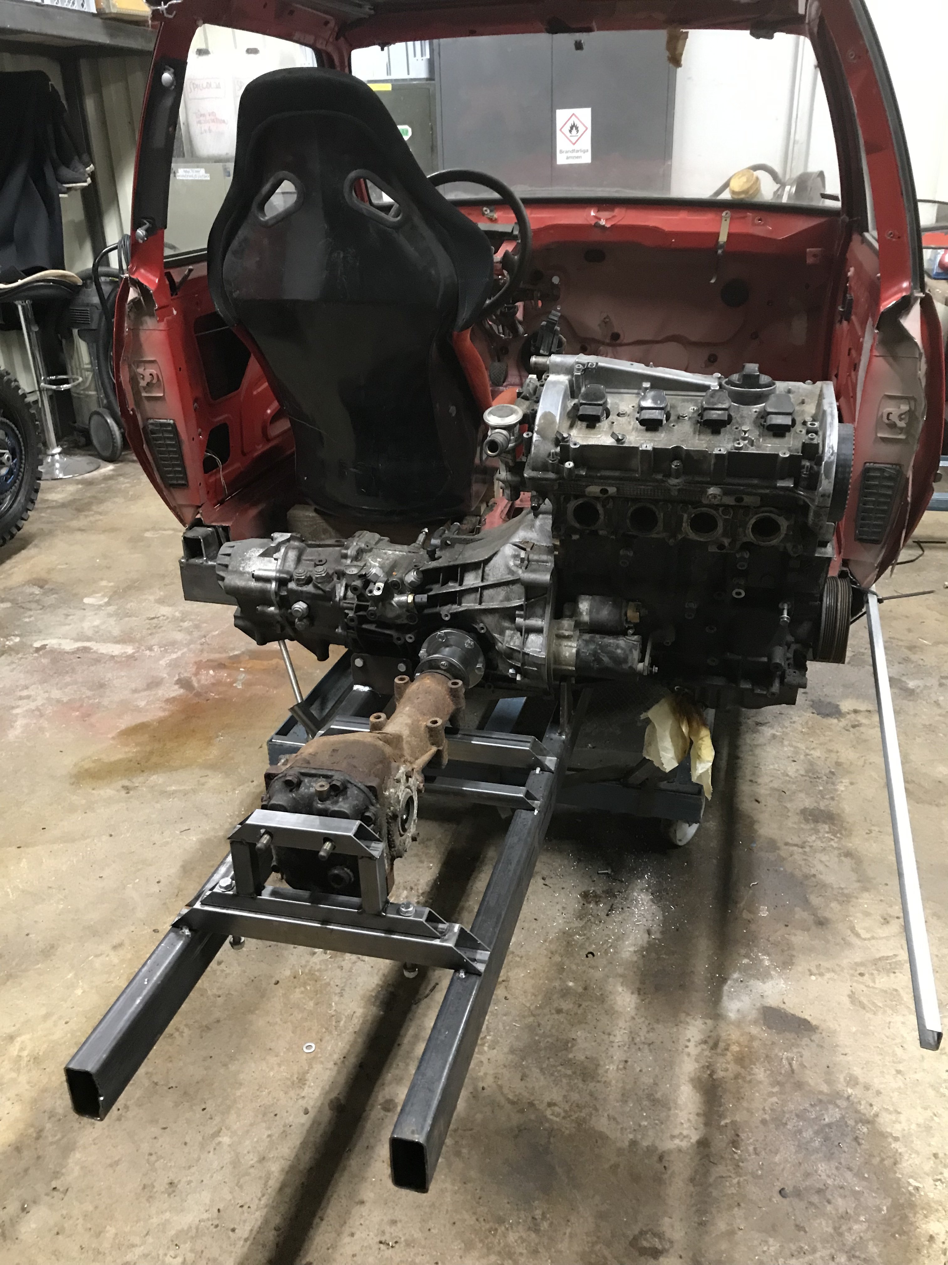

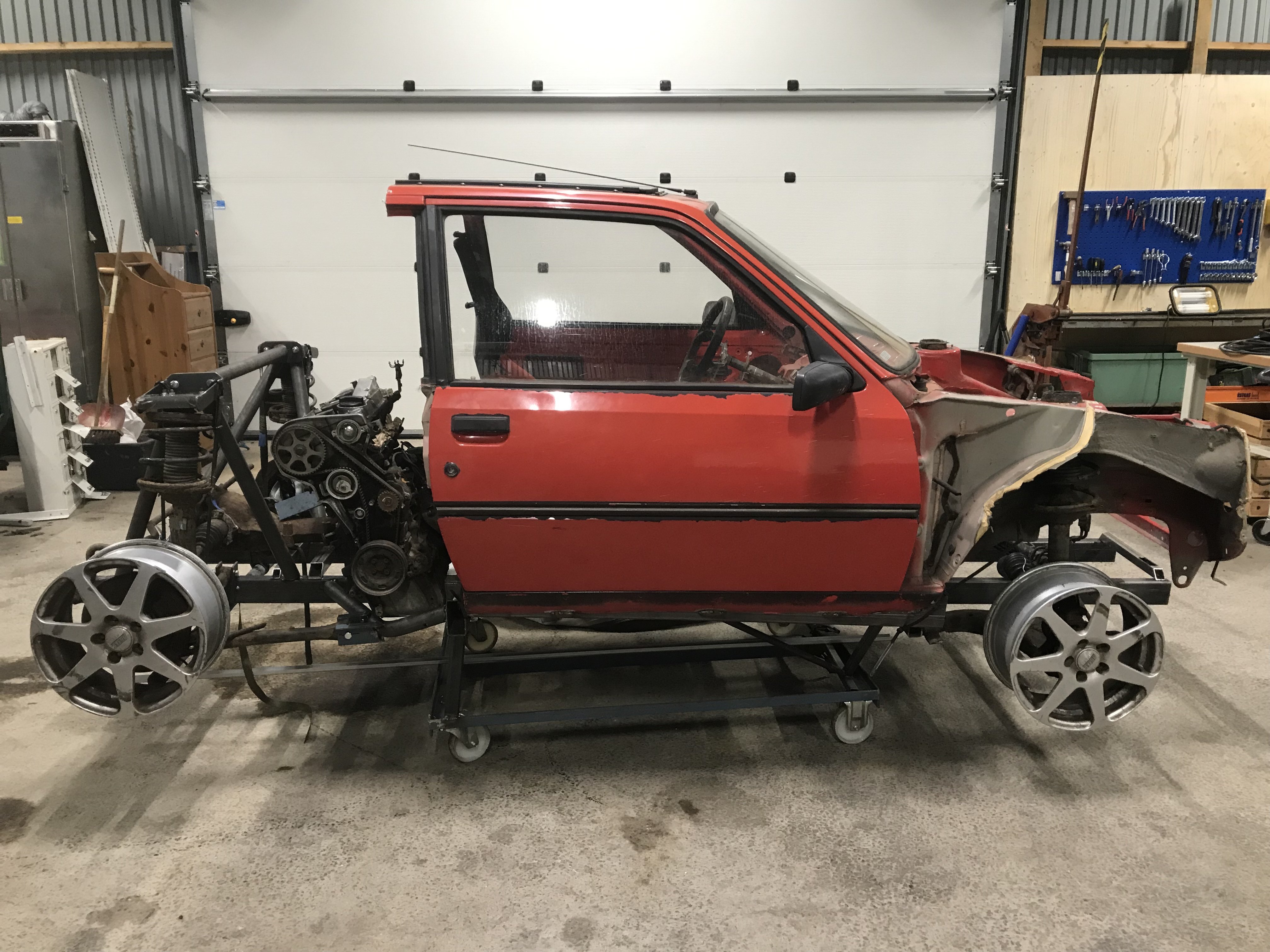

Finaly i have had some time to work on the projekt. Have waited for the bracket? between gearbox and rear diff….. If parts are for free I could wait. Waiting now for the otherside and I have to buy a another rear diff to the frontwheels.
My Goal in short term is to have a rolling car.
  • Like 4

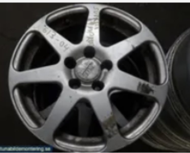

Berglundracing
These will be ok for now, 160£
wicked
For the final build I would opt for some white OZ or Speedline rally rims. Must be plenty of them available in Sweden...
Nice progress on the build! Does steel frame run completely to front of the car? What front end diff do you intend to use?

I´m searching for real rally wheels and have some options. Lot of rally drivers in sweden:-)

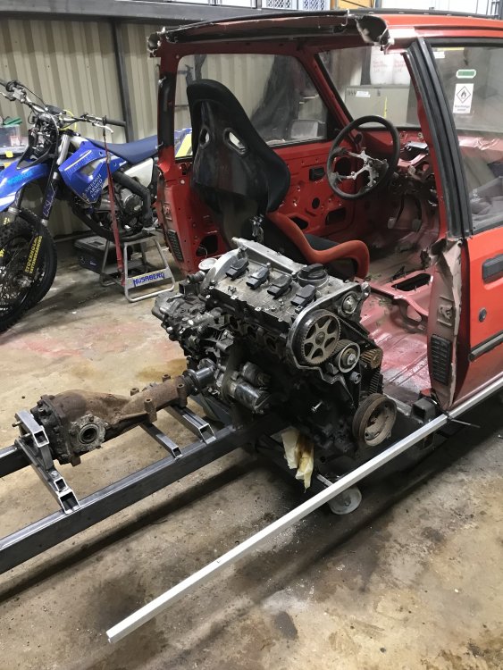

Steel frame runs all the way under the car and i will attache the front suspension to it also.

Berglundracing
I will start with frontsuspension as soon as the new syncro diff arrives.

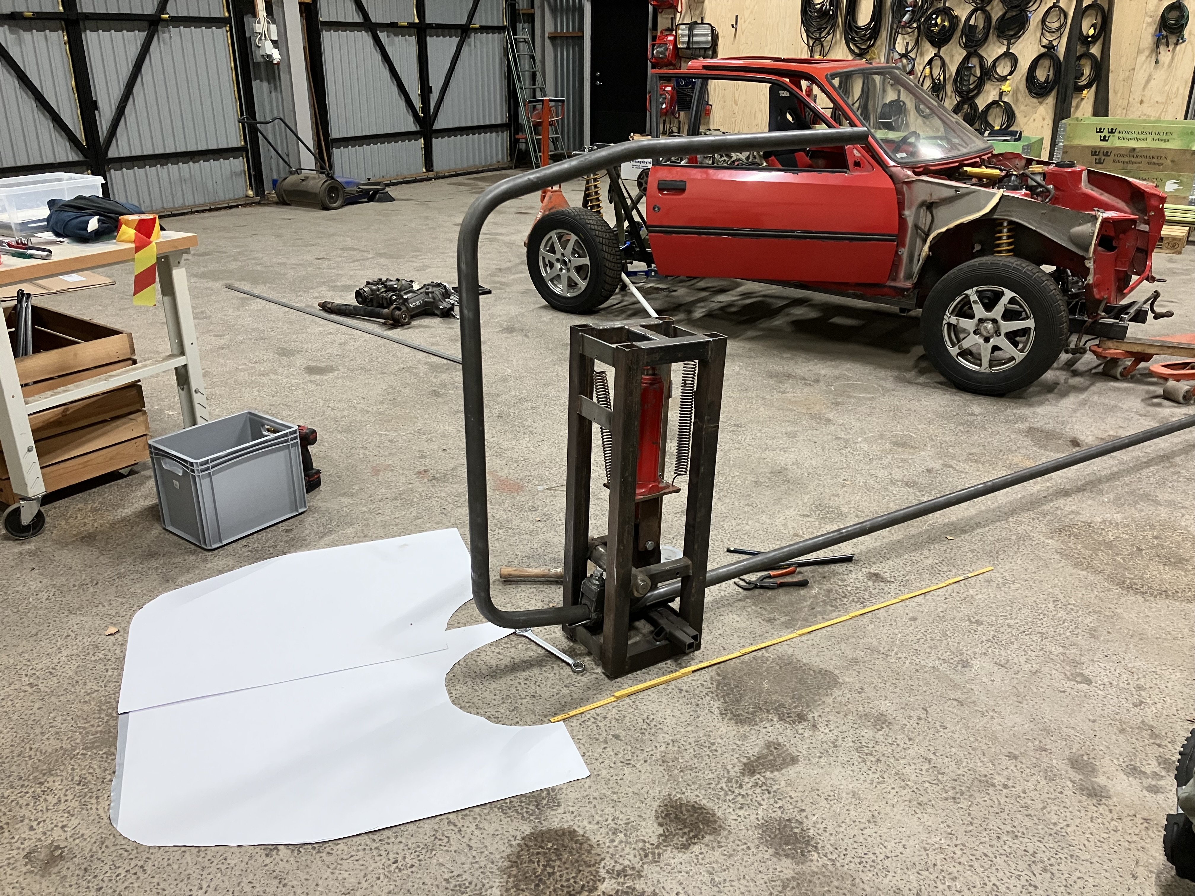

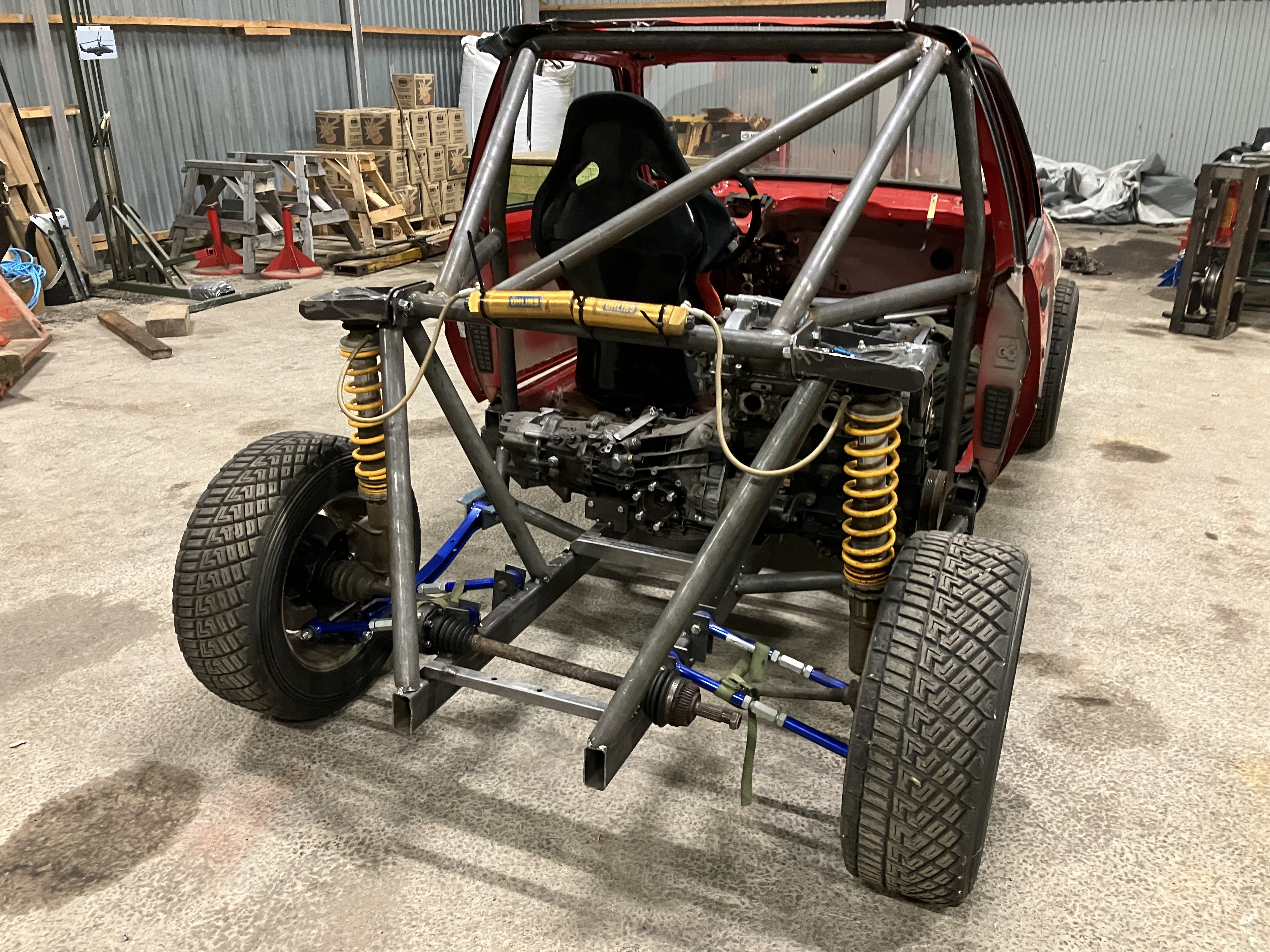

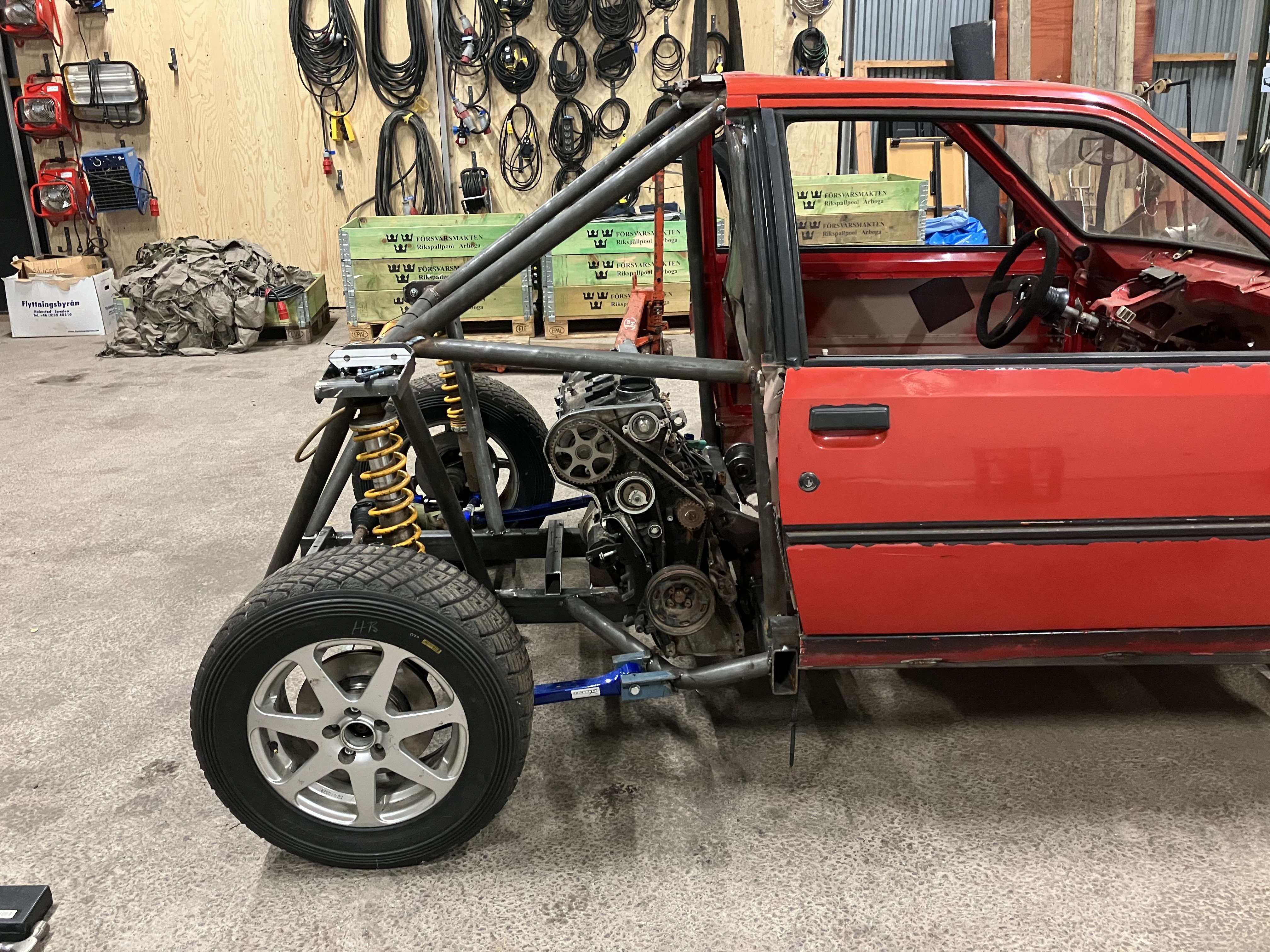

I have been working on the rear and have found Öhlins a subaru Impreza suspensin from group N rallycar. So far the most exspensive part on this build.
i’m very satisfied with the tubebending on the main rollcage. My homemade tubebender is not so precise and have no scales so i just have to wing it(?).
I use 45/3mm tubes and it will be very strong, and heavy……
I have found 2 golf syncro reardiff, the same as the Golf rally G60 uses. They are freerolling when you use the abs on the Golf and I have removed this funktion and now it work the way I want, always in drivemode. This is probably the week part in the drivetrain. Maximum 300-350hp? Also fitted adjustable controllarms an next step is to weld the brakets in right position to have right camber and caster angles.
  • Like 5

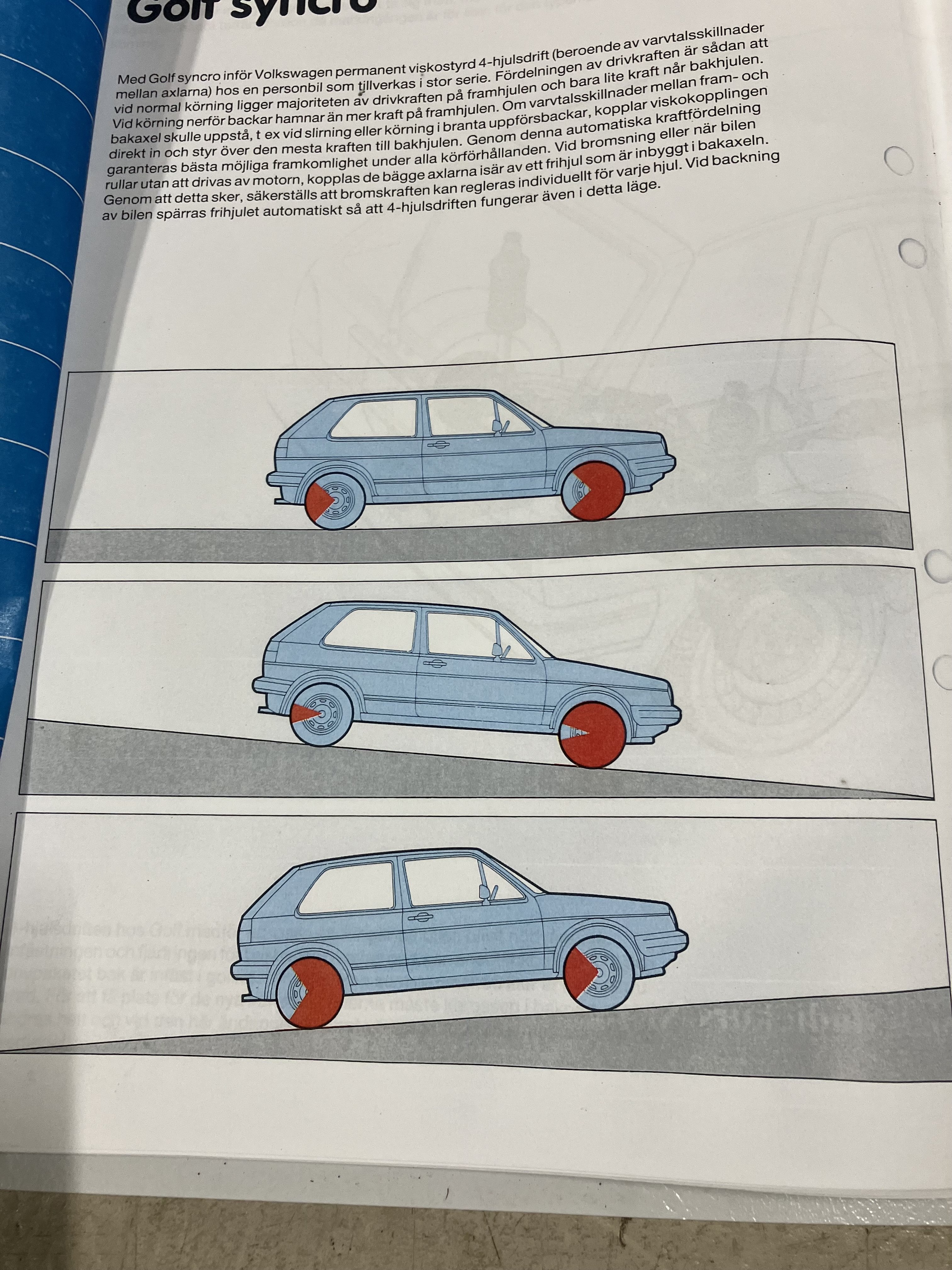

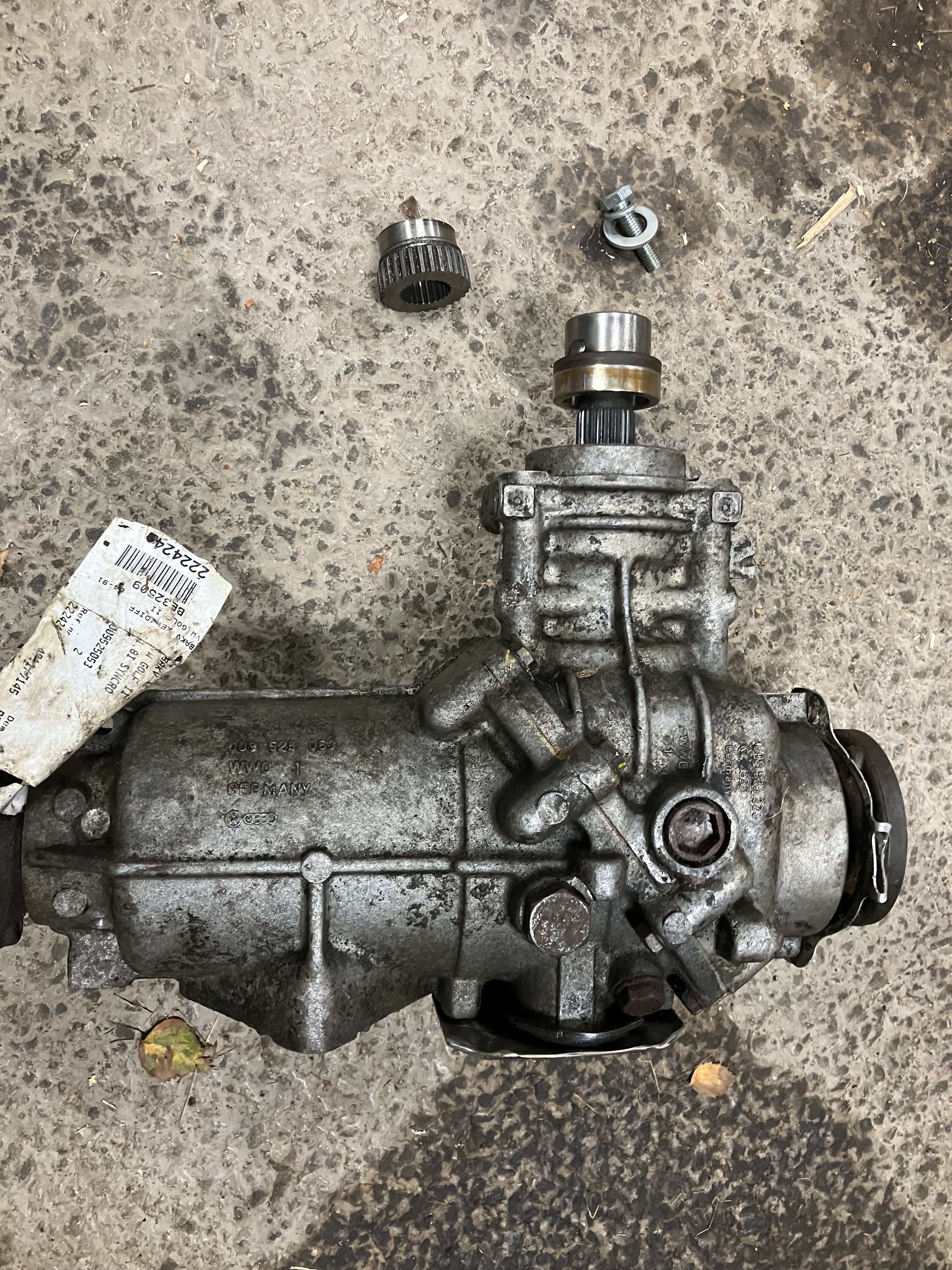

Berglundracing

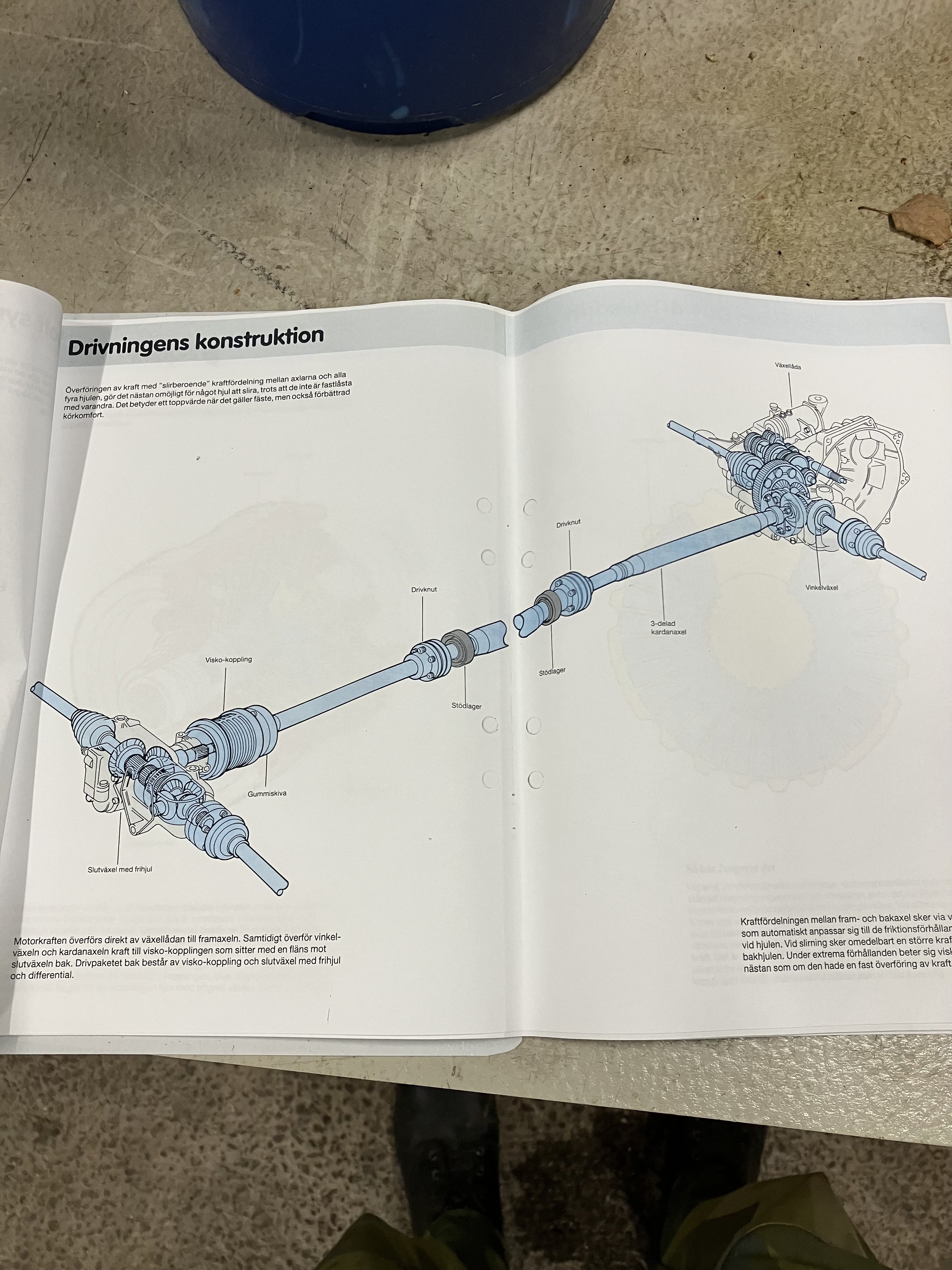

I have removed the viscos part and cut it in 2 pieces so I could use the splines and build brackets to be able to attache the diff directly to the driveshafts. It will give me 100% drive all the time, not like its supposed to work, only drive when the front tyres are spinning. I have also locked it in  drive and removed the pneumatic system that engage the drive when brakes are not used. Ill take som pictures tomorrow
Edited by Berglundracing
Spesh
I'd be interested to see the pictures of the inside of one so that would be great.
If you wanted to go to a simple viscous system on one of the axles you could use a freelander viscous coupling unit in one of the propshafts like the honda lot do when converting civics to 4wd, super simple way to implement it if needed.
What are you going to do about differentials as you've now got 3 open diffs in there?
Thanks for sharing so far, its super interesting :)
Berglundracing
This picture show the parts i have cut out from the viscous-system. I have cut the axle with splines in half so i could use it on two rear diff. I only had one viscous system. These 2 parts will be welded to brackets attached to the driveshafts to the front diff. The rear diff will be very close to the gearbox and i will probably use a Hardy-plate? I will be a bit of a struggle to lineup the diff with gearbox and not build in forces that ruin the gearbox.
I take some pictures of cutup viscous to morrow
