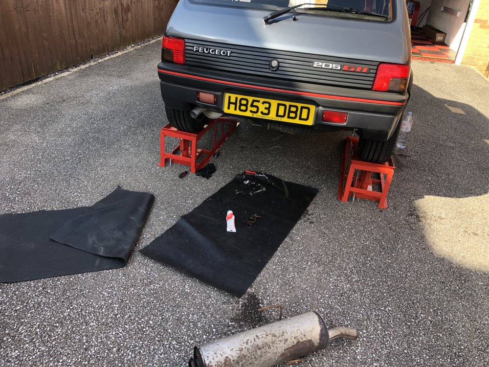

Got a new Bosal backbox arriving soon which is next on the list together with a quick oil and filter change.
ATK
Oil and filter change this week
Also fitted a new Bosal backbox, the old Klarius was buggered after only 5 years.
Need to re do the Bosal this weekend as it’s blowing at the join...argh!

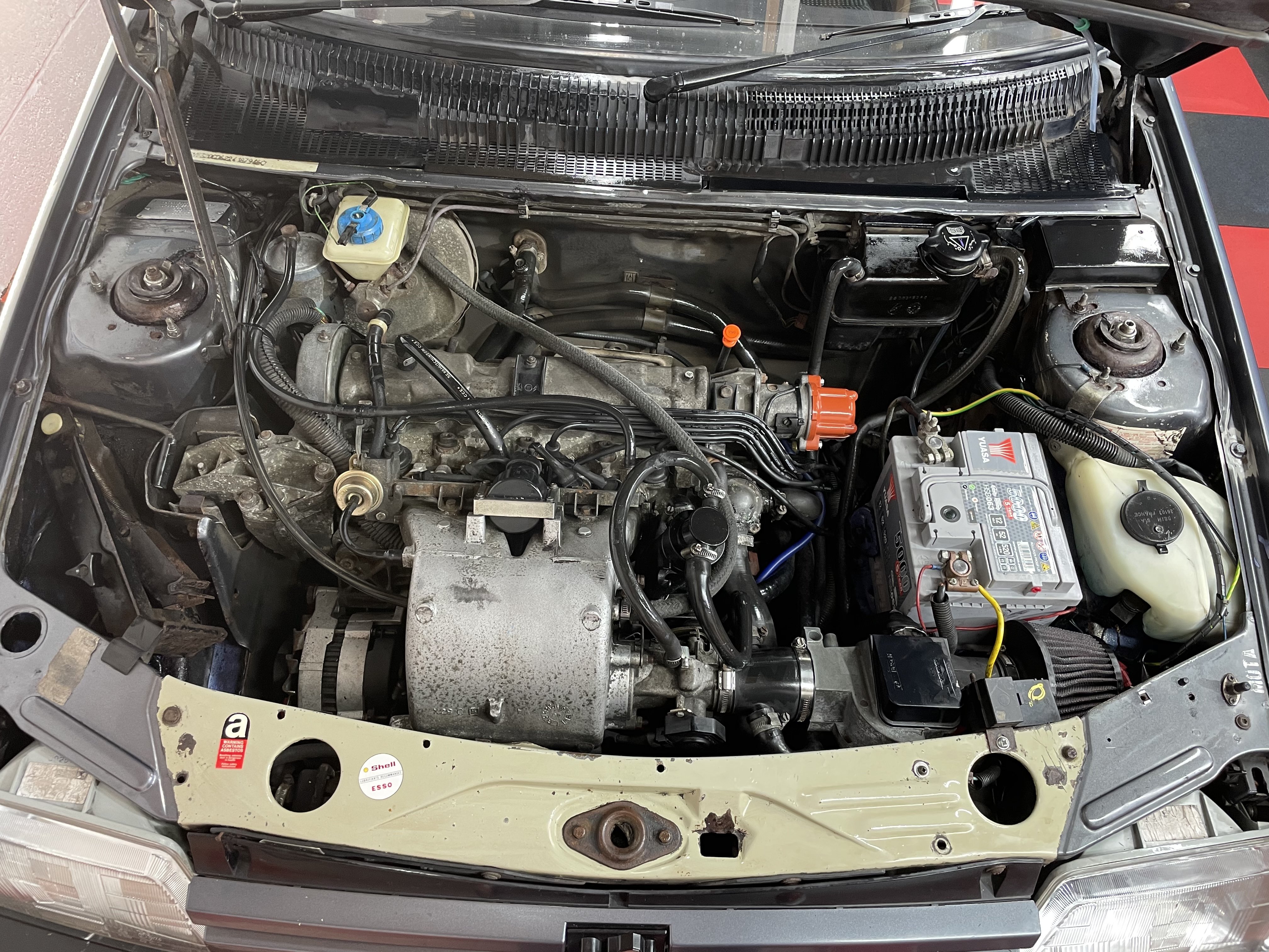

Also had took out all the front lights and examined the headlamp panels and inner wings. All in surprisingly good shape especially the headlamp panels. Cleaned up the inner wings and did a little patch repair on a small hole on the offside inner wing. Doesn’t warrant a bigger job as the rest is in good shape but no doubt will need doing properly in a few years time.
also gave the engine bay a bit of a cleanup as I’ve never cleaned the engine bay sunce I’ve had it!
still got an issue with my bootlight staying on - wonder whether it is the earth wire to the switch in the boot shorting somewhere - I think the circuit is by design “always on” and the tailgate switch effectively “un earths” the circuit. Fitted a new switch but still staying on so might need to wire a new earth wire from bootlight unit to the switch.
pretty happy with the recent work done - in particular everything out front is earthed properly, any bits of dodgy wiring has been sorted and  everything is working how it should ...for now!
