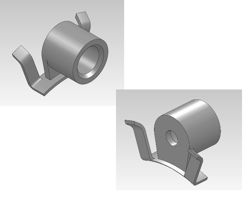

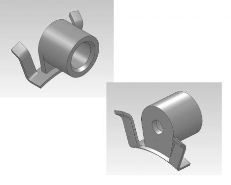

ALEX 98 1 Cars Posted February 15, 2013 (edited) Right just need a quote. Realised I only need 4 of these, so I'll get a quote for 4. If anyone want the cad file, just send me a PM with your email and I'll send it to you. Edited February 15, 2013 by ALEX Share this post Link to post Share on other sites
ALEX 98 1 Cars Posted February 18, 2013 Had a reply from them £5 each £5 postage. (Any finishing would be an optional £5 extra) Seems reasonable price as the clips would be close to this from Pug, but he mentions the material wouldn't be strong enough for the clips arms and they would break off. A bit like the originals then! (I might have to modify the design.) They are buying a different printer that has some flexibility on the finished parts, but they're not getting it for a couple of months. I might order a couple anyway and see what they are like and opst a pic up. Anyone know the part number and if these are NFP from Pug, as I could just go buy some instead. 1 Share this post Link to post Share on other sites
Anton green 12 1 Cars Posted February 18, 2013 (edited) Had a reply from them £5 each £5 postage. (Any finishing would be an optional £5 extra) Seems reasonable price as the clips would be close to this from Pug, but he mentions the material wouldn't be strong enough for the clips arms and they would break off. A bit like the originals then! (I might have to modify the design.) They are buying a different printer that has some flexibility on the finished parts, but they're not getting it for a couple of months. I might order a couple anyway and see what they are like and opst a pic up. Anyone know the part number and if these are NFP from Pug, as I could just go buy some instead. Not sure on the part number, but I know that a whole host of clips are sold inexpensively on an auction site. When I had to buy similar clips for a ford ka last year (don't ask) from a dealer they worked out ~£1 each, for a reference on clip pricing. I might have a part number for the Peugeot clips somewhere but don't count on it as I don't know when I'll be next making a trip to my far away storage area, where it will be. edit: not certain the clip designs on ebay will be too similar to the ones in your design above actually. Edited February 18, 2013 by Anton green Share this post Link to post Share on other sites
Tom Fenton 1,562 Posted February 18, 2013 I think that by copying the originals 100% you are making things harder than they need to be. All the "legs" do is hold them in place whilst you assemble. It is the "barrel" part that actually performs the important function which is to prevent the mirror fixing screws from crushing the two steel skins of the door. The way I would do it would be to turn them on a lathe from nylon and forget about the legs. When you come to fit a small amount of "dum dum" or similar putty to hold them in place momentarily whilst you fit the mirror. Cover plate then goes on and no one knows any better. I certainly wouldn't want to pay £35 for 6 spacers! 1 Share this post Link to post Share on other sites
