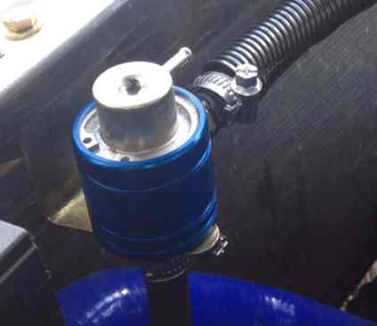

Looks good. Although personally i wouldn't of put the fuel reg so close to the junction box.
Al
Fare comment, but I'm sure Miles has his reasons for placing it there... Just looks so tidy and good!! Have seen a few other people have placed theirs in the same place from other threads I've seen

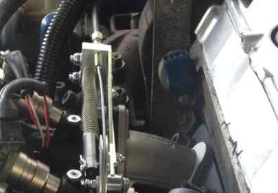

Quick update before tomorrows work being done (this time by myself and a mate)
Work already completed when she was down with Miles included the recon rear beam being fitted and body undersealed from the tank back::
Fitting of his gear linkages and my exhaust and his manifold and downpipe::

Fuel Reg - no compensation?
Was it not possible to add these functions and map the fuel by TPS and ignition by MAP?
Edited by petert
Cam sensor is not used on the Omex 600, No need too as it's a single coil pack like on the XSI engine and what other do with HT leads.
FPR again unless boosted no need to be connected, well that's what my mapping man has said and other's too and I have no reason not to believe him, as for the Teccy reason behind it I don;t know.
