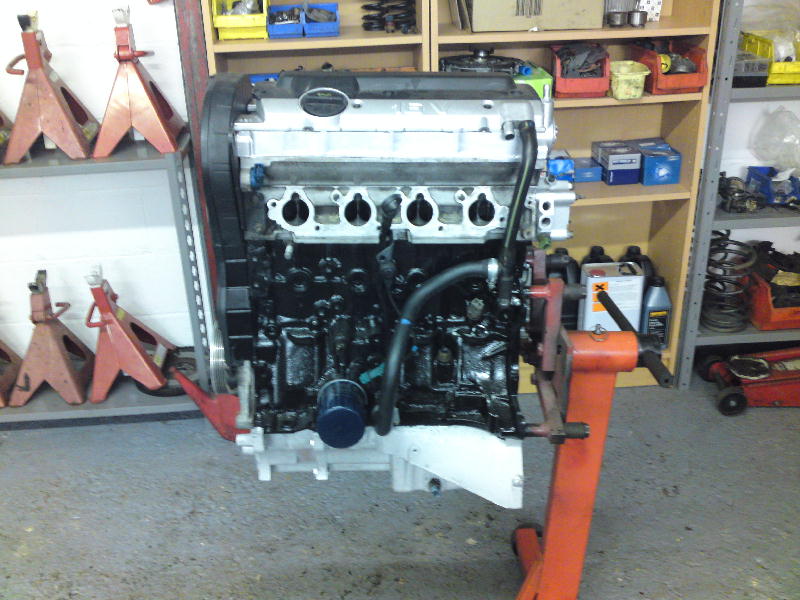

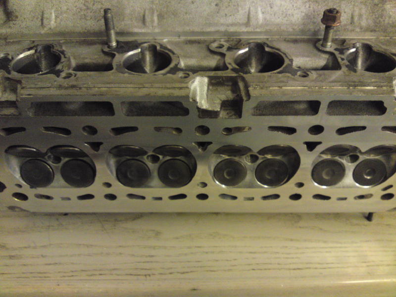

Surprisingly it hasn't needed much work. Valves had already been replaced, pistons and rings are in remarkable condition, crank had a polish only.
Miles has been quite astonished how lucky I have been with the engine!
Think its just had a cleanup and some new 3 angle valve seats, but I guess Miles will confirm when he sees this.

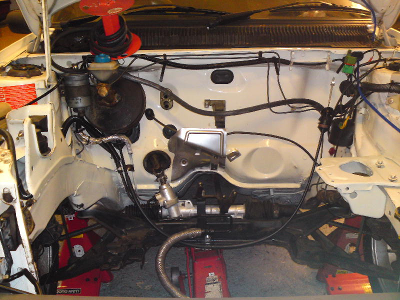

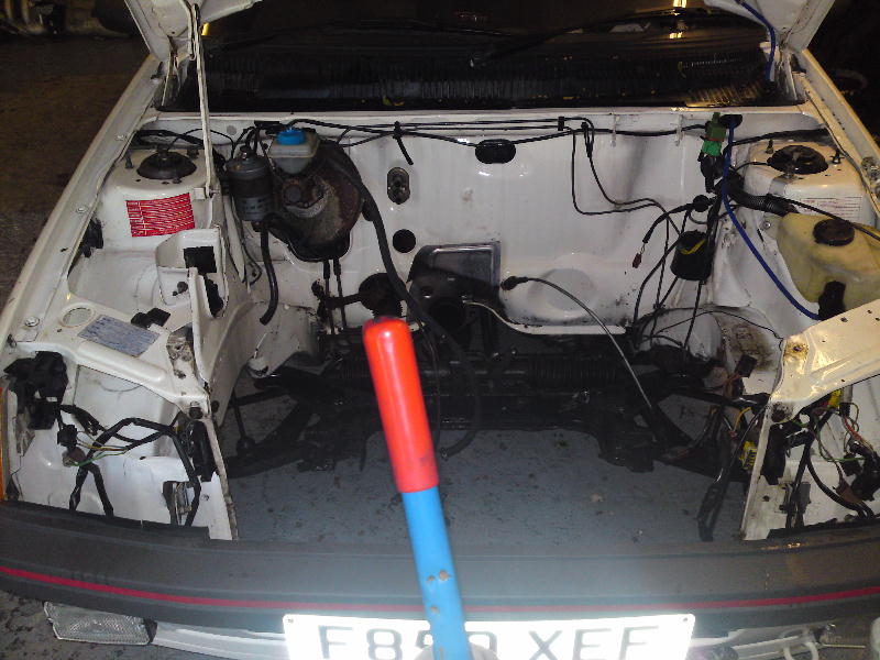

There's a big hole under the bonnet

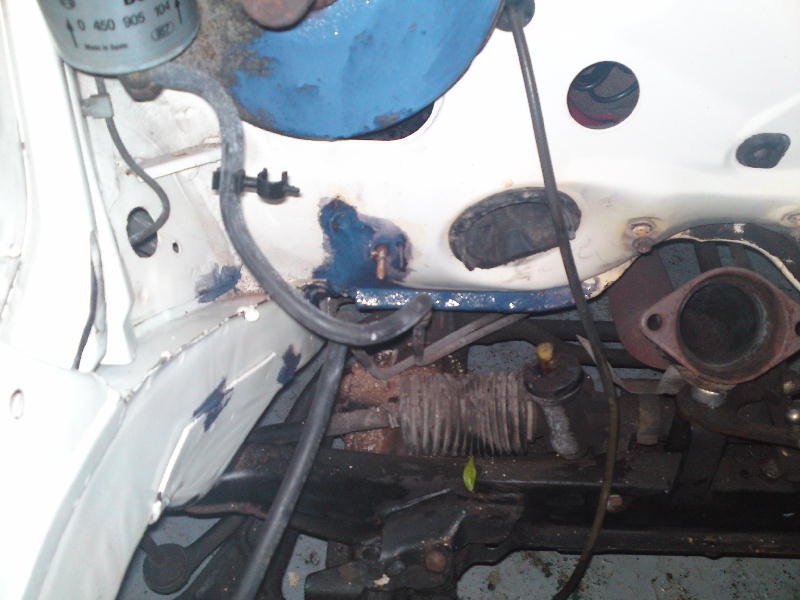

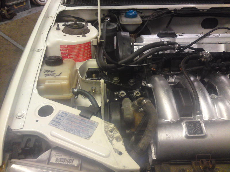

Just some rust to treat under the servo as normal ish
Bad picture of the head (Camera Phones)
Just need to check out the steering arm's for the rack now ;)
You can buy oversize piston's for these engine's no problem's, They do on some suffer from bore wear to a degree honing them makes them U/S, Hate to think what my 257,000 engine is like

Wow I cant believe how good that engine bay looks now the engine is out ;)
I may (did) overpay for the car, but I think the condition makes it worthwhile, as repairing loads of tinworm would have been much more expensive.

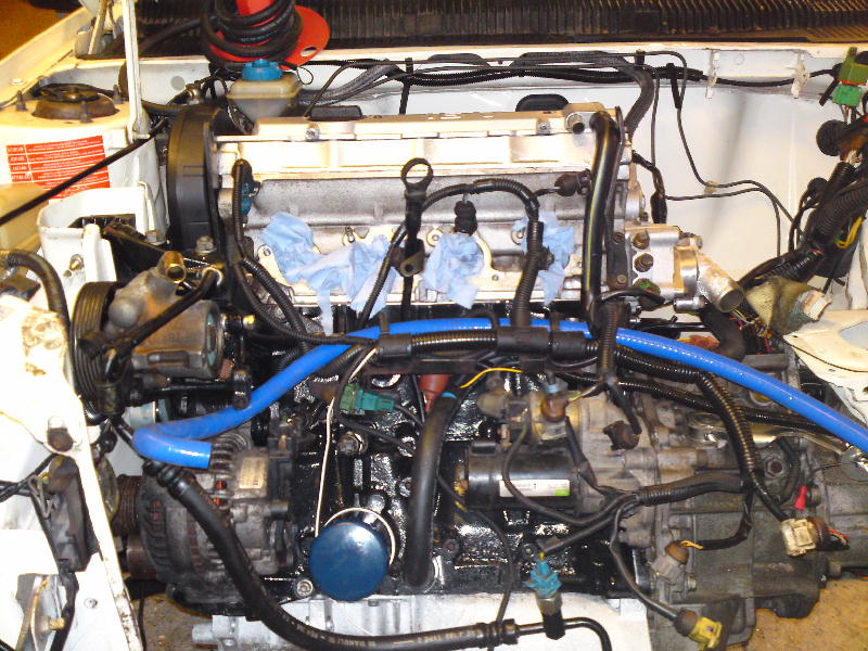

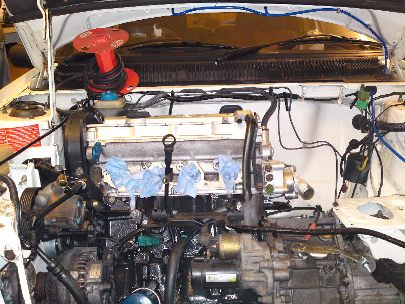

Couple more pic's of updates,

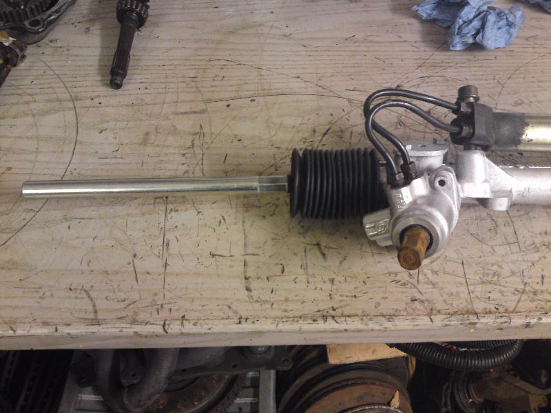

As you can see under the servo is getting a very common place for rust due to the location and seaping brake fluid over the year's, This must be delt with or as it's very thin here can hole in no time at all and is a MOT failure too.
Rack is all complete, Xsara VTS with 205 connecting arm's and new boot
Engine is almost complete, Finished off the engine mount today too.

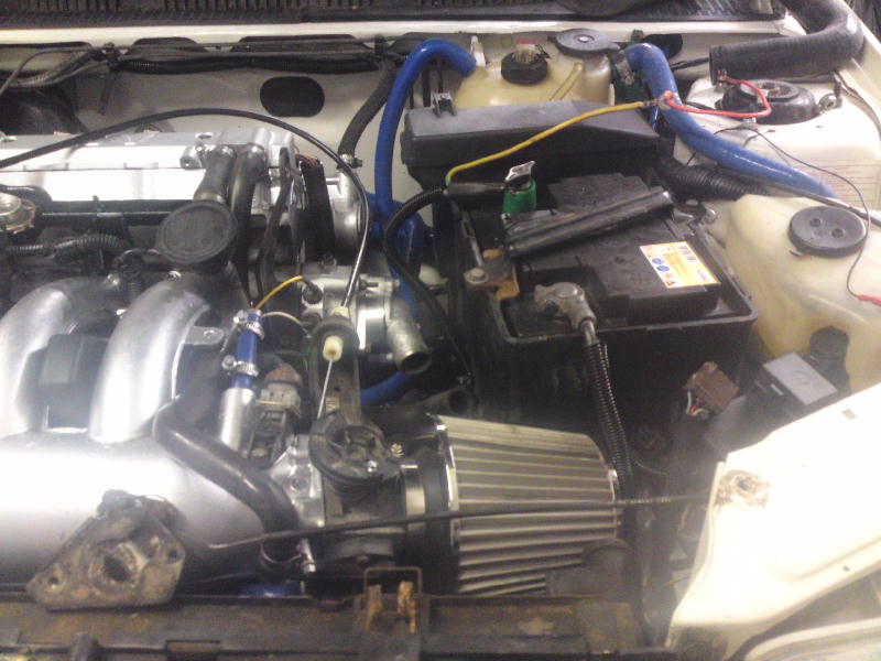

A couple more updates,

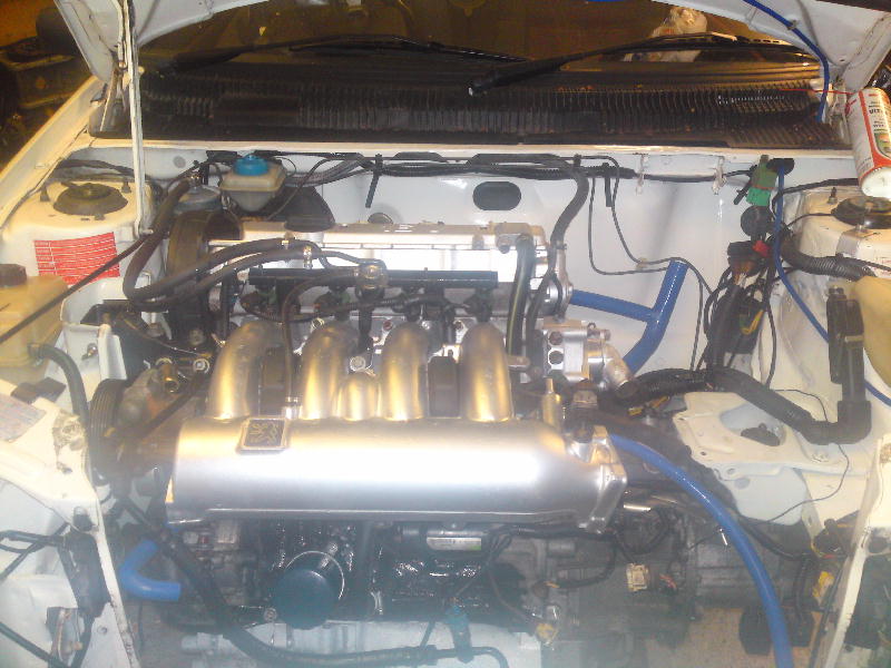

Engine's all in and wired up along with the Power steering, Just the Main system earth to connect to replace my Temp link
Miles
Almost finished, Just re-spraying the Slam panel and plug cover, Exhaust system to do and then thats job done, Well bar the door
Almost forgot, turned the key today and .........................
