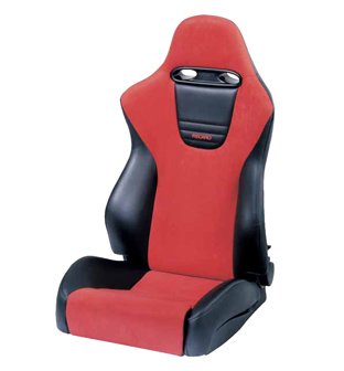

What you want is a pair of ATR recaro's! Best seat i ever sat in, and then some :lol:

I'm loving those seats Ben.
They're not an essential, but could be if they came in red and black. :blush:
They did in the ATR, but they are quite rare. Not a great pic:
http://i46.photobucket.com/albums/f140/iri.../P1010071-1.jpg
These are for sale on the forum at £400 i believe, but not to my liking :)
http://i46.photobucket.com/albums/f140/iri.../P1010074-2.jpg
The seats are also fitted to mitsi evo 5/6 as well as the clio, apparently
