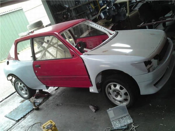

easypug
Small update with a picture of the progress. Still quite a lot to do.
easypug
Just to add the bonnet hasn't been fitted correctly yet.
easypug
Getting there, still some smoothing to be done which will be done when it's painted.
Will-205
I like it good work.
