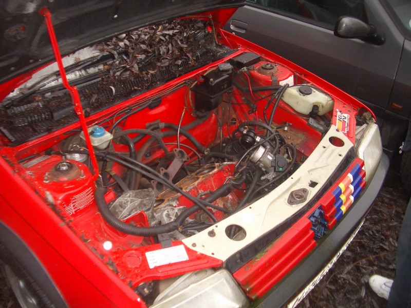

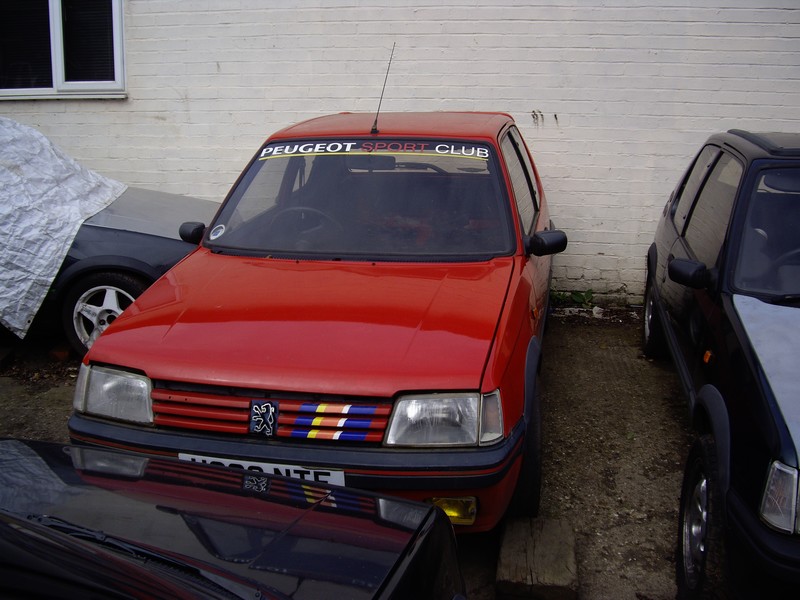

Here are some pictures of the shell that will be getting the attention over the coming weeks/months and no doubt years.

I am sure you can add a few more pics of shinny bits tomorrow. :blush:

Not my actual pistons but they are the same just to give an idea. Also a picture of the unsuspecting shell which will recieve all the treatment some time this year.
