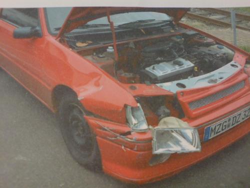

Some older pics of my last crash
DrSarty
^^ Who didn't look at that picture and think..."hmmm, what could I scavenge off that?" :lol:
Swazy
^^ Who didn't look at that picture and think..."hmmm, what could I scavenge off that?" :D
As you can see there´s the old TU-Engine inside :D
The crash was the result when women means to turn the car on street and have no eyes for the traffic :D
But my car was repaired very quickly
