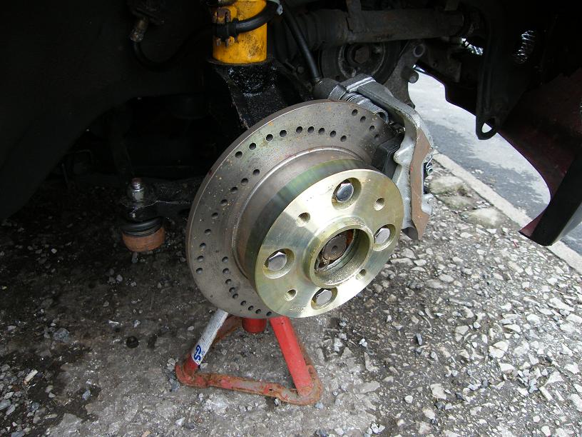

Damned good read that Phill, on a side note, what do your rear discs weigh now?
-Phill
pip470
Cheers Phill, well the rear disks I never weighed because to be honest i dont think it will be that much differance. I will weigh one though next time I have the wheel off. I have finished my new video now but because i only used windows movie maker it has a limited amount of things I can do. It doesnt contain the in car vid of my 13.9 run as the video clip is 7 minutes long and movie maker dosent let you crop it. I will do another soon. Also on the run it looks like the monaro doesnt set off at the same time as me but I have a pic of us leaving together and his reaction time is .7 and mine is .5, He did get a 3 second 60ft though so he did have a bad start, stil in the words of f&f, "winings wining" lol

Rippthrough
Cheers, want to see how they compare to mine :):(
